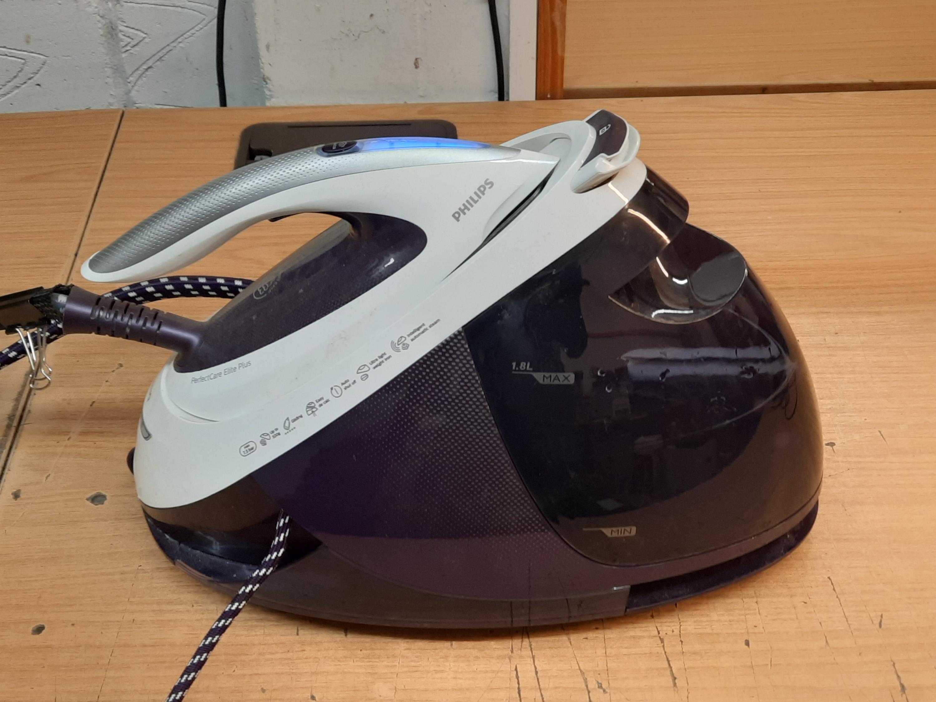

    GC9660 Philips iron advice please
    Full model GC9660/36/BI
    Hi all, this iron intermittently not producing steam.
    Anyone have experience working on them?
    • 31303
    Re: GC9660 Philips iron advice please
    strip it down, you will probably find the steam hose has leaked at one end and caused a shitload of corrosion
    • zen
      • 511
      Thanks STJ,will check & report back
      • zen
        • 511
        Right so here's what seems to be happening.
        When first powered works fine with plenty of steam.
        If I, then sit iron back onto its base & pick it at a later time it doesn't steam, but If I power on/off from standby button on base steam is back.
                    Strange, seems to be working fine.
                    Start up as follows
                    When initially powered on at mains, then standby button on base pressed, 2 quieter relay clicks are audible, then a louder click, which expect is the solenoid.
                    Element then kicks in to heat water.
                    during this time standby button LED flashing BLUE.
                    When then LED stabilizes iron is ready to go, & whenever trigger on iron is pressed there's an audible click, when steam released.
                    If iron sat on base again, unit goes into a semi sleep mode, whereby standby LED remains BLUE, & will start to flash when iron pick up, then stabilize when ready to go.
                    If iron left sitting on base for a longer period of time standby light goes out & would need to press button for power.

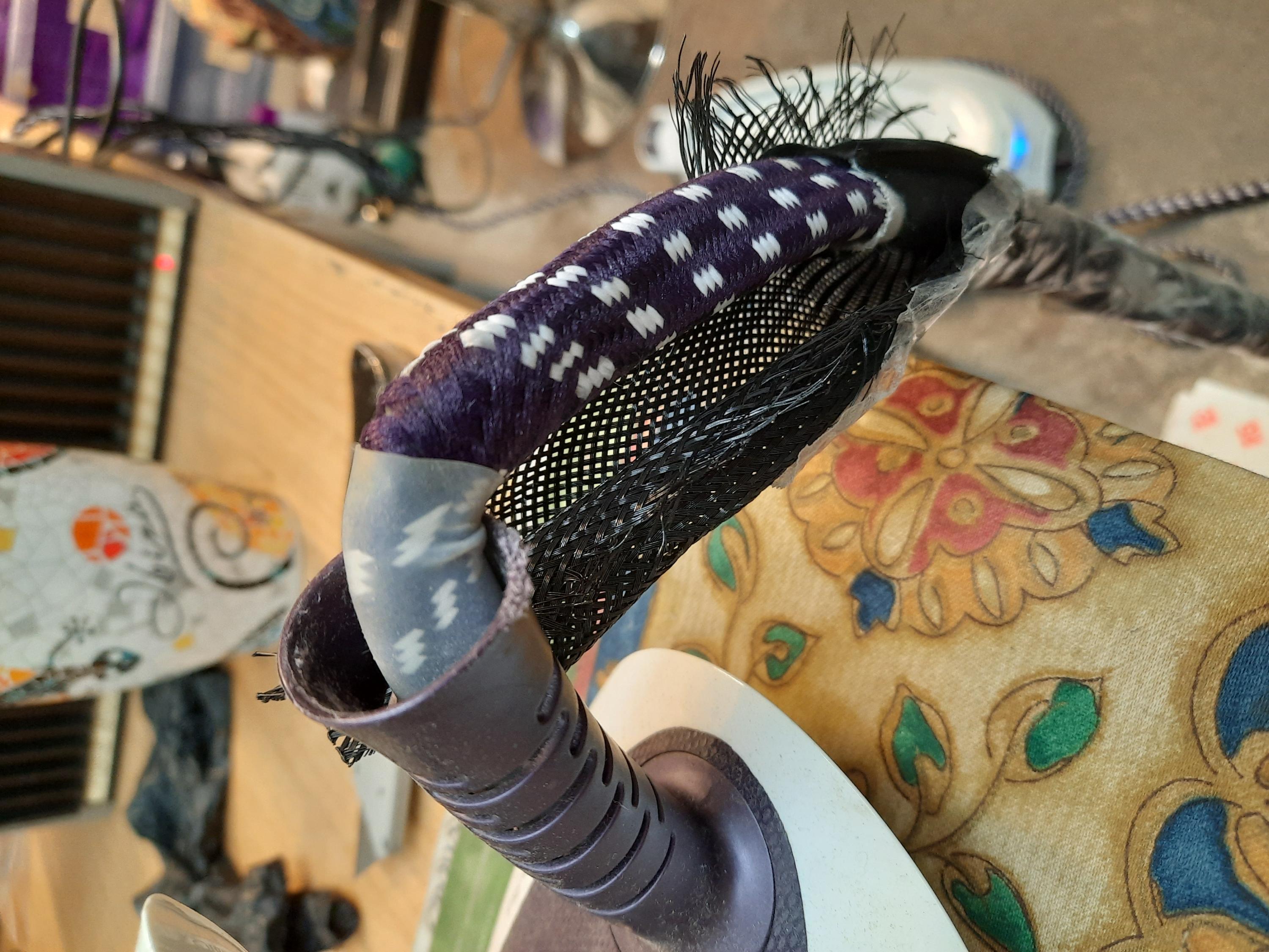

                              Really appreciate your input guys.
                              Had been searching for a complex issue where there wasn't one.
                              After some more investigation have discovered the issue.
                              The tubing that is a conduit for steam is being pinch when the iron is lifted high, which in turn restricts the flow.
                              Thinking of fitting some something over the tubing to stop it from being pinched.
                              Any other ideas welcome.
                                • 31303
                                a spring is the usual method, but it may not work if the hose is weakened at that point
                                • zen
                                  • 511
                                  Found the complete lead from ASWO
