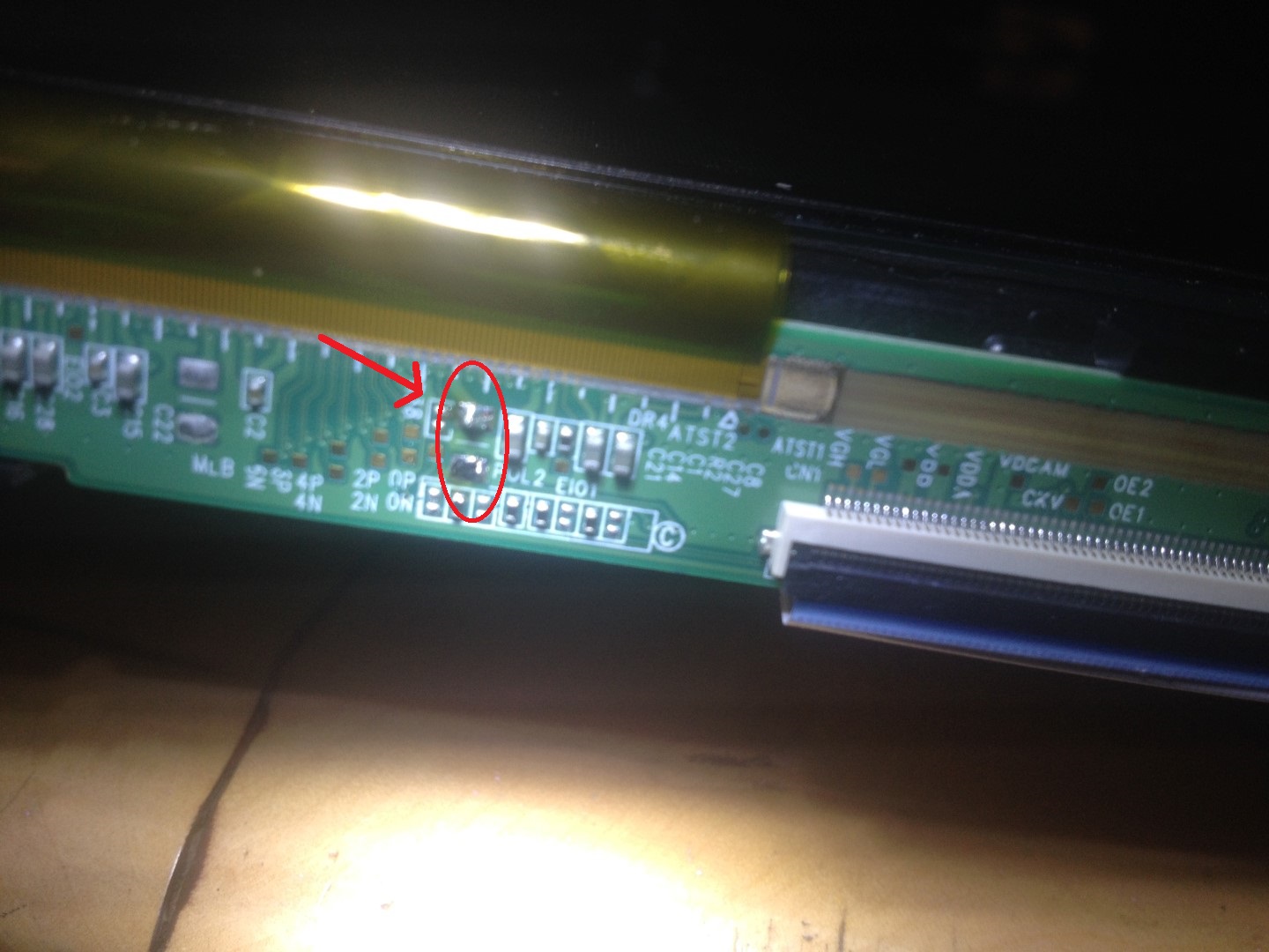

    Hi,thought I would post this in the hope it can save some tv's.
    Sony KDL-42ex440,completely dead,no reaction on buttons etc,as if main fuse is blown.
    Disconnected LVDS cable to t-con,tv comes alive,no picture of course.
    Reconnect LVDS,disconnect one of two ribbons to panel,tv comes alive with halve screen,other side white.
    Reconnect that ribbon,disconnect the other ribbon,tv completely dead again.

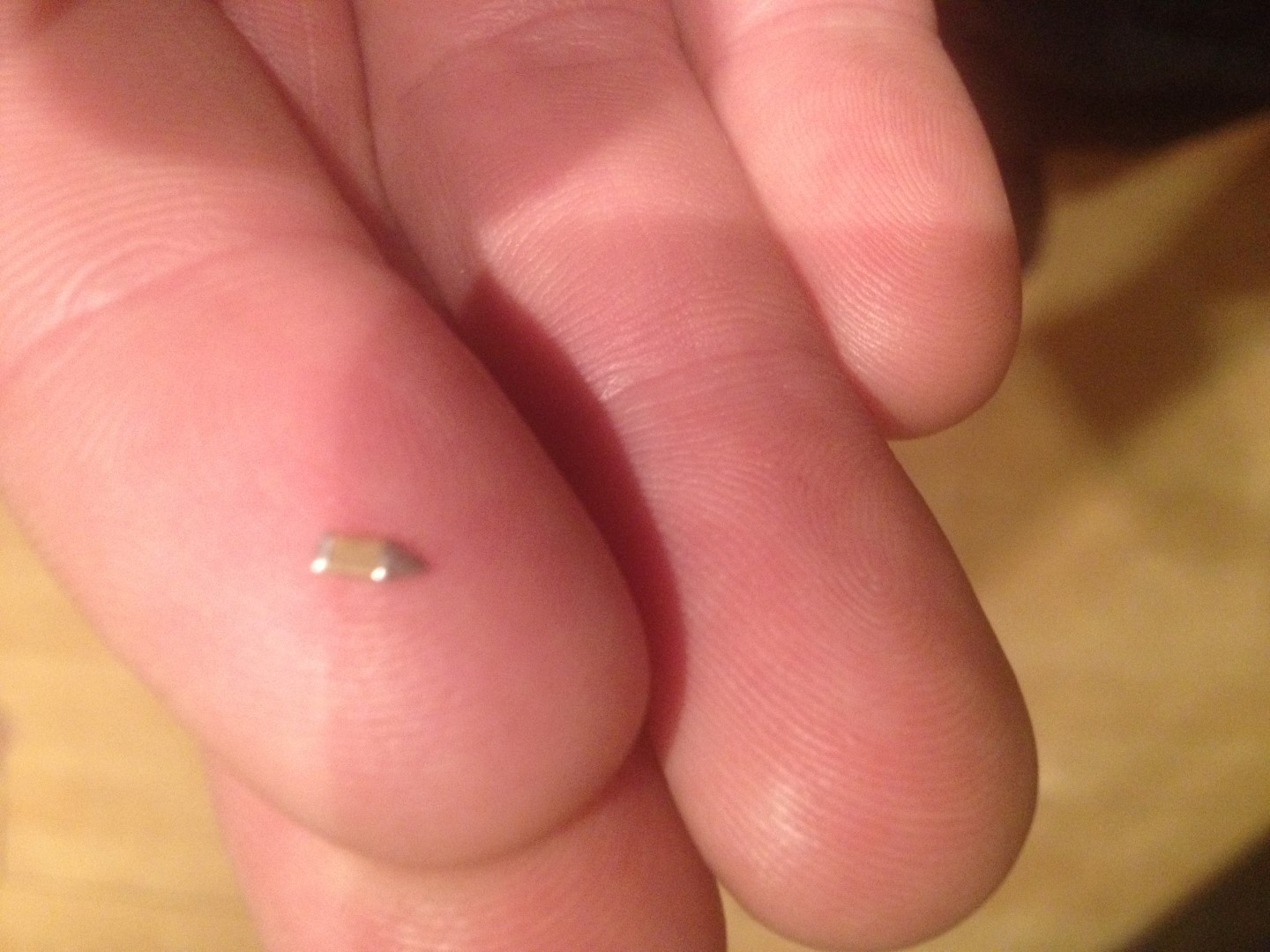

    Looked at small PCB that's attached to panel along the edge,found that the 3 larger capacitors(one by each tab) measured 2.6 ohms.Suspected them to be in parallel.

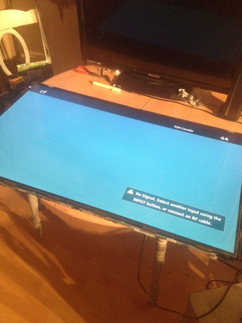

    Removed the capacitor closest to the ribbon cable connector,short gone and tv works perfectly fine again.
    Hope this will help somebody

      Lol,super easy to find. I posted this more for awareness,as in "don't give up on panel too soon"
      I fixed a few this way,some samsungs etc. Never had luck on LG with this.
      It would probably be a good idea to replace that cap,so far I just remove them,never had one come back yet.

          Can't remember the models,it's wide spread.
          When in diagnosing I get halve screen results,I then measure all caps on those narrow boards. Been lucky with this often enough to make it an effort
          No signs of damage to caps,they just measure very low ohms.

              Re: Sony shorted screen,fixed
              BTW, the failure mode for those MLCC is shorts or bad leakage resistance.
