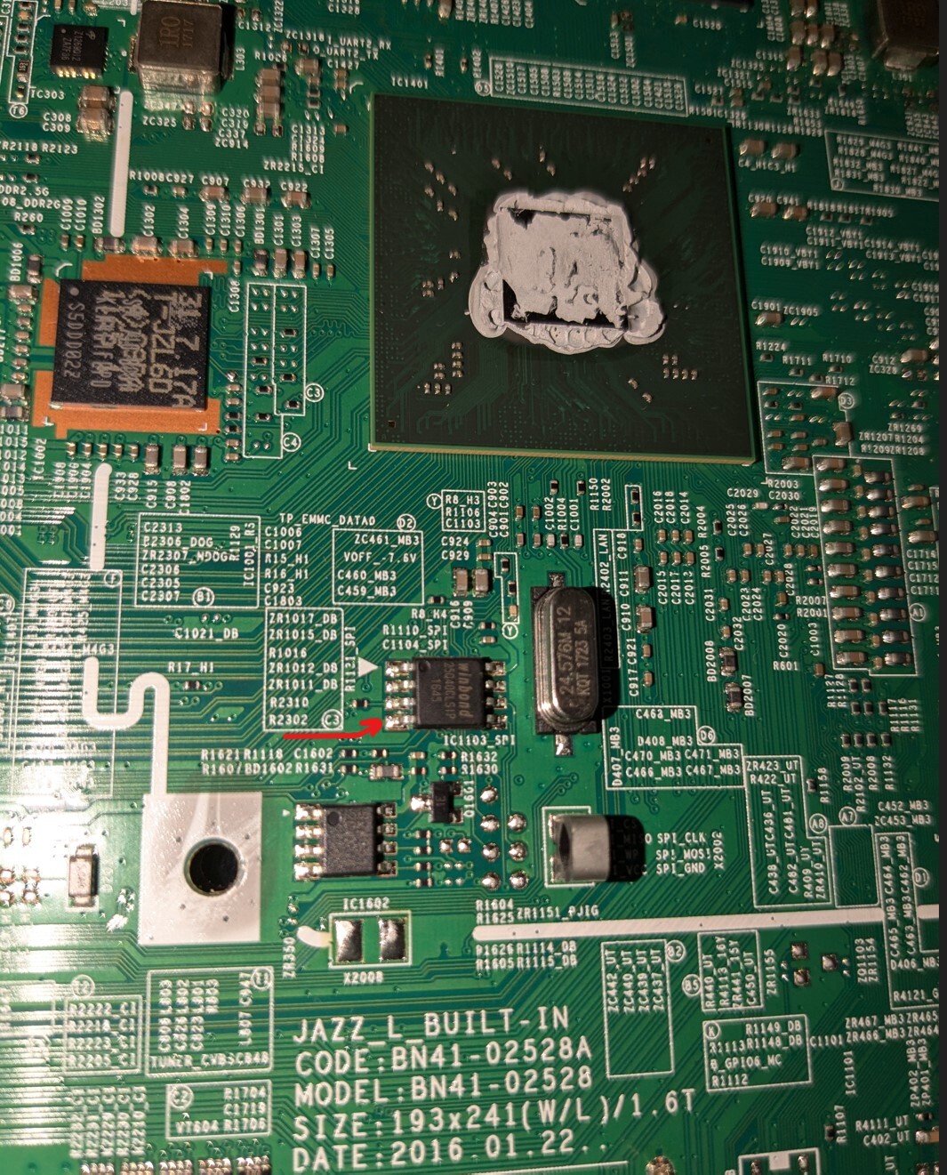

                                  I have a Samsung UE65KU6099UXZG with no standby LED. Voltages on Motherboard are fine (5V, 3,3V, 1,8V). Here is the EEPROM dump. Maybe it is bad?
                                  • lotas
                                    • Jan 2016
                                    • 4598
                                    • Russia
                                    #1777
                                    This dump has nothing to do with standby, this spi flash belongs to T-con, look for spi flash 25Q40 on the board.
                                    • Andreas_de
                                      • Jul 2024
                                      • 15
                                      • Deutschland
                                      #1778
                                      Here is the SPI dump. Thanks for your help.
                                        This dump is ok, working.
