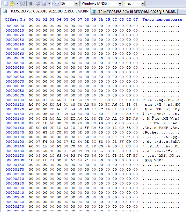

                    I'm looking for a dump for a Legend model: LE3233B
                    Main board is TP.MS3393.PB851
                    Panel is HW320WX2-206
                    • lotas
                      • Jan 2016
                      • 4598
                      • Russia
                      #1130
                      Re: Eeprom dump thread!
                      Post your non-working dump here, I'll fix it for you.

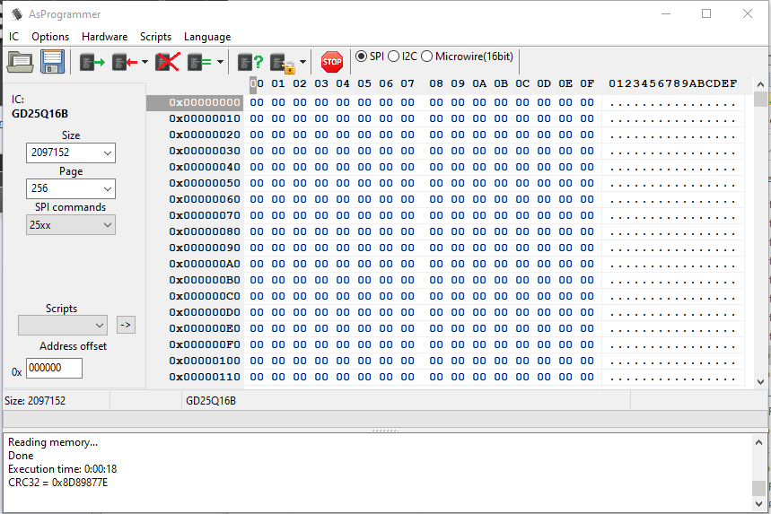

                                    • jeff260z
                                      • Jun 2014
                                      • 3
                                      #1138
                                      Thanks. I've been trying to read the eeprom but I keep getting all zeros from asprogrammer.
                                      I'm using a CH341A and trying to read the chip while still on the board. I've tried to read the eeprom from two different tv's and am getting zeros every time. I'll keep trying to figure things out.
                                      • Rajnhl
                                        • Oct 2018
                                        • 94
                                        • India
                                        #1139
                                        try with shorting crystal attached to main ic
                                        or programmer is not supplieng enough power to eeprom
                                        • lotas
                                          • Jan 2016
                                          • 4598
                                          • Russia
                                          #1140
                                          It should be like this at the beginning of the dump, unsolder the flash and try to read data from it.
