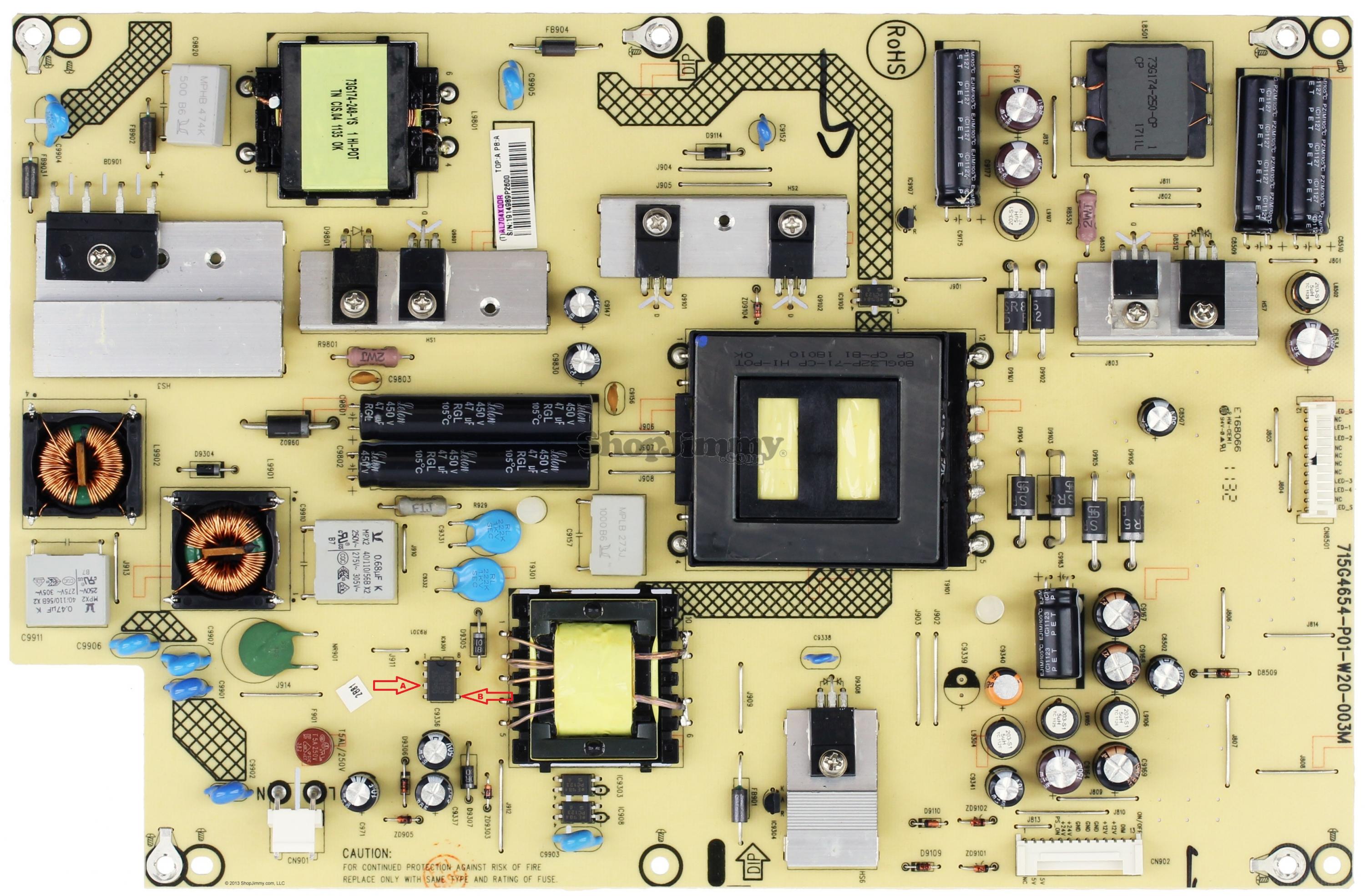

      Using your meter set to DC volts, black lead on point "A" and red on point "B" what voltage do you read. It should be a minimum of 13.8V
      STR-A6069H
      What pin numbers correspond with "A" and "B" you reference?

        Re: Vizio E370VT no longer turns on
        dick_barton can you clarify which points are A and B that you are referring to?
          Sorry, forgot to add the photo.
          • jason424
            • Dec 2015
            • 187
            That's OK. When I test it I get varying 29.3-29.7
              So is the voltage across those pins when it is running normally or when refusing to come on?

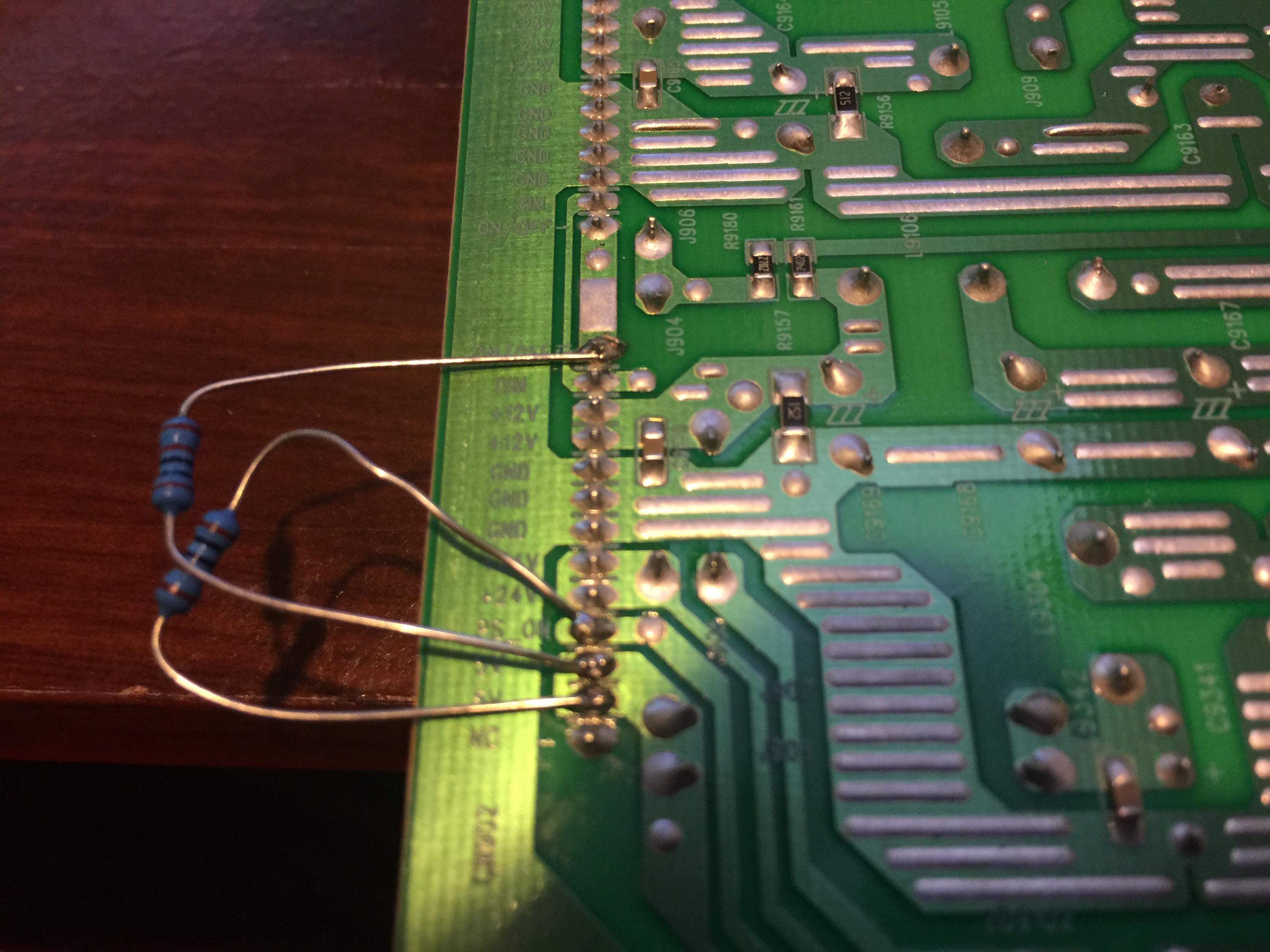

                  Disconnect the main board from the power supply.
                  Connect 1K resistor from 5V to PS_ON
                  Connect a 2nd 1K resistor from 5V to ON/OFF
                  Do you have 12V, 24V and DIM= xxV
                  What voltage between the two legs of C9803 (was 170V)
                  What voltage between pins 3 & 5 of IC9301 (was 29V)
                      Have the resistors handy now. How do you "connect" them to the pins? Little solder or ?
                        You can either solder them on the underside of the board or push them into the mainboard end of the connector from the power supply (as long as you ensure you have the correct pins).
                          Ok. Have the board out and the resistors installed. Now board needs to go back in and reconnect power supply to test the voltages stated above?
                            Make sure the resistor leads do not rest on the chassis when you put the board back in. Do not connect the main board. Power up and check all your voltages are present and backlights come on.
                              OK I have:
                              5v: 5.2
                              5v: 5.2
                              PS_ON: 4.8
                              ON/OFF: 5.1
                              The rest were 0.00
                              C9803 (was 170V): 171.7-172.0
                              IC9301 (was 29V): 12.2-12.3
