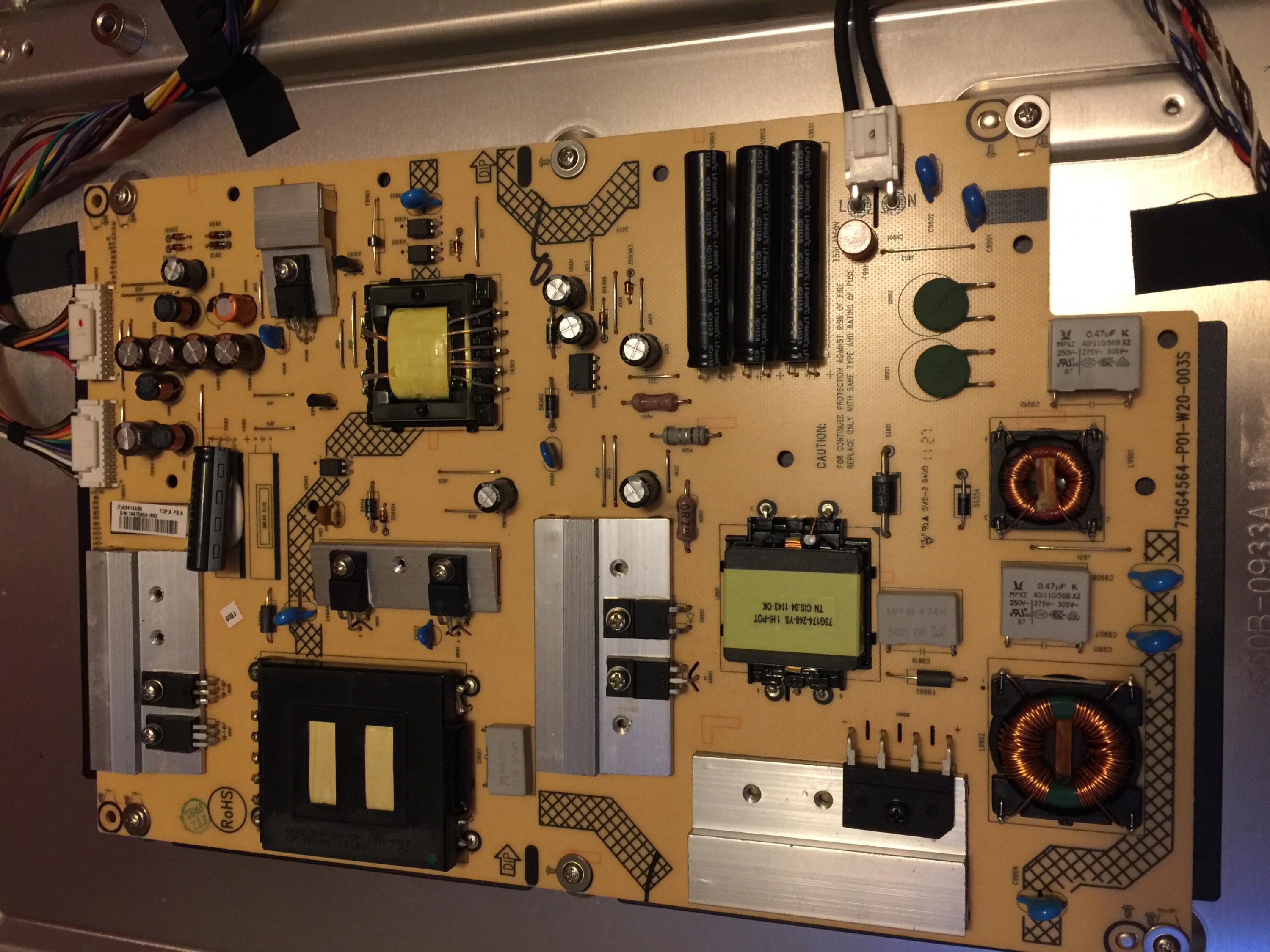

Vizio E370VT no longer turns on
  • jason424
    • Dec 2015
    • 187
    Tv did work but next day it won't turn on with remote nor button on side. Amber standby light is on but does nothing when pushing the power button.
    I don't see any bad caps and do have 5v standby (which I assumed since the standby light is on in the front.
    What other voltages/items should I be checking?

      Thanks for the response. Is the optoisolator the device that is below the 3 capacitors in the middle? I googled testing an optoisolator and it shows 4 pins that's why I ask: http://www.antimath.info/electro/how...n-optocoupler/

        The optoisolators are the four pin IC's above the transformer.ead correctly they are IC906 and IC9x07 ????
        Follow the checker divider between the hot and the cold side at the top. Second and third components down. Try freeze spray perhaps and see if it comes on.

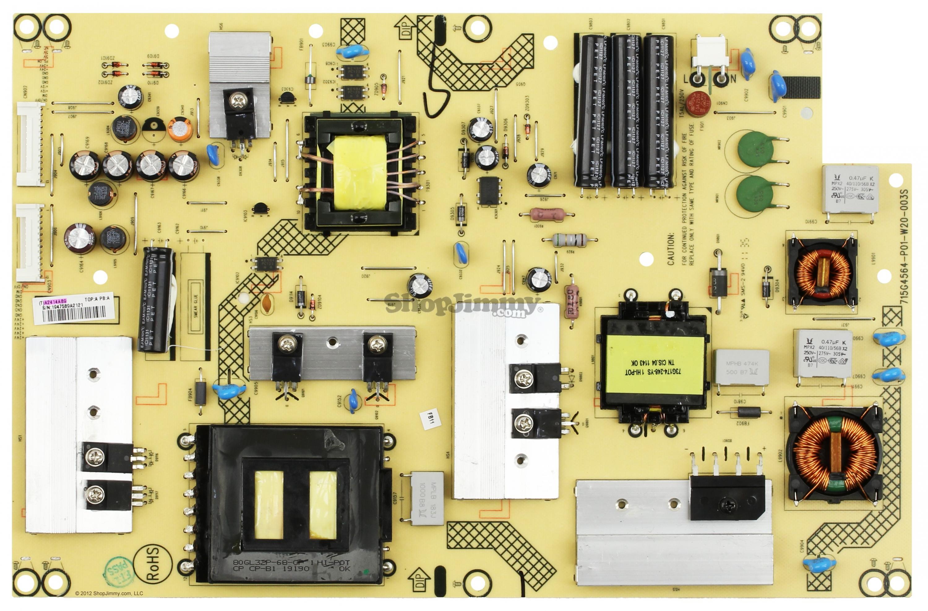

                            So the PS-ON (4.8 Vdc per your report) is present but the DCV on the main filter caps are only 170VDC, that means the PFC Voltage booster circuit is not working, the DCV on the filter caps should be >380 VDC when PS-ON is present.
                            Vizio ADTVA2414AB9 Power Supply
                            http://www.shopjimmy.com/vizio-adtva...upply-unit.htm
                            Pictures provided by shopjimmy

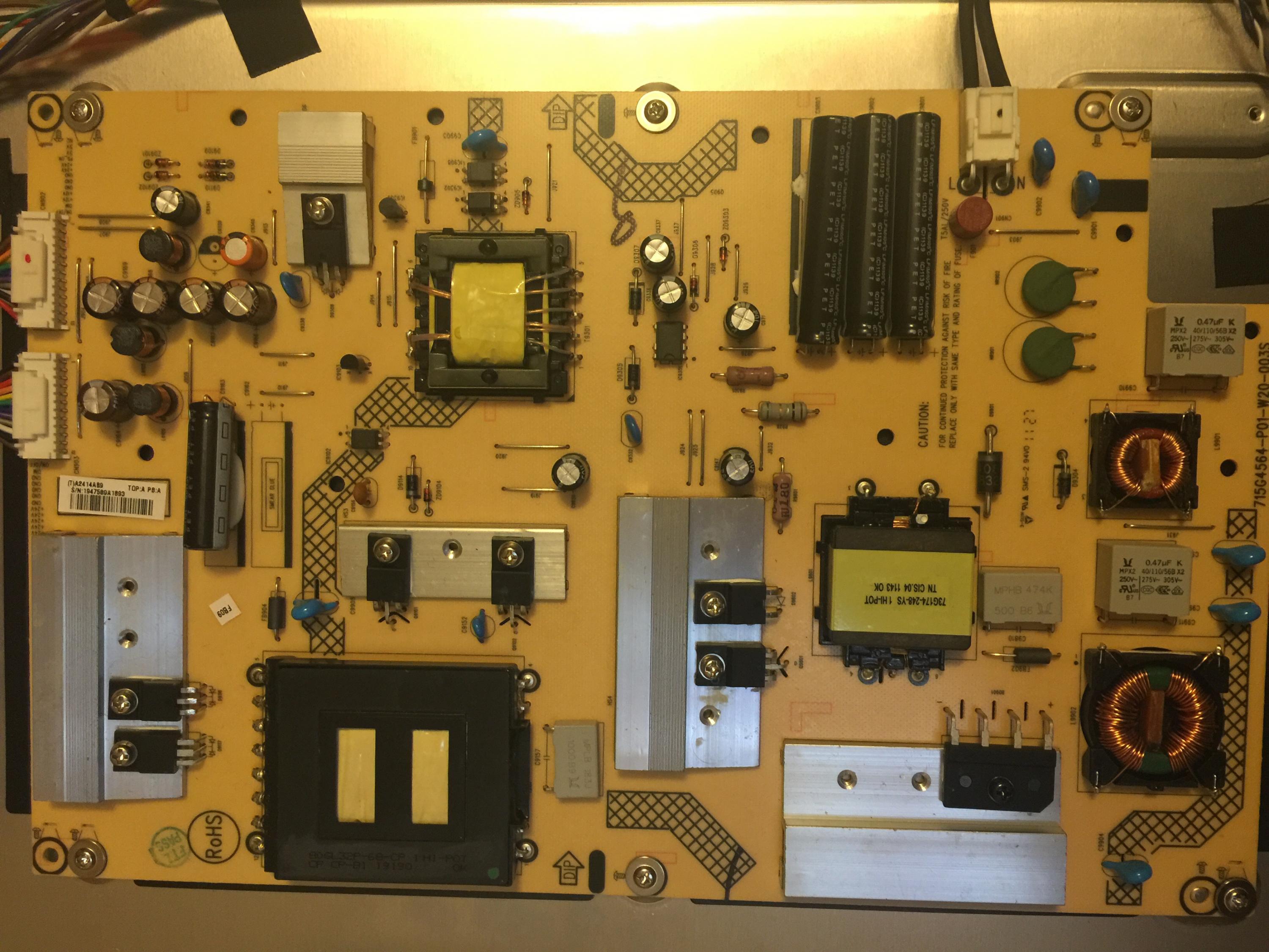

                                    The only 7-pin I see is in the middle of the board in the attached pic. It has printed on it:
                                    A6069H
                                    SK163
                                    24630D
                                    The only other ICs I see are in the checkerboard pattern running across the upper third (left since pic rotated upon upload) of the board and they have 4 legs each. Can you point out which is the 8 pin you are wanting me to check please?

                                      Bottom of board IC
                                      • dick_barton
                                        • Aug 2015
                                        • 6643
                                        • Wales
                                        Re: Vizio E370VT no longer turns on
                                        Using your meter set to DC volts, black lead on point "A" and red on point "B" what voltage do you read. It should be a minimum of 13.8V
                                        STR-A6069H
