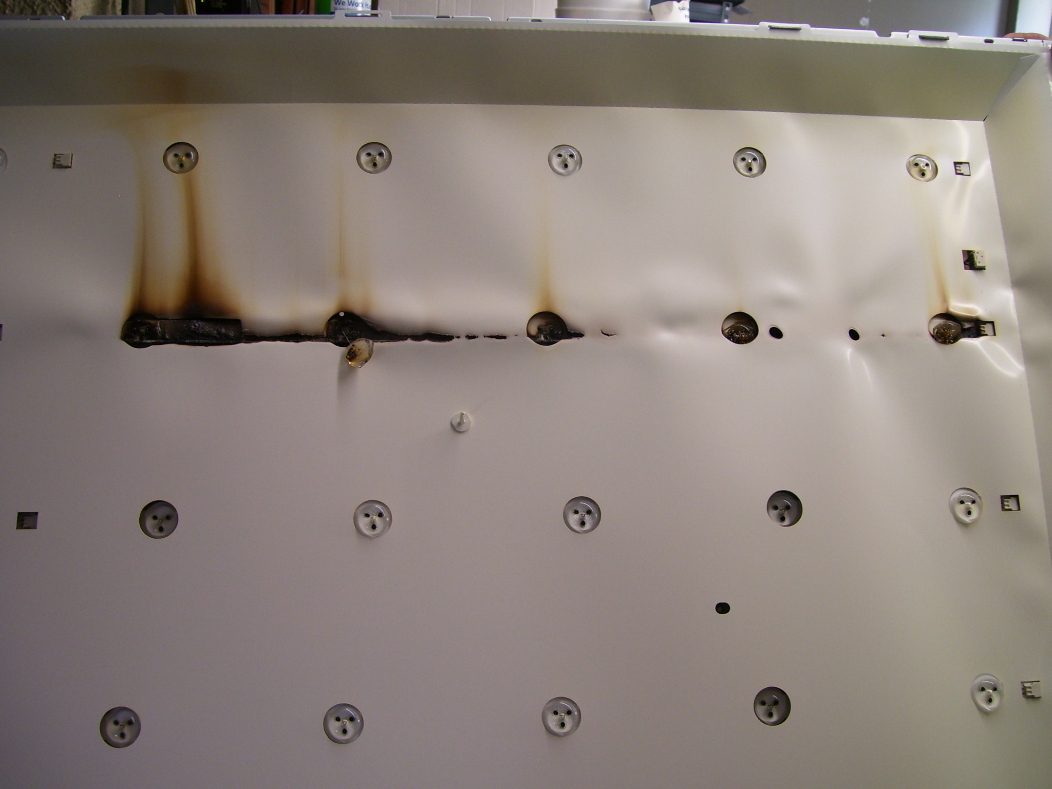

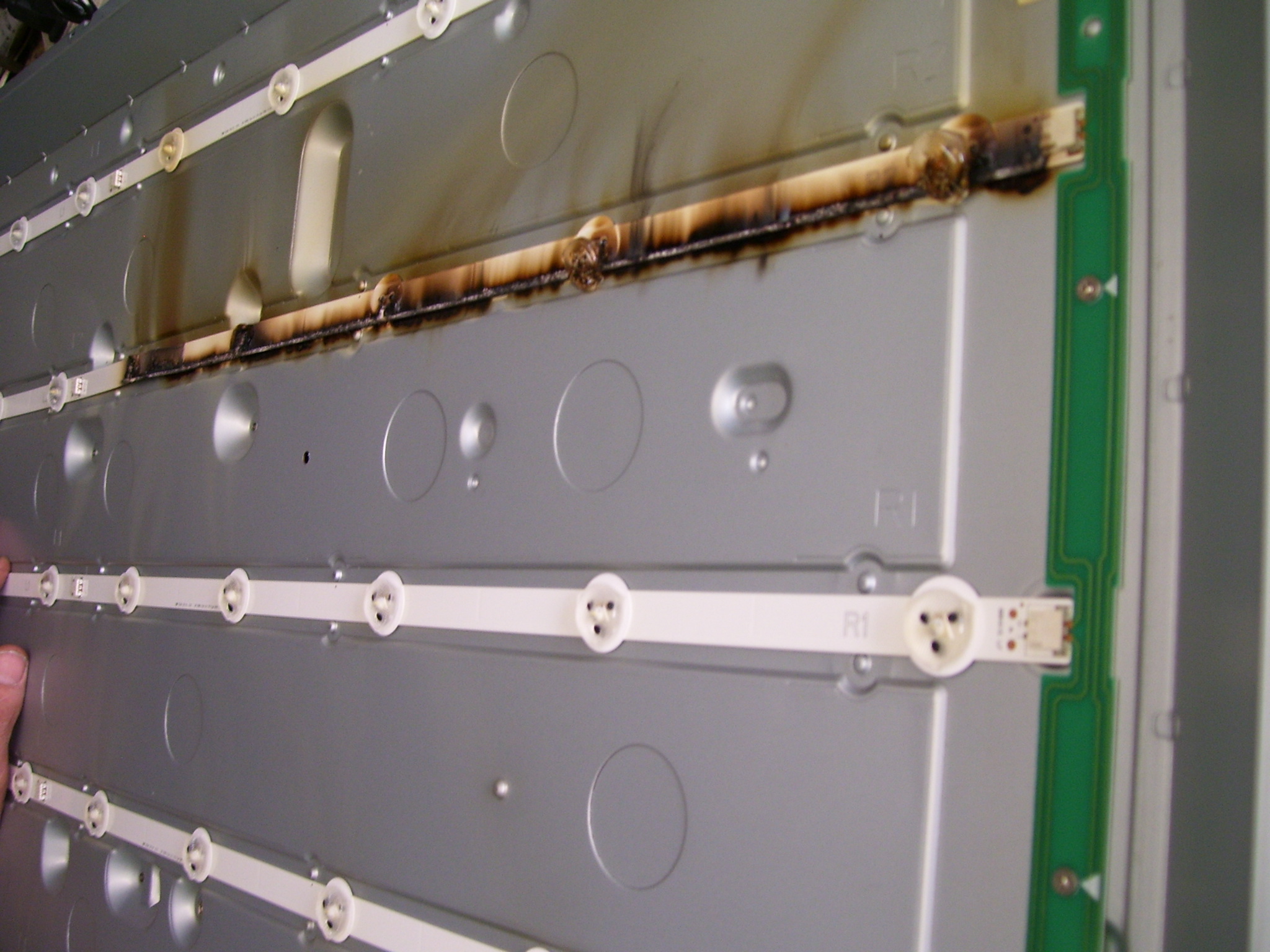

    Customer bring this in,,,LG 50ln5700 led strip fire, after testing , all was fire just no bl... replaced complete set of strips and the firmware update to stop this from happening again is important. had to have smelled that!

                      so what am i seeing, the pcb shorting against the backplate, or arcing between the tracks on the board?
                      it's very uniform along the length!

                          It seems to be shorting the return trace out which is why thats burning up. Very odd.

                            One LED failing short circuit in a series chain causing other LEDs to fail catastrophically and then leading to the array basically being a short across the power board output would be my guess.

                              The psb is only putting out 76.1v now. the legend states 110.v to LED, they just flash at boot. ideas?

                                  Driver Ic return probably damaged due to shorted/burnt string.
