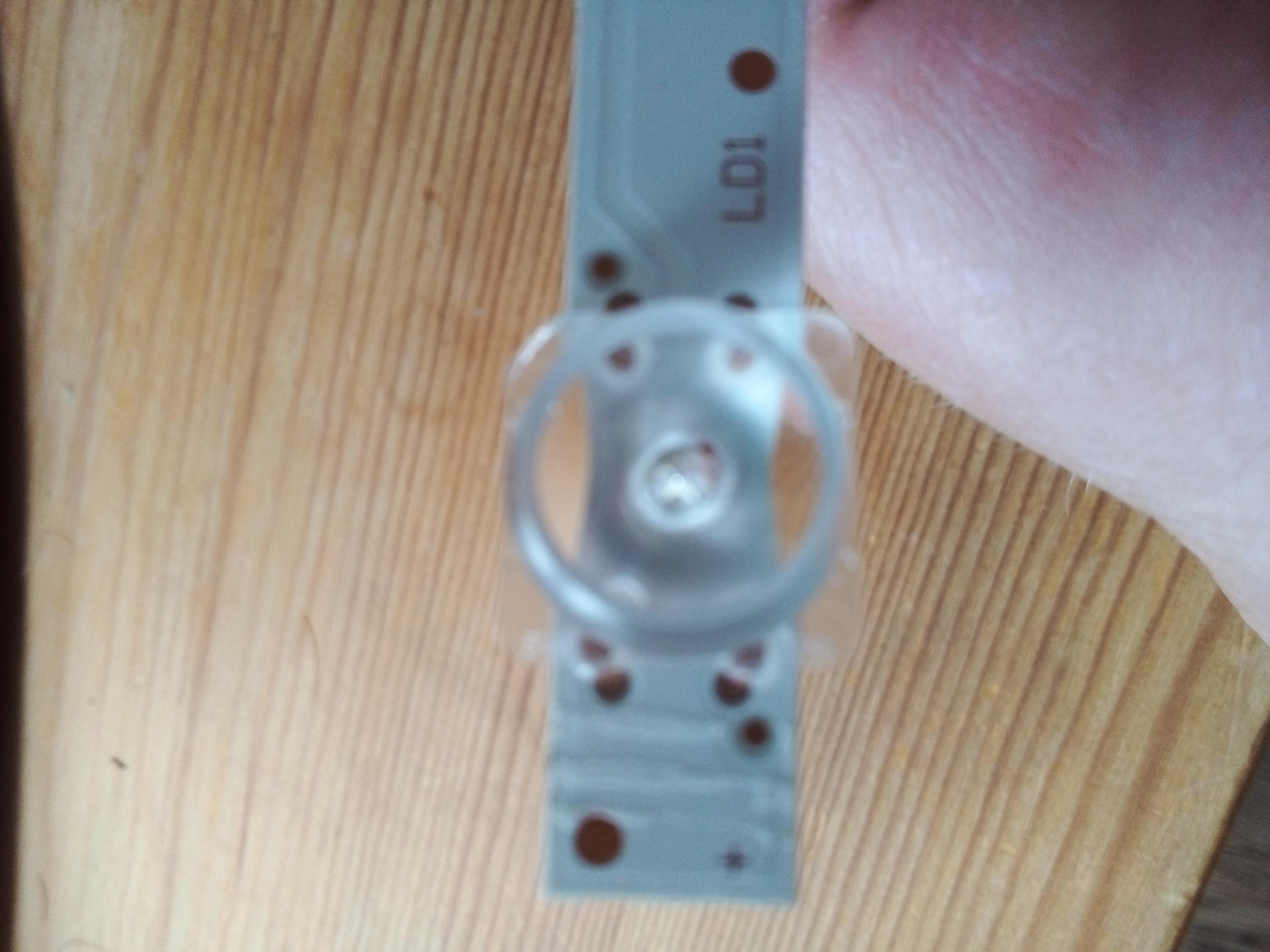

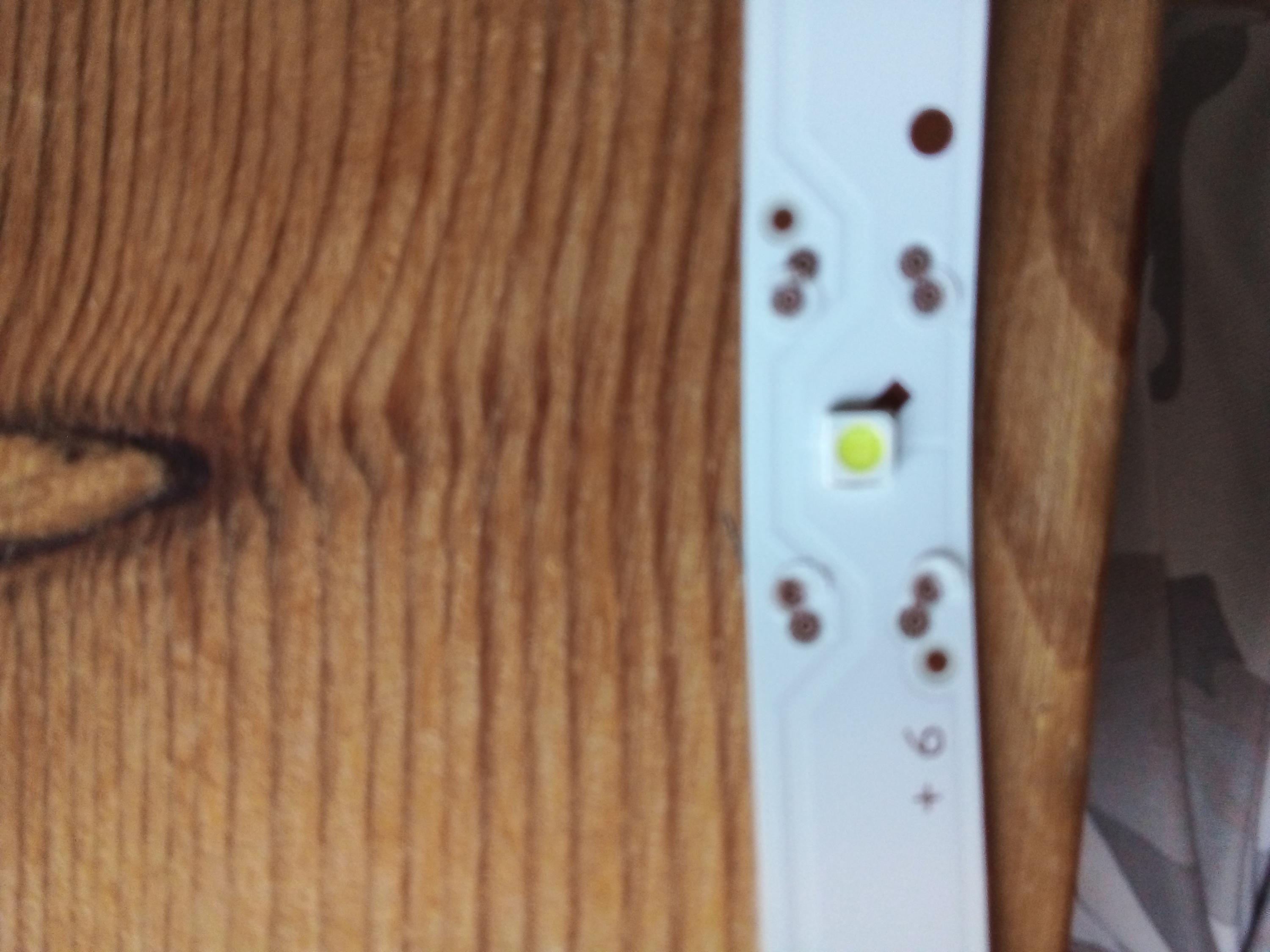

    I wonder if i shorted the whole strip...where to put pos and neg to just light up a single diode...or the entire strip. The strip lit for a second...so maybe i fried it? What say you?
    I have an adjustable dc power supply and was trying around 9 volts.
    I have a pic of a single diode...where to put pos and neg terminals to light it up?

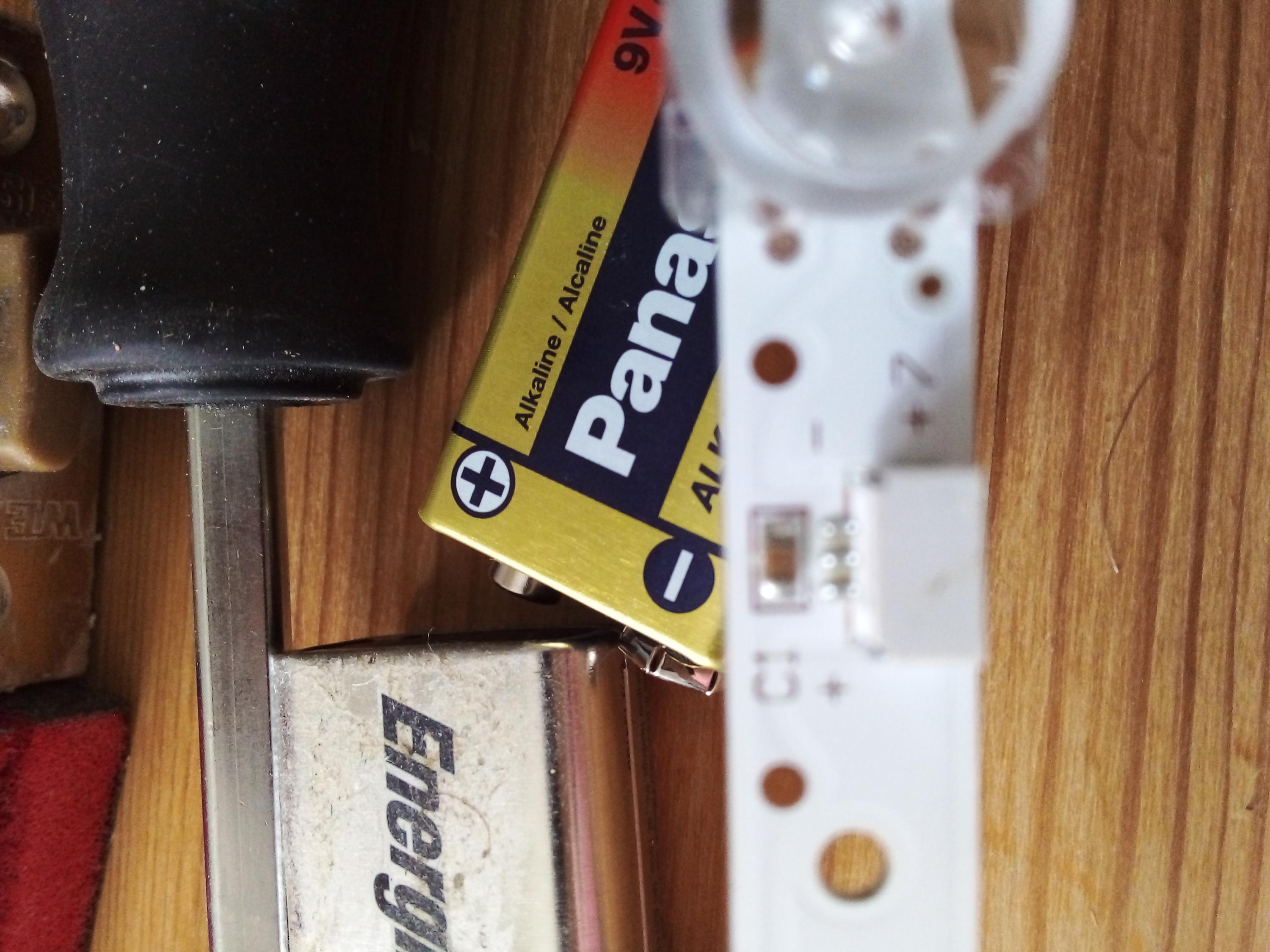

    Pic of middle of strip..is this where i light the entire strip?
    And pic of end...or does this light the entire strip?
    Where to put pos and neg for single diode..multiple diodes and the entire strip. As i mention...i may have blown out this strip already...that is possible.

                ok...positive to the positive sign and negative on LD1 light the first diode at 3 and 6 volts. I was thinking moving the neg to LD2 would light the first two...but no such luck. It seems one is dead and I can light all the others individually. Still not sure how to light the strip though.

                    on the second strip...every diode lights up individually. Just can't figure out where to put the probes to light the entire strip at once.

                        Re: Adjustable dc power supply and tcl led strip
                        I was thinking positive right on the plus and negative on the terminal beside it...referencing the picture of the end of the strip. But, that doesn't seem to work.

                              You should be able to light the entire strip by applying voltage to the center plug, I will assume that there are only 2 wires connecting each strip to the power supply board. If there are 3 wires to each strip, then it might not work.
