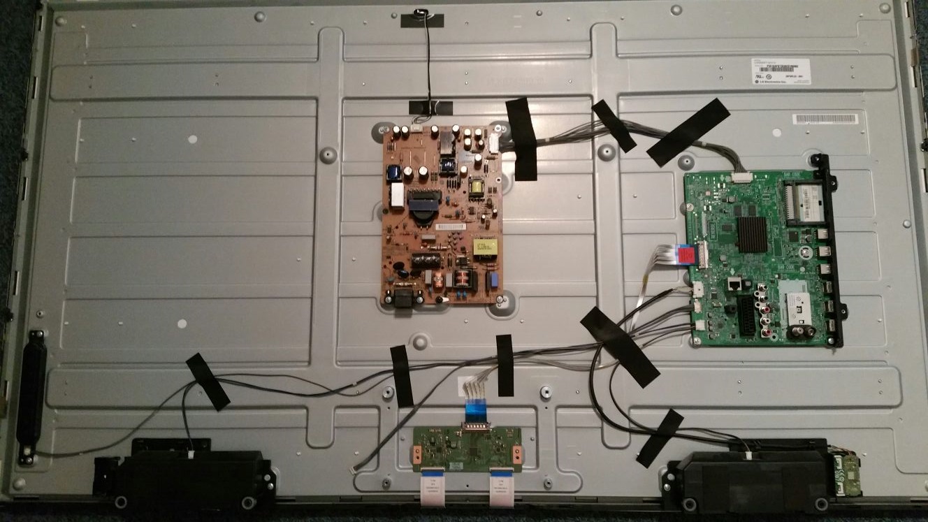

    I have a problem with my 55LA6208 LG led tv. When I turn on the tv, I only see a black screen. The black screen is powered by the leds in the background, so the back lightning is working fine.
    The problem is that I don't see any pictures on the screen.
    I think the fault wil be in the mainboard or the T-con board. I already measured the fuse on the T-con board, the fuse is just working fine.
    So I have a tv with sound and a black screen powered by leds.
    Is there anybody who knows what my problem could be?
  • johns1mj
    • May 2015
    • 242
    Re: Working backlight and sound, but no picture (55LA6208)
    Please include pictures of the back of the tv including input and t-con.
    First double check connections. You can try disconnecting one ribbon at a time to see if half a picture shows up.

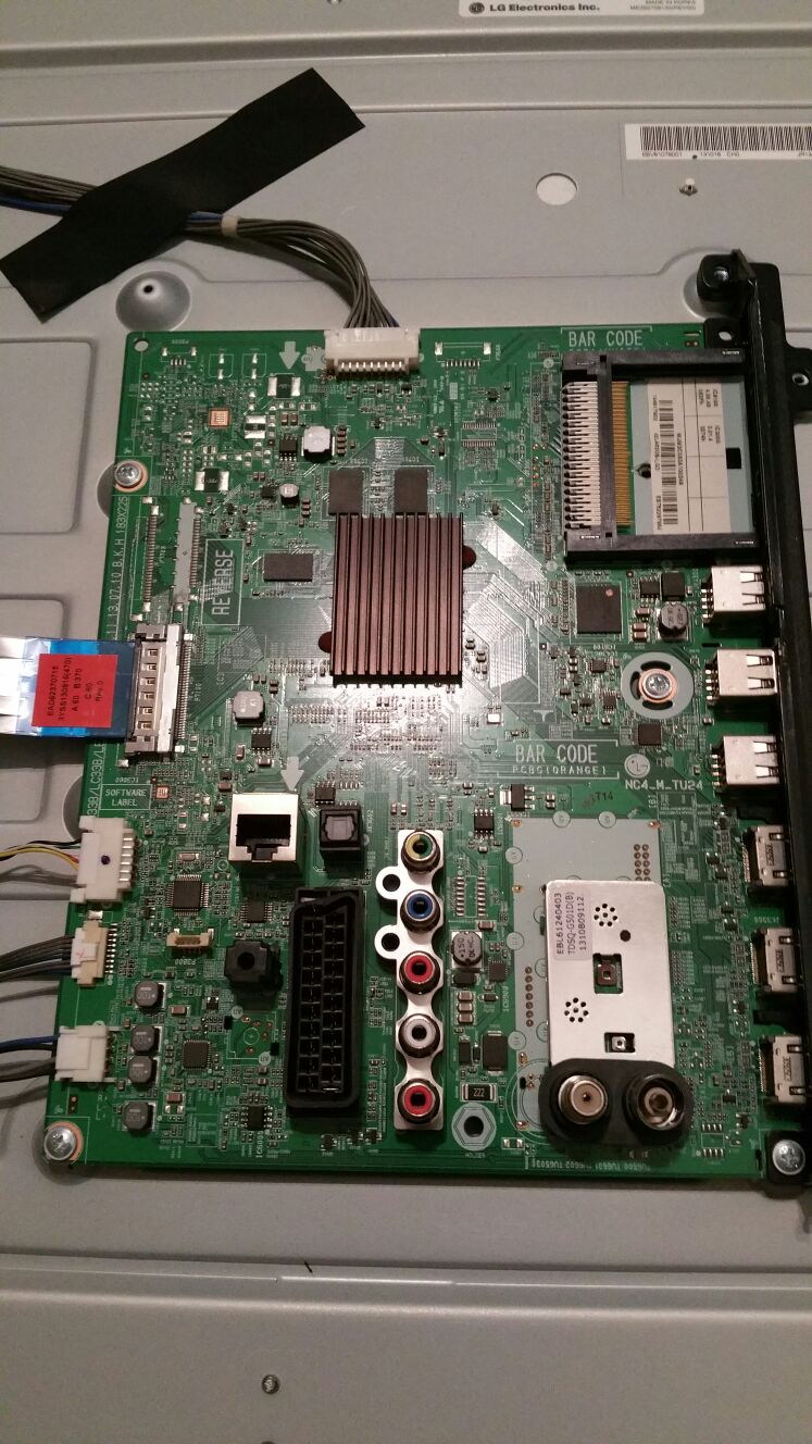

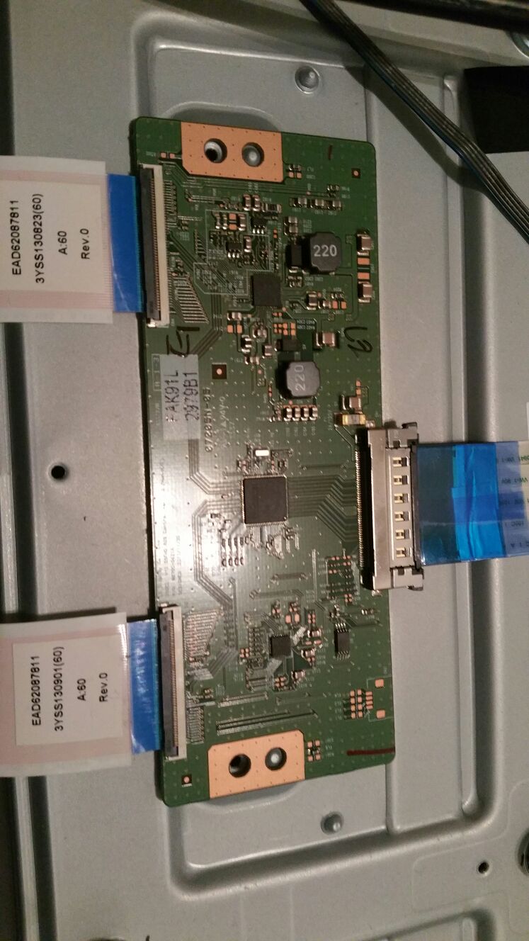

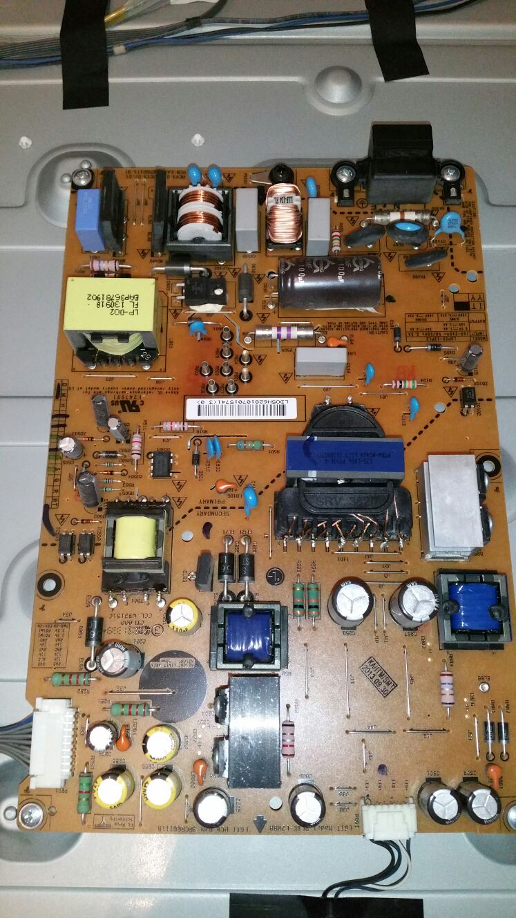

      There are two flat cables on the T-con board going to the screen, i disconnected one ribbon at a time, but it did not change anything, it is still a black screen with led lighting behind it.
      Here are some pictures of the back of the tv:

            OK then try cleaning and re-seating the Flat cable between the Main Bd and the T-CON Bd....Wipe the gold fingers on both ends with Isopropyl alcohol.
            If that doesn't work then your Main Bd needs fixing/replacing

                Yes you can check these voltages on the T-CON Bd.
                Measure and report these voltages:
                1. VGH (V0n) 20~30Vdc Gate ON supply
                2. VGL (Voff) -5~-8Vdc Gate OFF Supply
                3. VDD (Vlogic) 1.8~3.3Vdc Supply Logic Input (especially this one)
                4. VDA (AVdd) 13~20Vdc Gamma Supply voltage
                • Carlozzz
                  • Oct 2016
                  • 9
                  • Zuid holland
                  I got these voltages:
                  VGH: 0Vdc
                  VGL: -6.94Vdc
                  VDD: 0.5Vdc
                  And I could not find the VDA
                  I hope you know what the problem is.
                  Thanks in advance!

                    Well with voltages like that you have a faulty TCON.

                      I changed the t-con board, but there is still no picture on the screen. The voltages I measured are the same as on the old t-con board.

                        Disconnect the 2 panel cables from the Tcon and measure those voltages again.

                          Measured it again without the cables connected:
                          VGH: 27,9Vdc
                          VGL: -6.9Vdc
                          VDD: 16.8Vdc

                              It sounds like you LCD panel is loading down your VGH supply when you gave the ribbon cables between the T-CON and the LCD panel connected.

                                  +1 Does appear to be some sort of loading on the Tcon supplies and I would be suspecting a possible panel fault.
