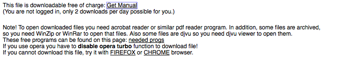

              It is a zip file and not a pdf file which is why it says may be a corrupted pdf file.
                Re: No Backlight on Toshiba 32HL67U
                yes the files are ok once unzipped but you will need the ZEUS ENGINE software on your pc
                http://elektrotanya.com/toshiba_zeus.../download.html

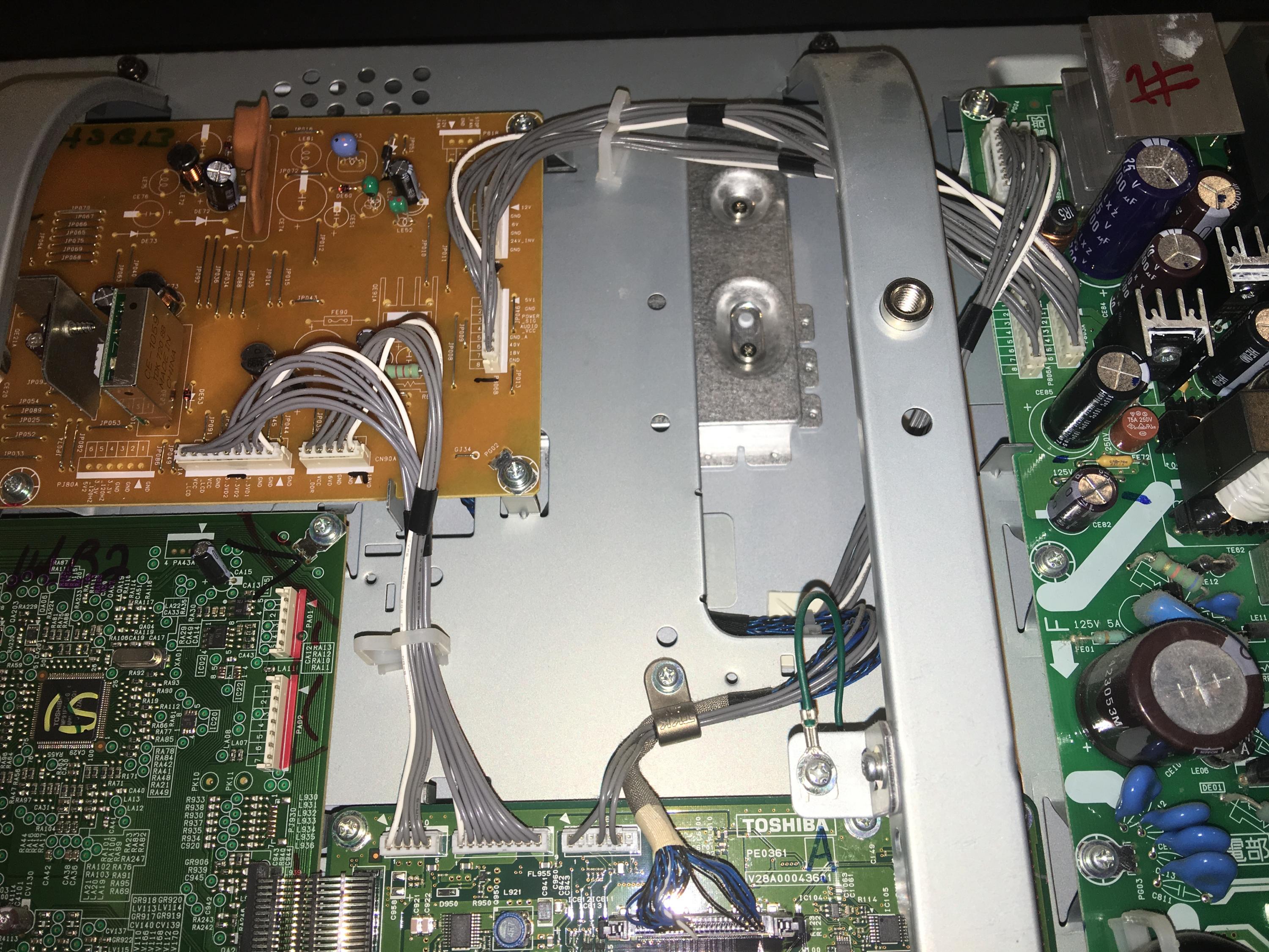

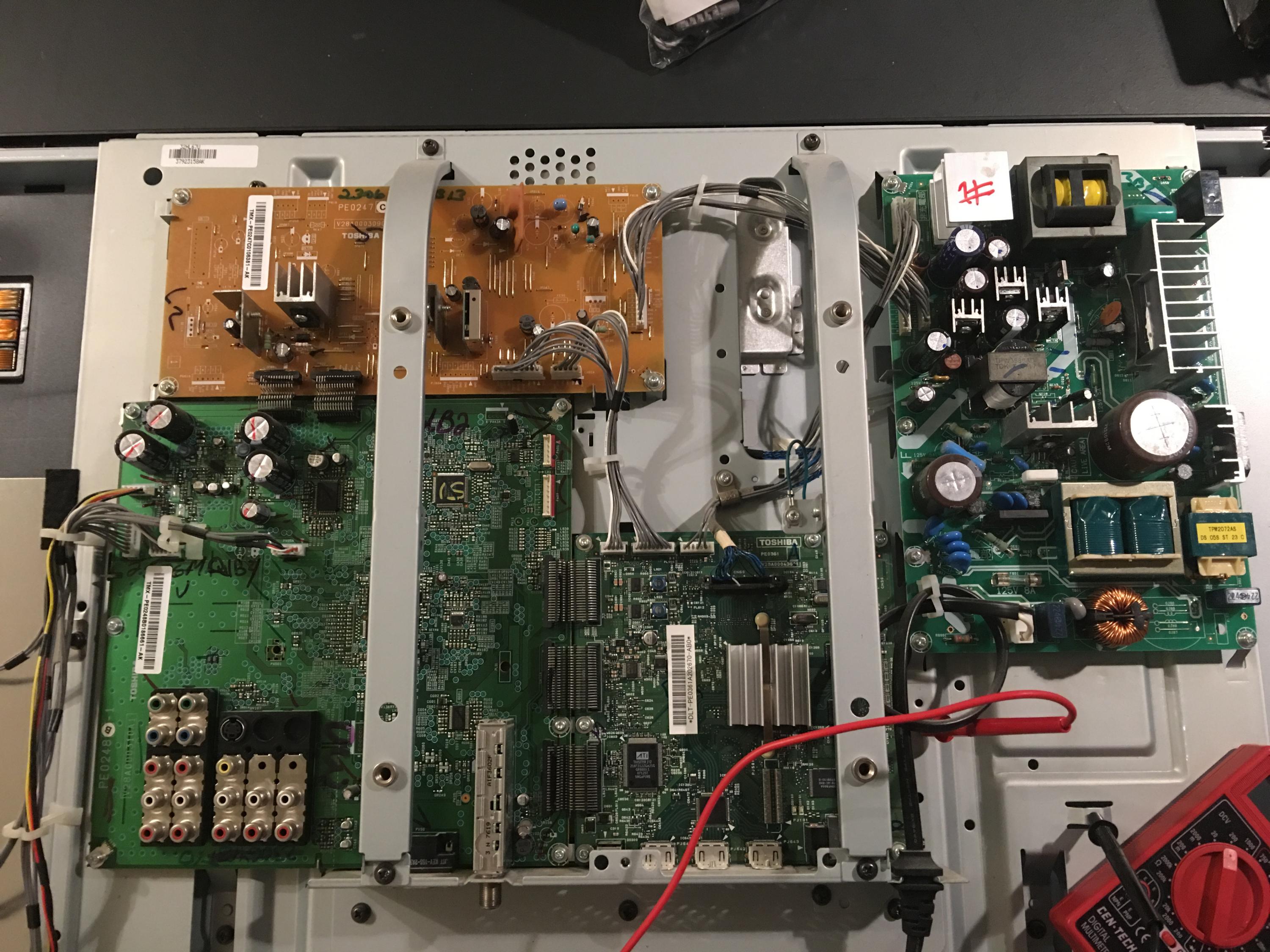

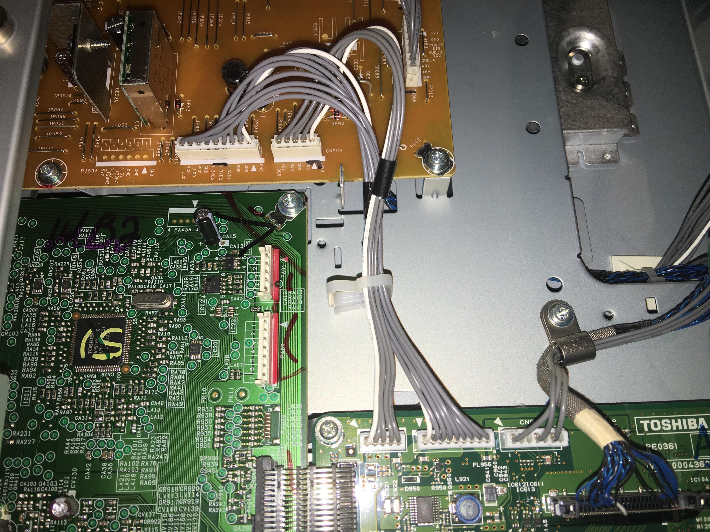

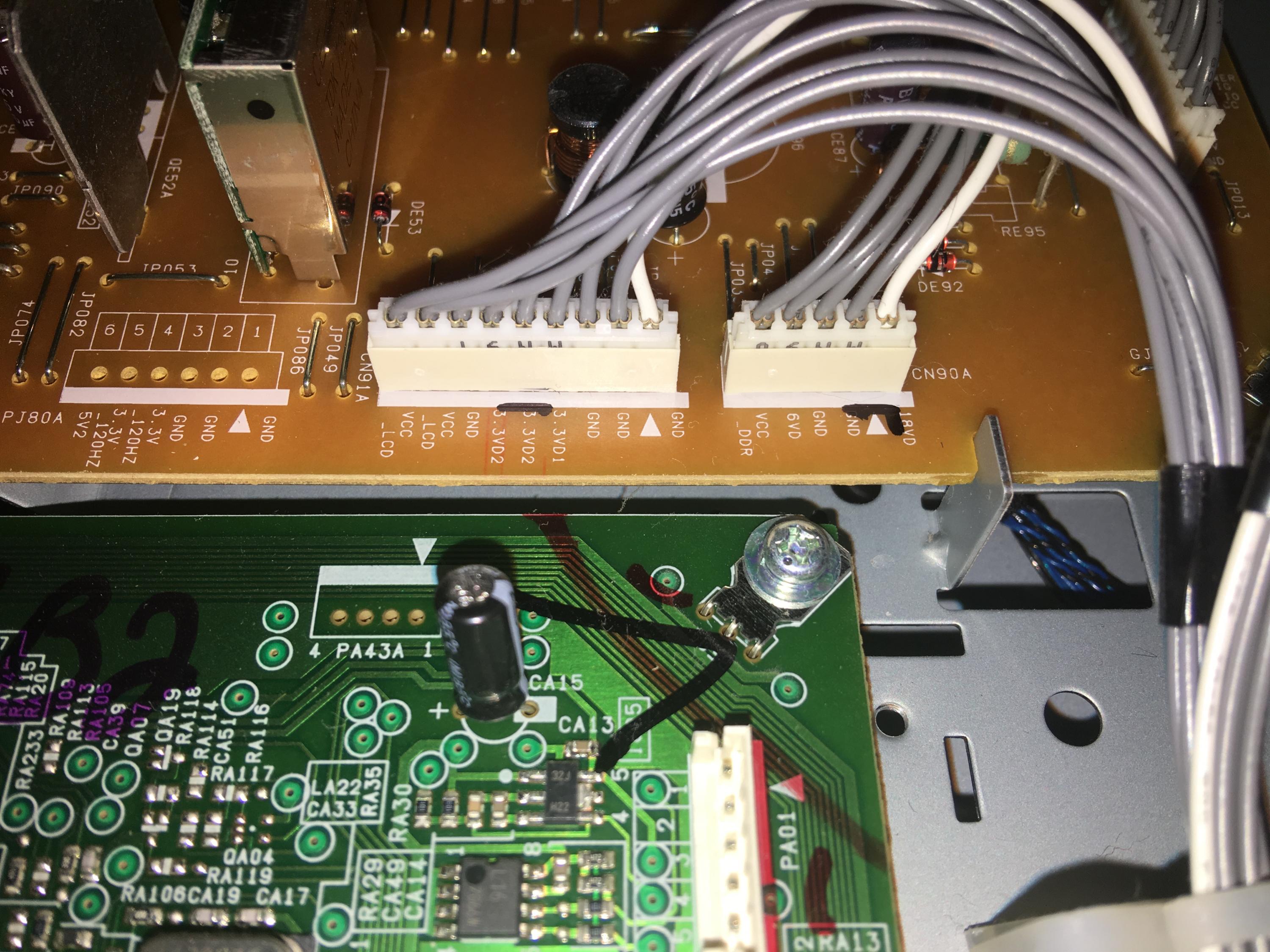

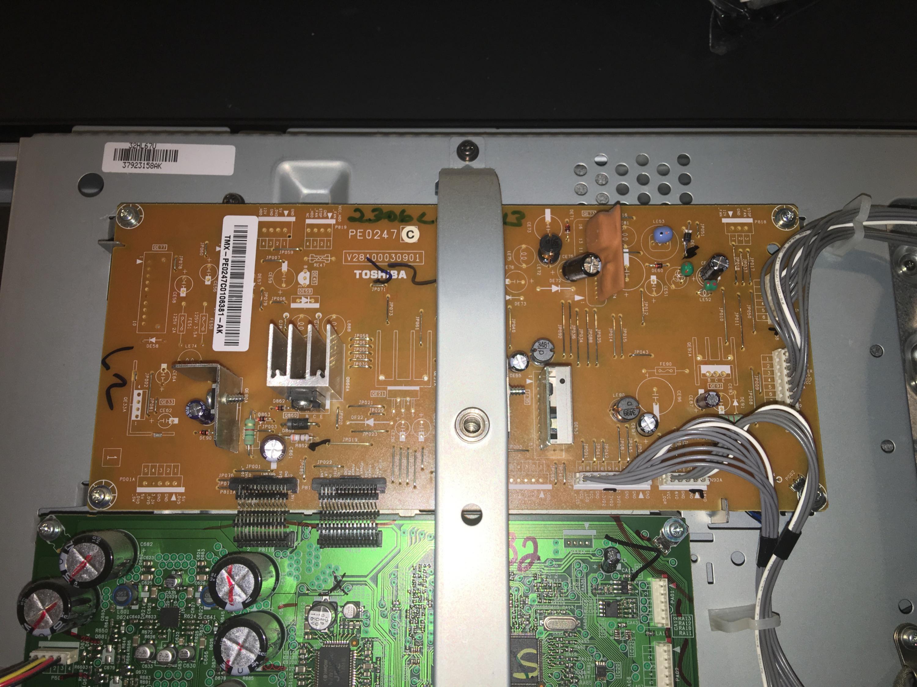

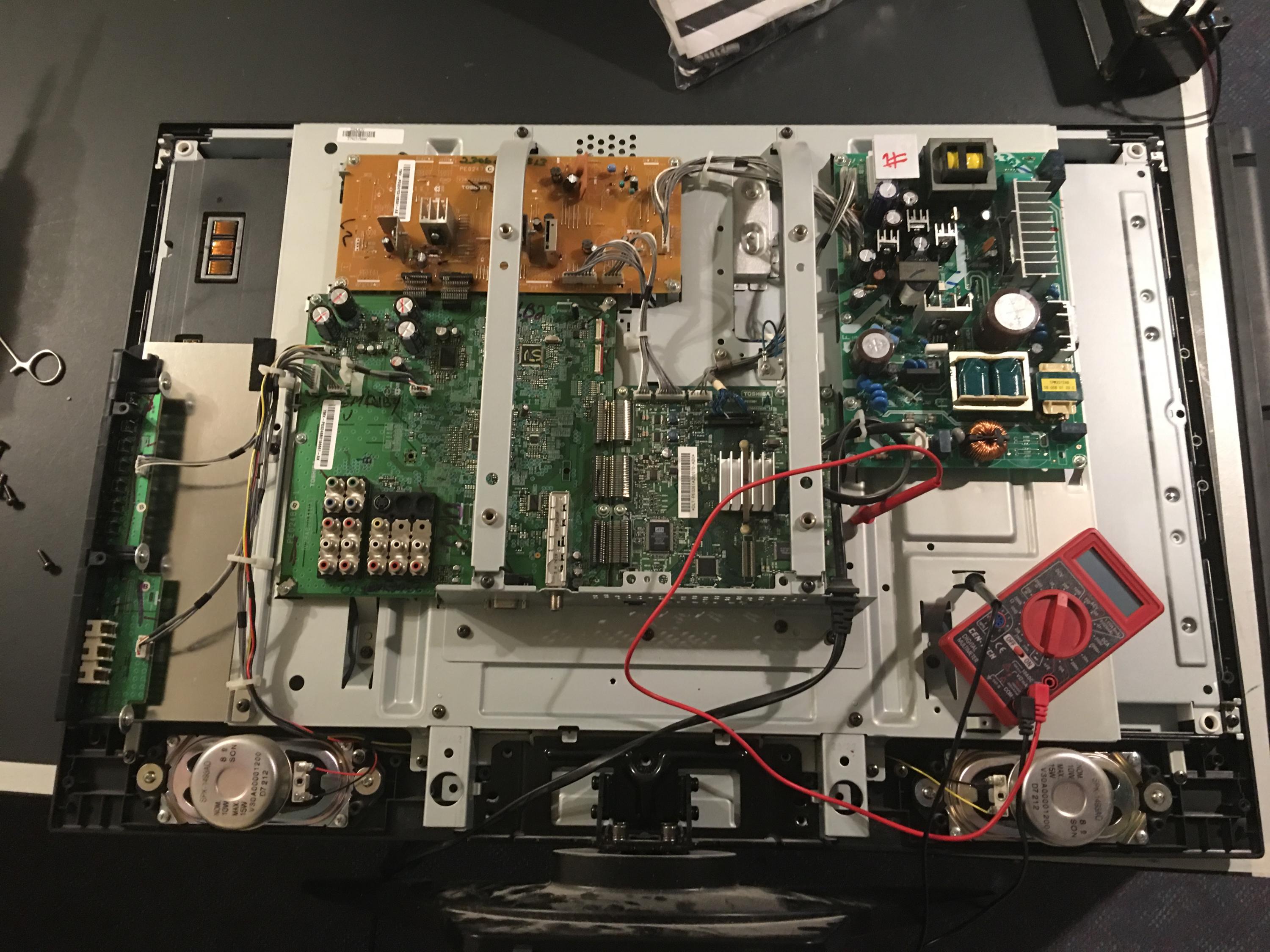

                          Finally was able to open the tv and test voltages. Here is an overview picture of the boards.
                          And a better overview:

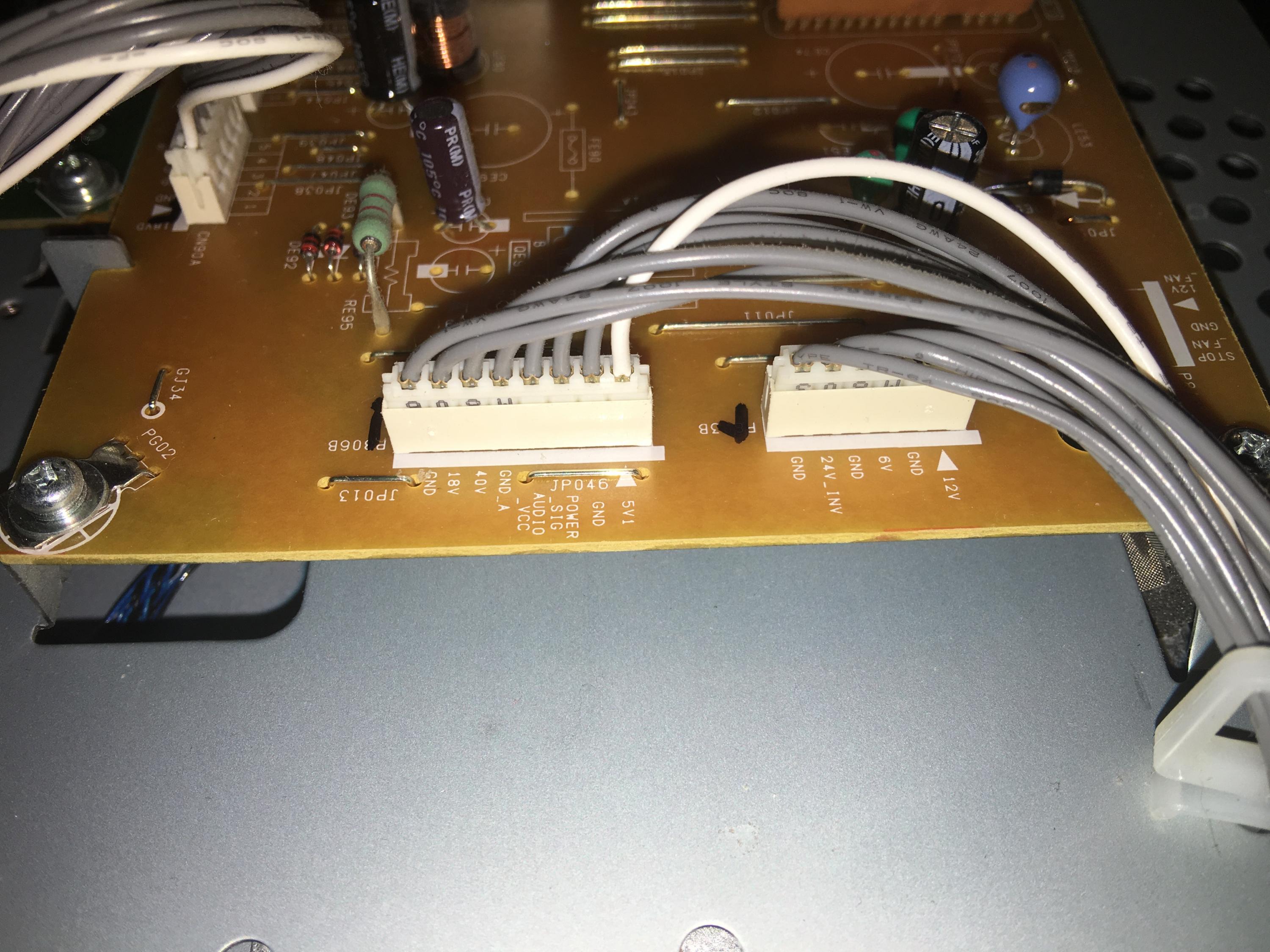

                          I started testing with the leftmost connector located on the top orange board (the cables, not the metal part connecting boards). Here's a picture of the orange board itself:
                          And here is the connector itself.
                          Here are the voltages on the connector:
                          VCC_LCD....5.1V on, 0 off
                          3.3VD2.......3.41V on, 0 off
                          3.3VD1.......3.41V on, 0 off
                          and on the next connector:
                          VCC_DDR....3.41V on, 0 off
                          6VD............6.39Von, 0 off
                          18VD..........19.61V on, 0 off
                          These are the next connectors. They are located vertically on the rightmost side:
                          18V............19.61V on, 17.97 off
                          40V............44.9V on, 42.4 off
                          Audio_VCC..28.7V on, 0 off
                          Power_SIG..3.28V on, 0 off
                          5V..............4.91V on, 5.00 off
                          24V_INV......23.9V on, 0 off
                          6V..............6.43V on, 6.46 off
                          12V.............11.87V on, 12.17 off
                          On the inverter, I only tested the VCC pins. They were all 23.9 volts

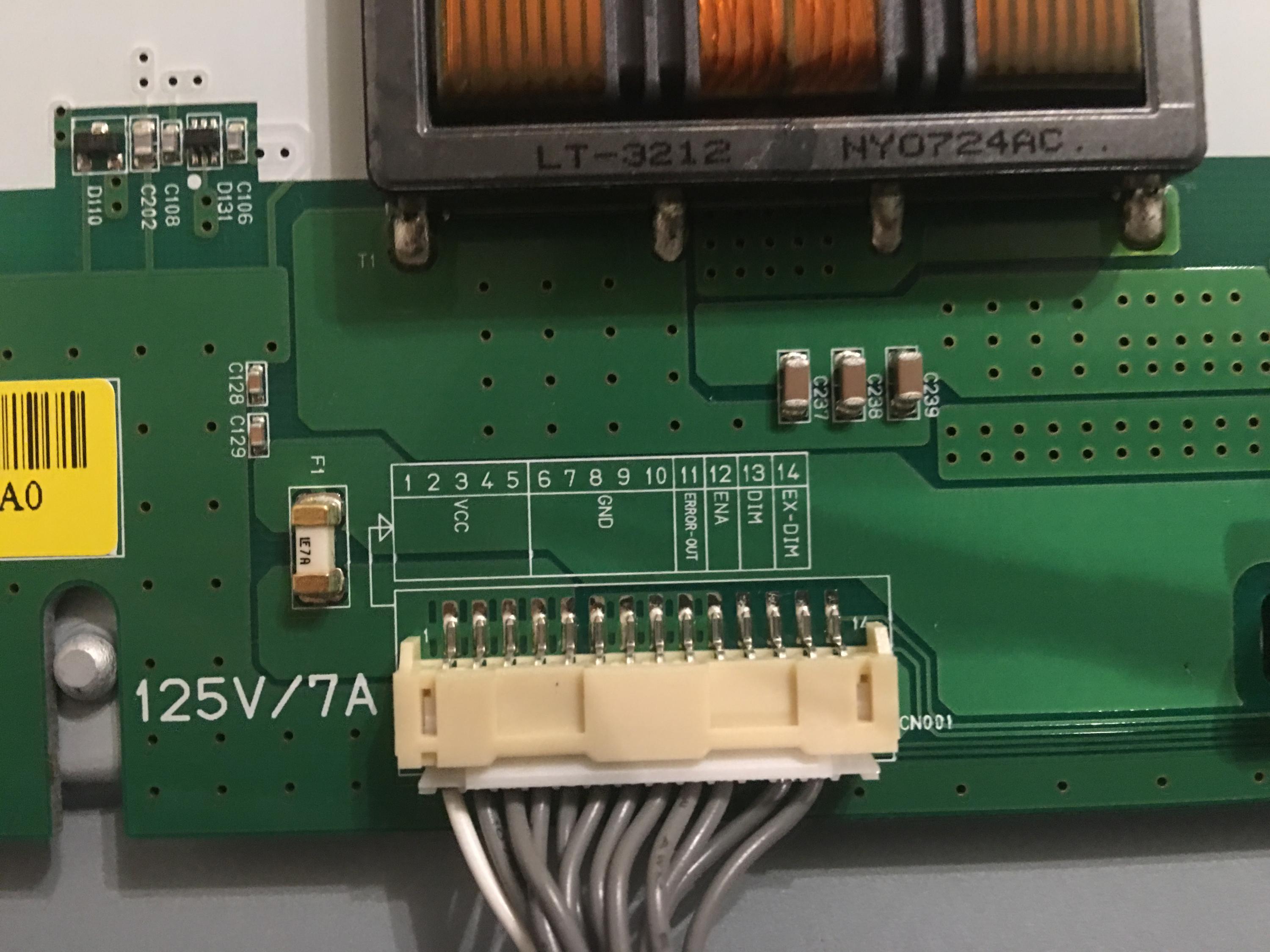

                            'I briefly looked at it and only saw one fuse, that had no resistance, so I assume it is good.'
                            Do you mean the resistance shows <1 Ohm, right?
                            You should have 24VDC at both ends of the fuse with ref. to the chassis if the fuse is good.
                            https://www.badcaps.net/forum/attach...8&d=1471577178
                            What DCV do you have on pin 12: ENA (same as BL-ON), and pin 13: DIM?
                              Fuse shows 24V (23.9V) on both sides.
                              Pin 12 (ENA) is 4.48V.
                              For kicks I tested pins 11-14
                              14...3.11V (EX_DIM)
                              13...3.36V (DIM)
                              12...4.48V (ENA)
                              11...0.01V (ERROR-OUT)
                              Pins 14 and 11 do not have a wire corresponding to them on the cable.
                              Thanks for your help!
                                OK, you have all the correct Voltage and signals for the Inverter board to function, so you need new inverter board or you can try fixing it down to component level.
