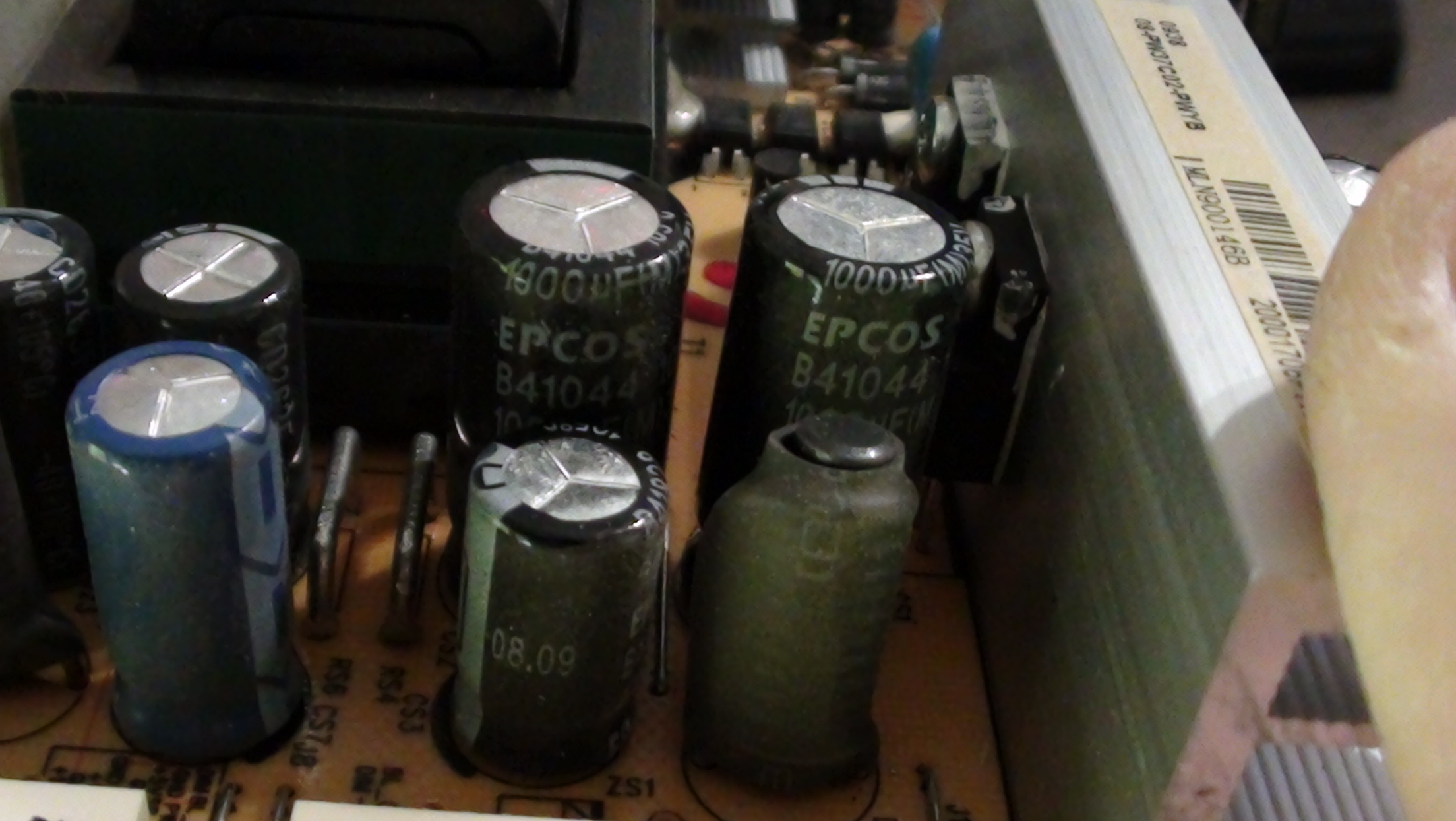

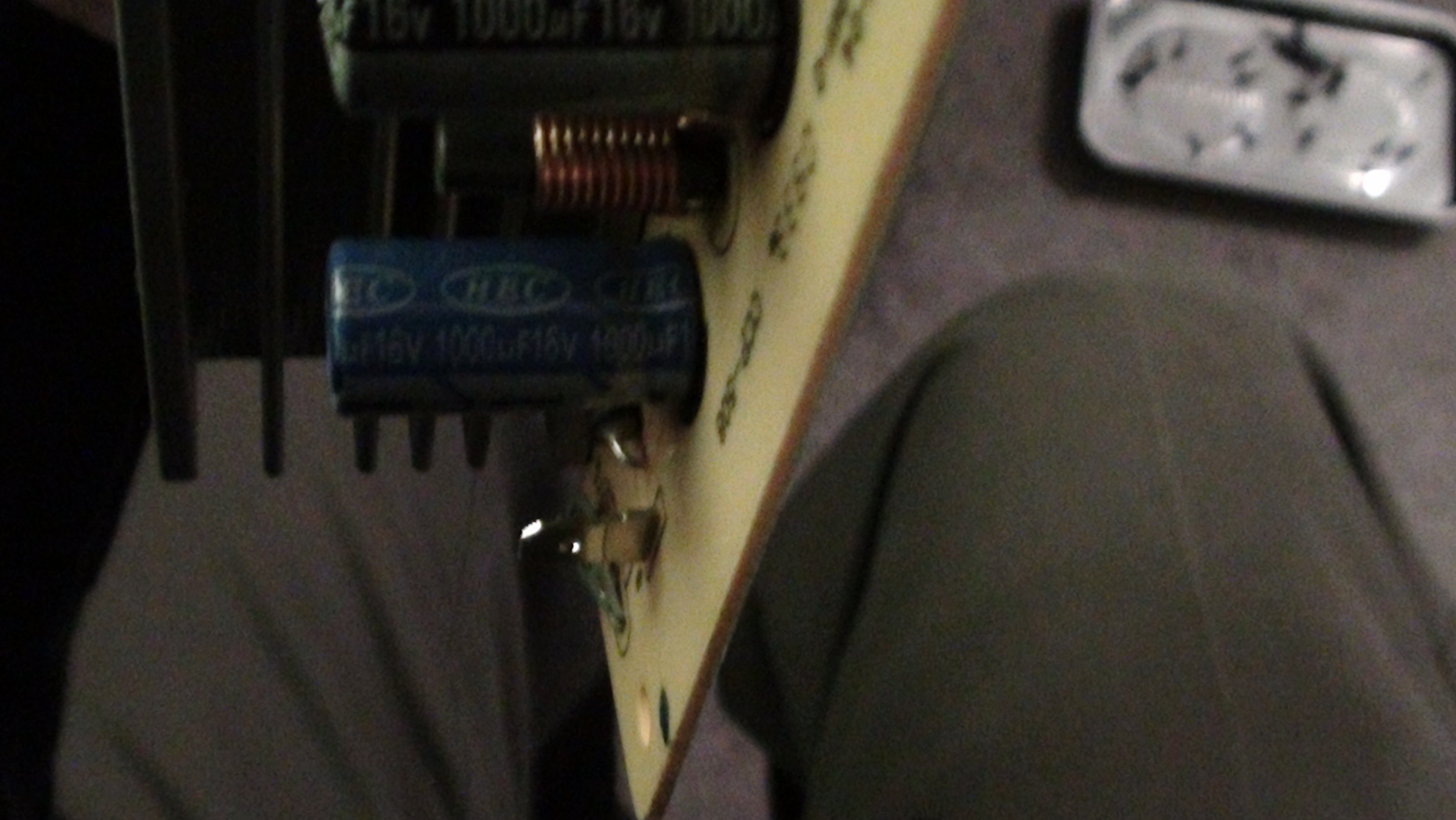

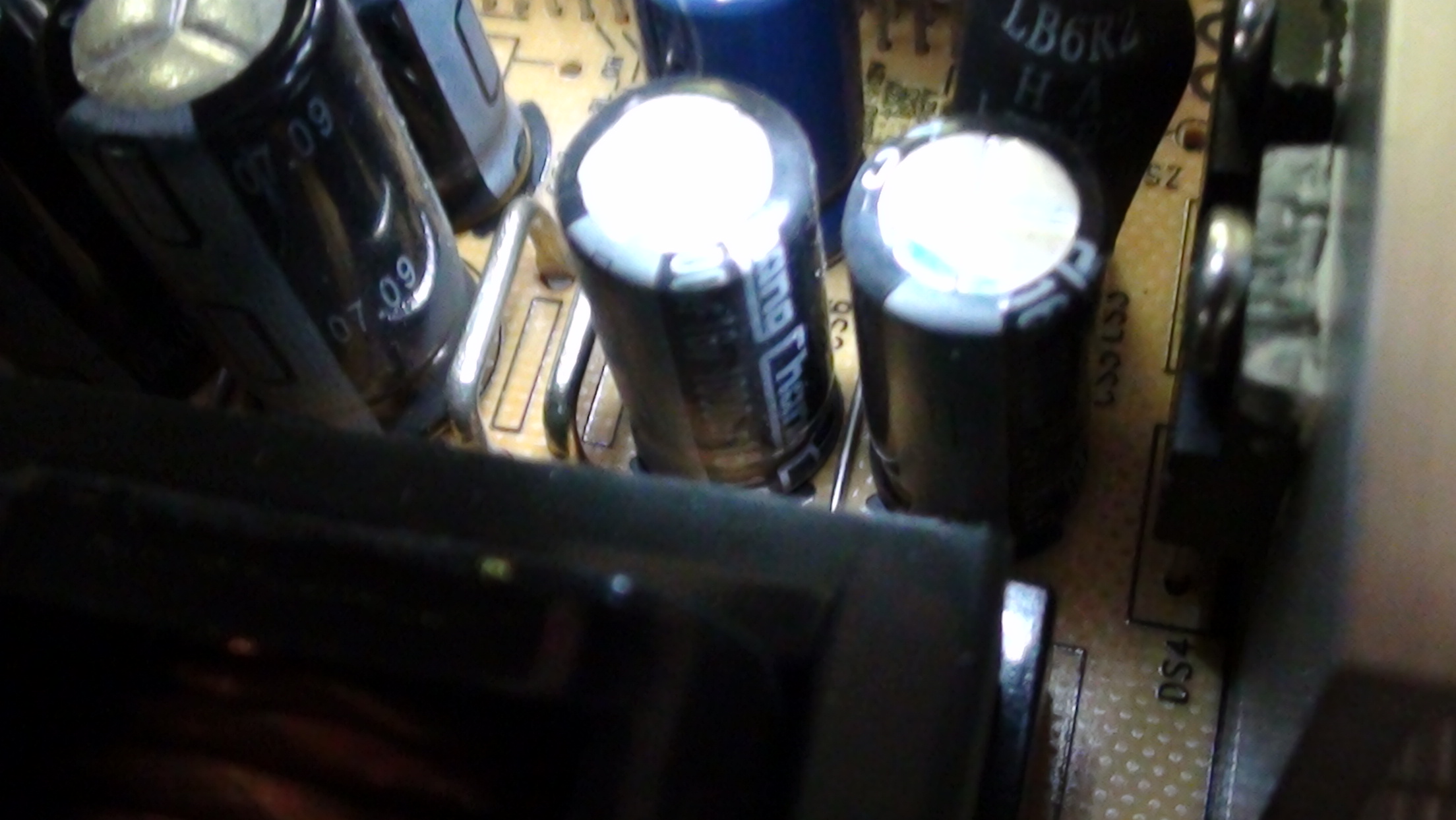

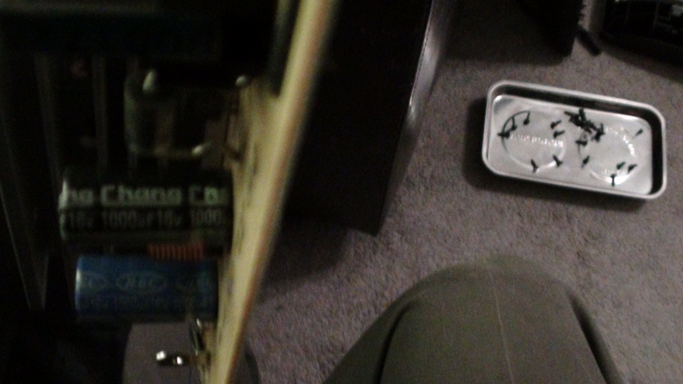

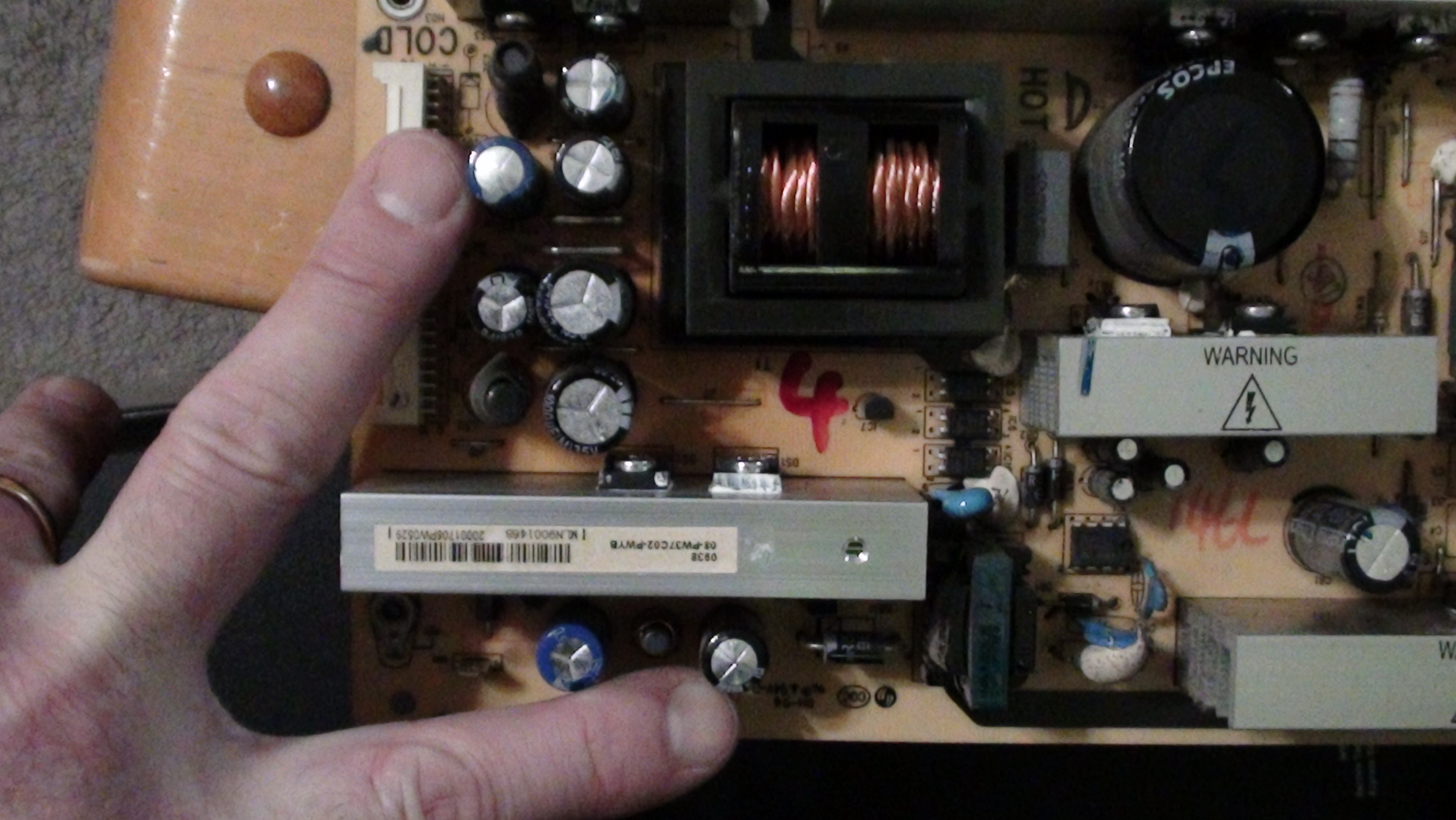

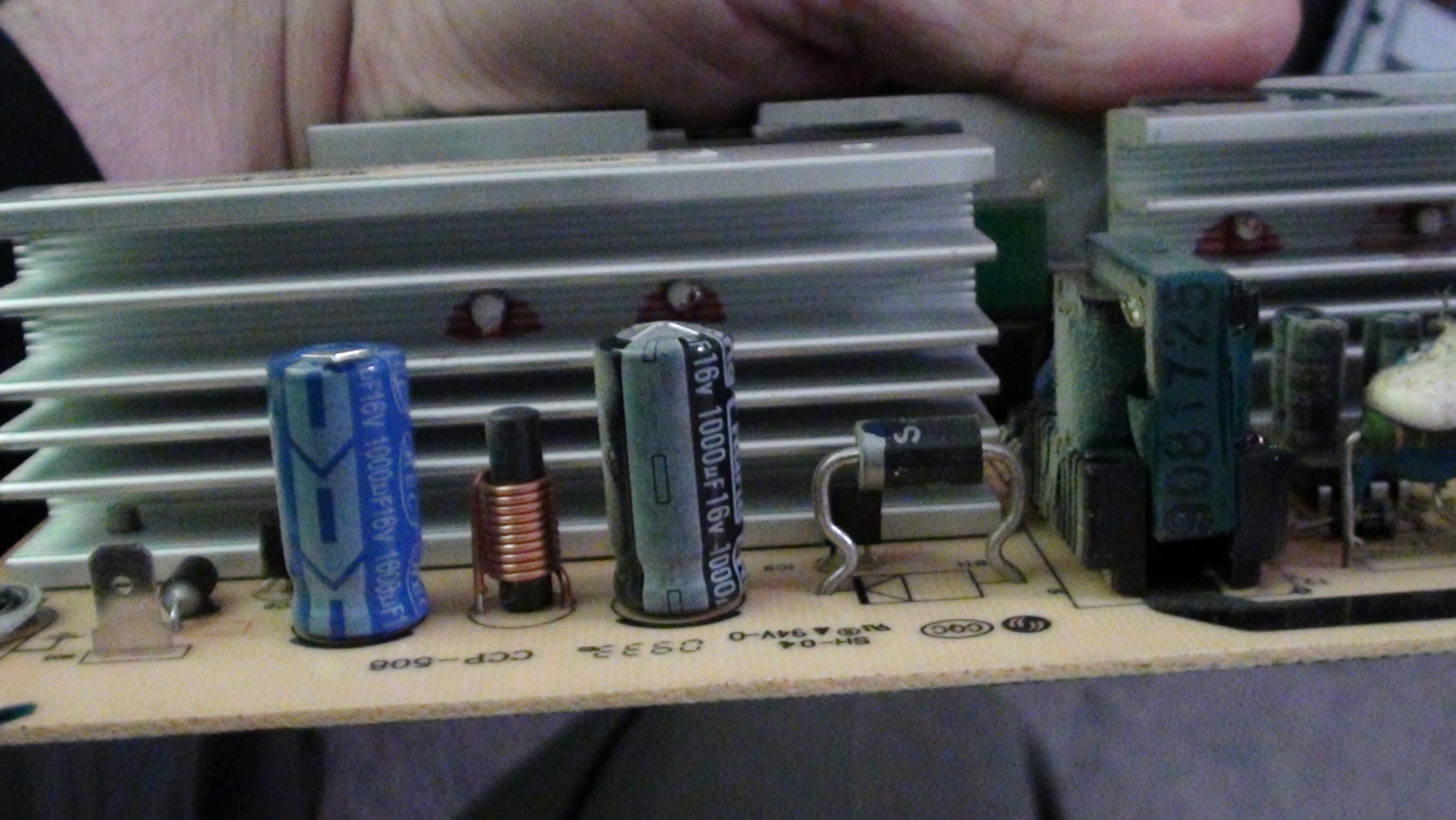

    I have an RCA L40FHD41YX9 that isn't working. I tore it open and two caps were physically buldging on the PSU. I replaced them and a good cap with some Panasonic FR series caps. I thought maybe that'd fix it. I hook up a video signal and I get nothing. It's like the backlighting isn't kicking on. I see a wire going to the inverter board that has a bunch of pins. A good amount of them in a row are labeled 24v, the other ones are labeled (in a row) gnd. The 24v's all seem to check out and measure around 24v. I pulled the cover off the inverter and checked the four caps. They seem okay.
    Does anyone have any suggestions on what I should check? I can post nicer pictures. I was just hoping someone might be familiar with this system and just be like oh, you should check the blah pins and see if you get blah voltage, if not, check the blah and see if it's broke!
    Thanks!

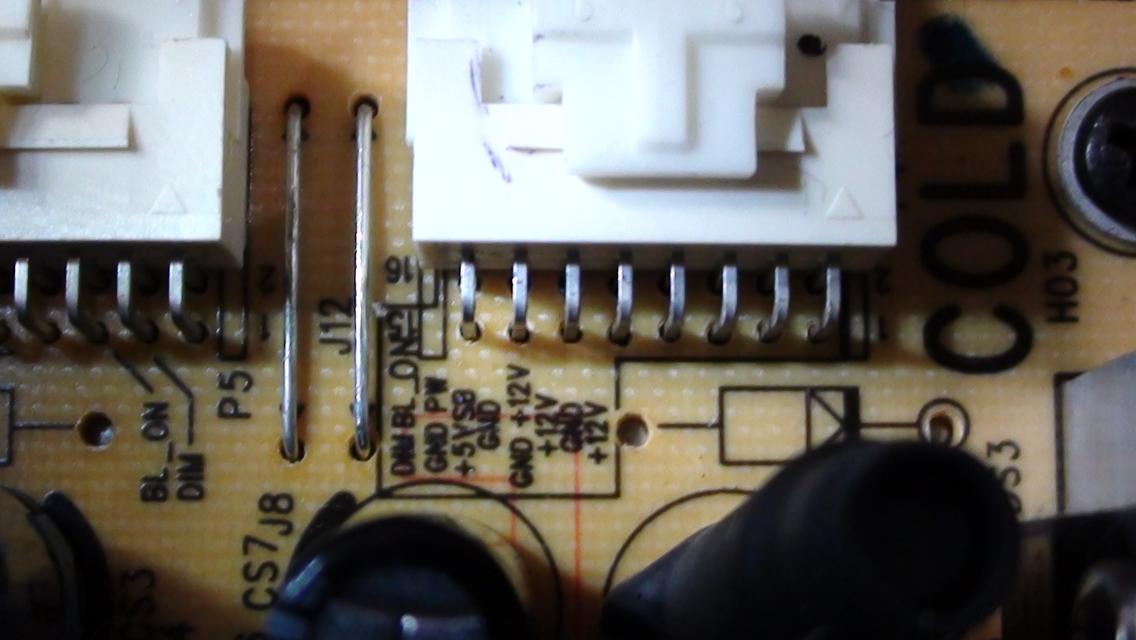

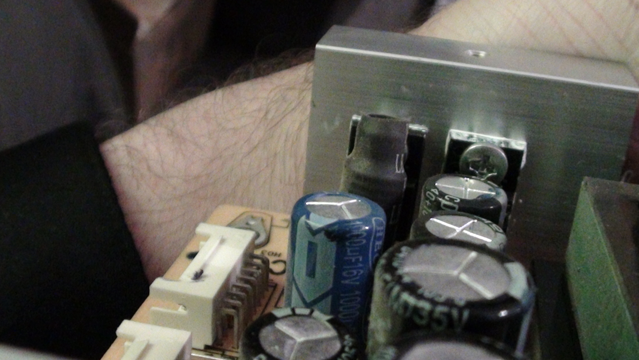

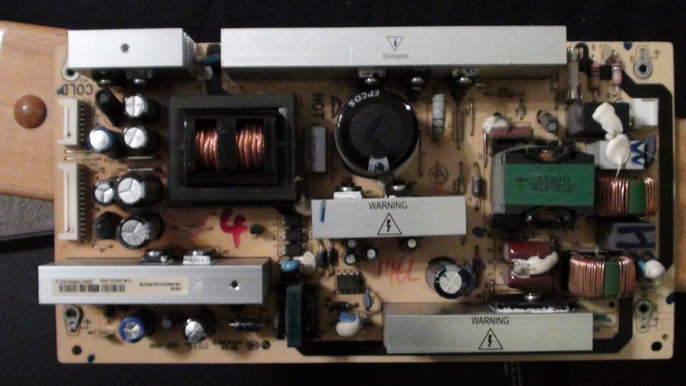

      I knew it! Thanks Budm! So, I'm going to show pictures of the main board and maybe you can help me figure out which signal is the BL_ON. I had found where it was listed on the silkscreen or whatever it's called but I couldn't figure out which pin it actually was.
      It's hard to see, but on this pin, on the PSU, there's actually two layers. I'm sure you know that though. I can't figure out how the labeling on the board goes. Is it the pins in the back or the pins in the front? If that doesn't make second, I can try to explain more with more pictures.

        Measure the DC V of BL_ON.

          Right, but which pin is the BL_ON? I tried that last night but there's a back row of pins there. And I can't figure out if it's the front row or the back. The printing on the board isn't exactly clear there.

              Besides the connector that has the 24v and GND connections, there's a 4 pin wire on the inverter. It lists four connections, SYNC, N.C, N.C, GND. Would that be it?
              For the main board, I can measure the front pin and the back. Maybe we can assume because BL_ON is listed last, it's going to be either the last pin in the front row or the last pin in the back row there...

                  Re: Broken RCA L40FHD41YX9
                  https://www.badcaps.net/forum/attach...9&d=1464795581
                  P5 BL-ON.

                    Dang, I was looking at the wrong one! I thought for sure the other one that had the BL_ON it was it. I thought the words were just mashing together.
                    I measured it, 4.01VDC.

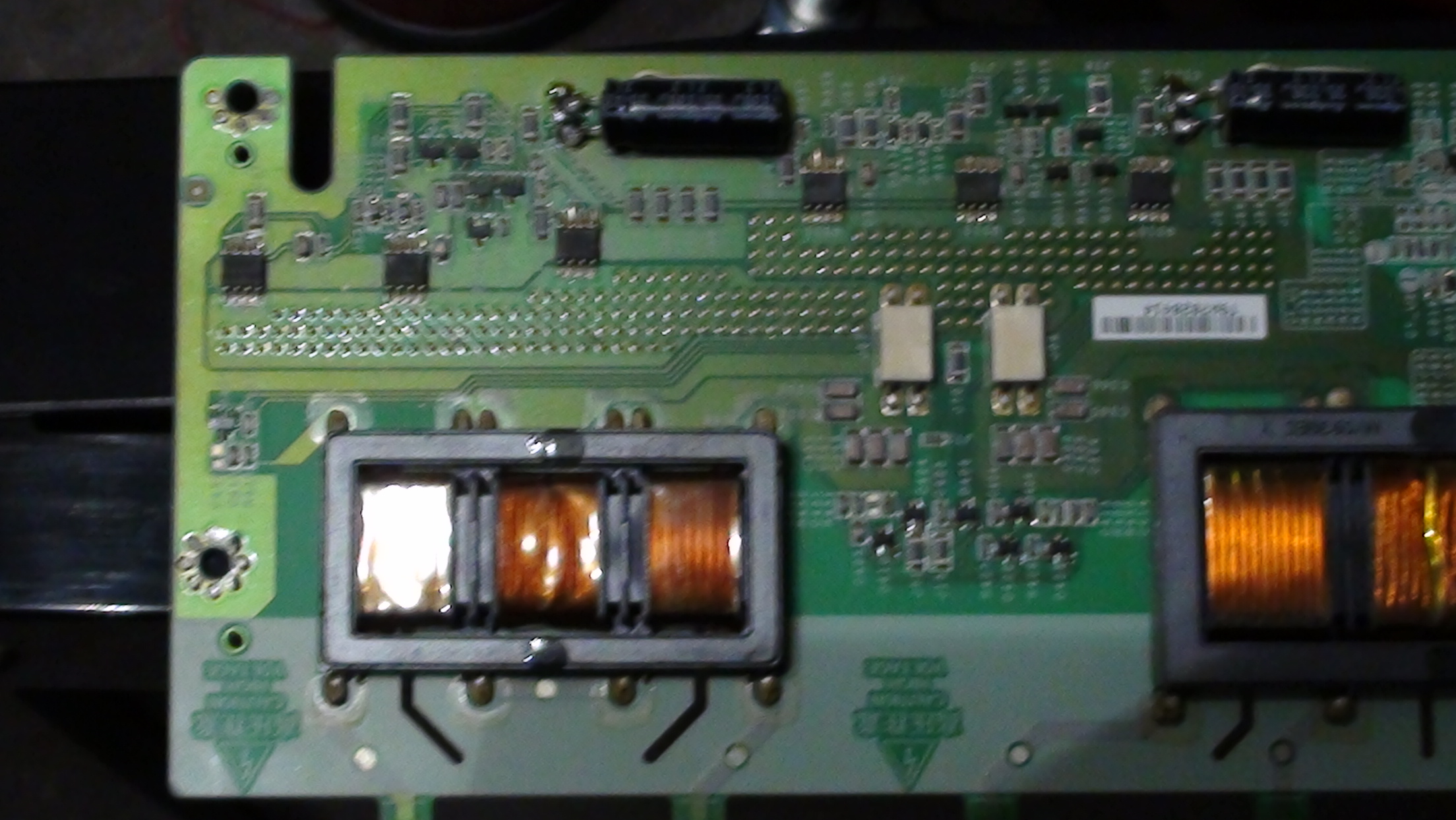

                      Do you still want pictures of the inverter board? I'm thinking if it's getting the 4.01V BL_ON, then maybe the inverter board isn't working right. What do you think?

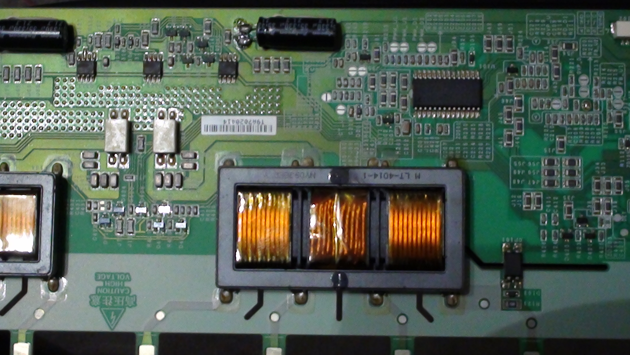

                        Since you have BL-ON then we do need to see the inverter board and also the whole backside of the TV that shows all the boards.

                          Them bad caps probably blew the fuse on the inverter. Get us some images of the inverter please.

                            Do you guys still want pics of the boards? ReeceyBurger123 was right. I didn't think any fuses would be on the inverter board but sure enough, two 1808 SMD 125V 7A and one of them has infinite continuity. I'm going to order a couple.
                            Should I replace them and then test it or keep testing stuff and when I get everything tested, place an order?

                              Possibly shorted mosfets too. Can we have images please ?

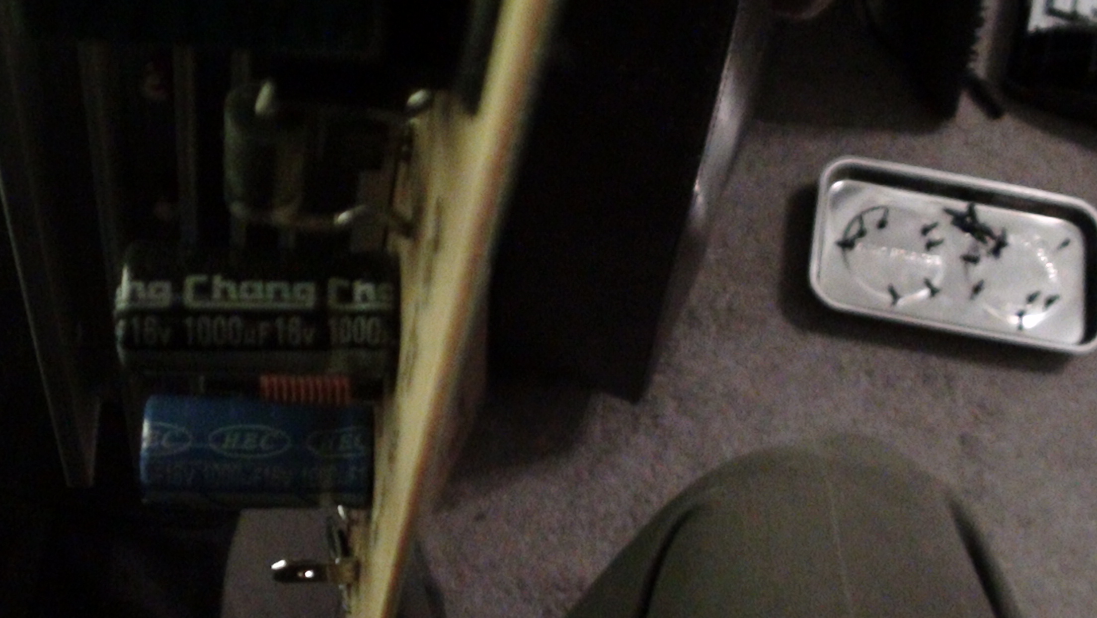

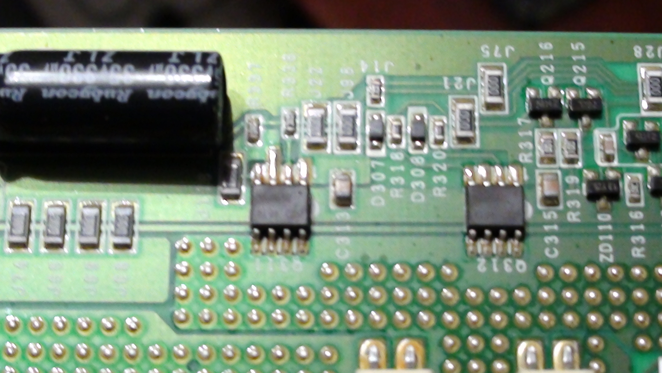

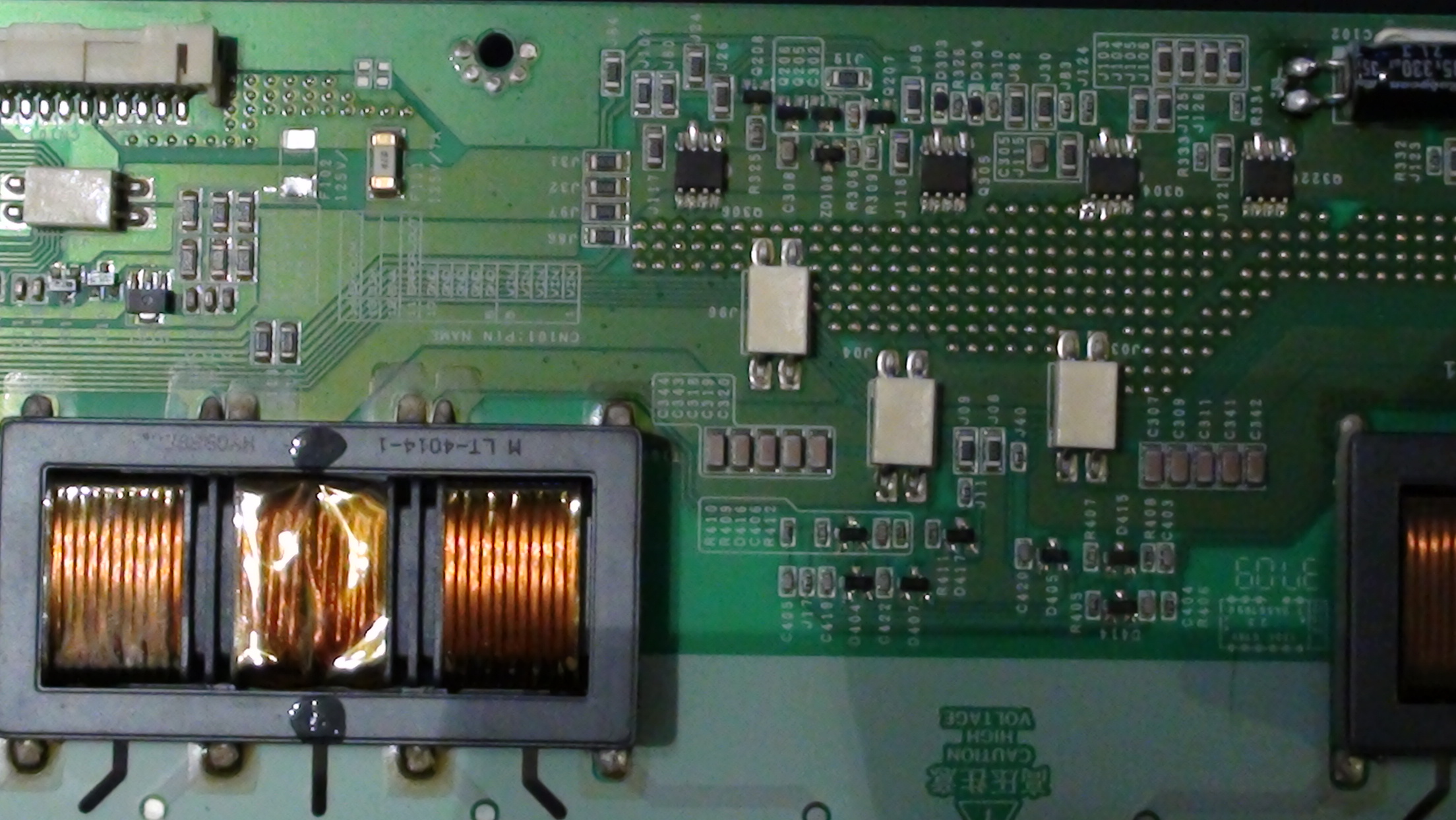

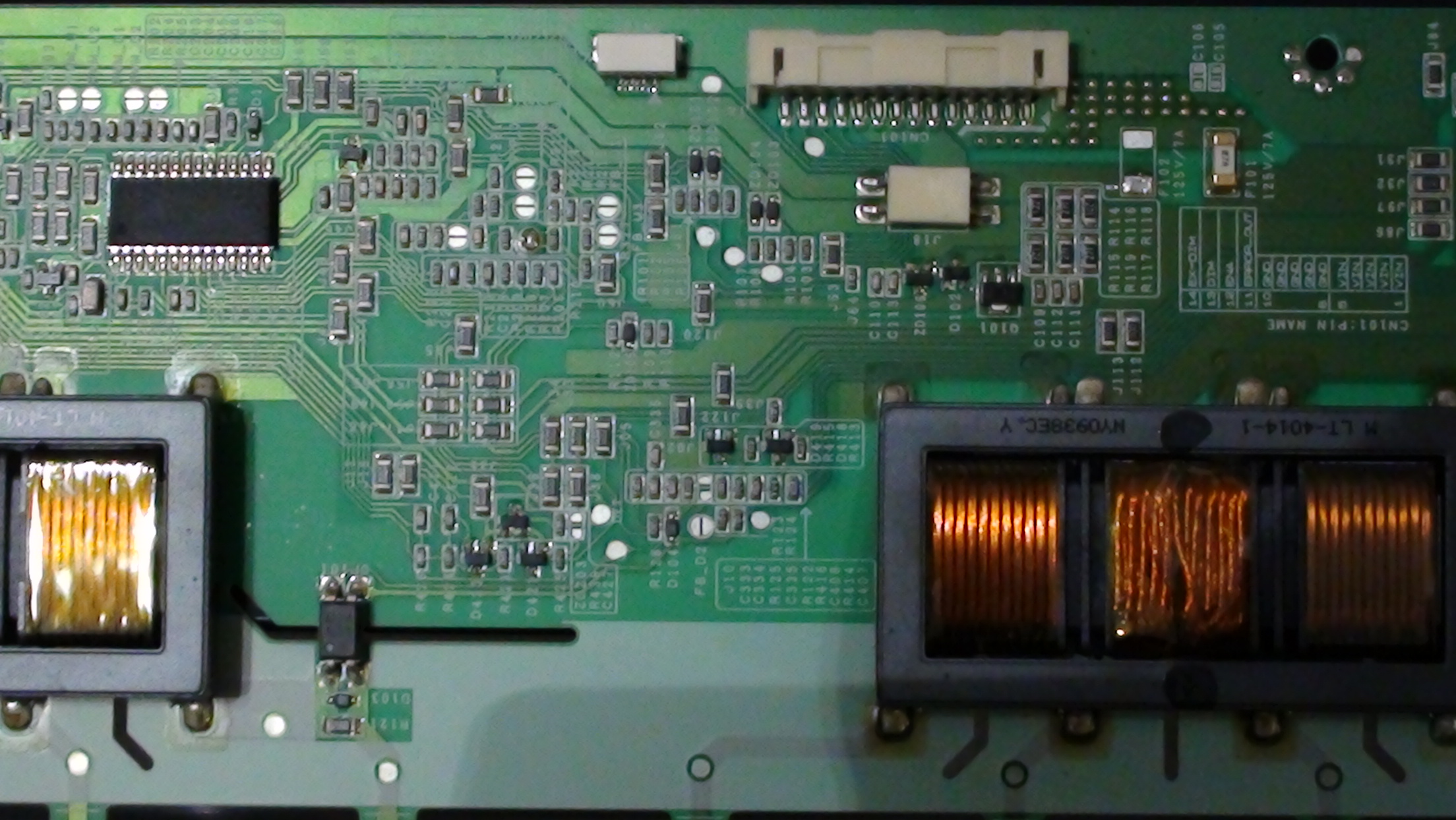

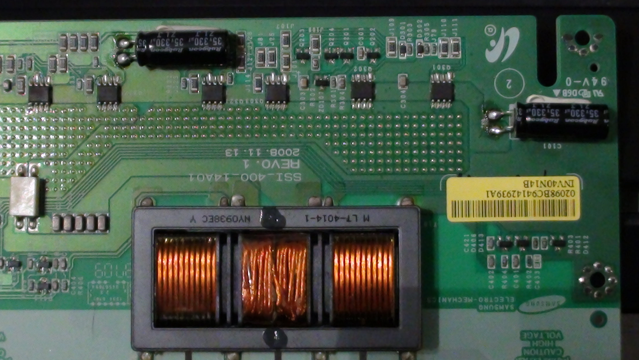

                                  Here's some pics...it's a bit awkward to take pics of this. I can send zoomed in clear pics of any area that you guys want. Just let me know if you want anything special.
                                  The way it goes is the first five go together, they make up the whole board. Then you see one part of the back, where it looks really burnt. Then you see the front area, around where the burned mark would be, if the burned mark was on the front...

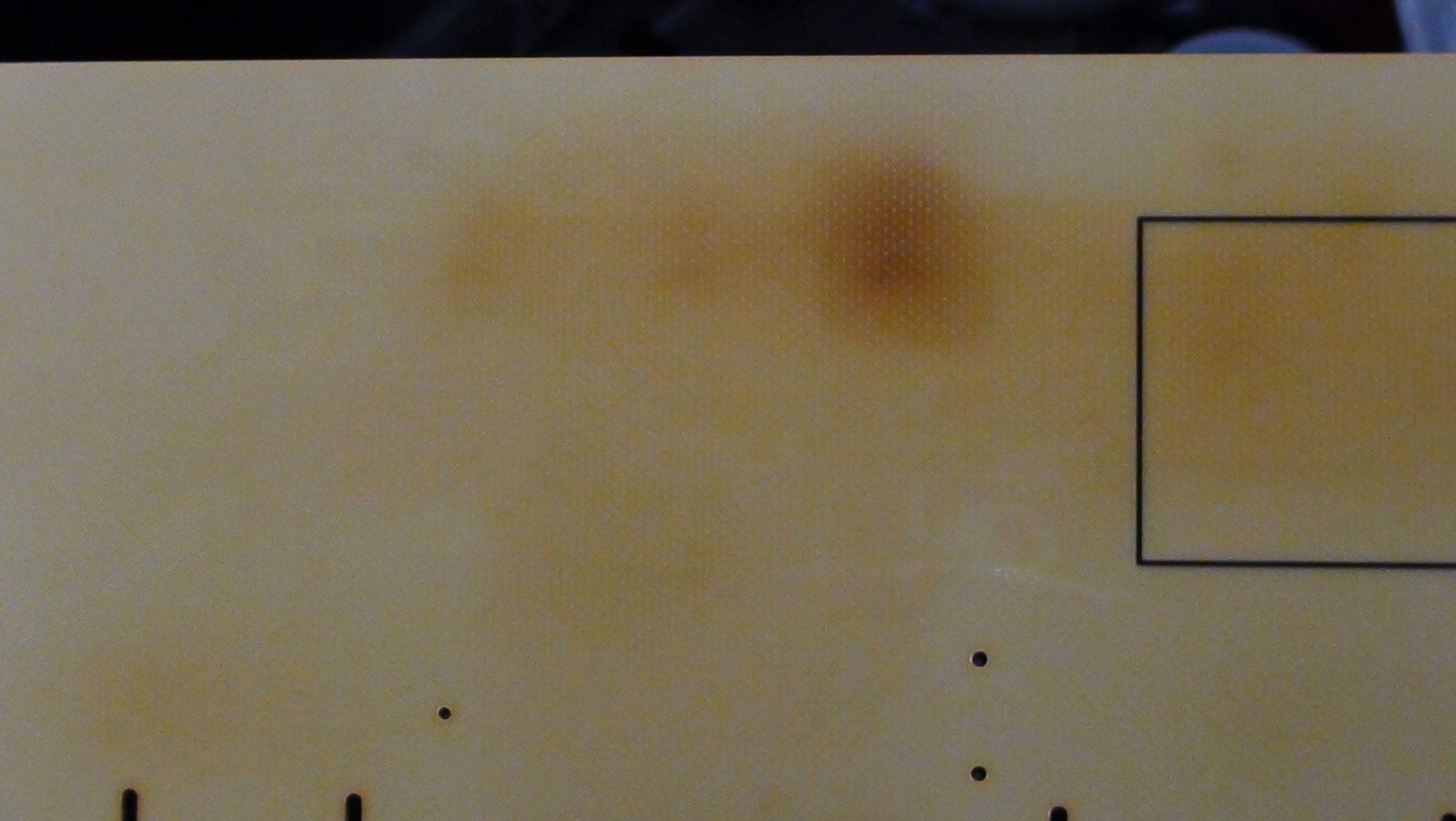

                                      Get the new board:
                                      http://www.shopjimmy.com/catalogsear...CA+L40FHD41YX9
                                      That burnt mark is the clue, it is another of those SAMSUNG board,
                                      Samsung LJ97-02098A

                                      • Spork Schivago
                                        • Mar 2012
                                        • 4734
                                        • United States of America
                                        Originally posted by budm
                                        Get the new board:
                                        Samsung LJ97-02098A
                                        They're out of the Samsung LJ97-02098A but they have a rebuild kit, which I don't really want. Can I use the LJ97-02098B? They're out of the 02098B as well. They also sell a repair kit for that. I'd like to know so I can check on other sites. Thanks!
