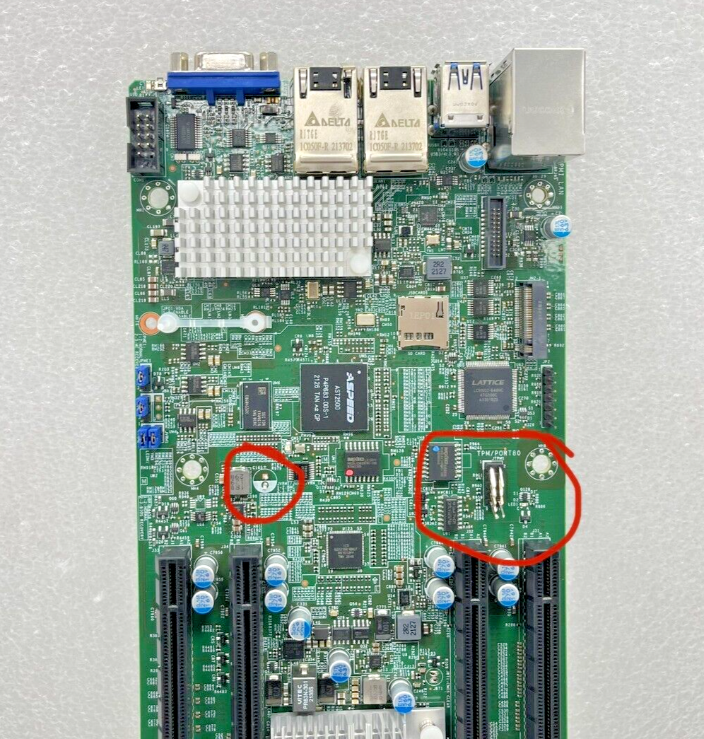

    Last year I bought a server. It's worked fairly well but had some issues. Some pcie slots didn't work and Xeon v4 is a bit slow and missing AVX 512. Came to realize that the next version up, with skylake uses mostly the same chassis.
    A board popped up on ebay one day being sold for parts. A working board like this is over a grand at best. This particular one was about $125 and I decided to gamble.
    At first it seemed simple enough. According to the description it looked like some mechanical damage.

    Found the missing 560uf cap and thought I was set. Ordered the processors/heatsinks and cables I needed for the conversion. I could always send them back, right?

    Figured that I had the component level parts so might as well start. I unbent the TPM pins and got to work on the cap. That's when the problems started. No amount of heat would budge the broken leads. I ended up heating the board with my rework station at full blast while touching the leads with my iron at the same time. They finally came out but sadly the holes didn't clear. I was using temps in the 400s according to the tools and it made me scared I would damage the board.

    I did not try putting in the new cap, for while taking breaks, I discovered more damage. Another cap was similarly ripped off. Still in relatively high spirits, I took off the remnants.

    More broken parts! My confidence sank. I don't even know what those are and looking them up has proved fruitless. I can deduce their values from parts near them. They are labeled 560 with a string of letters below.

    So what are they? Are the 199sz different from the 16DQD? Are they diodes? Coils? SMD caps? Will they be as hard to remove due to the thickness of this board? Finding C8190s value is probably impossible too. Can I ignore it? Bridge it? Can I even get the through hole caps in? I never had this much of a problem on desktop boards or other electronics. The fear uncertainty and doubt runs through my veins.
    At that, will this board even work or is it just treated so badly because it was a no post and garbage? Do I just give up at this point and send back what I ordered like a total failure?

        Well I appreciate the long reply but I think you overestimate how easy it is to just "go to another seller" or even find one of these boards. The system is https://www.supermicro.com/en/produc...4029GP-TRT.cfm and the board is https://www.supermicro.com/en/produc.../X11DPG-OT-CPU
        The only other options for sale at the moment have broken socket pins. I also left it for a month sitting while the weather was bad and I was busy so I can't go back and return the board. Shame on me for not inspecting, I assumed seller wouldn't miss other damage. I was expecting replacing a single cap at worst as pictured. He had lots of pics but not of that part of the board, I think they missed it.
        I do have a rework station and a soldering iron and I turned them up to high temperatures without the cap legs budging. I did not clean all flux off after removal because another cap is going in there, hopefully, maybe. The board itself is 2.5mm+ thick. Those ground pads and thermal mass is huge. I had tried using a small nozzle on the rework station to no avail. Ended up taking it off and running it at full air with no tip. Used both soldering iron and rework at the same time to budge the leads. To clear the holes I will try a little air to heat up the board and a large flat tip with a heated desoldering tool on the other side and see if that works. If only to practice and see if I can. As ugly as it is now, I don't think anything is broken there.
        Hot tweezers won't do me much good here as the diodes? are gigantic, those will need air. Since they are only on the surface I think they will move. I measured them with the diode test and they give .225v fwd voltage so I think they must be those. Unfortunately I still can't find similar parts online. If that's the case I am sunk.

        Its strange nothing comes up for 560 online, nor the letters. The one with the busted off plastic at least measures correctly so it still works. The missing one is well.. missing and it's by CPU2. I can attempt to run on 1 CPU and with the mechanically damaged one maybe, but I feel like I would just be taking my working server apart and doing work for nothing.

          I would use low melt solder and a decent soldering iron to remove those components.
          That looks like a Panasonic SP-cap 560uF

            Thank you. On image search they look to match up. I will attempt to order some equivalents. I think those will come off much easier than the through hole. There is some hope yet.

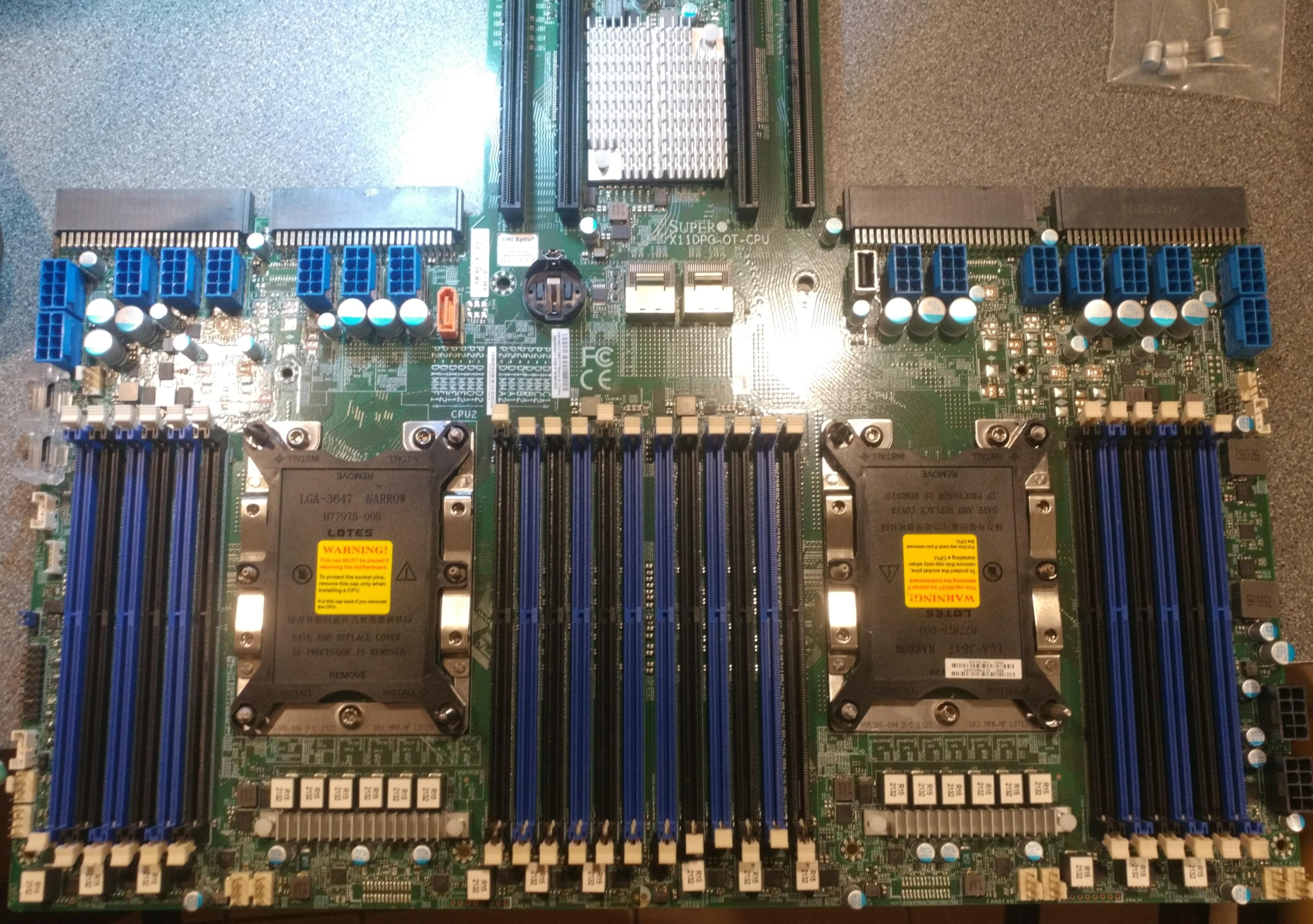

              When life gives you lemons:
ID:	3211993Click image for larger version
ID:	3211994Click image for larger version
              The board starts up and works. Unfortunately, I think I found the reason it was removed from production. No GPU will power from it. The server refuses to start. When I measure the power connectors they all output like 11.9 volts. I can't find any shorts either. It's like under load it's not enough current and whatever distributes the power fails. Since the business end is fine, I just externally powered my 4 GPU and am testing it. Still needs resizable bar and there isn't much more memory bandwidth than the broadwell board.
