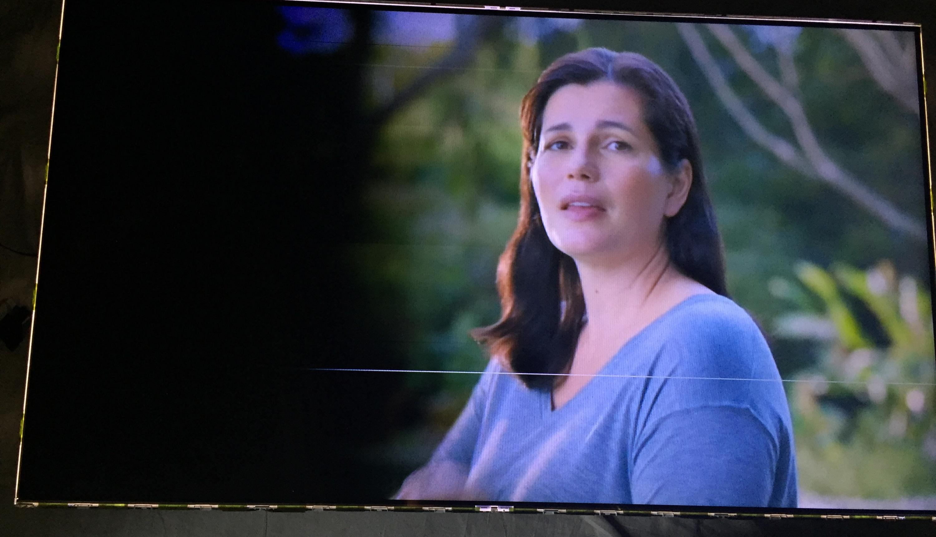

    Hello. I have a vizio m601d-a3r with a sharp panel. Trouble is a few horizontal lines and left side is quite dark. Backlight seems ok. I have tried cleaning/reseating the ribbon cables, but no change. Tab bonds don't seem to affect the picture either.
    I am thinking bad panel, but want to get your opinion on whether you have seen this kind of failure with a tcon.

    Horizon line like that will be the panel.

      Thanks--I was thinking the panel also (gate drivers). I have read the long 70" vizio thread about removing gate drivers on one side. Not sure it applies to this panel, I might pull off the gate driver chip tab on the bottom of the left side just to see what happens.

        Deffo panel failure. Try removing tabs but doubt it will make it any better.

            I don't see lines from your picture you posted. Looks like it could be the left side LED strips going out.
            If you were to remove the panel, can you see if the left LED strip lights up?

              Look closer lol, horizontal as well.

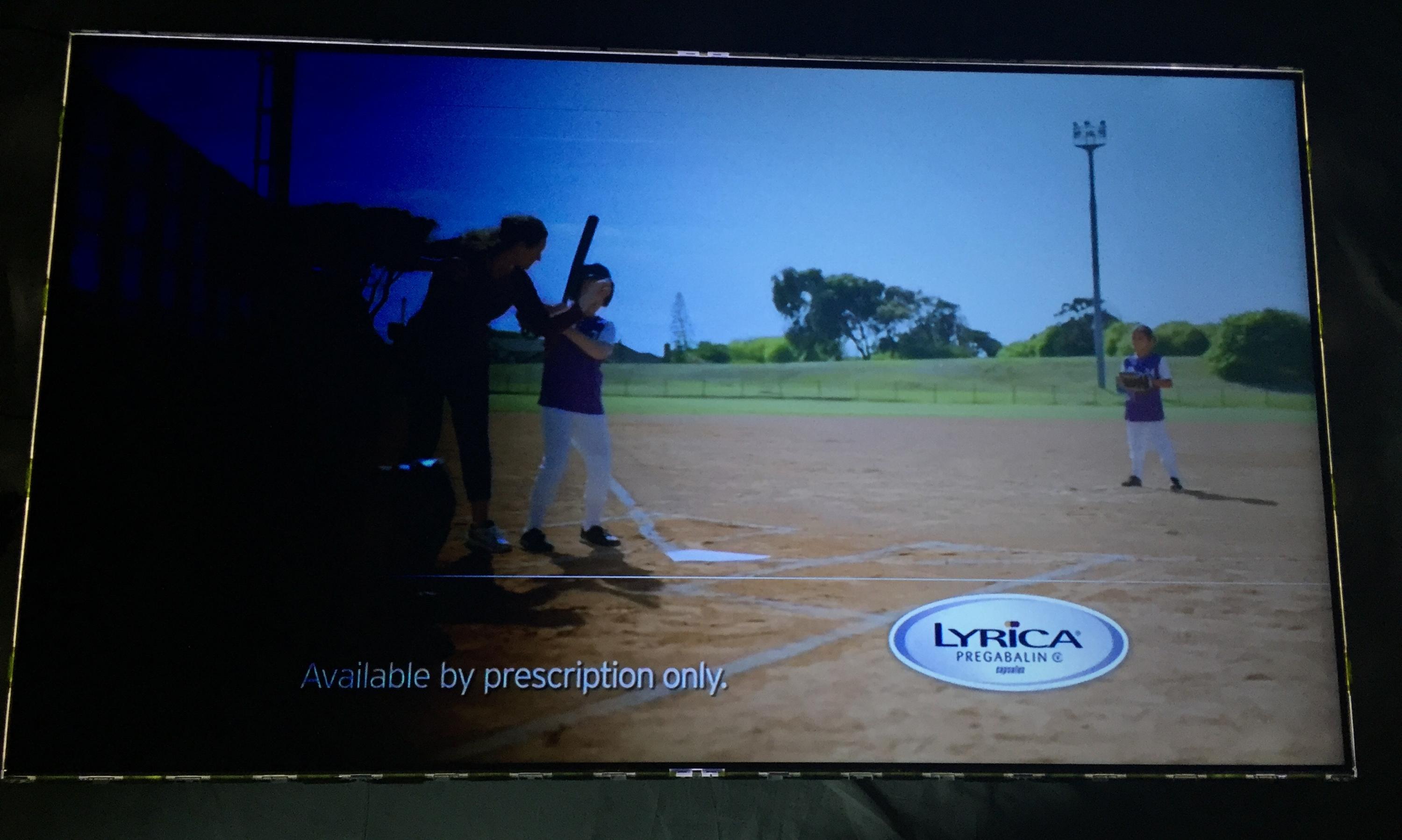

                Oh yeah that first picture the white line looks like its part of the commercial but second picture I see what you are talking about.

                  Yeah he did say the Bl seems fine, I presume he meant on that side

                    Yes--backlight is uniformly illuminating. I was hoping from the original description of the problem that the "darker on the left" description was a backlight problem.
