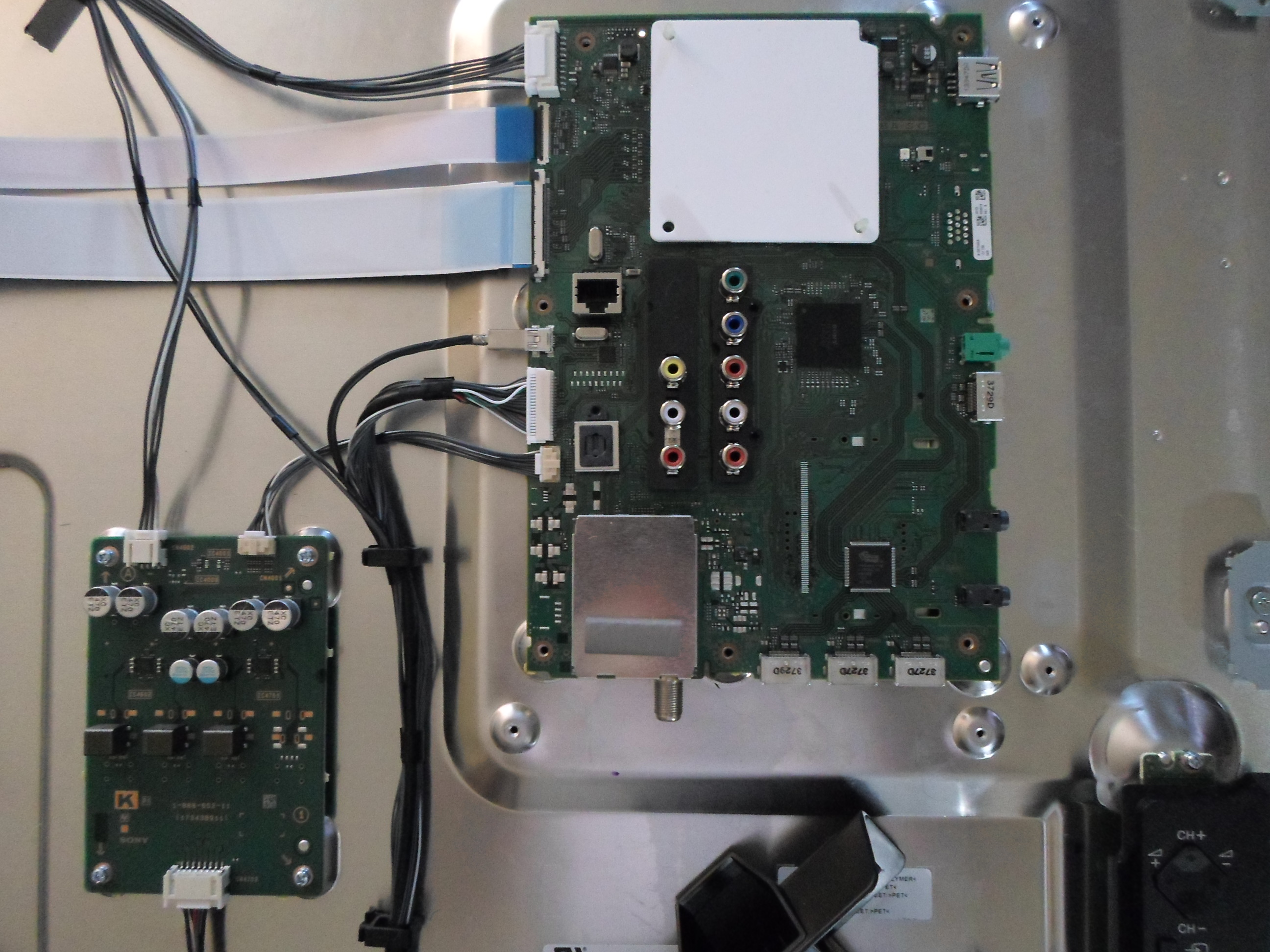

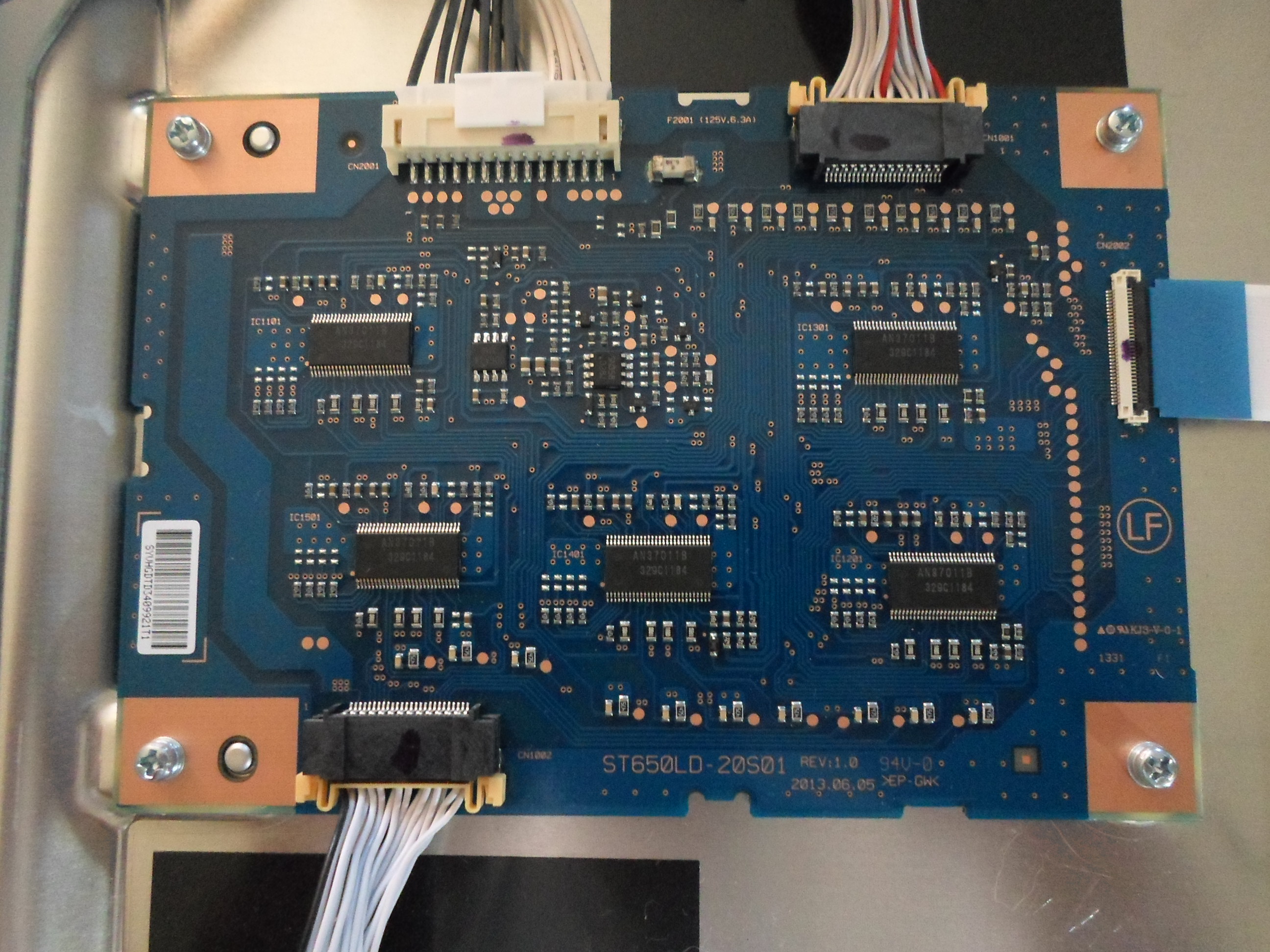

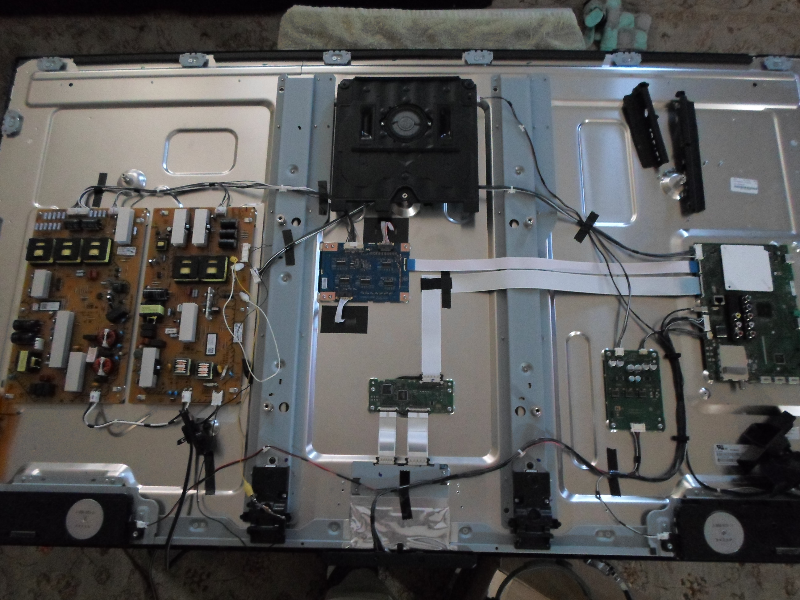

          #44
          Re: Sony KDL-65W850A Dead

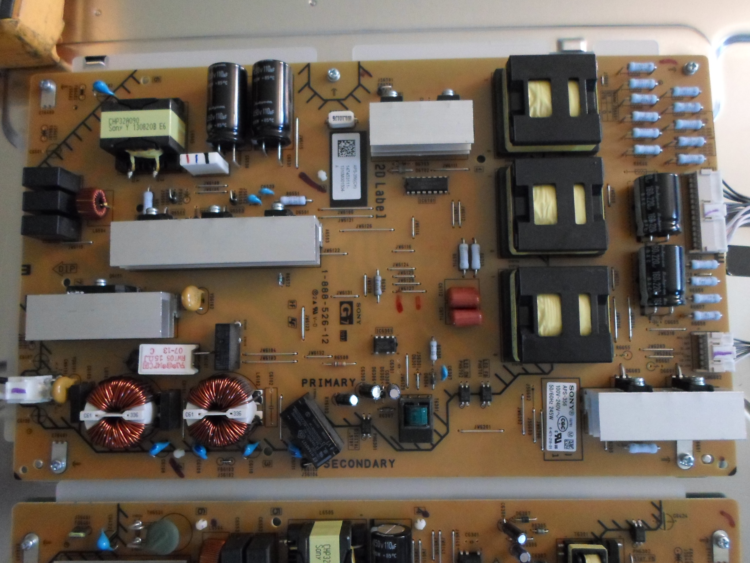

          Here's a few more pics, I'll be back in a few mins, thanks for the help!

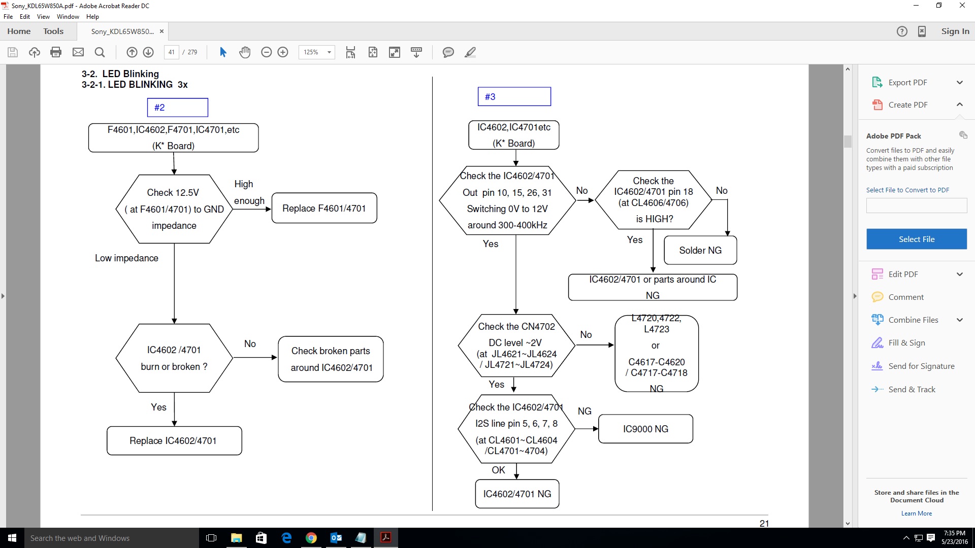

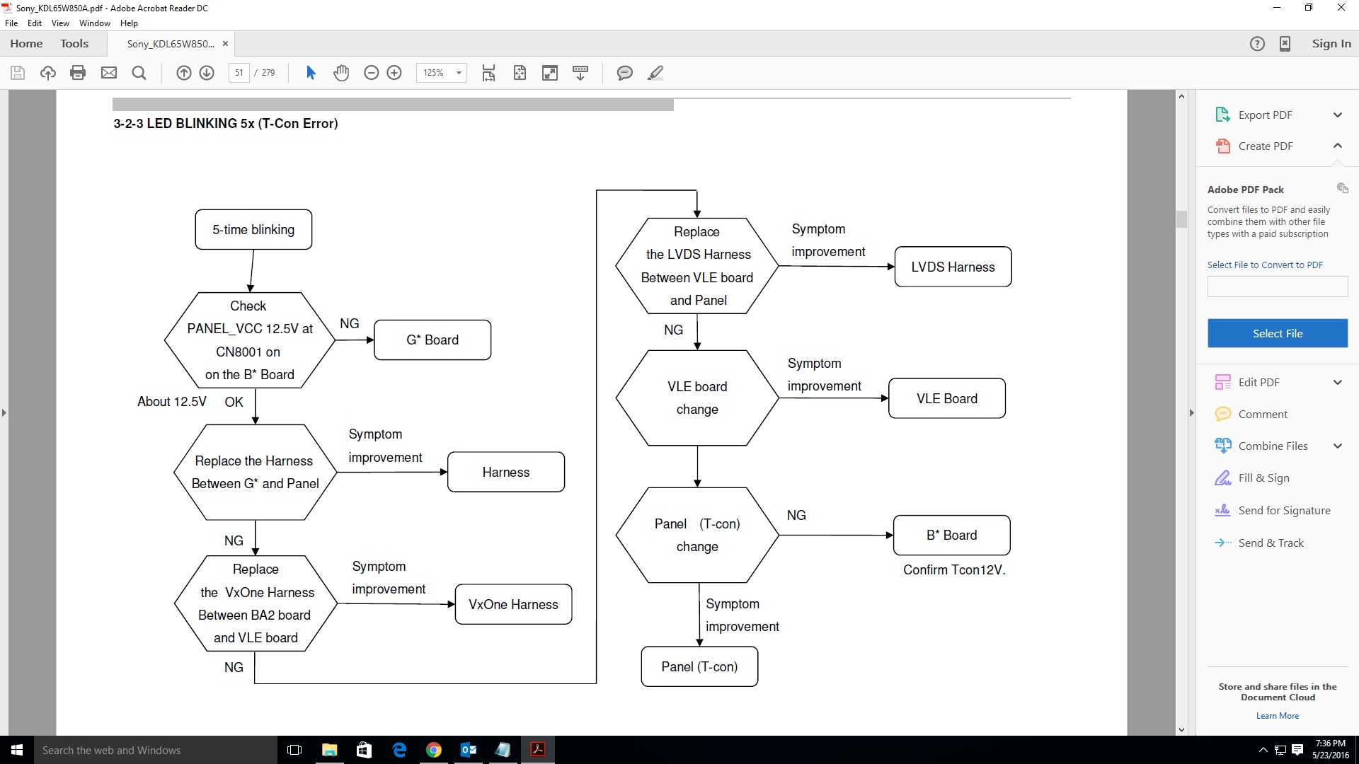

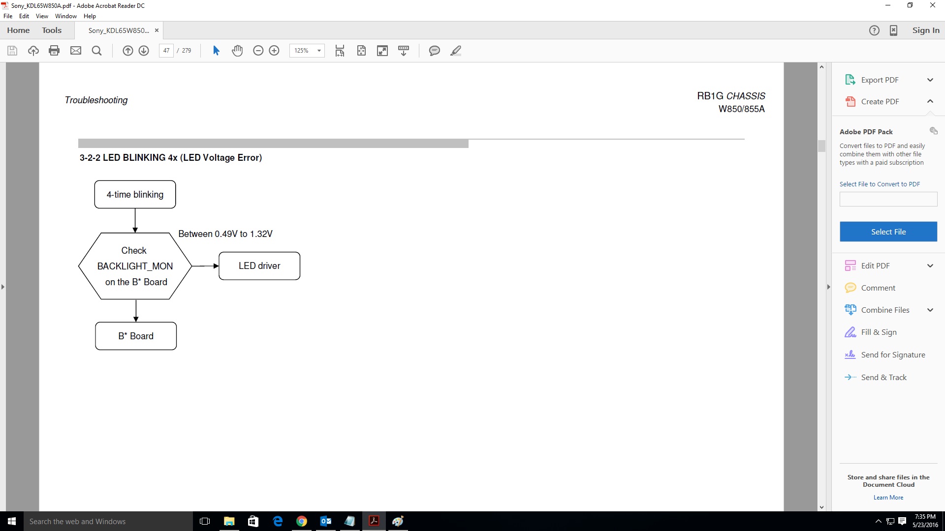

              #46
              Does the SM say anything about blinking LED Error codes?
              • kevinm34232
                • May 2012
                • 1884
                #47
                Yes there's quite a bit, more than this... I get no LED flashing at all though.
                • kevinm34232
                  • May 2012
                  • 1884
                  #48
                  [Service Manual]

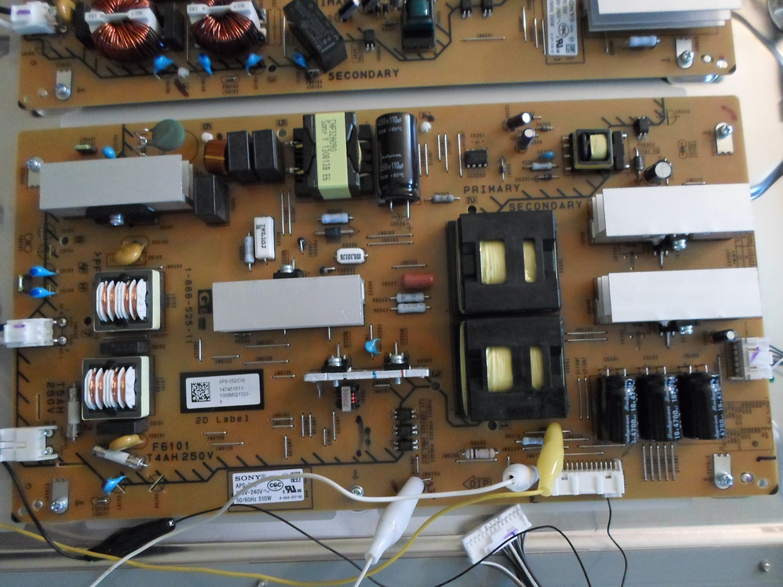

                      #50
                      Post 14:
                      But I was not able to jump the backlights on, I tried applying 3.3v to BL_ON along with PS_ON but nothing. It actually drags the 3.3v down.
                      That 3.3V does not sound right for it to be dragged like that.
                      • kevinm34232
                        • May 2012
                        • 1884
                        #51
                        Well I don't know what the reason is, but using the 12V to the BL_ON with a 1K resistor, the voltage drops to 6V on the BL_ON, whereas the REG+12V says at 12V everywhere else.
                        • kevinm34232
                          • May 2012
                          • 1884

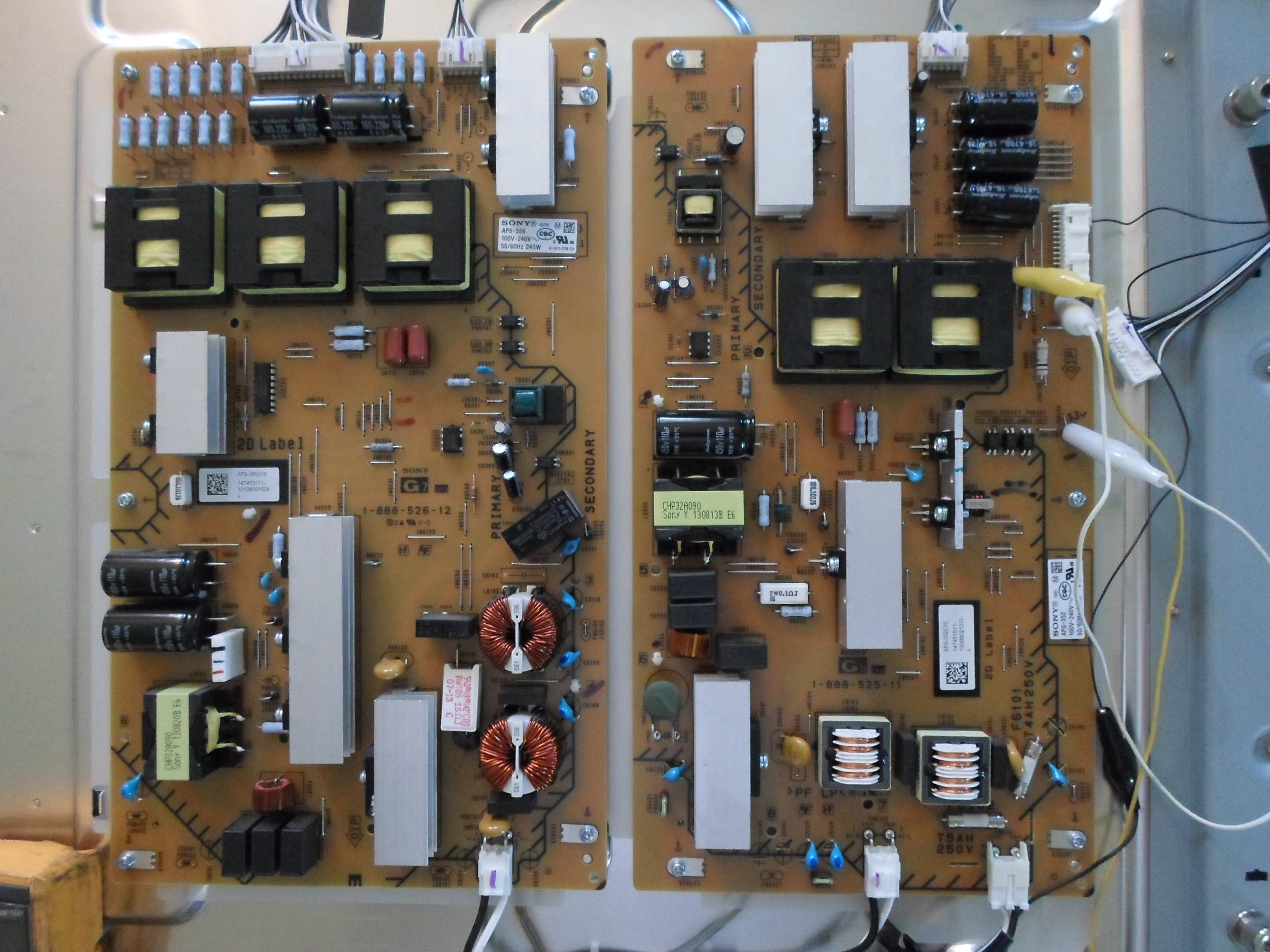

                            #53
                            Any way by looking at those 2 power boards to know if the one to the left should have voltage at the rectifier when just plugged in? 120VAC is being supplied from the other board as shown, but only the primary board has power. Also note that the PS to right has 166V at the main caps, and 396V when PS_ON is on.
                            • Diah
                              • Feb 2013
                              • 6435
                              #54
                              photo No 1, disconnect the following
                              socket from main board to audio driver
                              LVDS from main boards to T-CON
                              power on and tell which voltage you get.
                              Sony some how had no standby LED, just LED turn on at normal operation and can turn it off via menu
                              • kevinm34232
                                • May 2012
                                • 1884
                                #55
                                Nothing changed..
                                • Diah
                                  • Feb 2013
                                  • 6435

                                    #57
                                    Unfortunately the service manual doesn't help with the power supplies.
                                    The two boards are connected together with the white/black wires. Is there mains on both boards at the white connector points. I also see 2 white ceramic fuses on the one board by the mains in. Have they checked out as OK?
                                    • dick_barton
                                      • Aug 2015
                                      • 6643
                                      • Wales

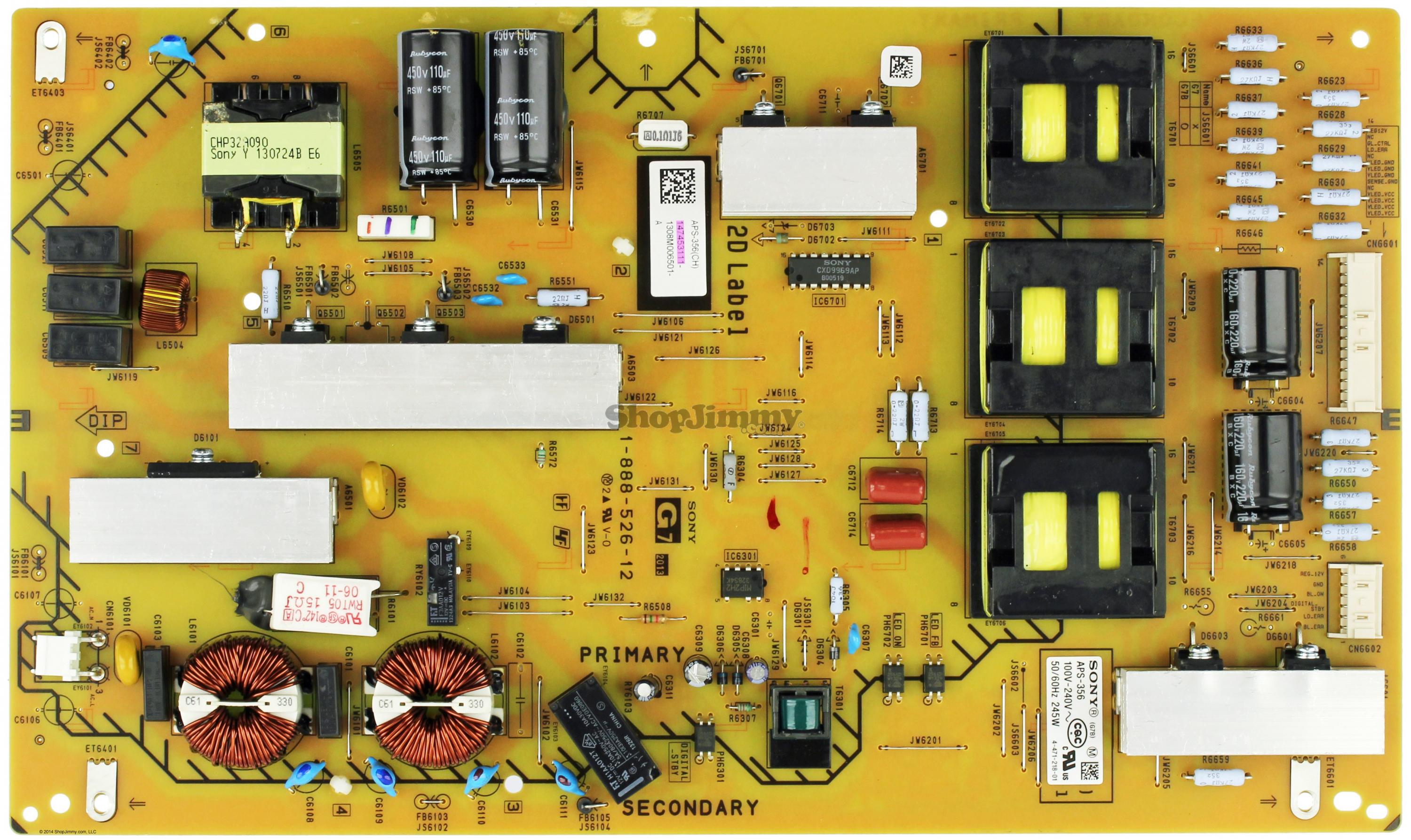

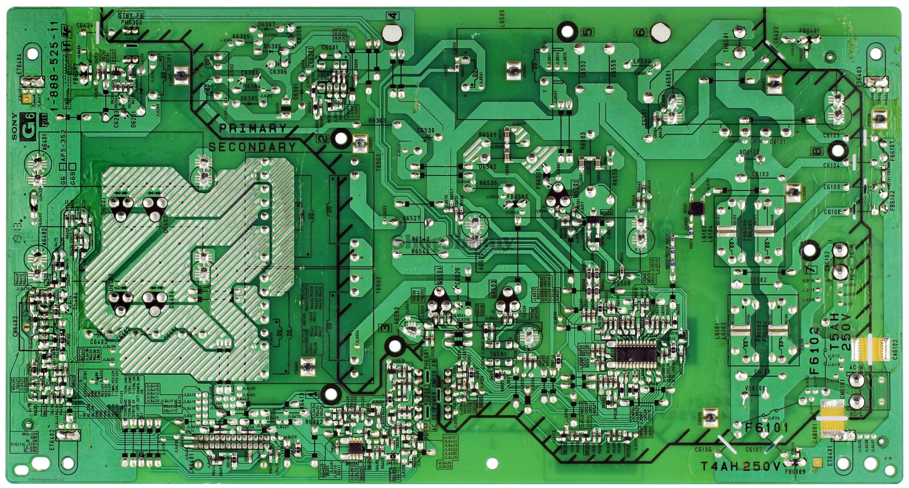

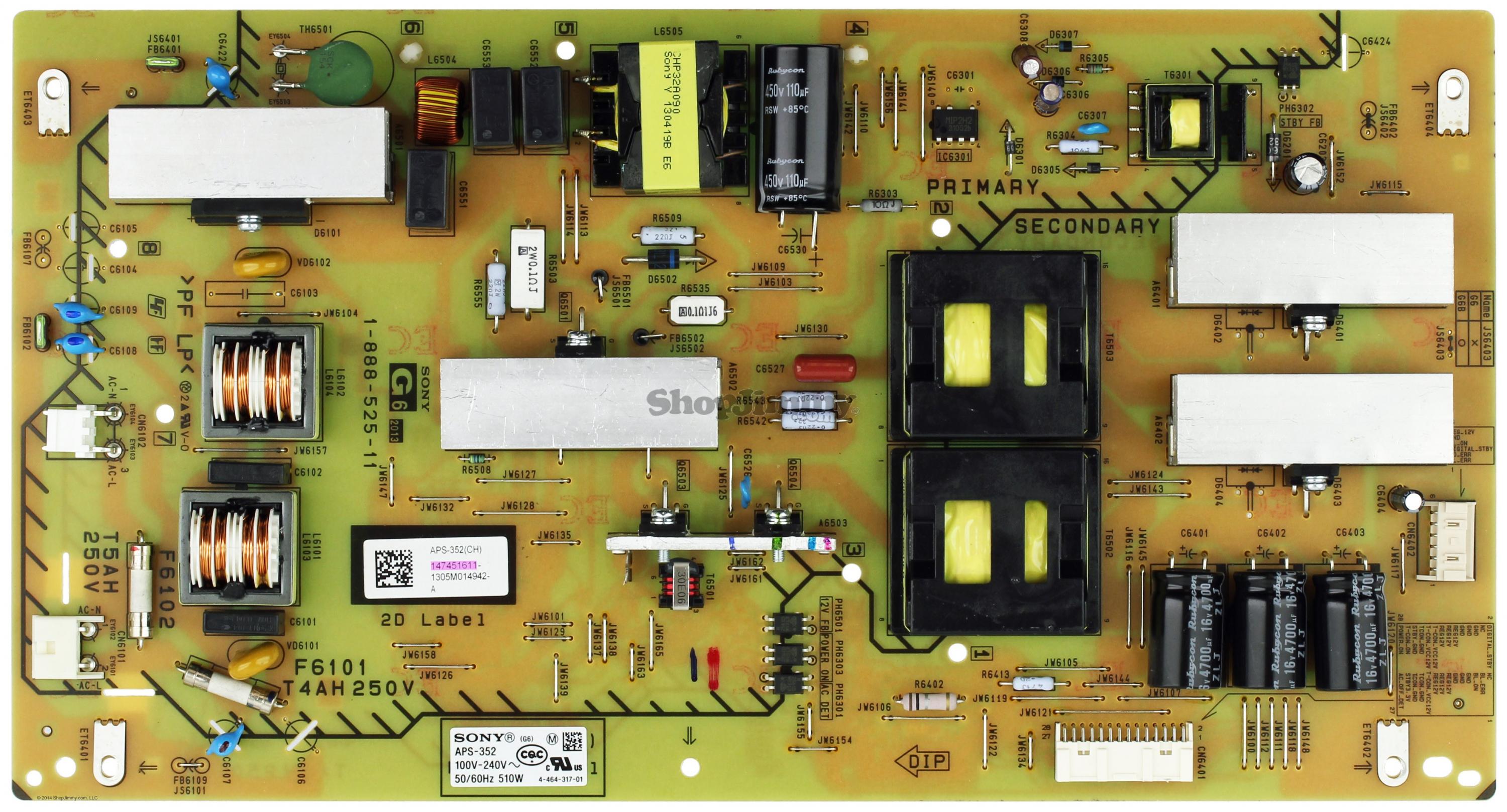

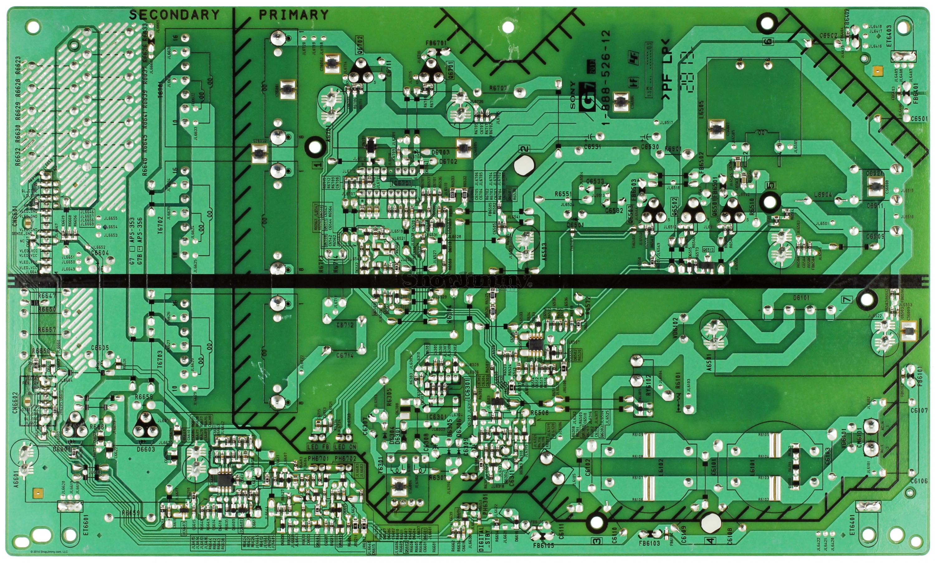

                                      #58
                                      APS-352 and APS-356 is second PS. BTW the second PS board, AC is connected from one to the other, but I only 1 have 1VAC at the 2nd bridge rectifier, not sure if it is supposed to kick on with a relay somehow..
                                      You say you only have 1VAC on the 2nd bridge but which bridge is it. Is it on the 352 or 356 board and what is it's component number.
                                      Photo's courtesy of Shopjimmy
                                        #59
                                        The Bridge on the LED power supply 356 will not get any AC to the bridge untel the board get the BL-ON signal to turn on the power relays RY6102/6103 to supply AC to the bridge D6101.
                                        Right now we know that the main board has at least one problem, it is not sending the PS-ON to turn on the power supply board.
                                        • dick_barton
                                          • Aug 2015
                                          • 6643
                                          • Wales
                                          #60
                                          You won't have any AC voltage on bridge rectifier D6101 on the APS-356 until the relay operates. This is a 12V dc relay. Measue the coil resistance which had diode D6616 across the terminals with your meter set to ohms. It should be 12 ohms.
