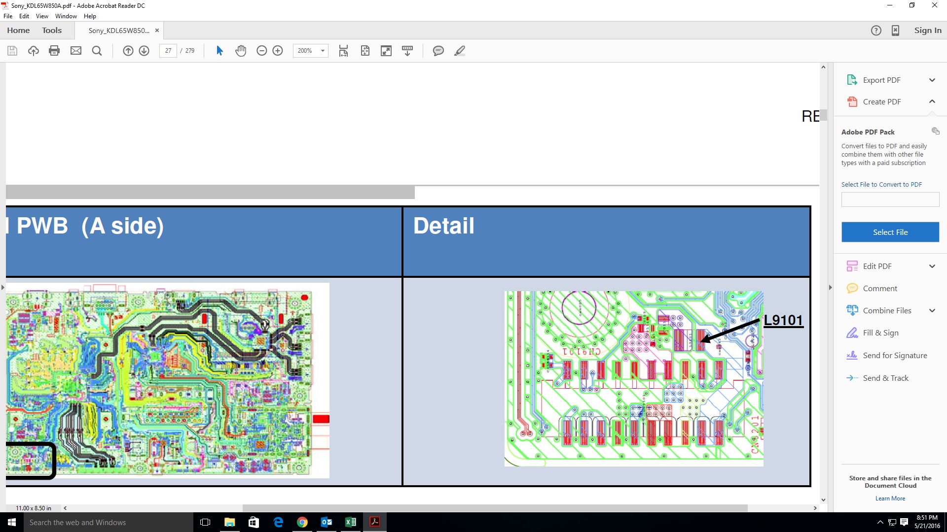

    Sony KDL-65W850A Dead

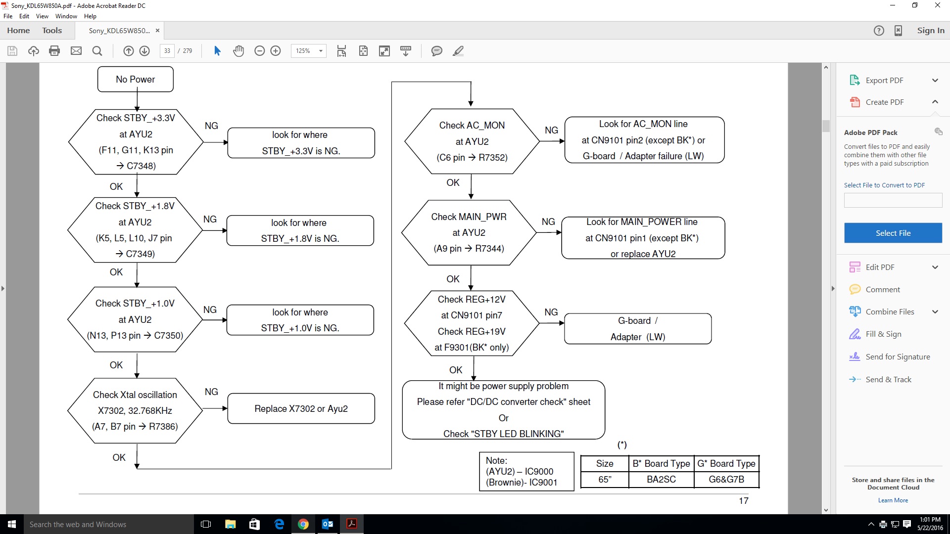

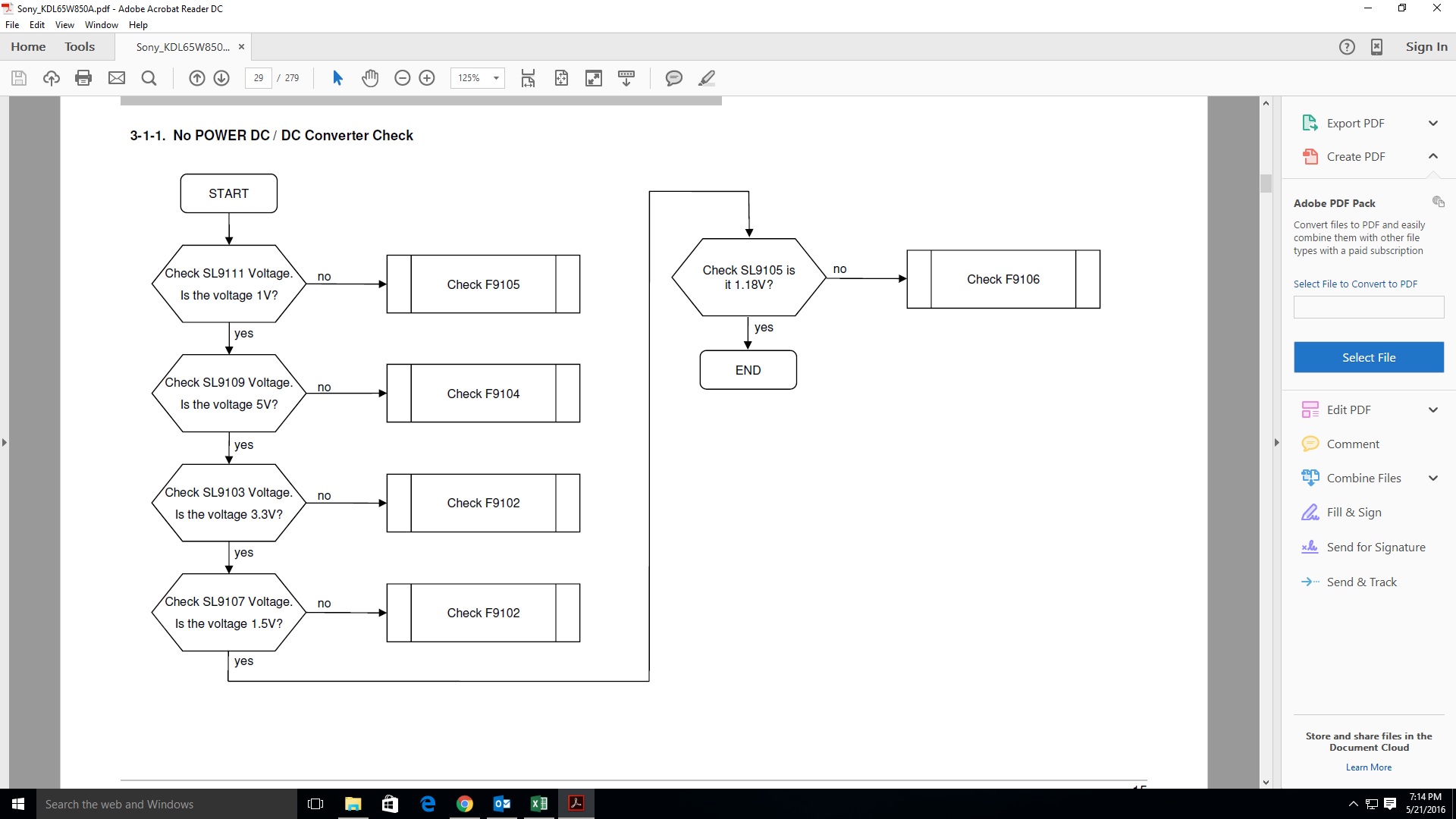

    I'm following SM flow chart, and have found the 3.3v standby power is present. Next step is asking to check the DC/DC converter. Note the "SLxxxx" in the photos.. I don't understand what they are asking to check, there is nothing there where the arrows are pointing. What does "SL" mean?

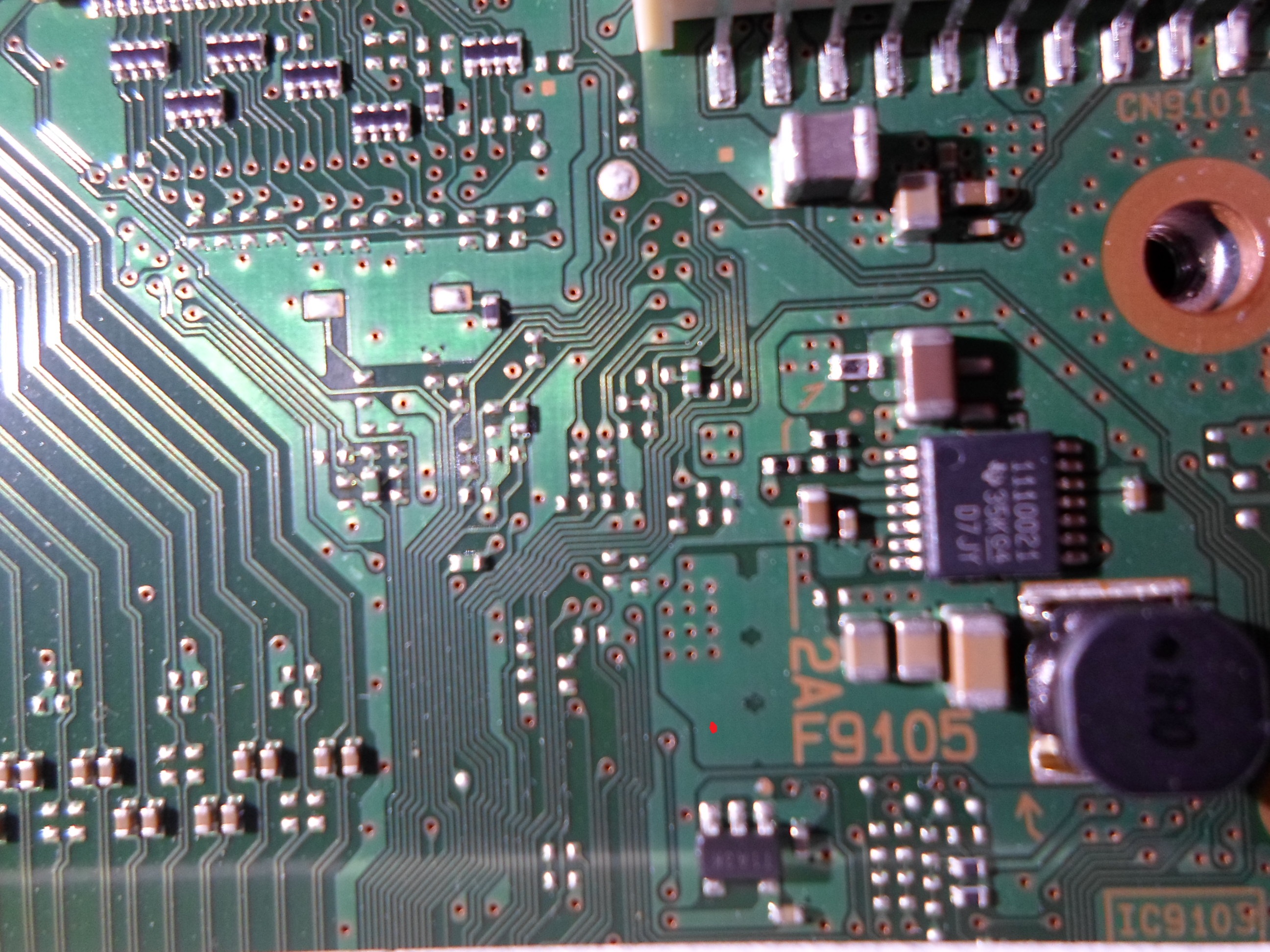

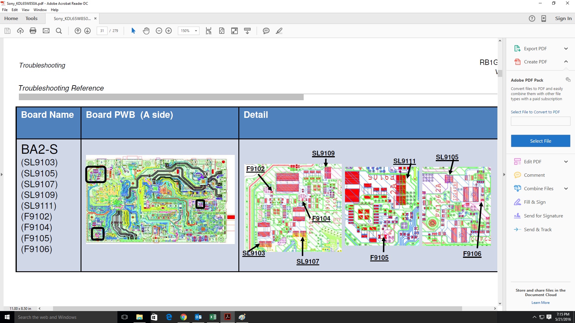

    I attached a photo of one example looking for SL9111 close to F9105. I put a red dot where the arrow points. There is nothing on the other side either..

    i think 65W85 are same as 65W95 forget the SM, and told us the stroy of the faults just dead !! how about your volts measure at main boards

      They are dc-dc converters, the ic's take one voltage in and convert it to another I'm not sure what voltage they are supplied but each will output the corresponding voltage listed in the chart 5v 3.3 1.5 1.8, if the output voltage is not there, check the fuses which seem to be on the inputs of the dc-dc ic's. sl9109 must be ic9109
      Like the above poster, what is the actual problem with the tv?

        I understand the DC/DC process, I just don't understand why they wouldn't ask to check voltage at the fuse, but a different point at the board, where there is nothing really there and no "SL9111".
        The fuses test good but I am not seeing any voltage there. The only voltage I can find is the 3.3V standby at the corresponding main board test point.

            I think voltages are supposed to be there since, the flow chart is for "No Power".. I'll have to look at it closer, I just want to know where they are actually saying to check it..
            The check for standby 3.3v was a coil on the main board and was correctly shown..

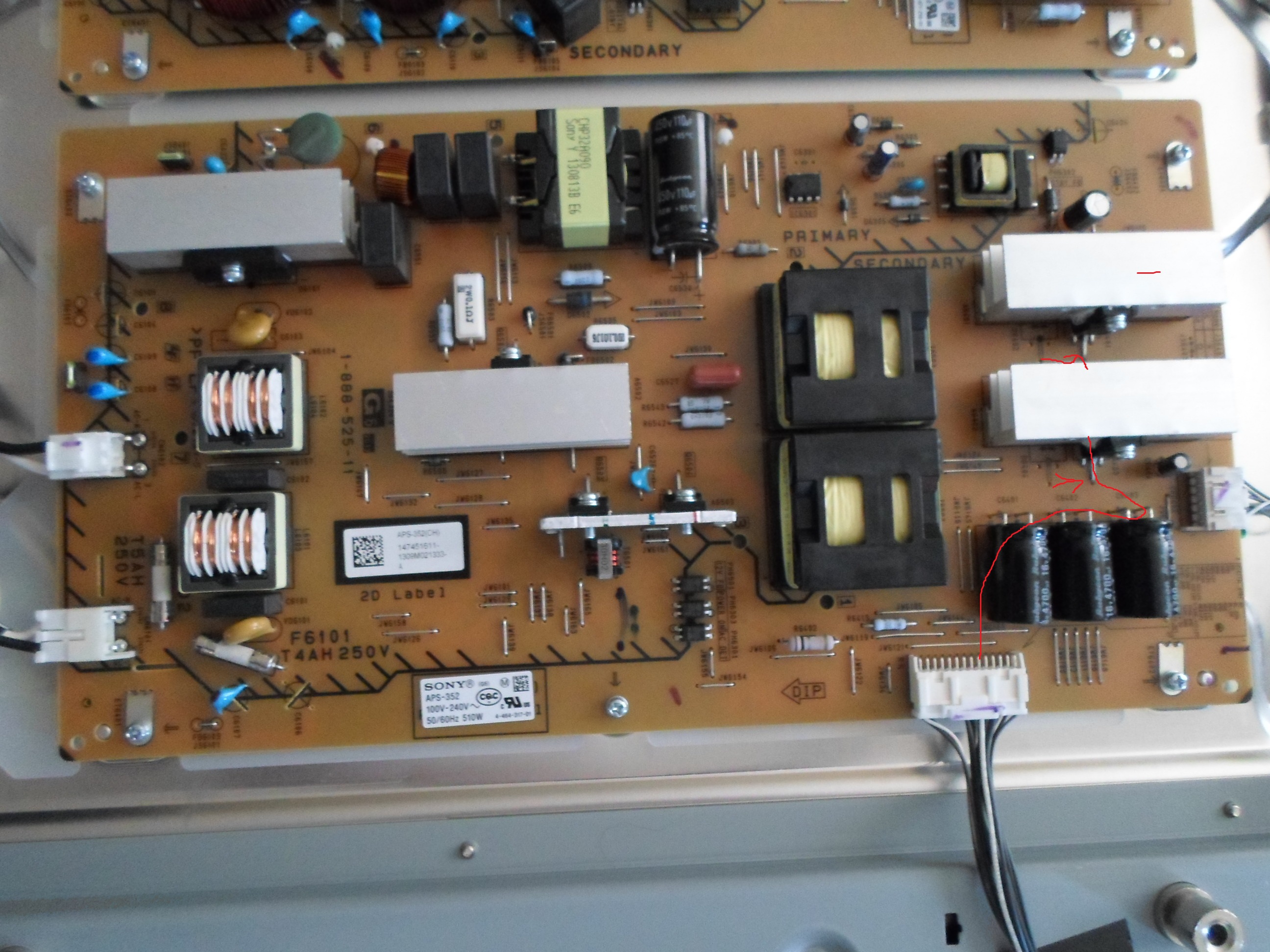

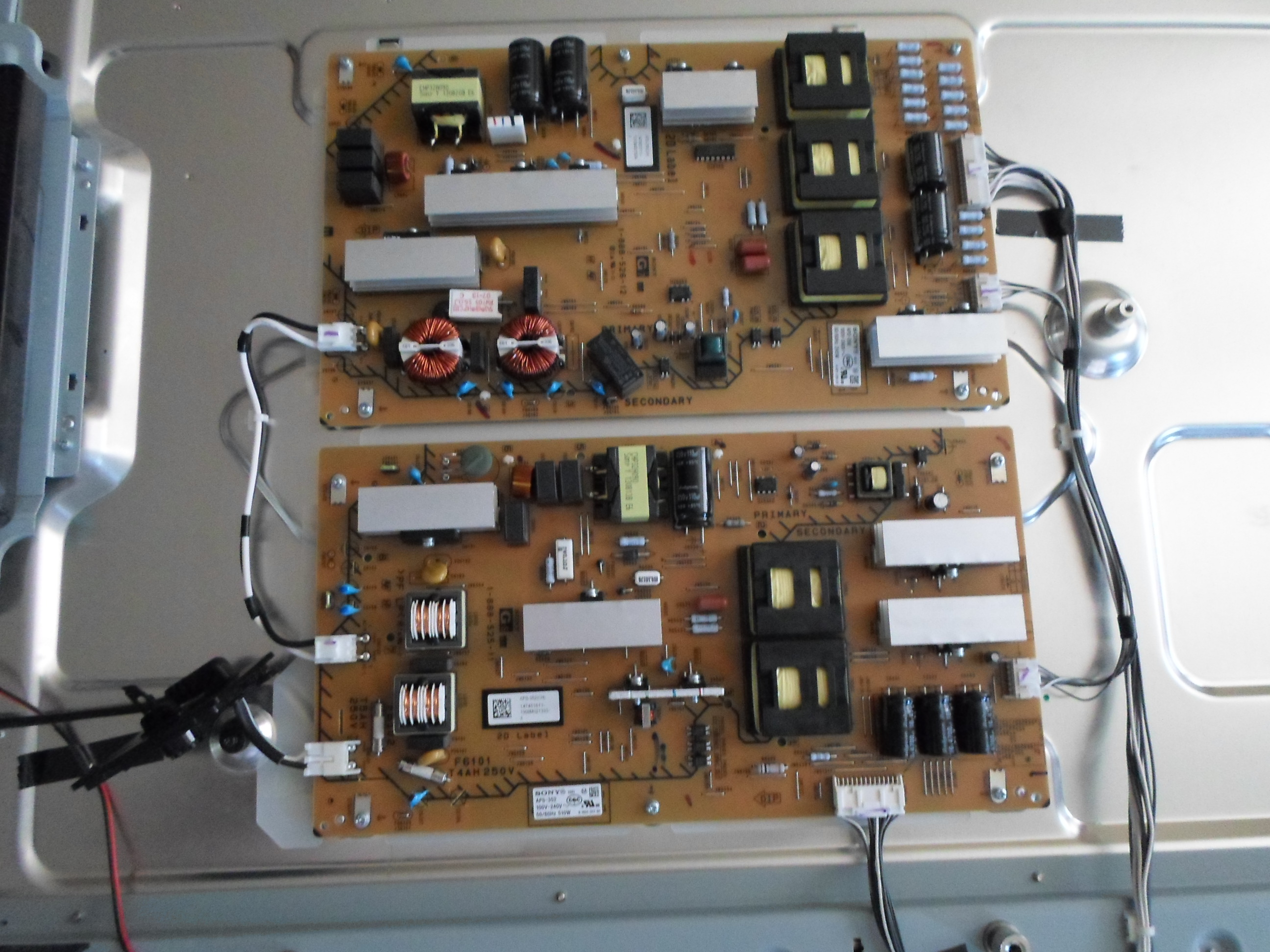

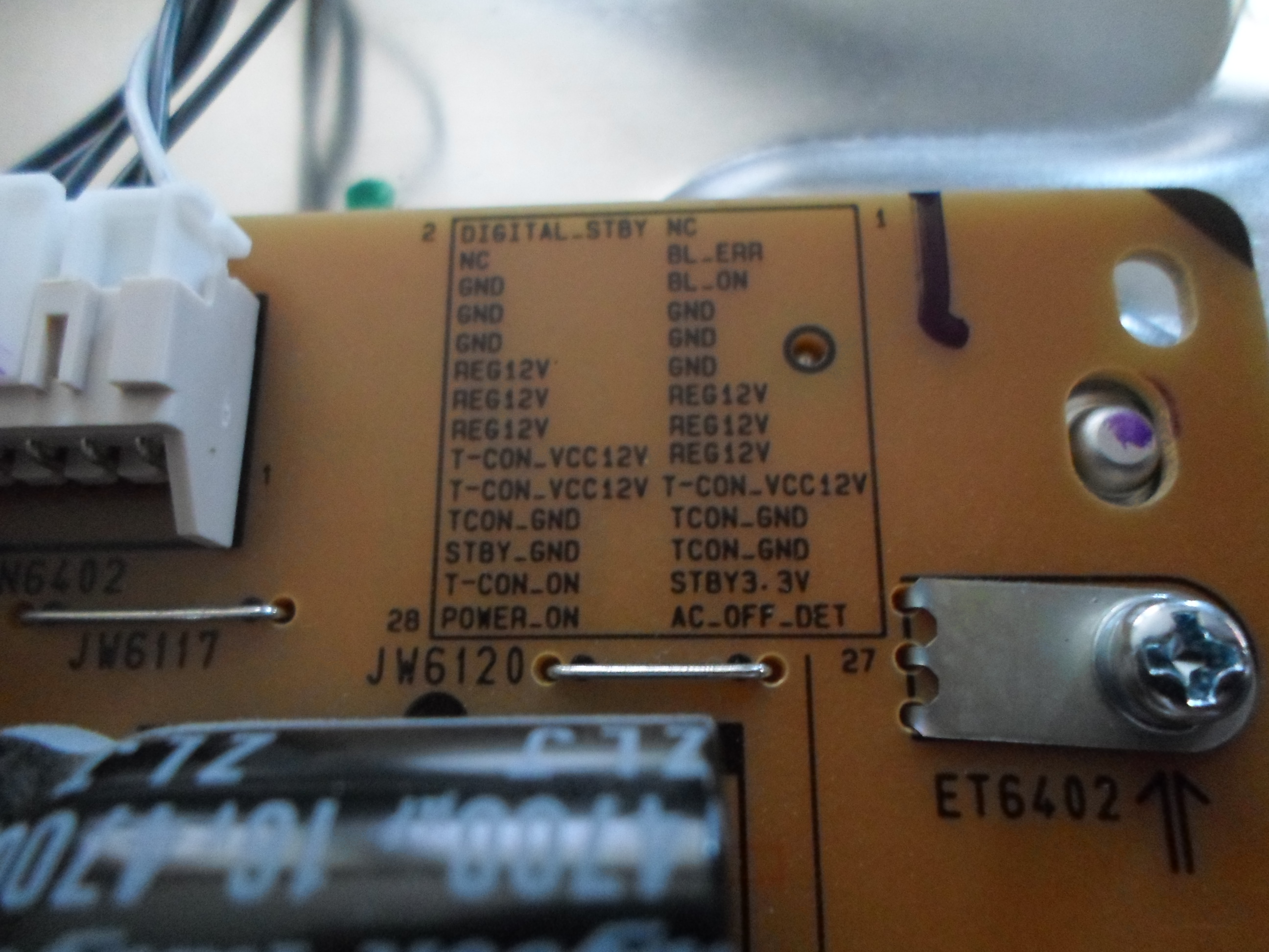

                  Yes there is a PS-ON, but I don't know if it 12V is part of that.. Here's some more photos if it helps. There are 2 power boards but it looks like the 2nd one is mostly for the backlights..
                  The REG+12V pins on that connector go back to the 2 diodes and 3 caps I marked.

                    When you power up, what DC voltage do you have on AC_Off-Det and the Power_On pins ?
                    • kevinm34232
                      • May 2012
                      • 1884
                      Re: Sony KDL-65W850A Dead
                      3.3V at AC_Off-Det, and 0v at PS-ON. I jumped PS-ON from the 3.3STBY, and then the REG+12V comes up. I still can't figure out where the test points are for DC/DC converter on the main board, but all the fuses are good and have either 12v or 5v.

                          The 1110021 is the regulator (SN1110021PWP). Measure the dc voltages on the pins.

                            Ya and the main caps come up to 400VDC.
                            But I was not able to jump the backlights on, I tried applying 3.3v to BL_ON along with PS_ON but nothing. It actually drags the 3.3v down. Notg sure if this is the correct process on this TV.

                              Did you use a resistor to jumper the Backlights On from the 3.3V. Resistor value of 500 -1000 Ohms?

                                I have 12V on pins 8 & 9 and pretty much 0v everywhere else.
                                  12V should come up on six pins as shown in the legend and STB3.3V on one pin?
                                    Where is the pin out legend that you are looking at?
                                      One of the photo's you provided. Post #9, SAM_2818.JPG (3 of 3)
