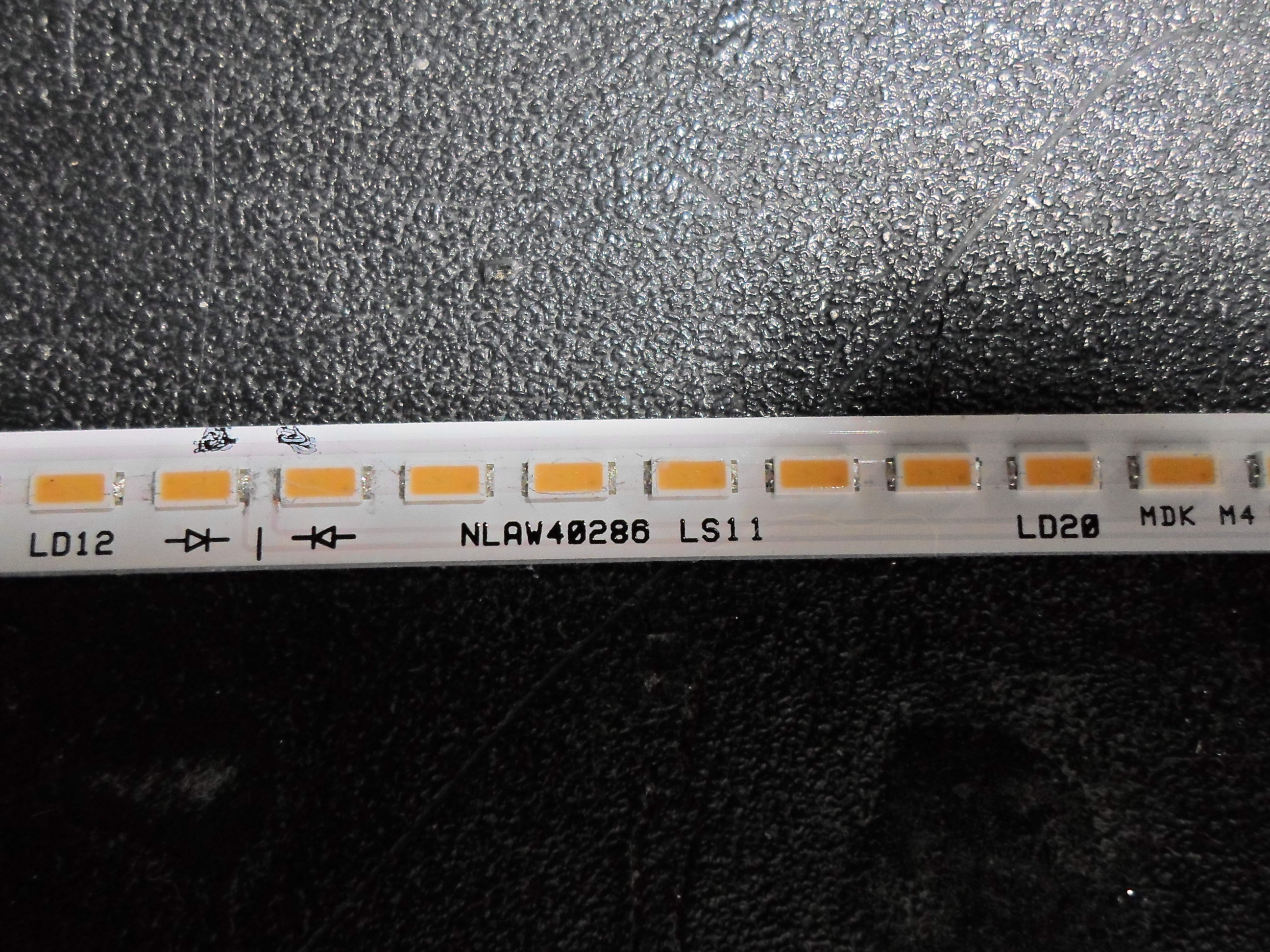

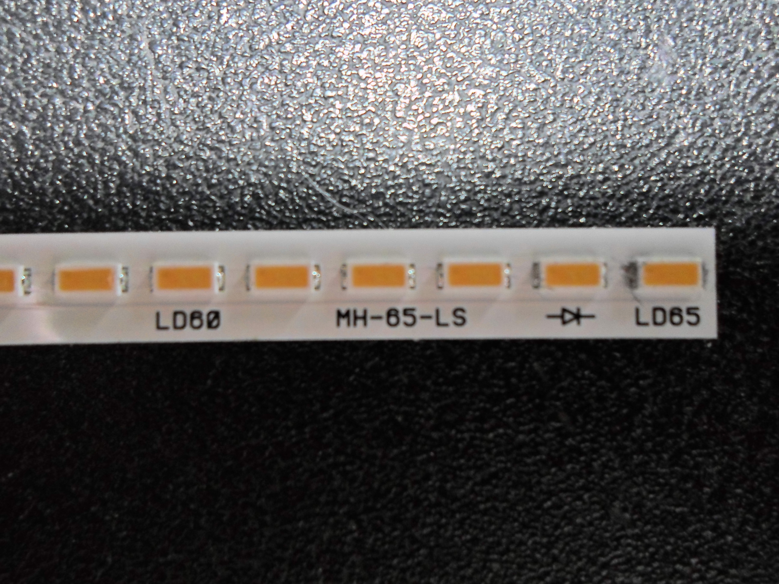

    Originally posted by kevinm34232

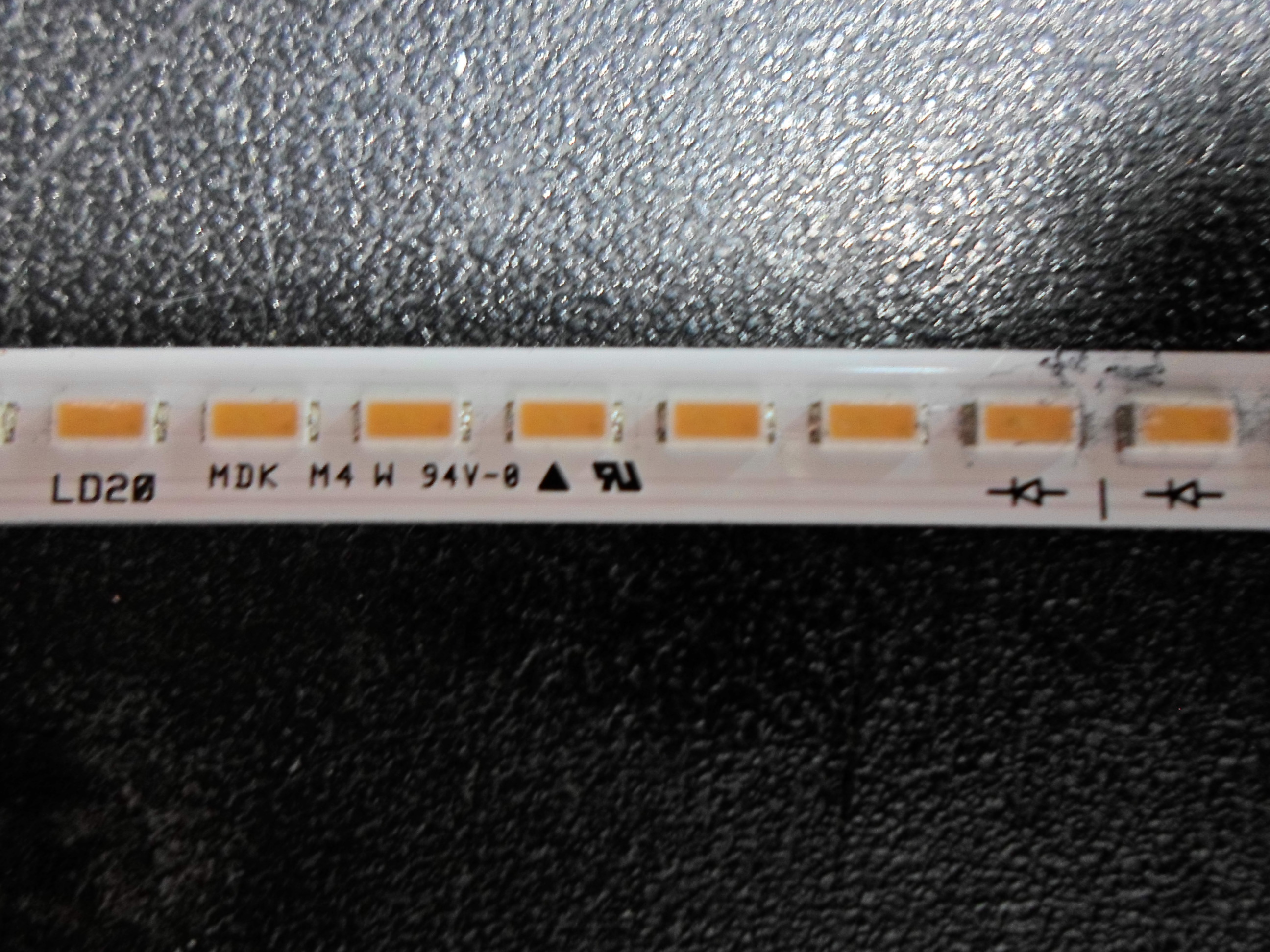

    How do you know the size, I measured around 5mmx2mm
    yours measured wrong. do as you like.

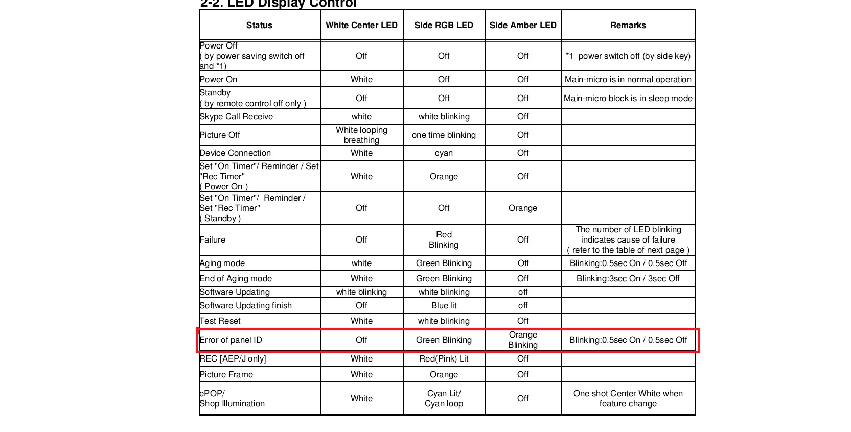

      Re: Sony KDL-65W850A Dead
      Right, main board problem first, but I replaced main board and had new problem with TV turning on then back off with flashing standby LED, but not a blink code or anything described in the SM. It flashed from green to amber over and over again.
      this is system software error
      when you replace main board you need to upgrade software
      try this.
      https://esupport.sony.com/US/p/model...d#/downloadTab
      Regards.
        i cant find anything smd size wise that matches your measurements maybe get a cheap pair of digital calipers (ive just got a cheap ebay set ideal for measuring stuff like this.)
            i dont think its so complex issue to buy such stuff if he dont agree on my LEd type statement.. ... Metric primary School Rule enough too..LOL
            the long measurements should be done at the base as there are 2 pin at sides, and the wide from the top, this LED at this post are 7020 LOL
              I asked how you know the size of these LEDs that's all..
                i see how do i know this size... before you has seen this strip for first time, i had changed all LEDs in total at 2 and half hours.

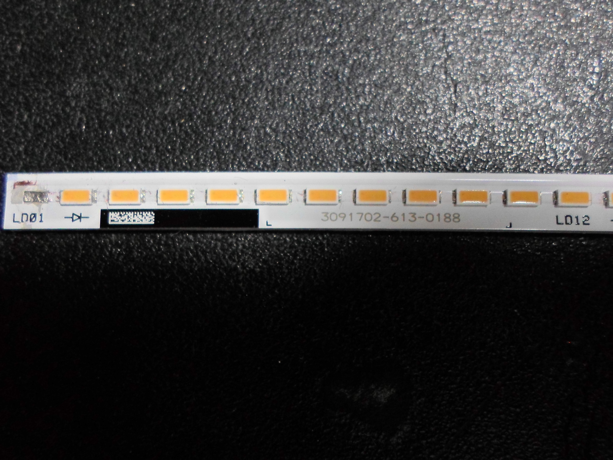

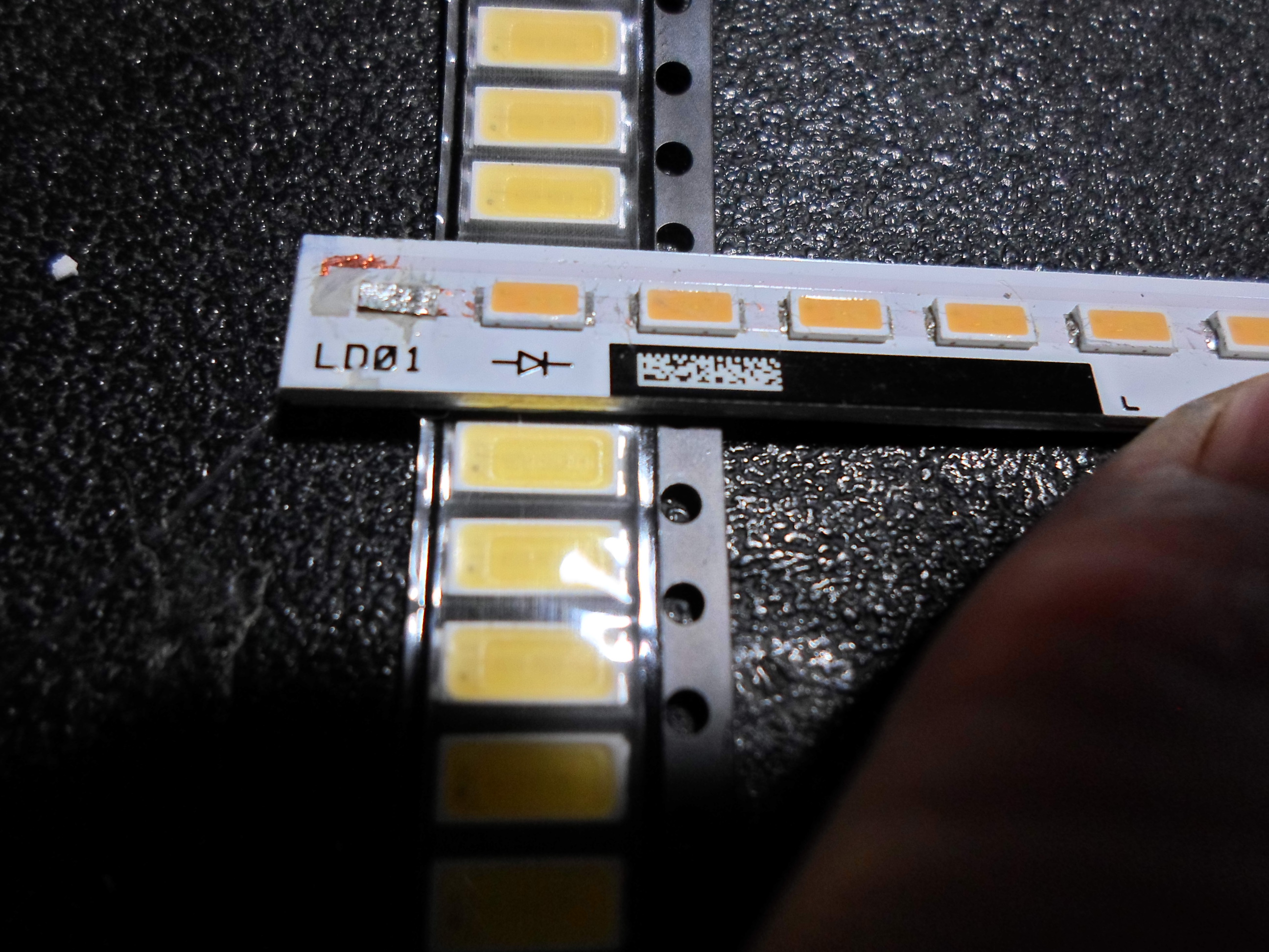

                  OK I have ordered some of these (the 7030 in 260mA, is that OK?)
                  http://www.aliexpress.com/snapshot/7...75837294490041
                  Next question. The LED strip is attached to a massive aluminum heatsink.. Making it difficult to remove a single LED. There are no screws holding it in.. What kind of adhesive are they using?
                    this seller i dont know and seem no one bought from him, use the one i listed as you can see the feedback of buyer.. and i do had 3 time ordered from them
                    if you are going only to replace the defect one, leave the strip at its place, just cut the defect one with cuter and clean the rest with yours soldering iron.
                    if you want to replace all you need to take the strip out its glued on the metal base. with glue film same to use Mobile Phone to glue screen thin double side glue film.
                    other tips, when you take out led, and clean it place, with shave plate make the base color print out and place solder at it from both side, then place your new LED as it most.. and with Iron just heat the soldering try dont touch the LED sides. this is best methode as you still have space between each LEDs

                          Diah, do you know where I can get these LEDs?

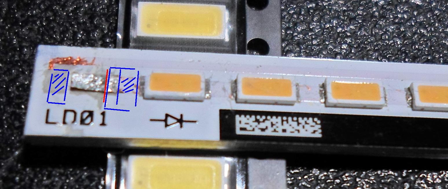

                            #133
                            there are no 5x2 LED, i wounder why its look yours different 6x2 !!!
                            however you dont need to worry as you still can use 7x3. take look on the photo
                            1- the red Line you need to separate the solder between the pad and the middle chassis pad
                            2- the blue area with shave plate clean it and add solder to it on both side, after you fit the 7x3 LED at its place just heat the solders from both side, i suggest you to use soldering iron head thin one such 0.5mm or less, then you are fine.
                            other photo of here i have KDL 65W95 you can see the LED 7x2 and beside it 7x3.

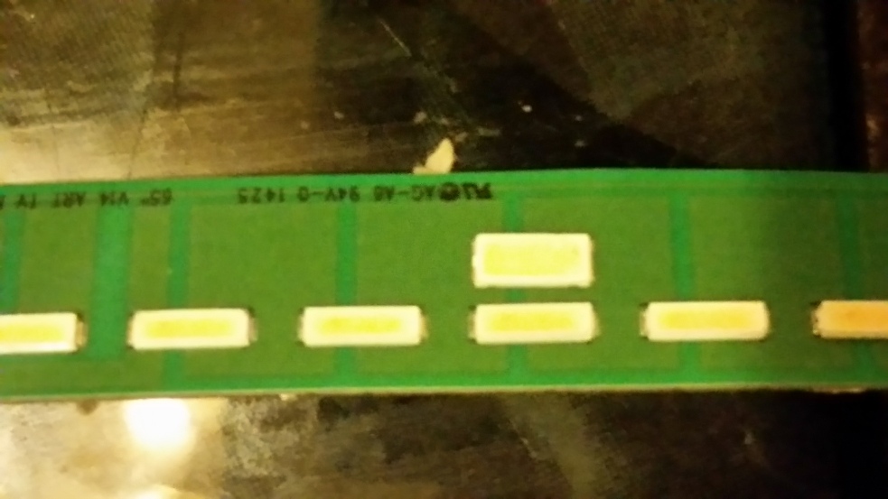

                            • kevinm34232
                              • May 2012
                              • 1884
                              #134
                              I just measured with a digital caliper and they are indeed 5x2.. The actual LED case without the metal ends is around 4.6mm x 2mm.
