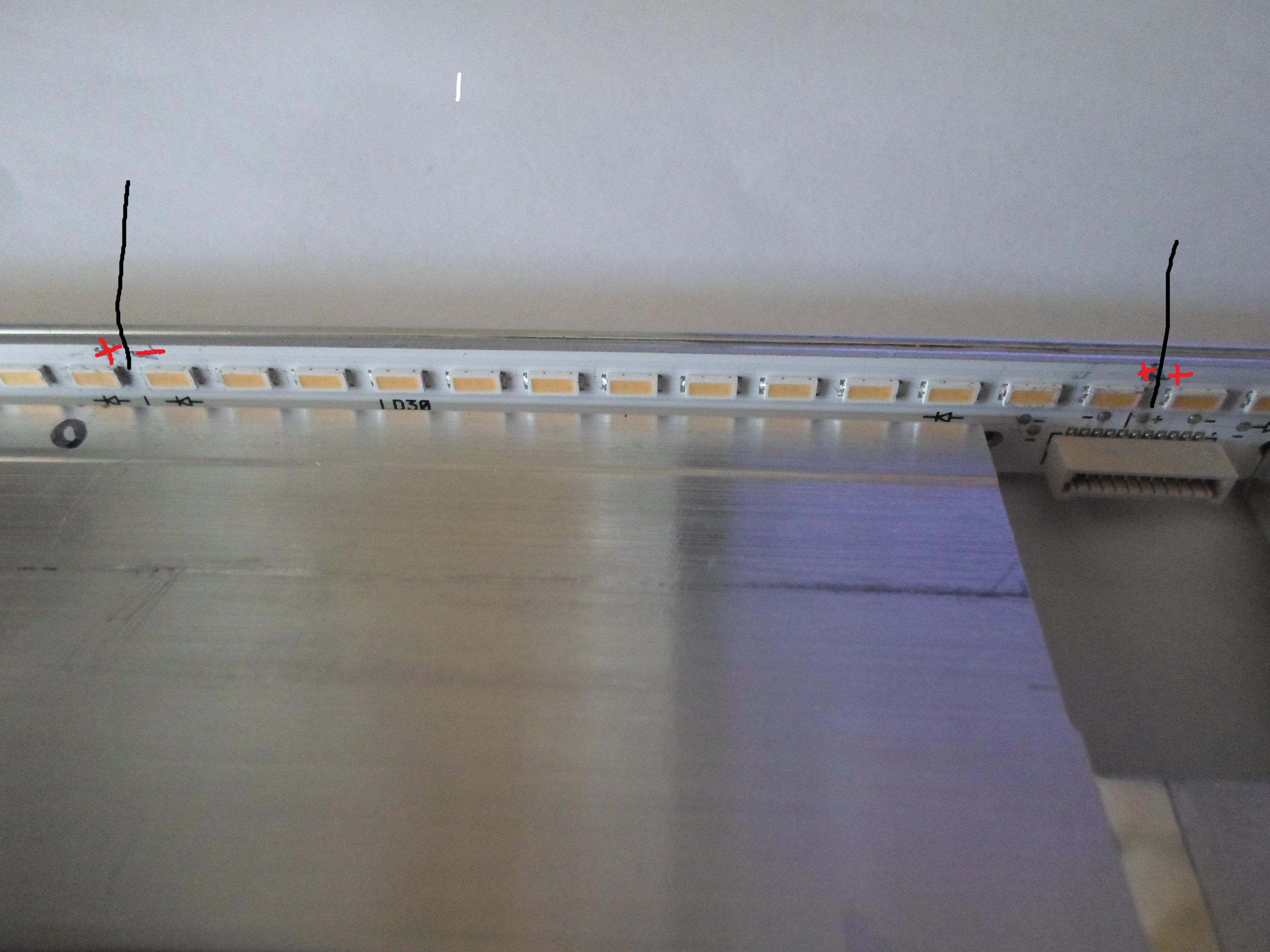

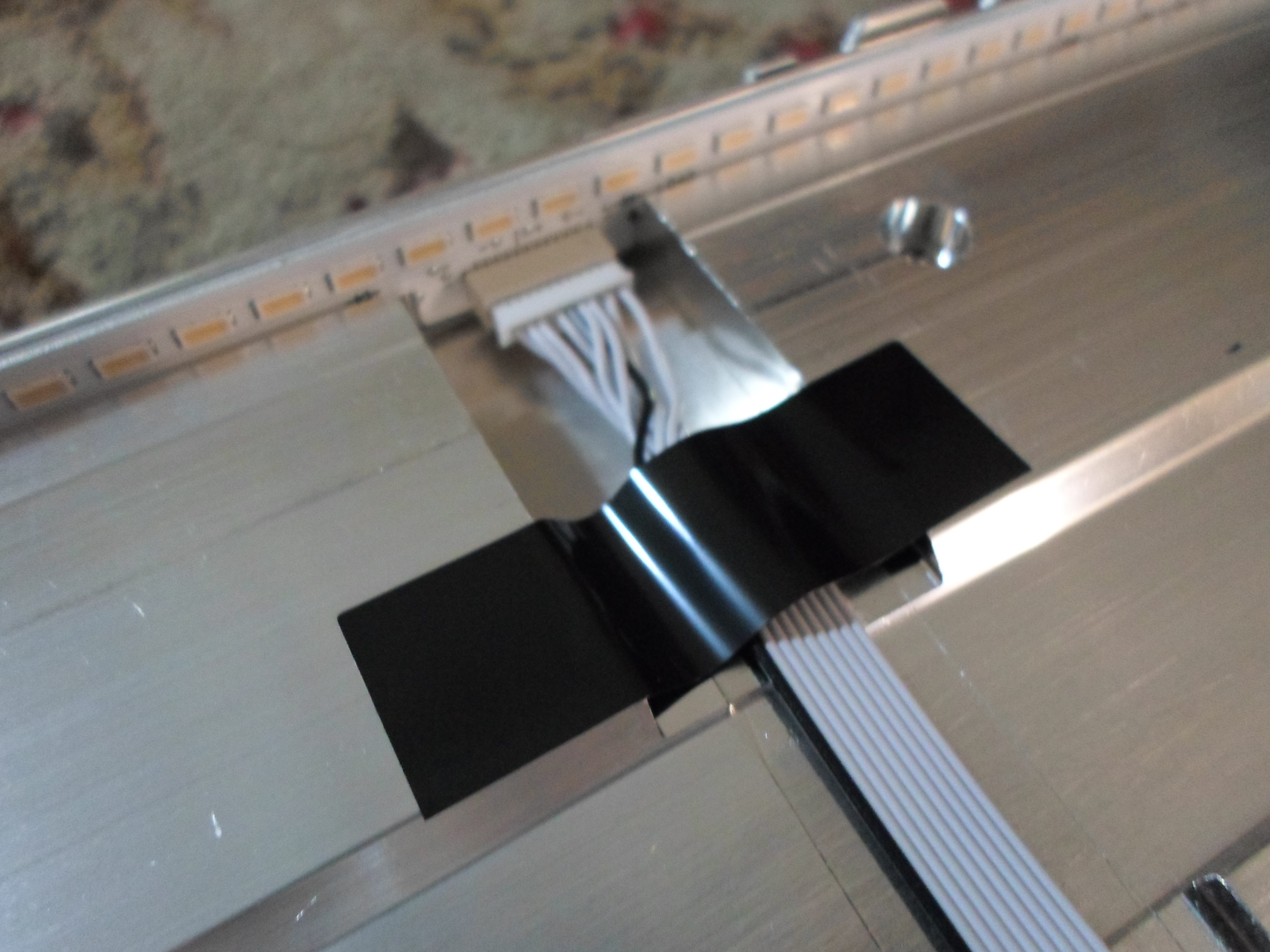

    I decided to go down to the LEDs.. This is different than ones I have seen before.
    There are 4 strips of 65 LEDs, 2 on each side.
    Each strip seems to have 5 sets of 13 LEDs, as the A and C reverse after each 13.
    There are 10 wires in the harness going to each strip.
    What's the best way to test these?? Testing each LED in diode mode with my DMM seems to give good readings but they don't light up..

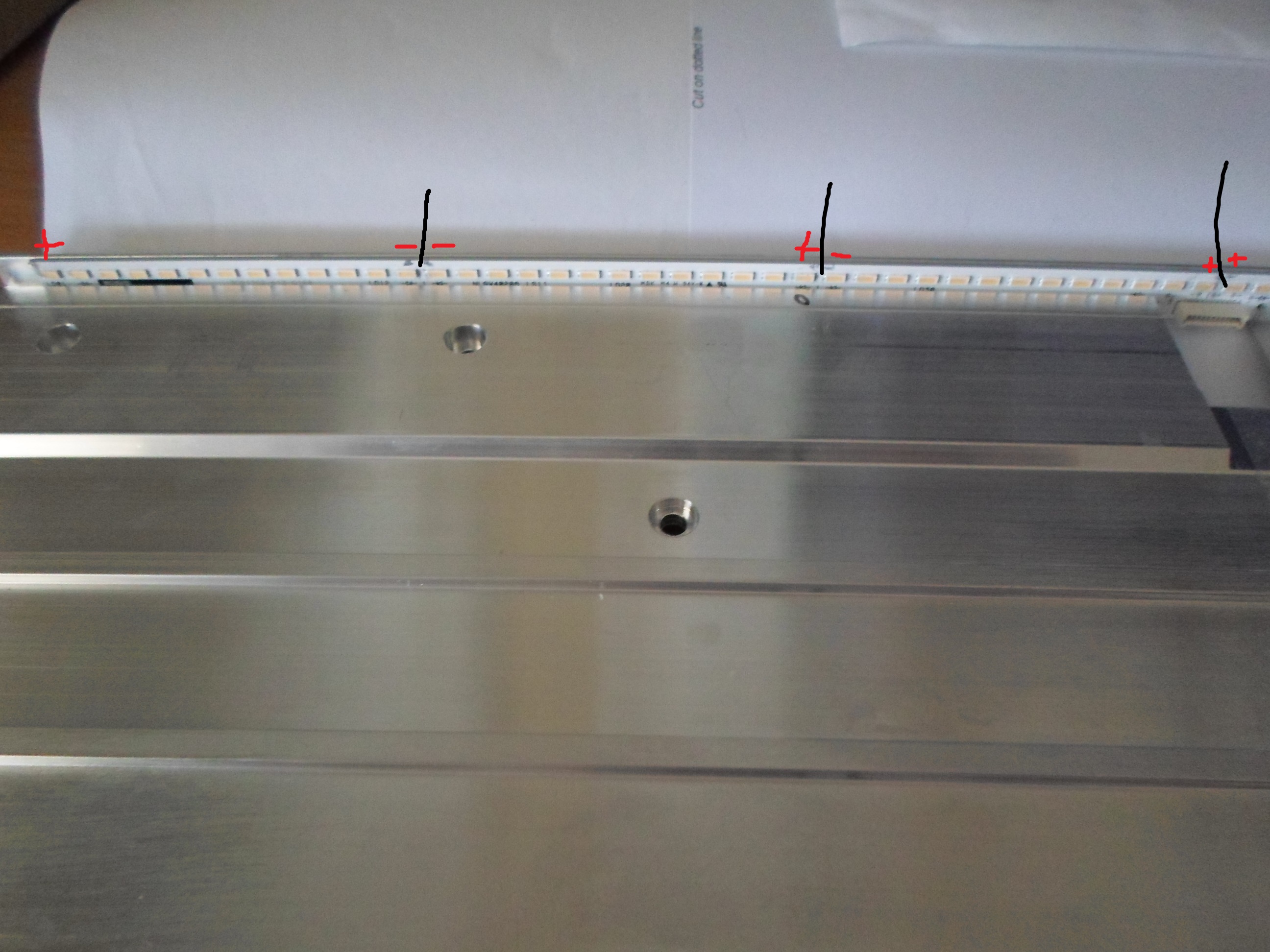

      Can really use some help with testing these LEDs while I have the panel apart.. As I said, each strip has 5 "sets" of 13 LEDs. There is a common "+" for all 5 sets, but each "-" is independent of each other.
      See photo with the "+" test point, and the 3 "-" test points, there are 2 more sets of 13 to the right that are not in the picture.
      I am not sure how to test these, I've opened up 2 LEDs already trying to figure it out.
      I tested each LED in diode mode and all seemed good, I really would like to light them up..

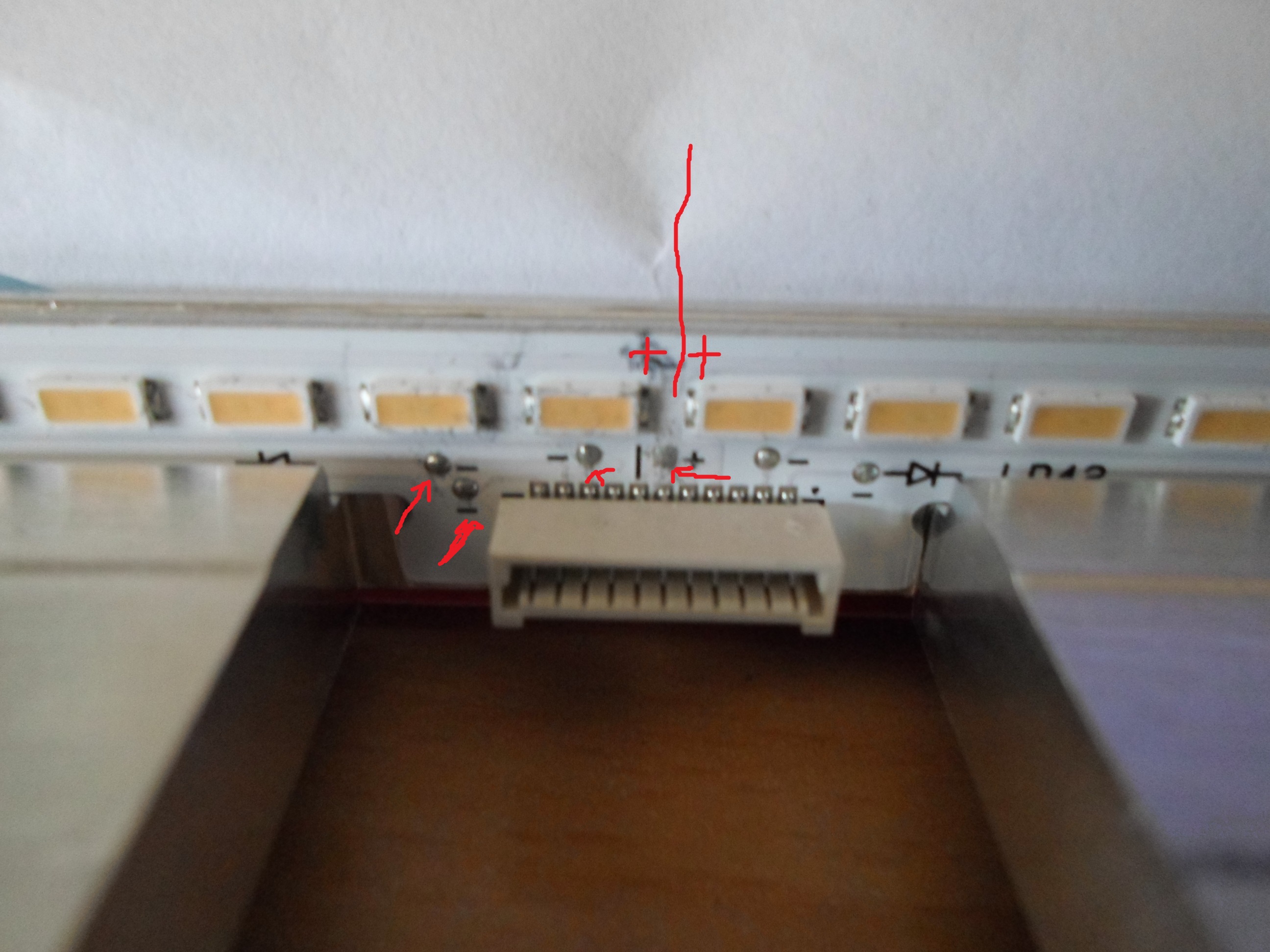

          'I tested each LED in diode mode and all seemed good' What does it show on the meter? 0.75. 3, 6?

                All other strips I have are in series, so they will light up with the DMM. These will not light up one at a time. I am confused by how they are wired, a common positive feed for all 65, but different negative for each set of 13.
                I don't know where to place the leads? This is how I opened 2 of them already.
                Can I hook my PS to the common +. and one of the - test points for the 13 LEDs?
                Is it going be set to 3V with higher current, or 3x13V like they were in series?

                          You are reading the Vf of the protection diode which is in parallel with the LED/s.
                          Vf of single white LED is around 3V, dual LED will be around 6V.
                          Reverse your probe and test them again.
                          BTW, your meter may not have Voltage to test dual LEDs.

                              First you need to get the correct ANODE/CATHODE pin first, so try using your meter in diode mode the establish the correct pin first, if you hook up the 3V or 6V wrong you can damage the protection diode and shorted it out.
                              The good LED in one way should show 0.6~0.7V (Vf of the protection Diode), and 3V (Vf of single white diode, or two LEDs in parallel), or 6V for dual LED (LEDs in series) in another way.
                              This is why it is important to use current limiter power supply in case you apply the Voltage with wrong polarity to the LED with built-in protection diode.

                                With the DMM, the LEDs read 0.75V with black on the Anaode and Red on Cathode. So now what do I do?
                                  #96
                                  Re: Sony KDL-65W850A Dead
                                  Reverse the leads and see what you get.

                                    Reversing leads I get 0L, that's where on the other strips it would usually light up the LED.

                                          OK, it shows 0.7V, you are reading the Vf of the protection diode, that means the polarity of the LED will be opposite of what you are probing,
                                          I.E. Red probe on one pin (called it pin 1), black probe on another pin (called it pin 2) the meter shows 0.7V. That means pin 1 is the CATHODE of the LED, PIN 2 is the ANODE of the LED.
                                          So apply 3V 100mA in that polarity, it should light up the LED, if not it may be dual LEDs in series, then you just have to turn up the Voltage slowly. Try that on the good LED.
