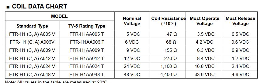

      Re: Sony KDL-65W850A Dead
      12 Ohms for the 12V DC coil is too low, if the relay coil is rated at 1W, then the DCR should be around 140~150 Ohms range, or higher if it is 1/2W relay.

          #64
          That's obvious when you point it out. Just looked at the Fujitsu data sheet and it does say 11 ohms. Will dig deeper.
          Edit
          Coil resistance 270 ohms

                #67
                You won't have any AC voltage on bridge rectifier D6101 on the APS-356 until the relay operates. This is a 12V dc relay. Measue the coil resistance which had diode D6616 across the terminals with your meter set to ohms. It should be 12 ohms.
                Edit
                Updated coil resistance in later post
                Which coil are you referring to, I don't see a D6616?

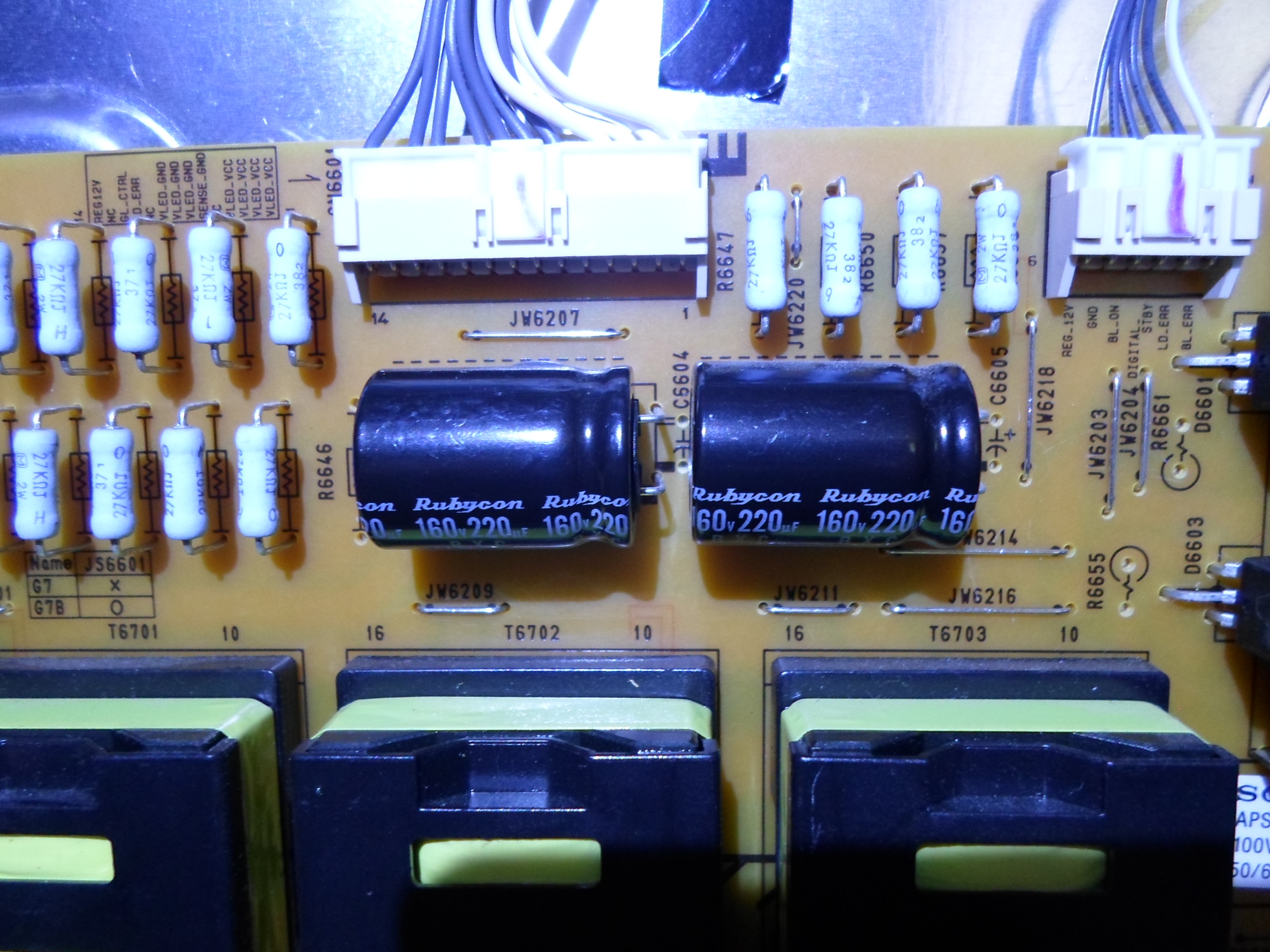

                    #69
                    Shown in attachment

                        #71
                        Edit
                        263 ohms. I decided to order a replacement of this APS-356 and had no changes. 259 ohms on replacement board across the pins with D6616.
                        • kevinm34232
                          • May 2012
                          • 1884
                          #72
                          Welp I got a replacement main board, and now TV responds to power button.
                          But, plugged in power, pressed power button, got a brief flash of backlights, then went out and front LED flashing green to amber over and over until AC unplugged.. Now no backlight flash at all just same green-amber flashing..
                          So this is progress, although disappointing.. Time to look at the SM again and see what this means.
                          EDIT:
                          [Quick look at SM and nothing describes this symptom, great...]
                          More info:
                          In standby, now get 3.3V STBY and REG12V. POWER_ON is also 3.3V. When power button is pressed, main board sends 3.3V to DIGITAL_STBY and BL_ON (relays click then go off in 1-2 secs).
                          There is a TCON_ON on the PS, that does not get a signal at all from main board during this time.
                          I then tried another LED power supply (APS-356), and got same results..
                          This is looking more and more like another bad LED light, or possibly the LED driver board.

                              #74
                              So now (with main board disconnected), I jumped 3.3V to:
                              POWER_ON
                              BL_ON
                              DIGITAL-STBY_ON
                              This kicks on the 2nd power board (APS-356), but still no backlights.
                              The voltages on the 2 connectors on APS-356 are as follows:
                              14 pin connector (to/from LD board):
                              VLED_VCC = 60.75V
                              LD_ERR = 0.13V
                              GL_CTRL = 0.0V
                              REG12V = 12V
                              6 pin connector (to/from PS board APS-352):
                              BL_ERR = 6.17V
                              LD_ERR = 0.25V
                              DIGITAL_STB = 3.2V
                              BL_ON = 3V
                              REG_12V = 12V
                              I should mention that while checking voltages when everything was connected normally, occasionally I'd get backlights for a few seconds, and GL_CTRL would be around 1.1V.
                                You have BL_ON which is good but unfortunately BL_ERR is indicating faulty backlights.
                                Can you measure all 4 VLED_VCC and say what the voltage on all 4 connections are. They may go high when first switched on and then fall back.
                                You could also measure the primary and secondary resistance of each of the transformers and see if they differ significantly from one another.
                                You're almost there.
                                GL_CTRL......Unfortunatley I don't know what that stands for but does it say in the manual?
