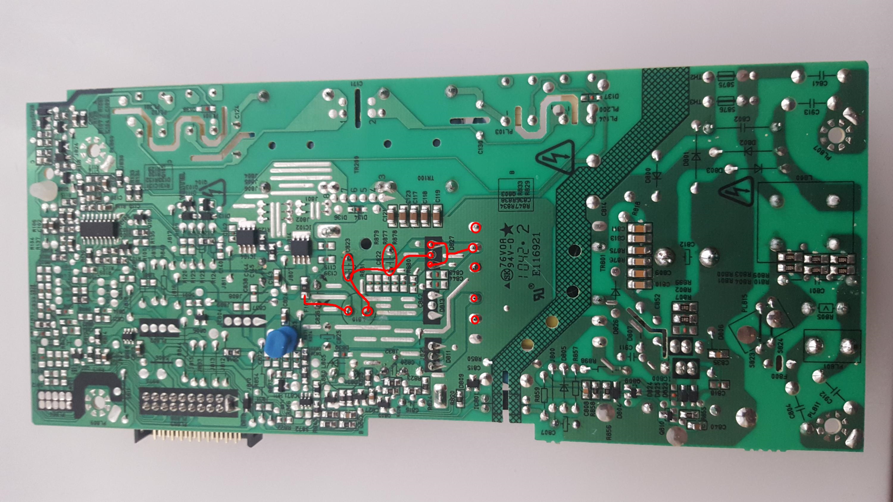

    What dc voltage do you have from L810 to chassis?

      I thing we may be chasing our tails. The checking solder joints suggestion sounds pretty good to me.

        Originally posted by sordids999
        This what im saying i have intermittent voltages yesterday no voltages then later on i had 5v/12v voltages but now nothing ?
        You do have +5VSTBY, so need to check real close in that section of the 14.5V section, the primary drive circuit is working otherwise you will not have the +5VSTBY.
        We need to get that 14.5V first.

          Originally posted by budm
          I hope that the basic tests have been done in that section already such as checking to solder joints, rectifier diodes, inductor L810, etc.
          yes but checking again

            14.5V connections, resolder them all.
              Done but still the same only STBY+5V present but still stuck in standby and now i have tried a replacement working power supply from a friends tv and still the same

                Re: Luxor LUX-22-822-COB stuck in standby
                Hmm thats odd, I have the same Psu here and it brings all rails up with no mb, but I guess all Vestels are different lol. Its a Mb issue then. Got a close up of the Mb ?

                  The 14.5V is an ALWAYS on power supply, no control signal needed as you can see from the marking I made on POST 45.
                  You should have DCV between the two legs of C822, 823, 825 the minute you apply AC to the board, unless D827 or the transformer winding have open circuit.

                    Replacement main board ordered now all working
