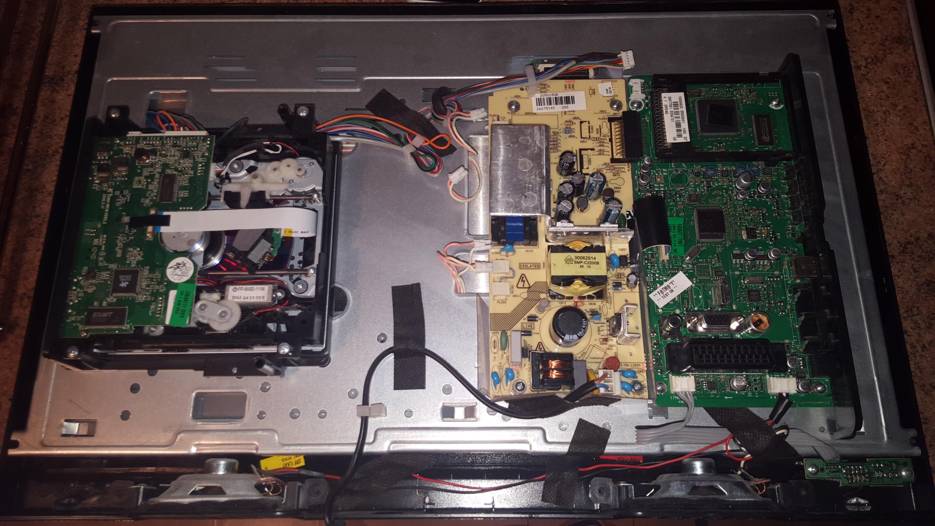

    hello
    picked up this tv tonight standby light is stuck on blue light
    cant get any voltage readingsoff the power supply
    im just wondering if its the built in inverter ? best way to test to see if its working or faulty ?
    thanks

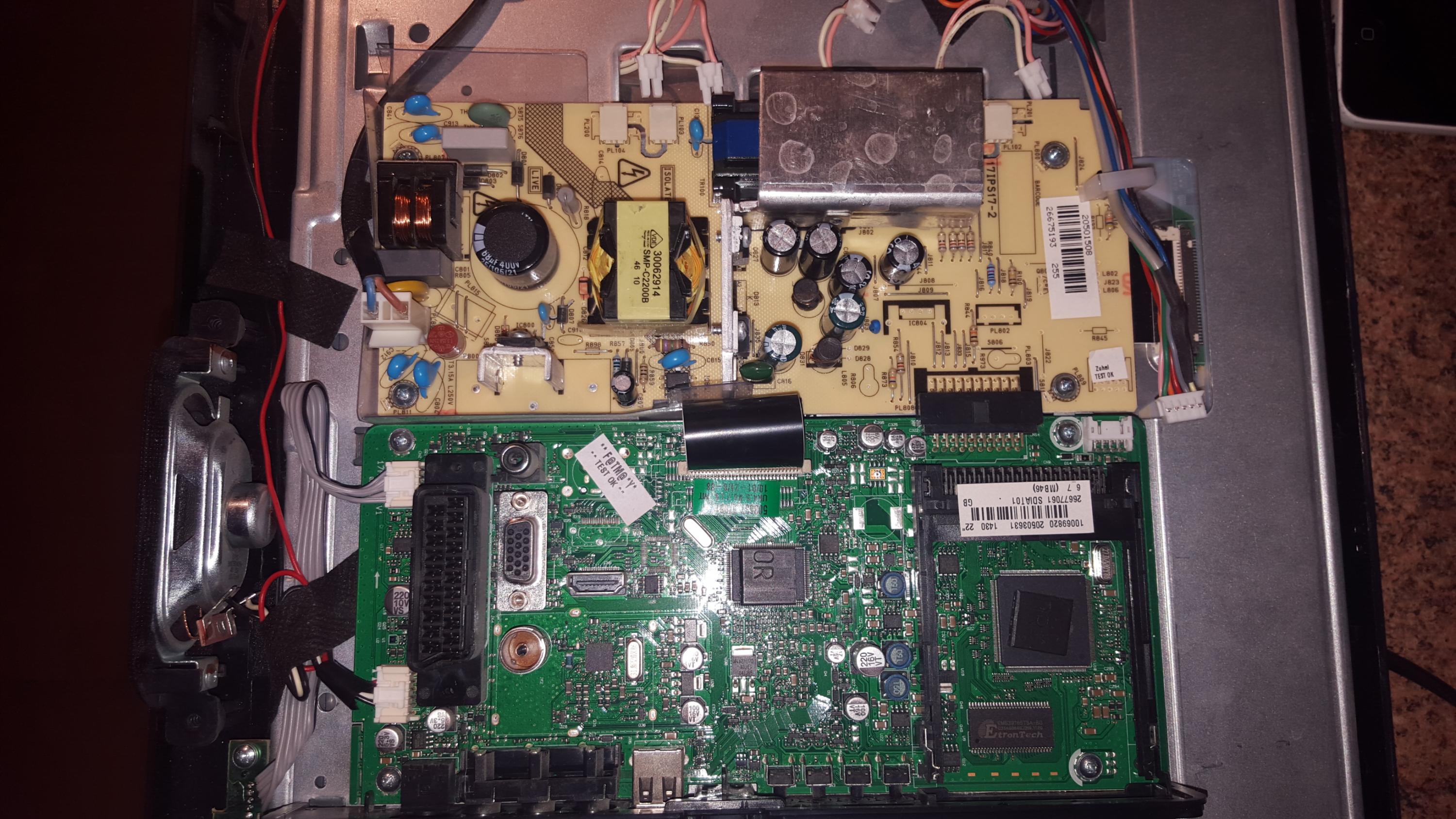

          Re: Luxor LUX-22-822-COB stuck in standby
          Strange !
          tested mosfets not shorts and now with the psu disconnected from the mb i tested the voltages again and now i have 12v/5v but fluctuating voltages up and down
            Sounds like a bad start up/feedback cap to me. Try heating the Psu maybe ?

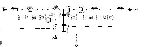

                      with psu disconnected and reading of PL803 12/5 volts fluctuating and no 33 volt present
                        33v goes straight to the inverter I think on these so check what the mosfets are getting.
                          The 33V is derived from the +12V supply.
                            This Vestel uses ACTIVE LOW, when STBY_ON/OFF is high the switches are turned off, when when it is LOW the switches are turned on, when the PS-ON of the main board is HIGH to keep the power supply OFF by biasing on the PS-ON line controlled Transistors (Q802, 806, 871, see page 1) on the power supply board to keep the switched power supplies from coming on, so when you disconnect the cable from the main board the PS-ON controlled switched Transistors are turned off due to no biasing which then allow the switched power sections to come on. So it still requires PS-ON which in this case the ACTIVE LOW PS-ON.
                            The inverter circuit uses 14.5V (Always on 14.5V, feeding the fuse F101 and then get relabeled as 12V, see page 2) for running the inverter drive and output circuits.
                            The 33V is used for tuner not for the inverter circuit, it is high Voltage (33V) and very low current as you can see from the diagram on how the 33V is generated, the Varactor Diode in the Tuner does not need much current to run.
