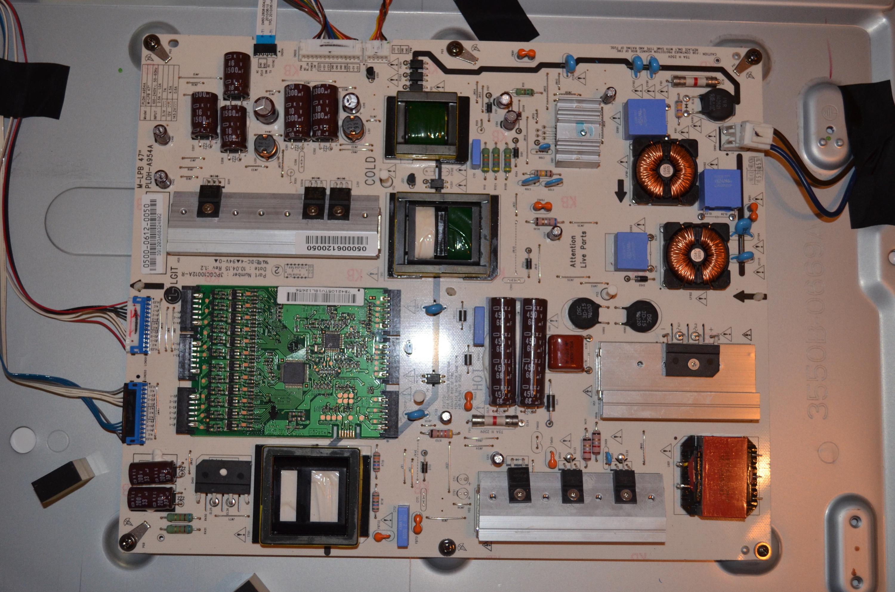

    Hello bjhunnicutt, could you also post a clear picture of the circuit board shown within the white box.

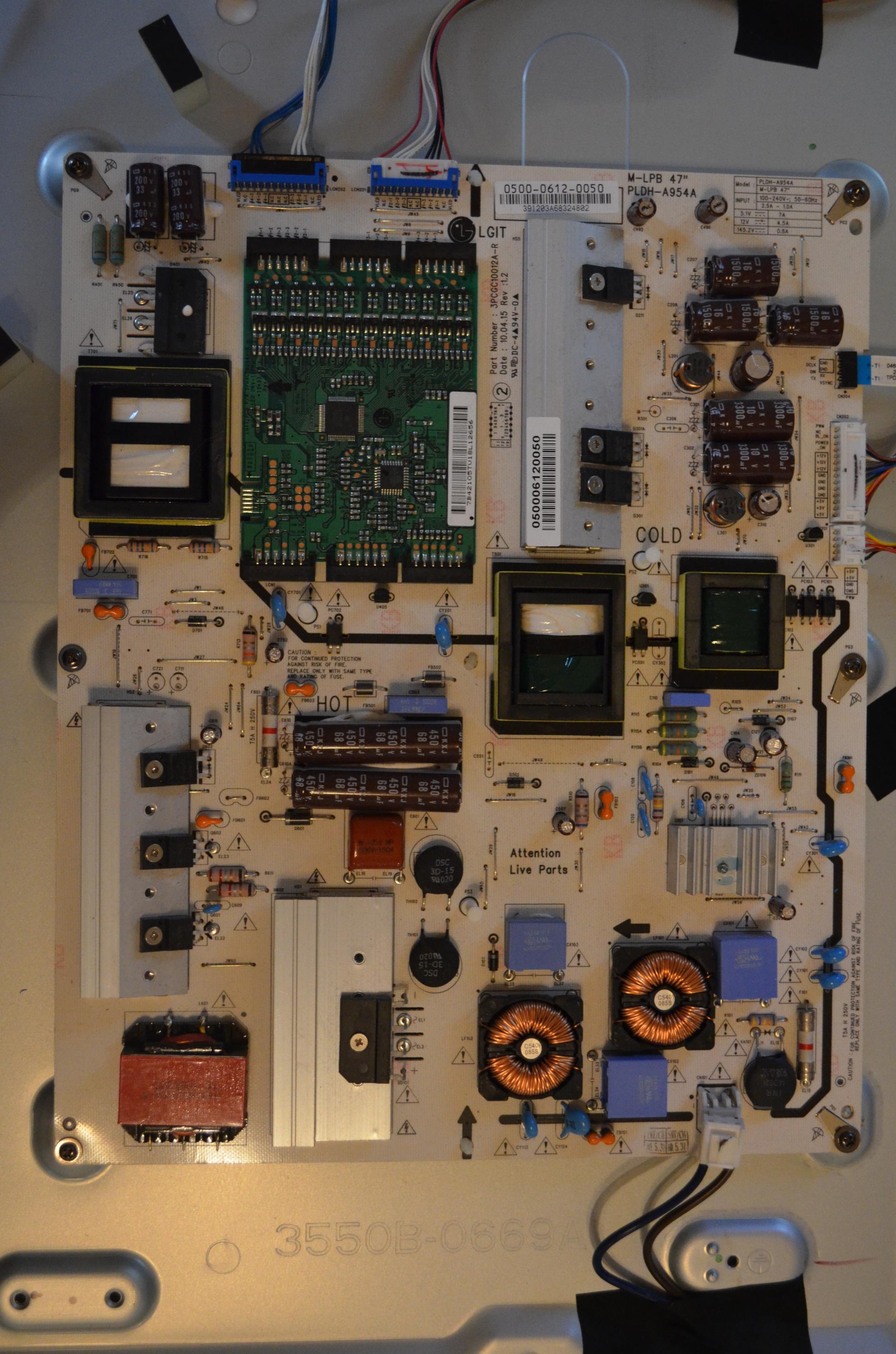

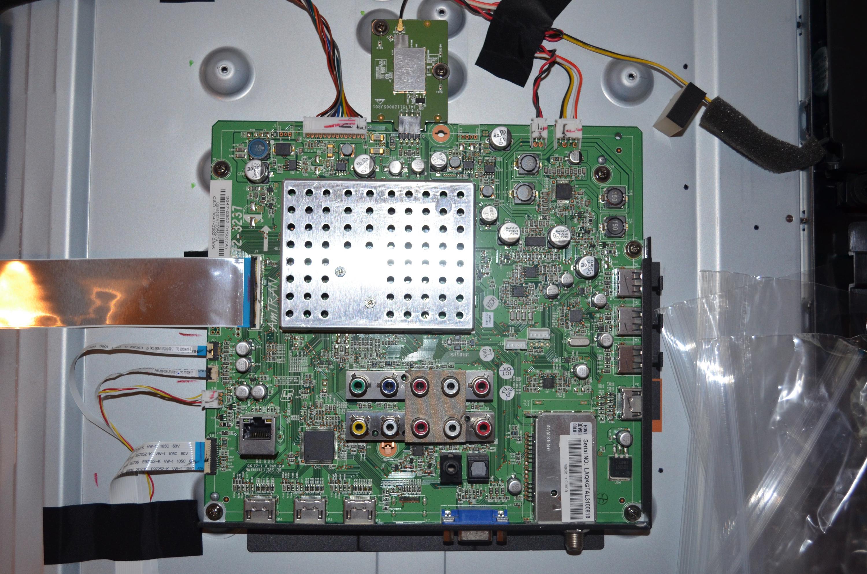

            Re: Vizio M470NV will not turn on
            Here are some higher resolution photos of my boards.

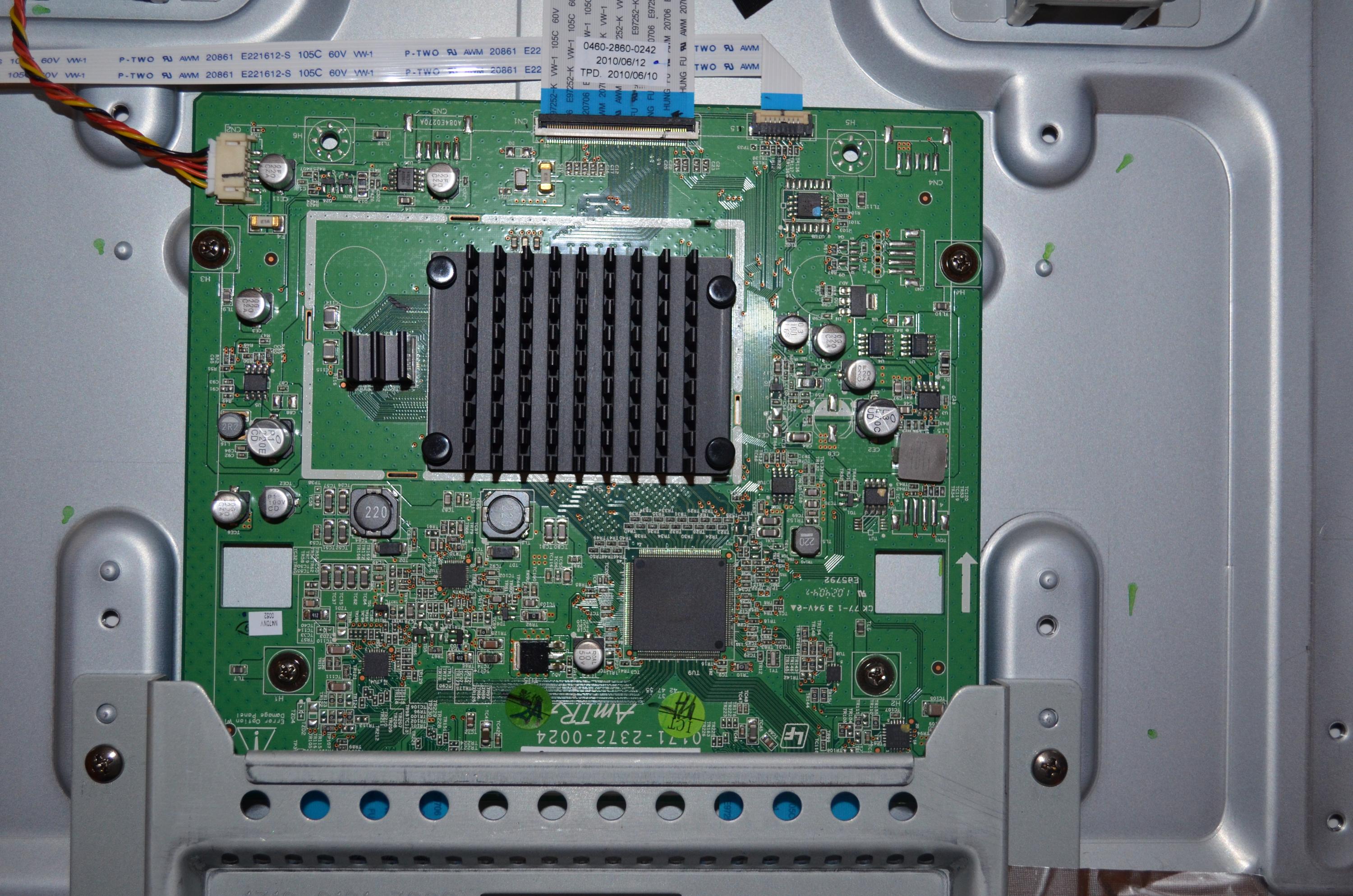

              Daughter Board
                Post 12 has a clear close up of the 5v/12v/Pwr on section of the power board
                Post 18 has a clear close up of the LED connectors
