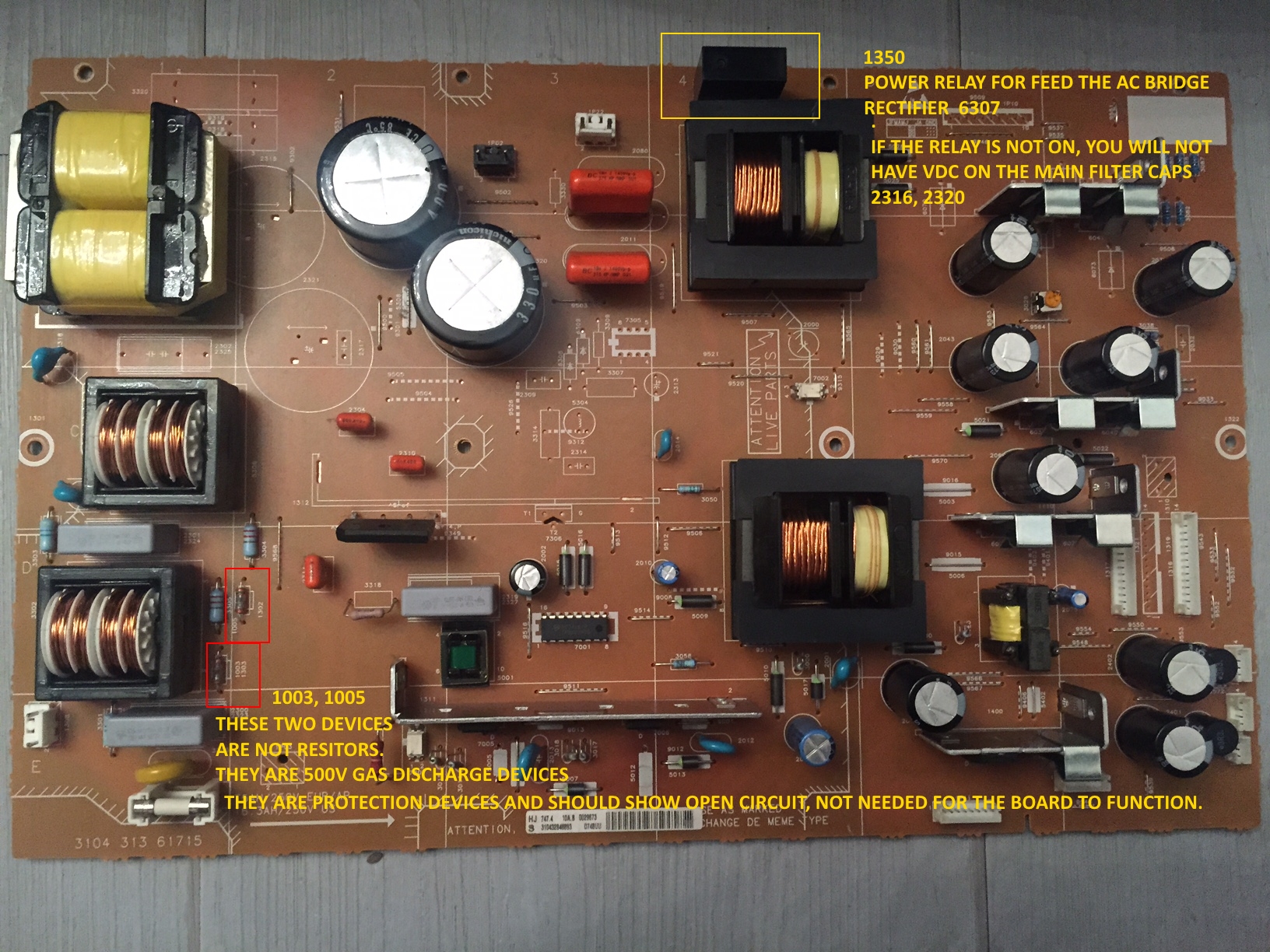

    Re: tv lcd Philips 42pfl9632d/10 Power board ko
    Originally posted by Diah
    on the hot area near to the ac in after the IC big caps, - & + with DC read how much volts DC YOU HAVE IT SHOULD be 350 to 400 Volts
    Do you mean in the black connector?
          Originally posted by Bibu
          Diah i know that in the black connector ther is ac current, for this reason i say Where do you mean that i must make the test...
          be careful. you ahve 2 dick caps 330uf with DC - and + you need to read it had DC and how much

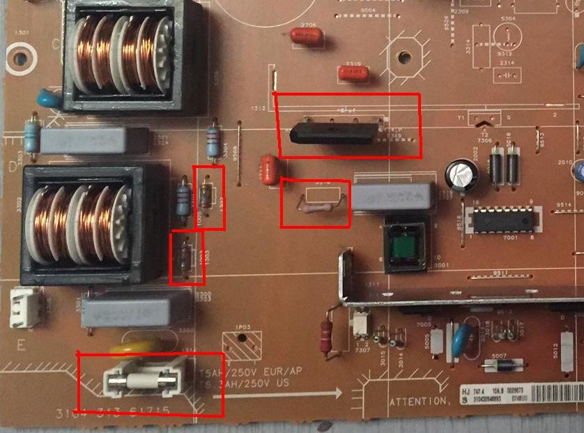

            i think you dont haave volts at all on them because i can see you have burned Resistor and the AC-DC IC 100% defekt
            so if no volts you need to replace these in the photo.
            sorry cant help any more.
                Devices 1003, 1005 are protection device (500V Gas discharge/sparkgap), they should show open circuit, they are NOT RESISTORS, they are for protection an not needed for the circuit to function.
                R3318 (for 25V PS) you have already tested.
                You will not have DCV on the two filter caps if the relay 1350 is not activated.
                You still did not indicate if the main fuse have blown or not with those two shorted out MOSFETs you have indicated.
                  I tested the Dc on the two caps and is 0.
                  The fuse is good.
                  But know i have a news... There isn't video, there isn't light and led, but there is a noising sound from the speakerslike a zzzzzzzzzzzzz
