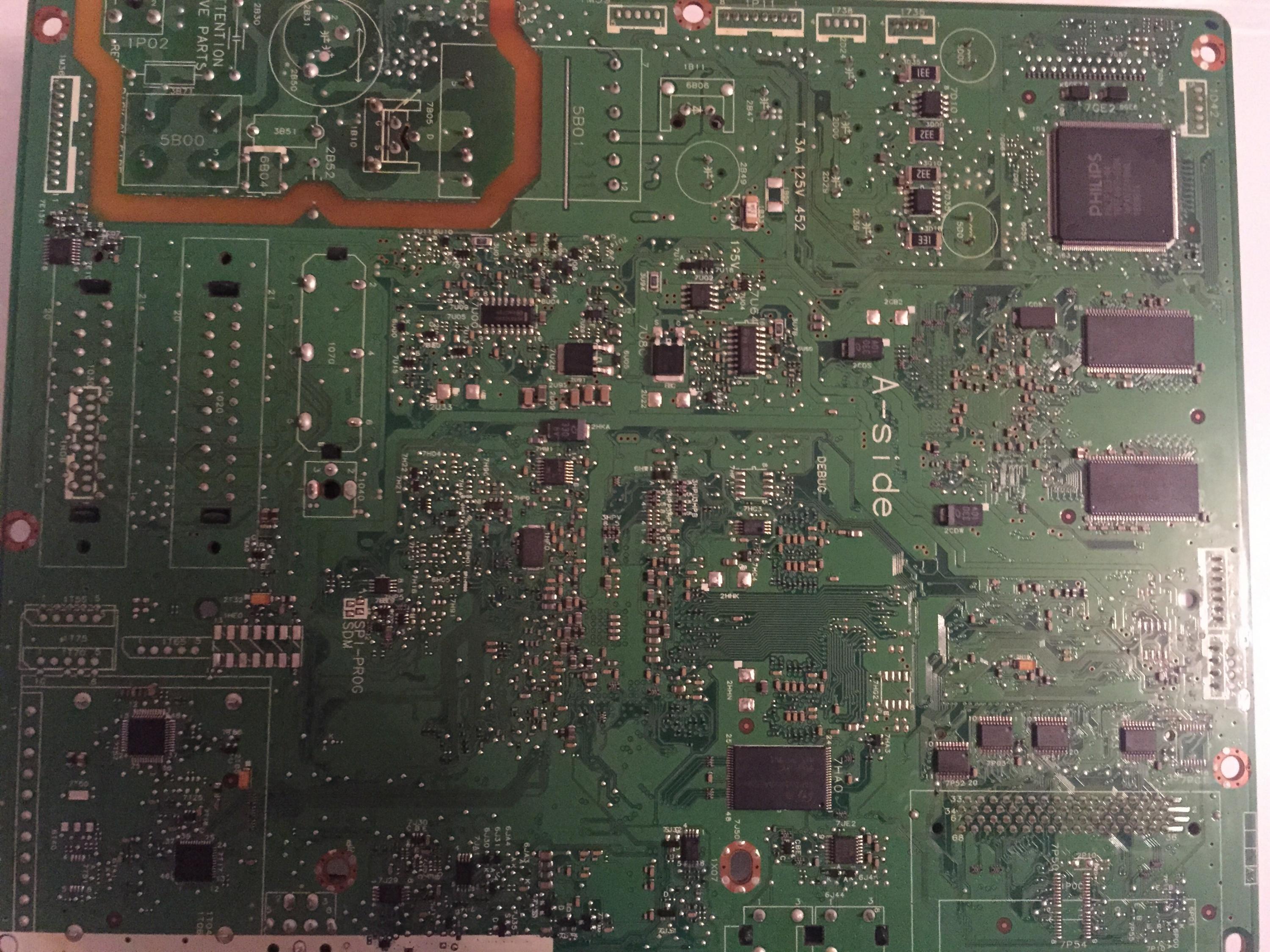

                      The relay is turned on when the main power supply board receives the 5V from the main board power supply. I do not get to see good clear pictures of the whole boards in post 58, I waisted so much time with OP on the 100 Ohms resistors already, plus try finding the diagrams, etc. and not getting any where with the OP.
                        #71
                        Re: tv lcd Philips 42pfl9632d/10 Power board ko
                        Budm sorry for all time that you waist with my problem, i think that a thanks isn't enough.
                        See if this picture is better, or is better two different photos of the same board?
                          #72
                          Top and bottom side of the main board so we can look at the small power supply on that main board? We need to get that 5V from the main board power supply.
                              as budm says once you get good clear pictures of the main board we can try too help you
                                #75
                                Here the photos of the mainboard
                                  #76
                                  Front side
                                    #77
                                    You will need to re assemble all the boards and connectors the on top right if the main board theres a oblong fuse by the black connector what dc volts do you get on each side of this fuse.
