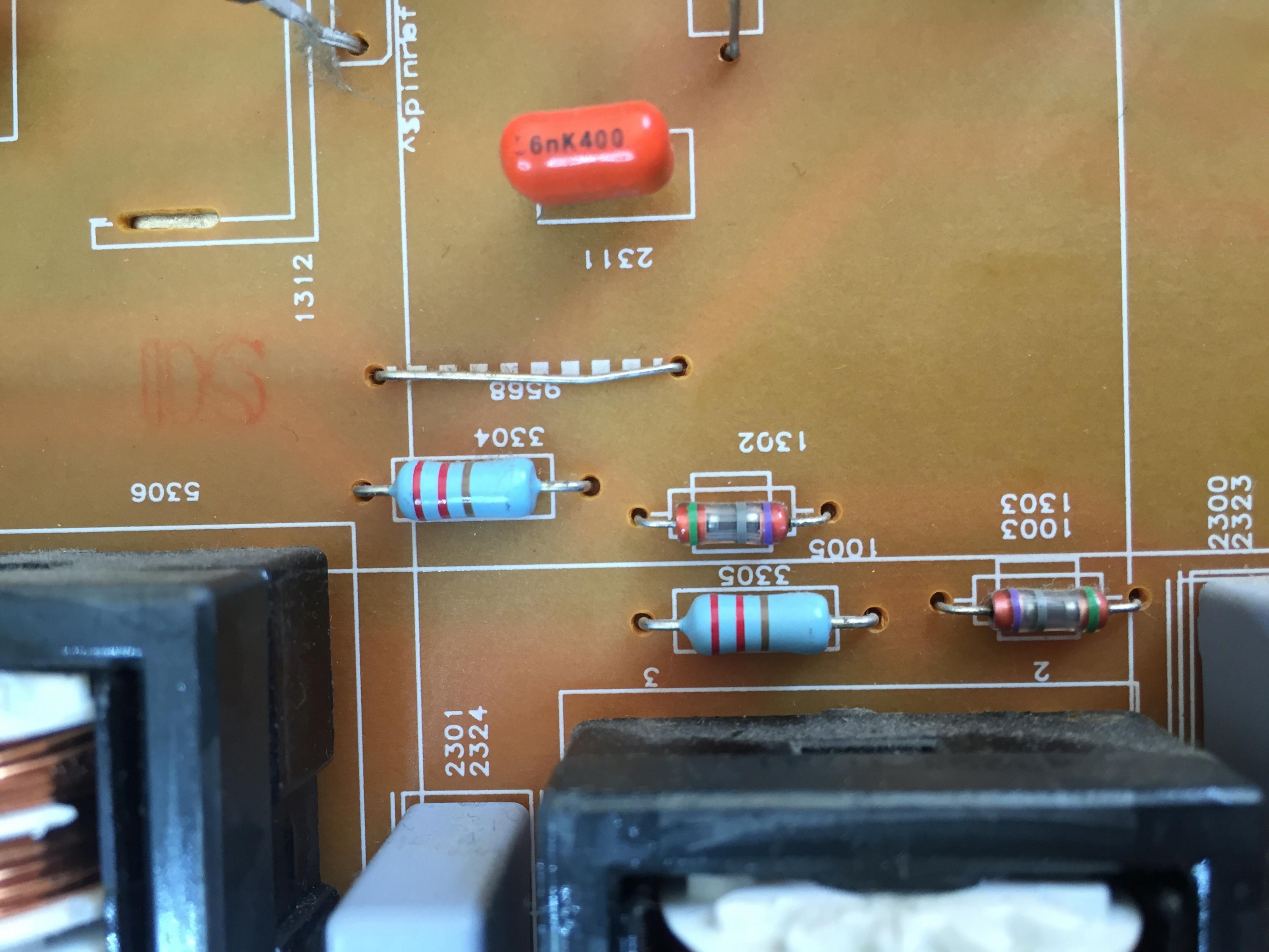

    3305 and 3306 are resistors?
      #42
      Re: tv lcd Philips 42pfl9632d/10 Power board ko
      have you got a picture? i havnt downloaded a service manual myself but a picture will tell us what they are
        Ok this is the photo
          #44
          yes they are both resistors what do they measure?
            #45
            230 ohms
              #46
              yes thats about right for them

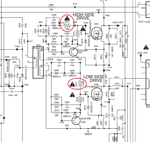

                3304, 3305, 1005, 1003/1303 are part of the protection circuit, they are not the problem, they are not needed for the board to function.
                You can see how they are used in the SCH I attached.

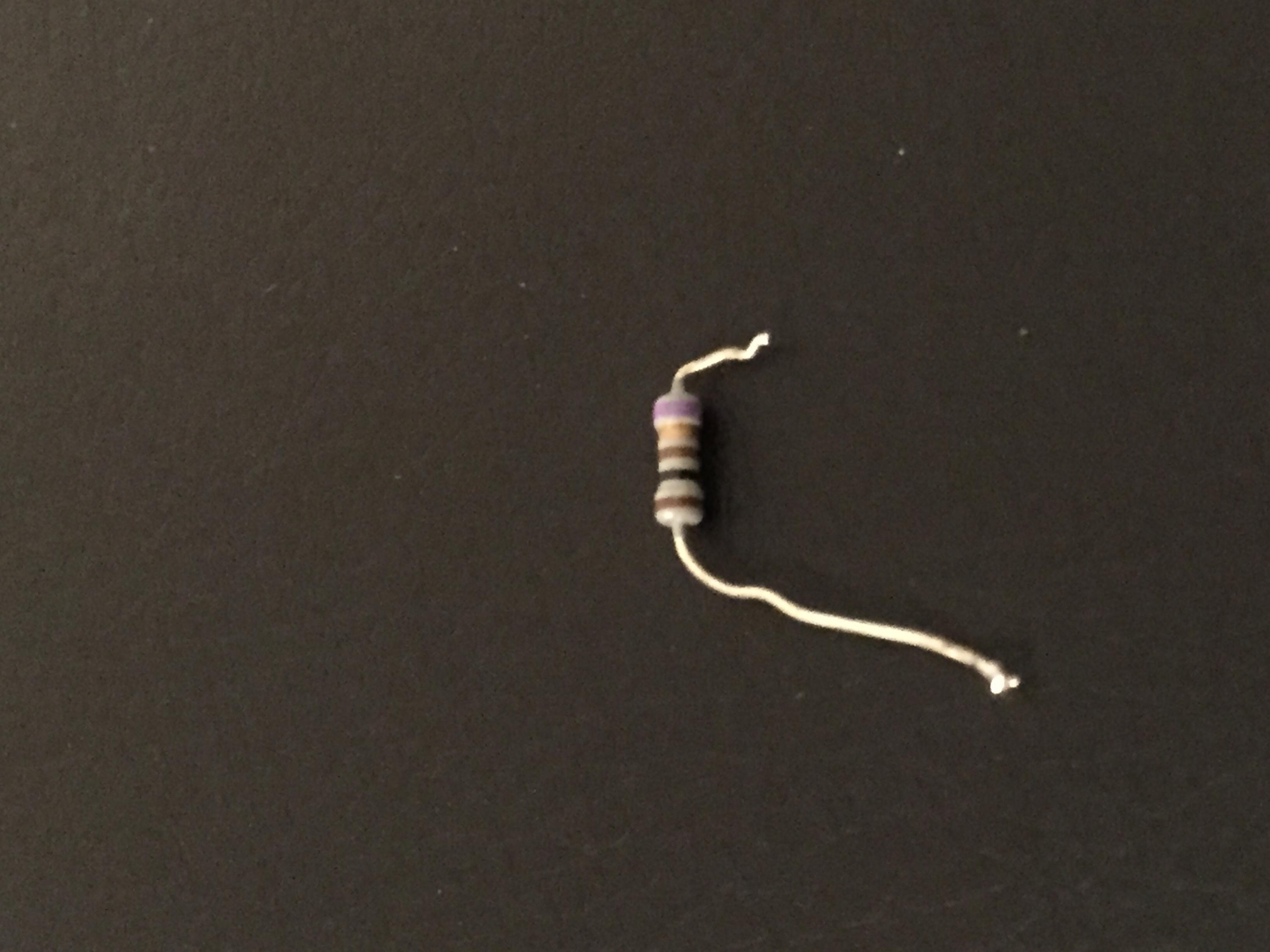

                  But it's possible that a 10 ohms resistors at the test Give 96 ohms?
                    #49
                    If the resistor is marked as 10 Ohms and it is tested as 96 Ohms, then it is bad, you can also remove it from the board to test it also since any residue Voltage left on the board will also cause the Ohm to read wrong.

                        If you look at the SCH I provided, you will see that 3014, 3017 are 100R resistors which are 100 Ohms resistors, not 10 Ohms resistors.
                        So are you for sure that the MOSFET 7005, 7006 are really shorted out because you said it did not blow the main fuse.
                        Right now we need to fins out what DCV you have on the cold side of the power supply connectors.

                          Budm but the resistors that i post Now in photo aren't 10 ohms? All calculator program tell this.

                            That is 100 Ohms resistor (Brown, Black, Brown) 5% MOX (Metal Oxide) Flame proof.
                              #54
                              Isn't brown black brown GOLD and violet?

                                R3014, 3017
                                We are not getting any where here.
                                Recheck the MOSFETs and show the resistance reading between S and D.

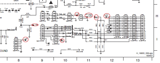

                                  Main power supply board connectors.
                                  Do you have 5V2 (notes: this Voltage is generated by the power supply on the main board, chassis GND ref.)? See the large version of the SCH.
                                  Do you have 25V_HOT (GND ref to negative leg of main filter cap in the DC primary)?

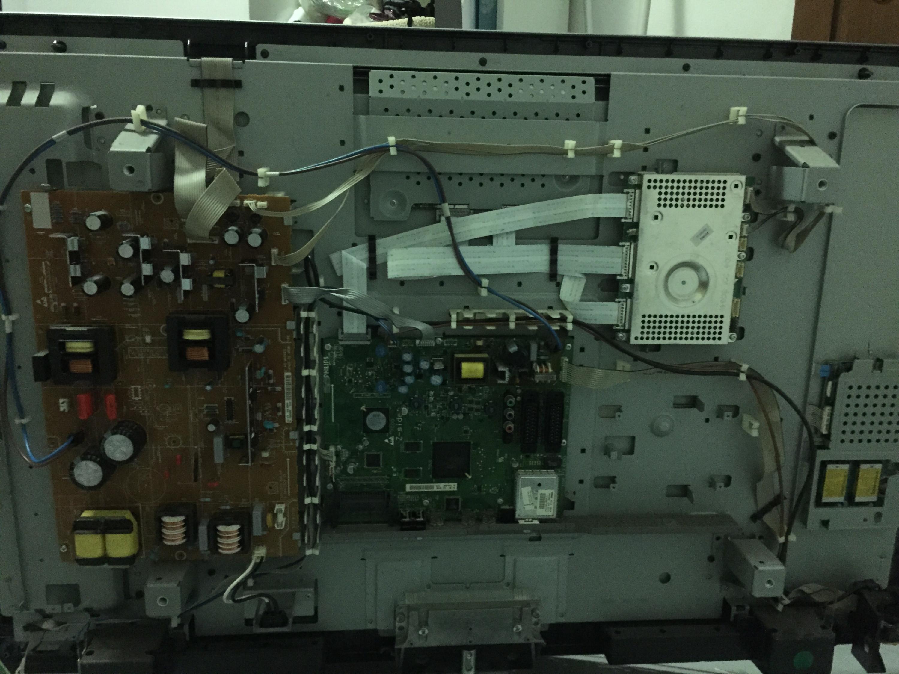

                                      The 5V is generated by the power supply on the main board, so you need to find out of the main board is getting the main AC feeding the 2-pin power connector on the main board or not.
                                      It is time for you to upload pictures of the whole back side of the TV so we can see all the boards and how they are connected together.
                                      What is the history of this TV? Was it hit by power surge? drops? someone worked on it before you? etc.

                                        the tv is mine, no power surge, no drops... some week ago decide to die, without motivations. no atoner people work on it before.
                                        as soon as i will post the photo of the back side tv.
                                        The strange is that the speakers are connected to the main board... if there isn't V, why they work?
                                        i say alone. the main board take directly the 220V AC from the black connector of the power supply, for this reason the speaker works
