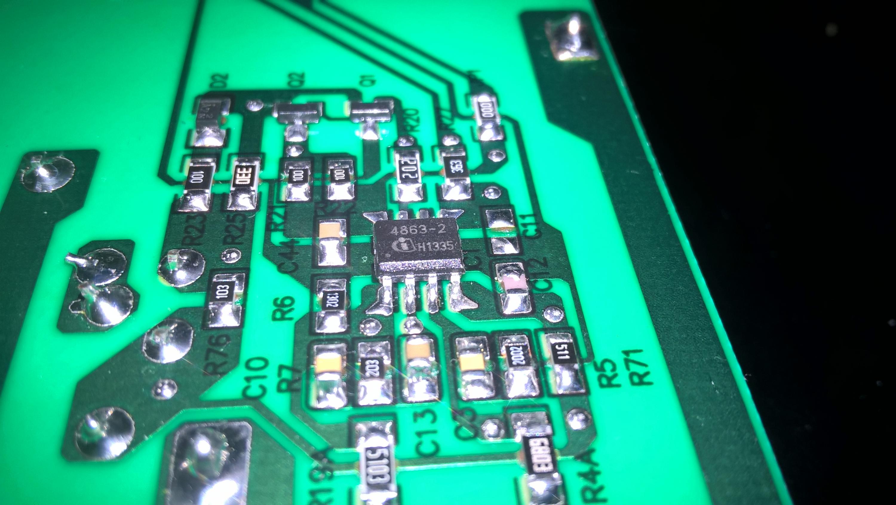

                            Need to get the P/N of that PFC Controller IC to find out if it is getting the VCC to run when PS-ON is present.
                              Re: Rca led50b45rq
                              Here is the P/N for that IC:
                              4863-2
                              H1335
                                Re: Rca led50b45rq
                                this should be the data sheet maybe measure pin 8 vcc pin and see what voltage you get
                                https://cdn.badcaps-static.com/pdfs/...7e28445b8e.pdf

                                    Re: Rca led50b45rq
                                    yes just be carefull your probes dont slip etc as dont want too cause more dameage whilst your testing the ic you might as well take all the pin readings in one go.
                                      Re: Rca led50b45rq
                                      Here are the results:

                                        Re: Rca led50b45rq
                                        Can you verify that PS-ON Voltage did not drop out when the VCC drops down to 0?
                                        You are getting the same VCC Voltage drops out on the SMPS IC too, same power supply is used to supply the VCC to both ICs which is generated by the AUX winding of the standby power supply transformer that I drew up the diagram in the picture for you to trace out the Voltages.
                                          Re: Rca led50b45rq
                                          PS-ON remains a constant 3.54v regardless of the VCC drop out. Also, with the LEDs unplugged, PS-ON is a constant 4.89v.
