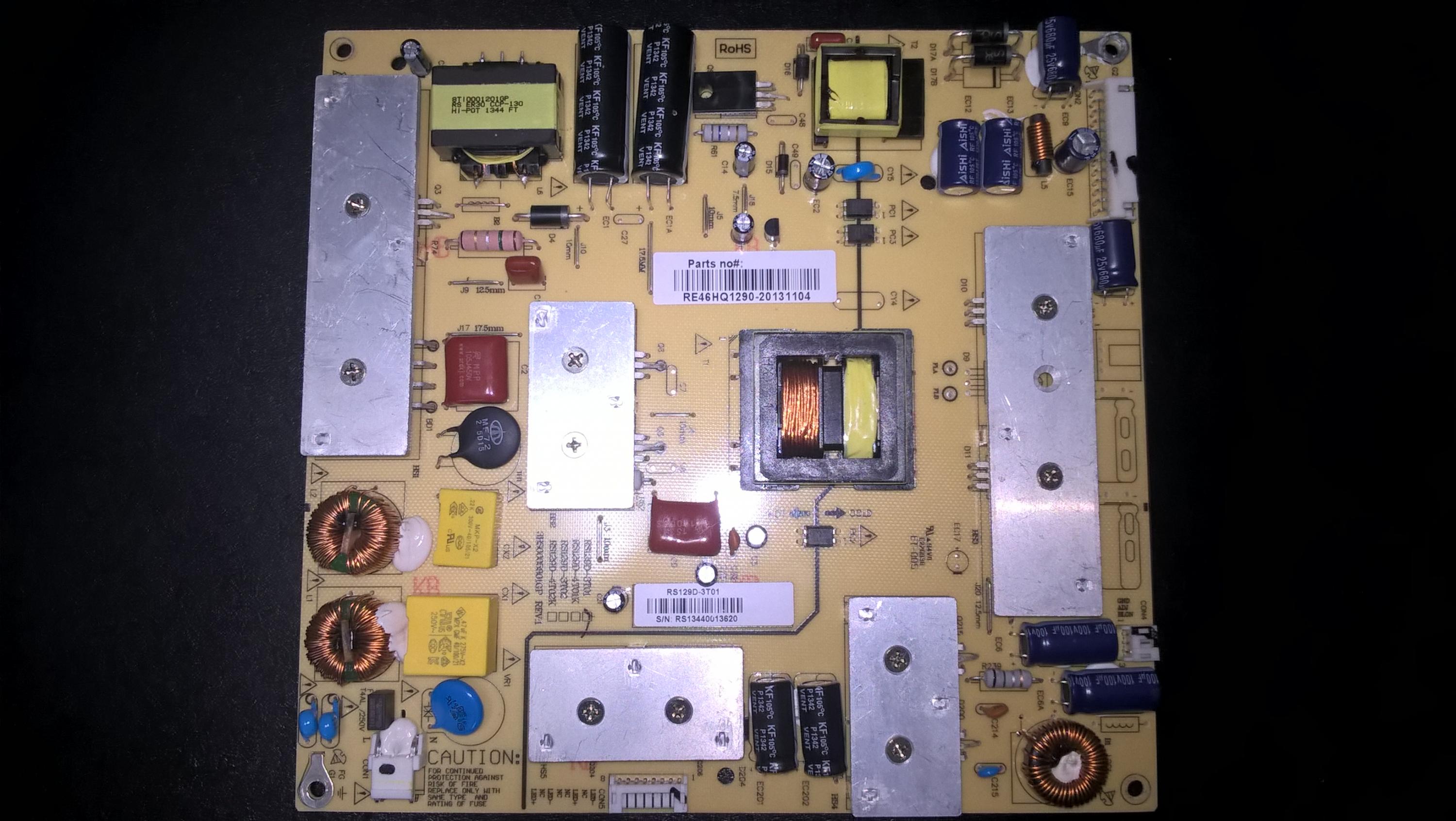

                    Re: Rca led50b45rq
                    I have the same exact model with the same power board, however my issue is slightly different. When i plug the tv in the red standby light comes on. When i press the power button it turns off, however the blue light DOES NOT come on. There is no indication that the set is on.. No picture or sound. If i press the power button again the red standby light will come back on, and continuing to press power continues to switch the standby light on and off. I got this tv from my brother because he didn't want to fix it. The very first time i turned it on there was a very brief horizontal line that flashed along the upper-mid section of the screen, but since then this hasn't happened again. The caps and overall appearance of the main power board is excellent. I've considered the possibility of a blown SMD fuse or bad EEPROM, but I'm not certain of anything at this point. I can't seem to locate the fuse on this board either, however i haven't yet removed the entire black cover on the back of the board. Any help is greatly appreciated! Thanks
                      #30
                      Re: Rca led50b45rq
                      You can start by providing good clear hi res pictures of what you have, same model TV can have many versions of the circuit board, LCD panel, etc.
                      • x_orange90_x
                        • May 2015
                        • 727
                        #31

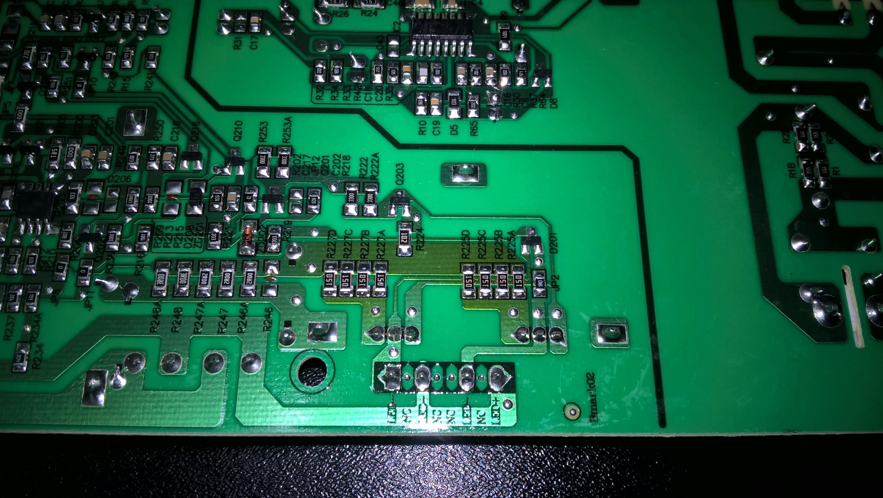

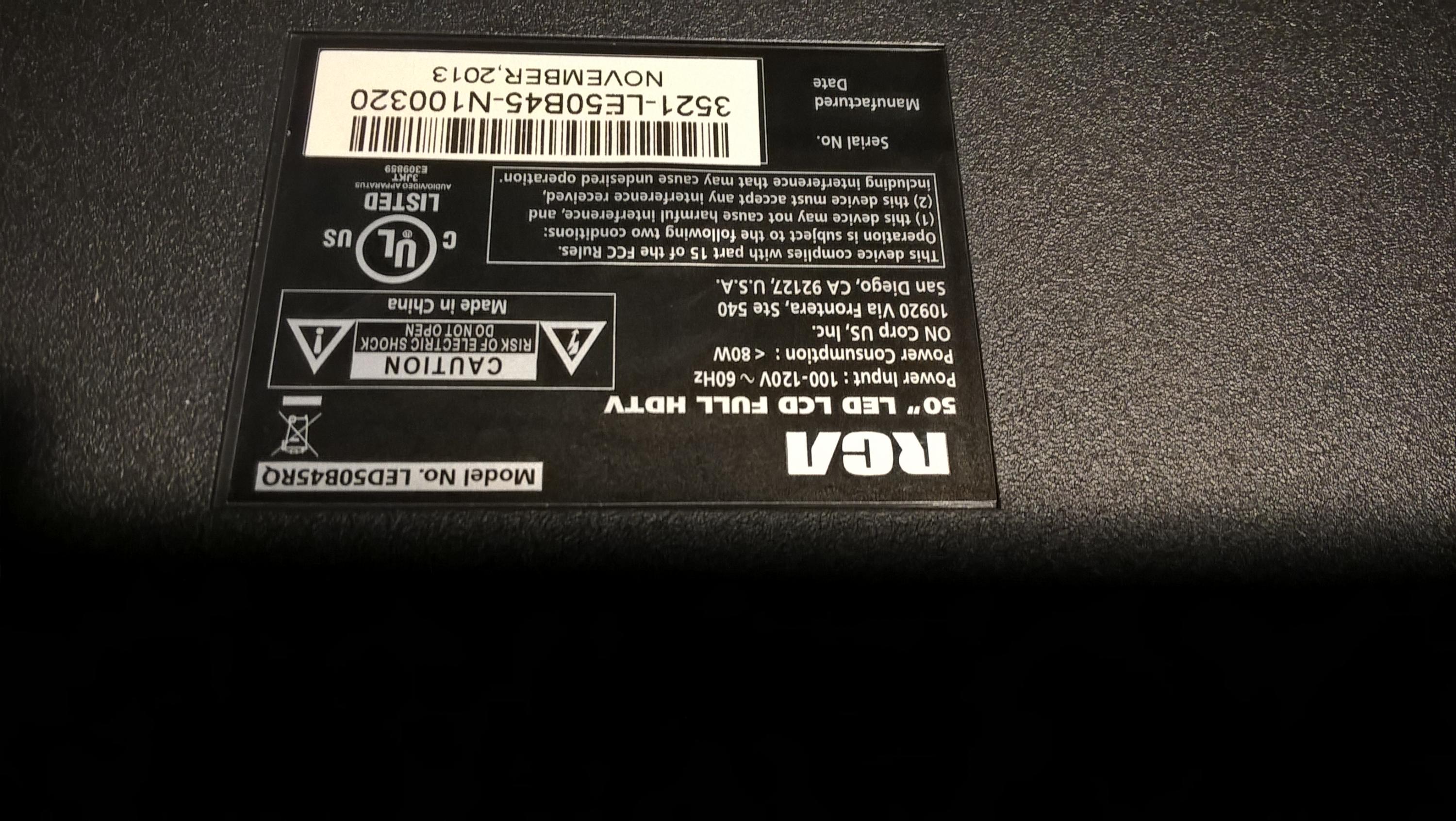

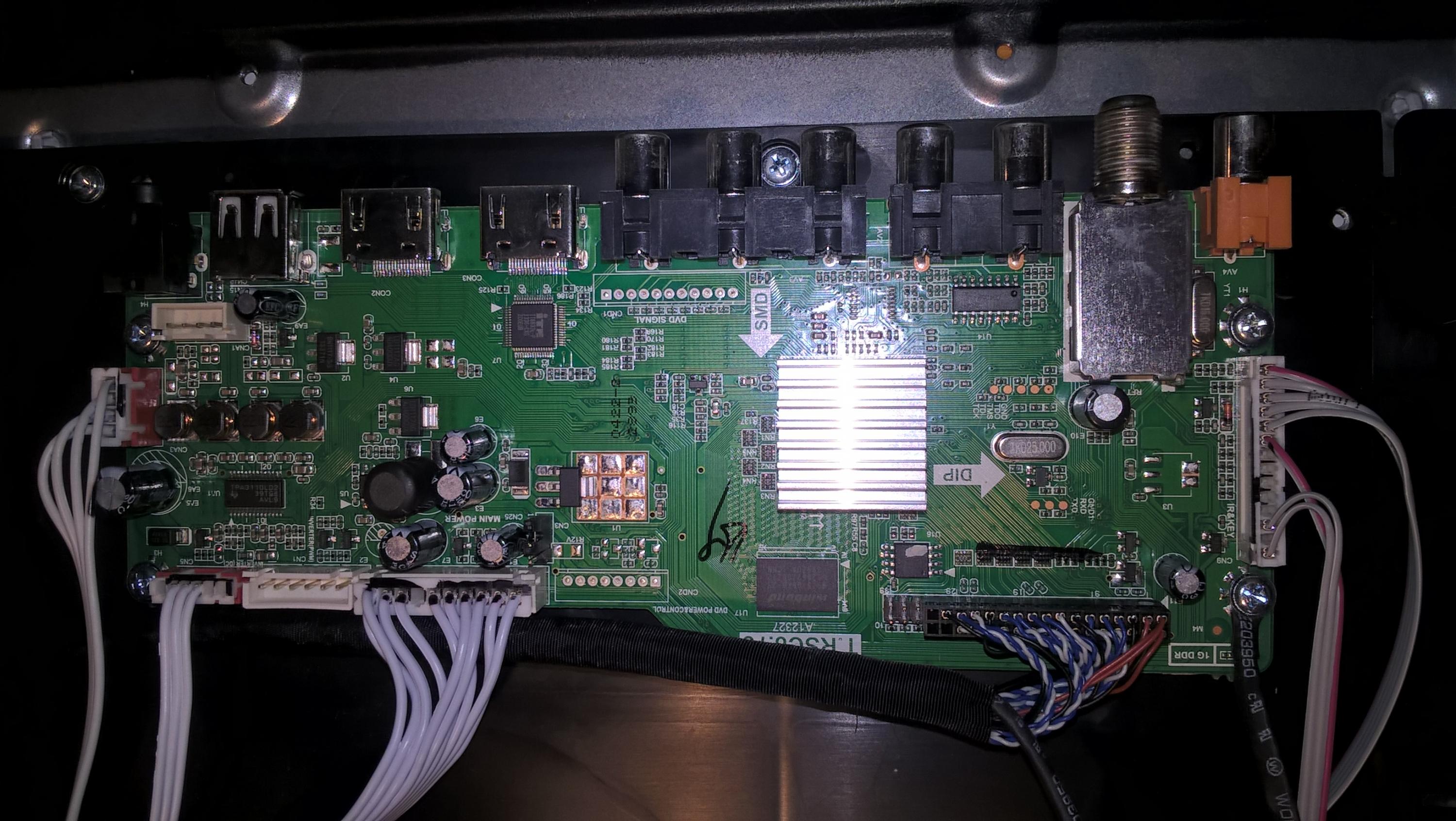

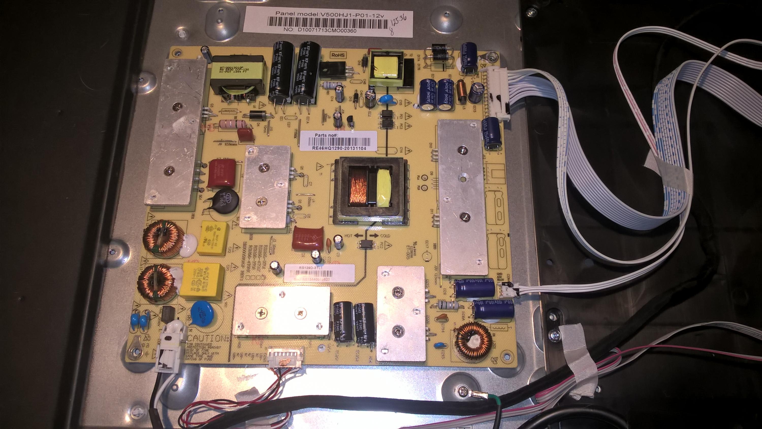

                        Re: Rca led50b45rq
                        Here is a picture of my tv model sticker, and a couple of the power board.
                          #32

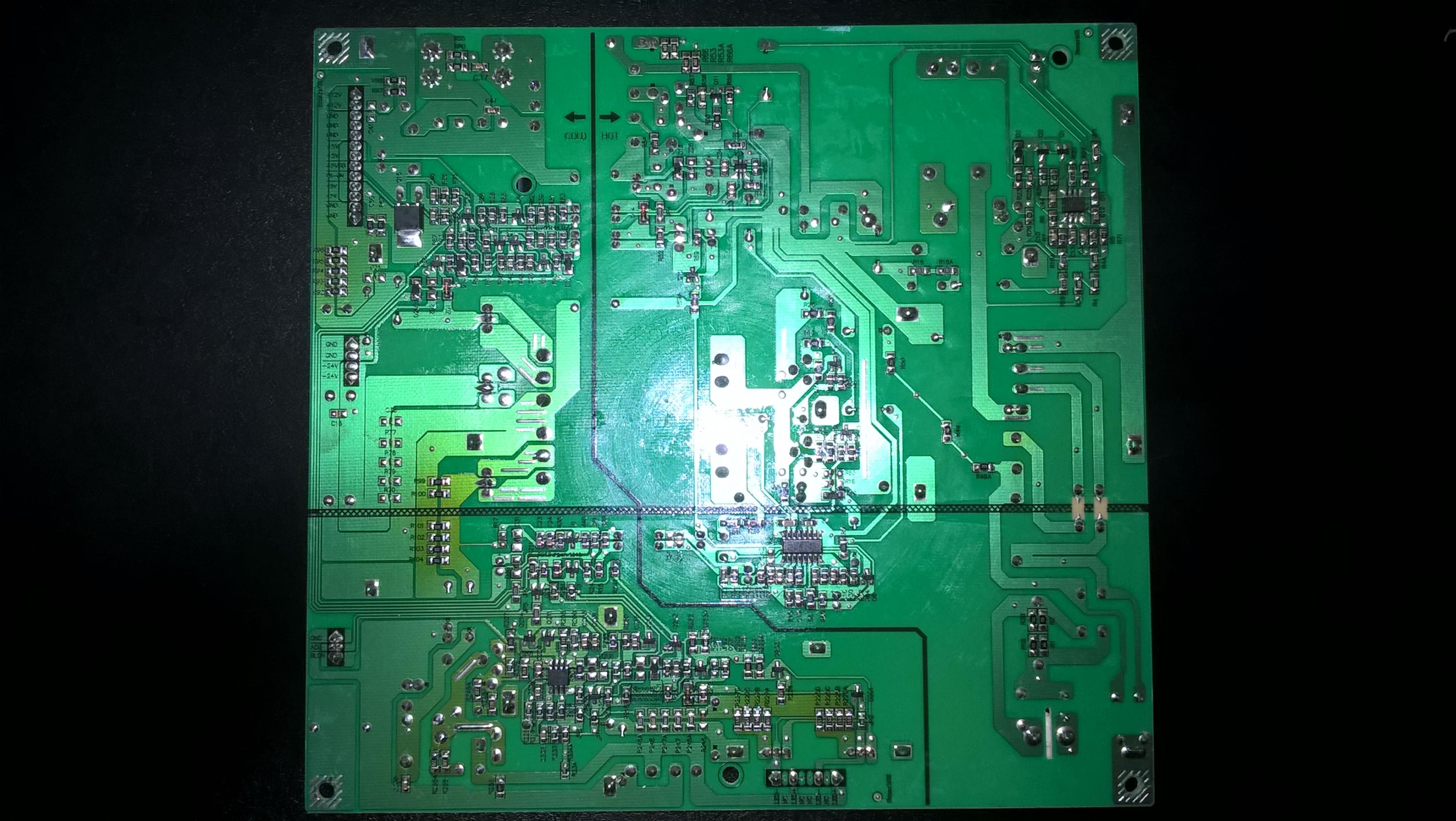

                          Re: Rca led50b45rq

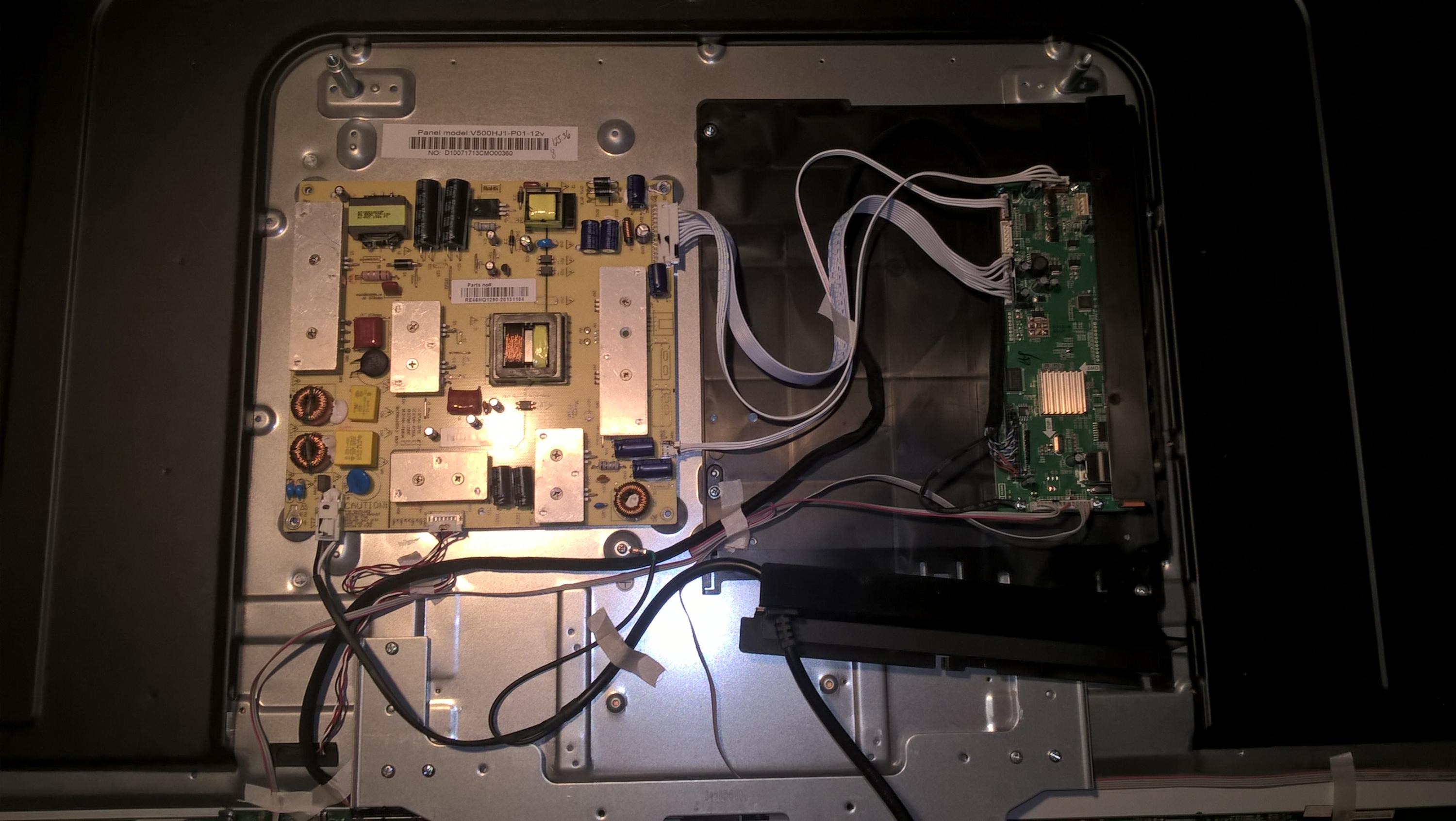

                          Can we see the whole back side of the TV showing all the boards so we can see how they are connected to each others?
                          https://www.badcaps.net/forum/attach...4&d=1489680896
                          Straight shot pictures of this top and bottom side of the board will also help so we can see the labels for the connector pins.

                            Re: Rca led50b45rq
                            I can upload them this evening. I'm at work right now and the ones i posted already are the only ones i took on my phone.
                            On a side note, i asked my question on FixYa earlier this morning and this is the answer i received: "Could be an open internal fuse of power supply falure"
                            I'm assuming they are referring to the SMD fuse.
                              #34
                              Re: Rca led50b45rq
                              Right now your power supply board is putting out at least the standby Voltage otherwise you will not have indicator lights at all.
                              We you will need to check the DCV at those two white connectors (not the AC input connector) and report the readings when TV is OFF and when the power switch is activated.
                              You need to put down the pin name and follow by the DCV reading for each pin so we can see what are there and what are not there.

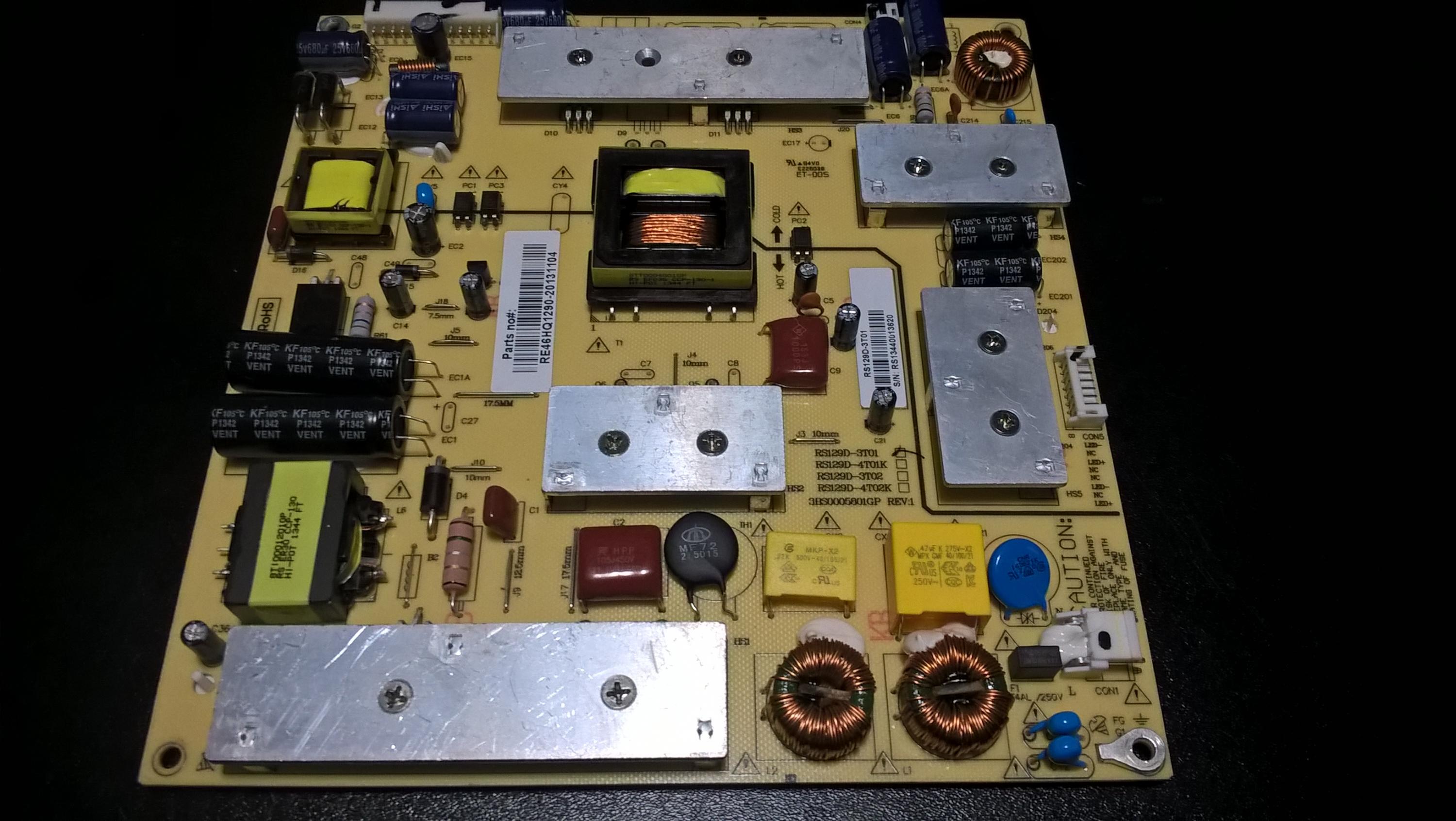

                                #35
                                Re: Rca led50b45rq
                                Here are pictures for you 😉
                                • dick_barton
                                  • Aug 2015
                                  • 6643
                                  • Wales

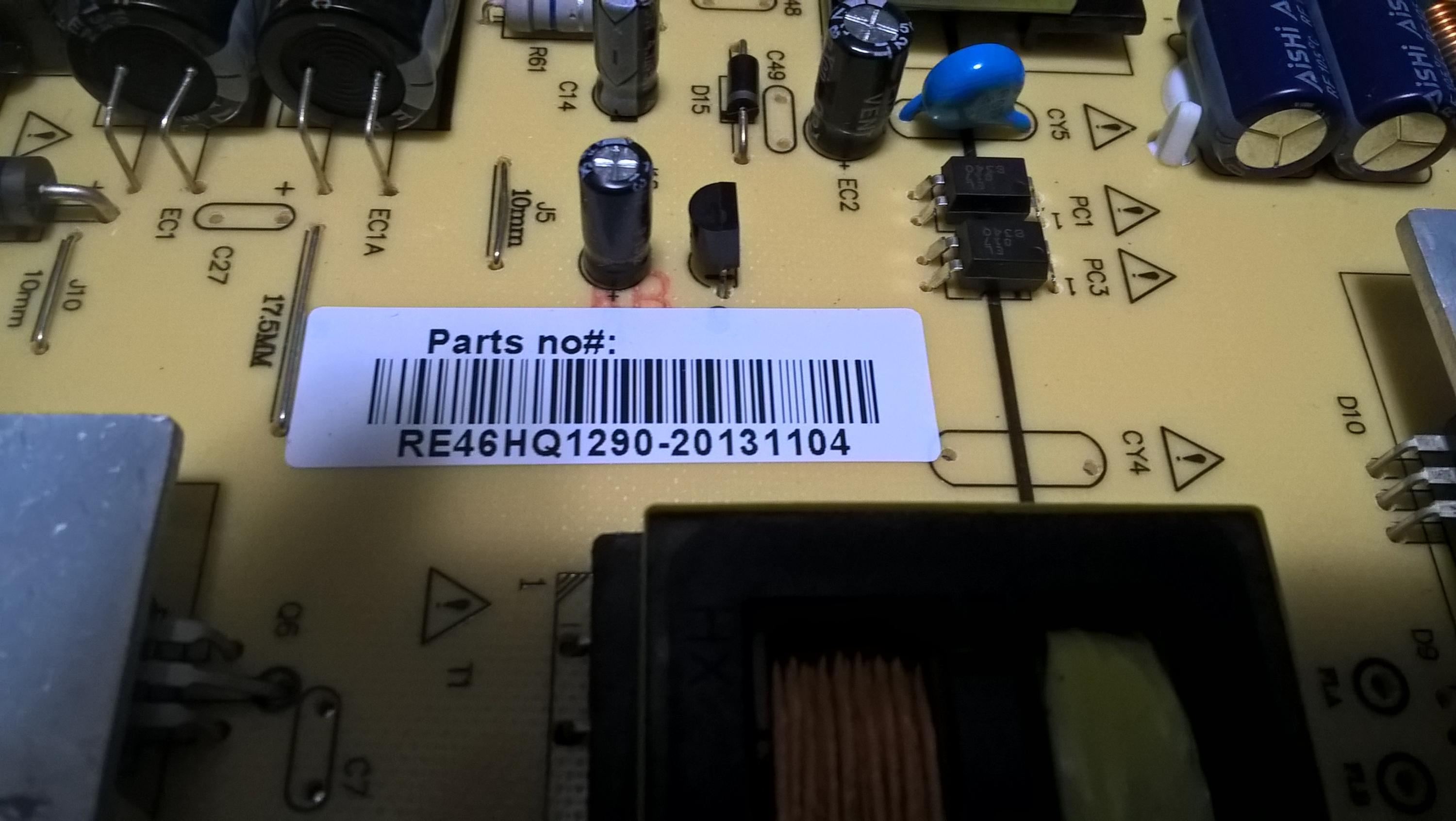

                                  #36
                                  Re: Rca led50b45rq
                                  What dc voltages do you have on those pins on picture 5 of 7

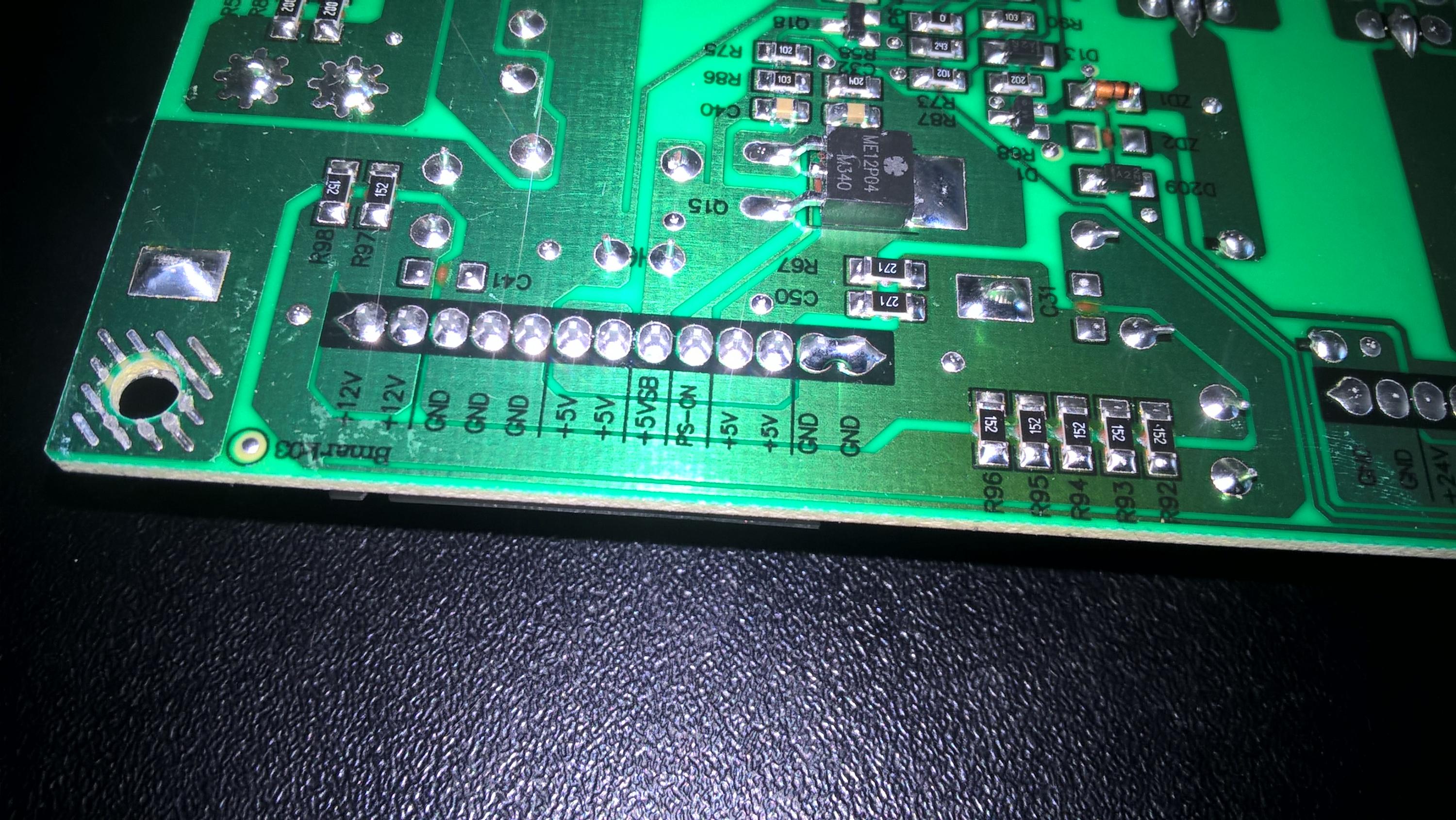

                                    #37
                                    Re: Rca led50b45rq
                                    Which pins do i probe on this connector?
                                      #38
                                      Re: Rca led50b45rq
                                      All the pins except the GND pins which is where the black probe of your meter will be.
                                      You must make sure to put down the pin name and follow by the Voltage readings.
                                      You will be reporting the readings when TV is off and when the power switch is activated, you MUST follow the instruction to make it easier for us to help you.
                                      We need to find out what Voltage you are missing on that connector.

                                        #39
                                        Re: Rca led50b45rq

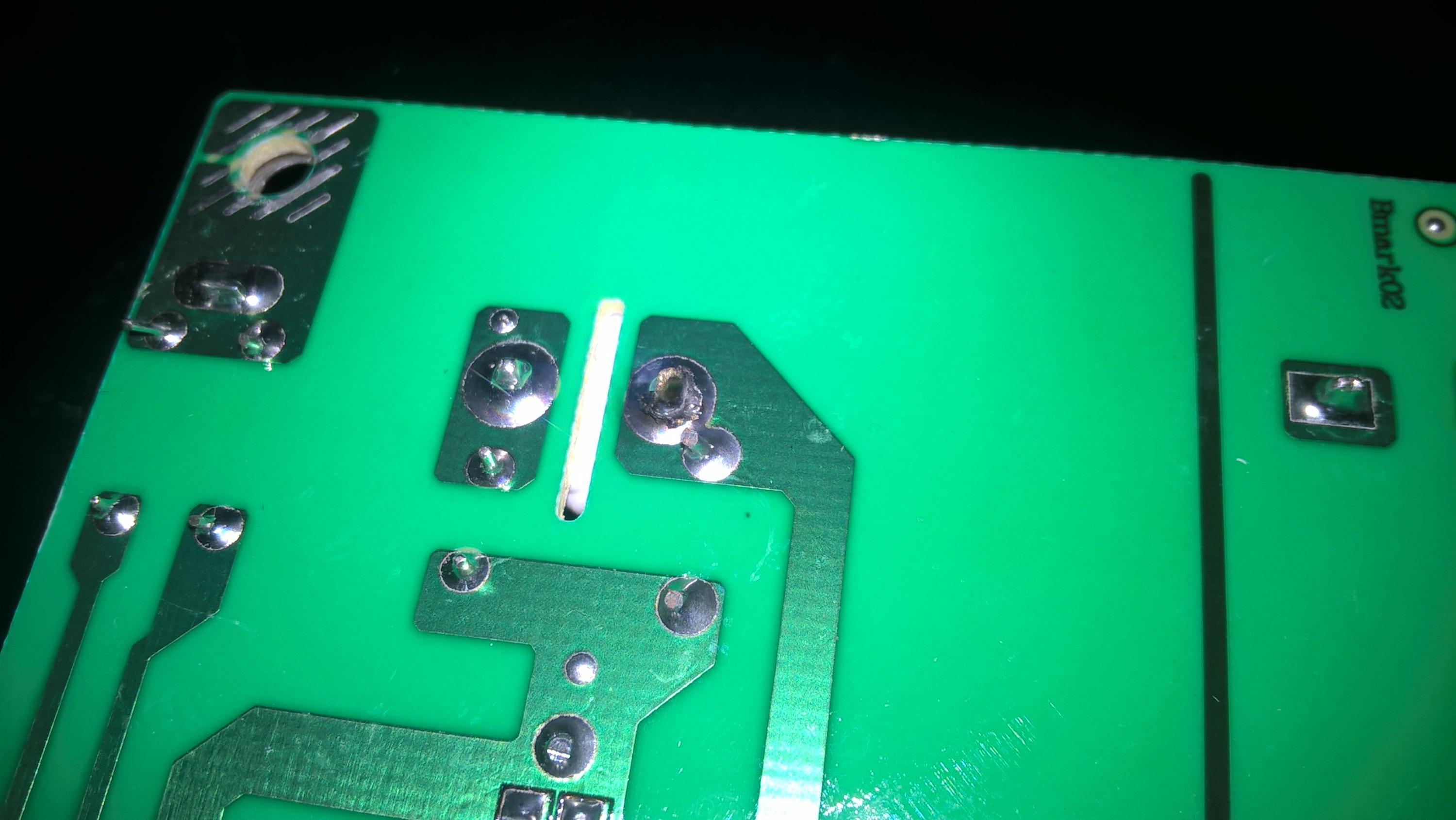

                                        Ok, so i fear this was destructive testing ☹ i shorted the main plug with my multimeter.. And it went POP! (photo attached) However, now the tv acts a little differently. When i plug it in, the red standby light still comes on, but now when i press the power button i get that horizontal line i mentioned before followed by a quick flash on the screen. Also, pressing the power again now does not bring back the standby light as it did before. But the line and flash can be repeated everytime i unplug, replug, and turn the power on.
                                        Anyway, as for the readings I got from that connector.. Everything reads 0.00-0.01 both in standby and with power on, except for +5VSB and PS-ON. Those are as follows:
                                        +5VSB -- Standby 5.17V On 5.17V
                                        PS-ON -- Standby 0.00V On 3.54V
                                        Readings were taken AFTER i shorted the main plug, so I'm not sure if i made things worse or if they were like that before.
                                        The burnt solder in the picture is the only evidence of the short I created, but i fear i have done much more damage than that.

                                          #40
                                          Re: Rca led50b45rq
                                          What are the IC numbers as printed on them.
                                          What dc voltage do you have between the two legs of EC1 and EC1A when out of standby (On)
