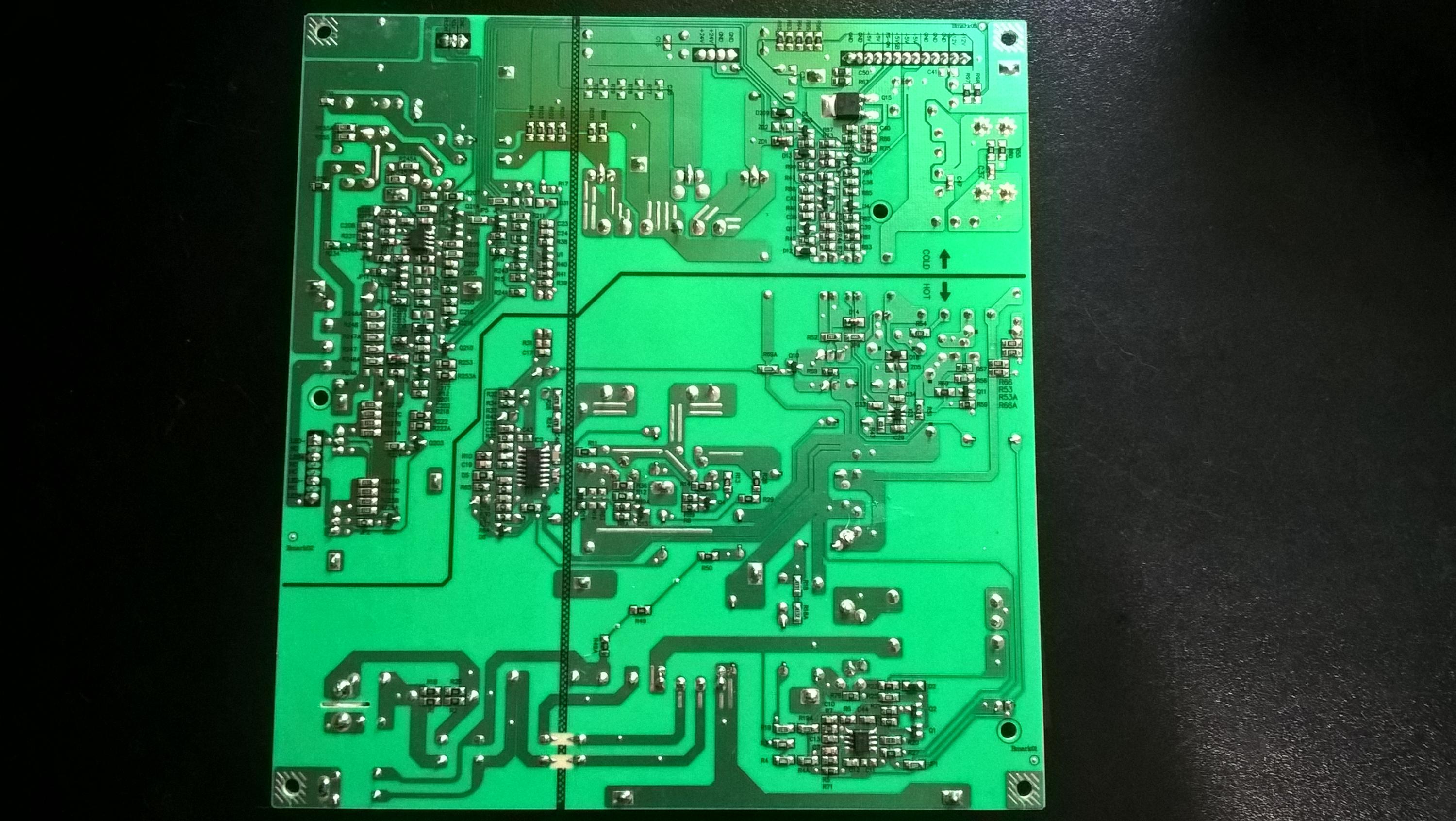

                      We are going to need real hi res straight shot pictures of the top and bottom side of the board without all that glare so we can easily see the traces.
                        #91
                        Re: Rca led50b45rq
                        Here is the best i could do without creating a glare again.
                        Edit: I added a couple more pictures with light shining through the board from both sides. PIN 12 (VCC) is the pin that lines up exactly with the left side of C4 (fourth pin from the right).

                          Check DCV at Collector of Q10.
                            #93
                            Re: Rca led50b45rq
                            Thank you for the diagram! Do i just need to check the points you've labeled + and -?

                                        So that Q10 Emitter has about 13VDC, but you are getting only 0.28V ON PIN 12 of the PFC IC.
                                        As you can see in the picture that I marked, the E is conected ZERO resistor, another end of that resistor should be connected to pin 12 where C4 is also, so verify if my tracing is correct or not. It should show <1 Ohms between pin 12 of the IC and the Emitter/ or the resistor connected to the Emitter of Q10.
                                          Re: Rca led50b45rq
                                          Your tracing appears correct. I checked resistance between the resistor 000 and pin 12, from 000 to both sides of C4, and also from the incoming side of 000 to both ends of C4 and to pin 12. I get a reading of 1 with all of them, however a couple of times i had it bounce all around from 70.0 and below when checking the incoming side of 000 to the outgoing side of C4.
