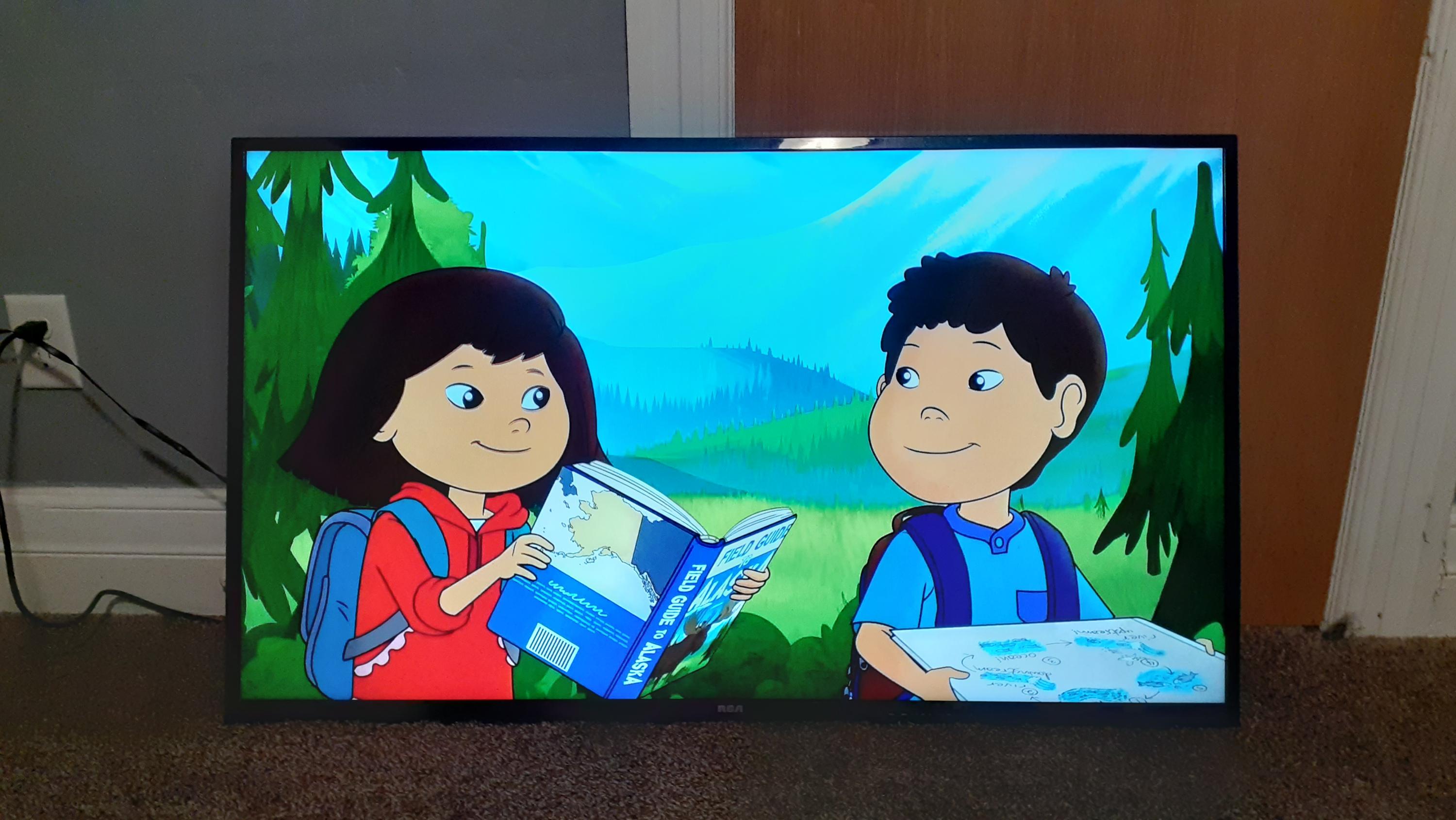

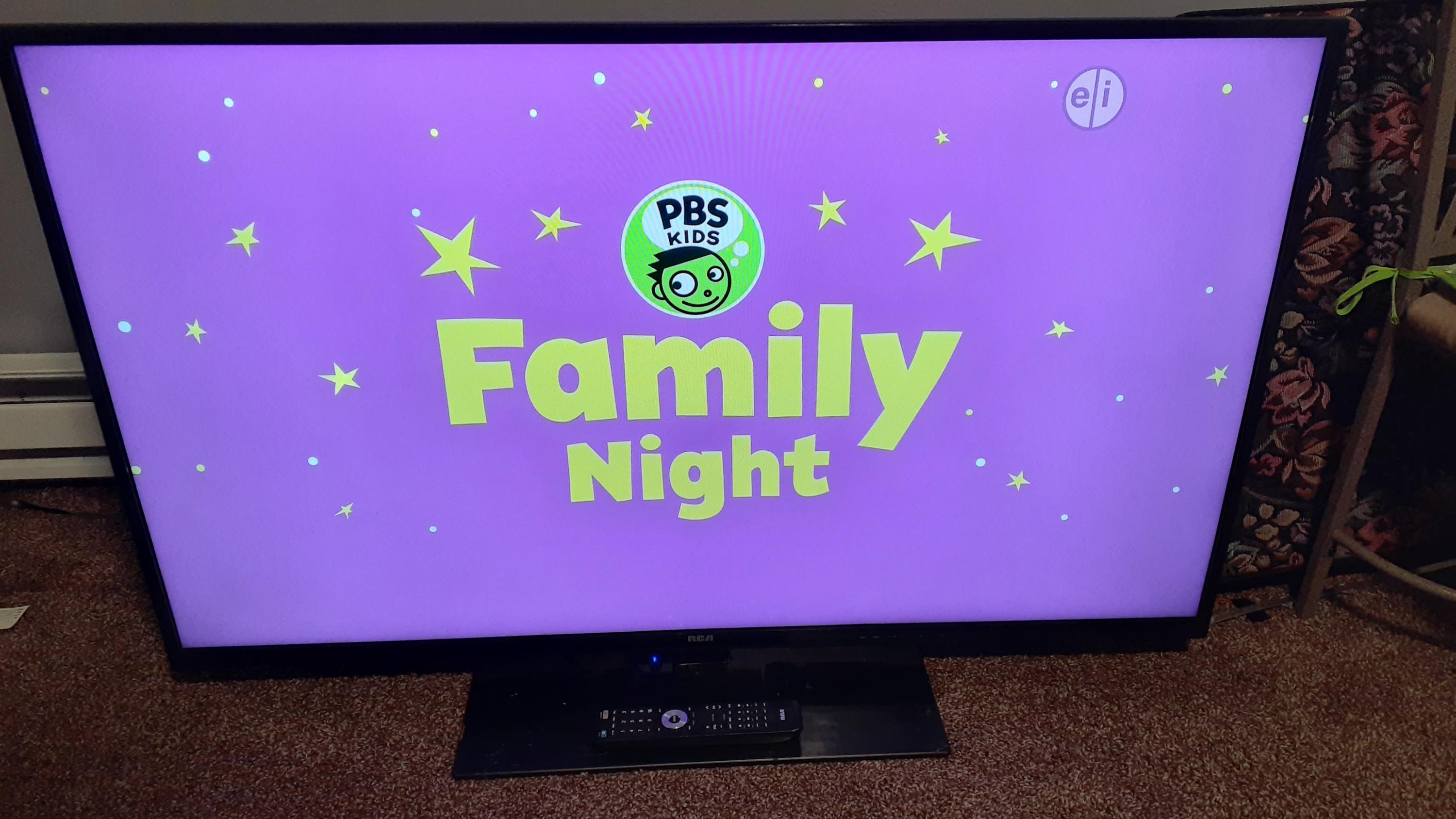

                    Just a quick update on this..I replaced the strip with the bad LED and its working great! Unfortunately this TV doesn't have a dedicated backlight setting so I can't turn it down... But I did set it to Power Save which reduced the backlights.
                    However, it's now working and that's great news since it's been sitting in my basement for about 3 years
