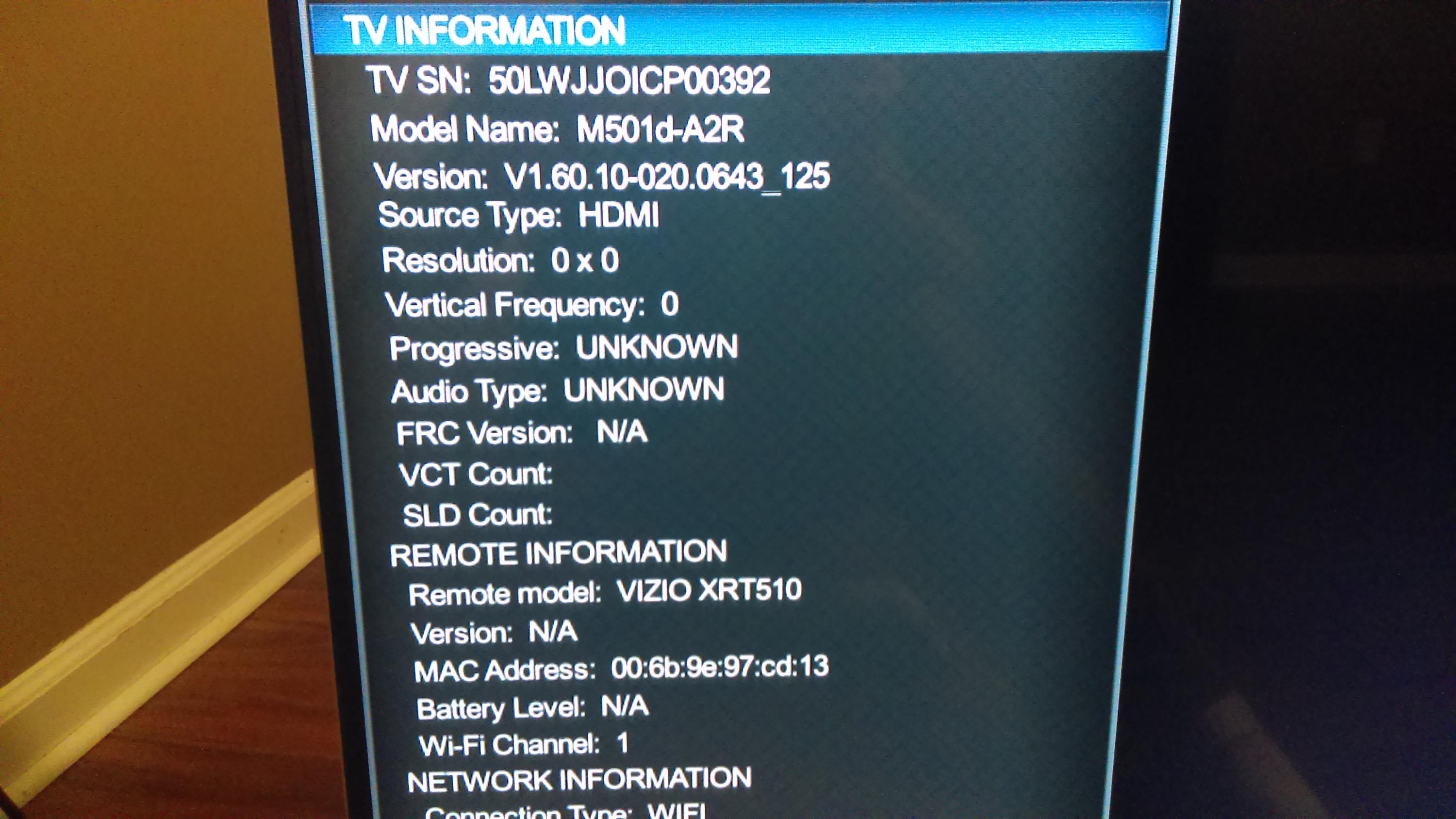

Vizio M501d-A2R screen jumping from normal to horizontal lines every 2 secs
  • snake91876
    • Feb 2013
    • 236
    TV flashes from a normal screen to lines every two secs anybody know a fix.

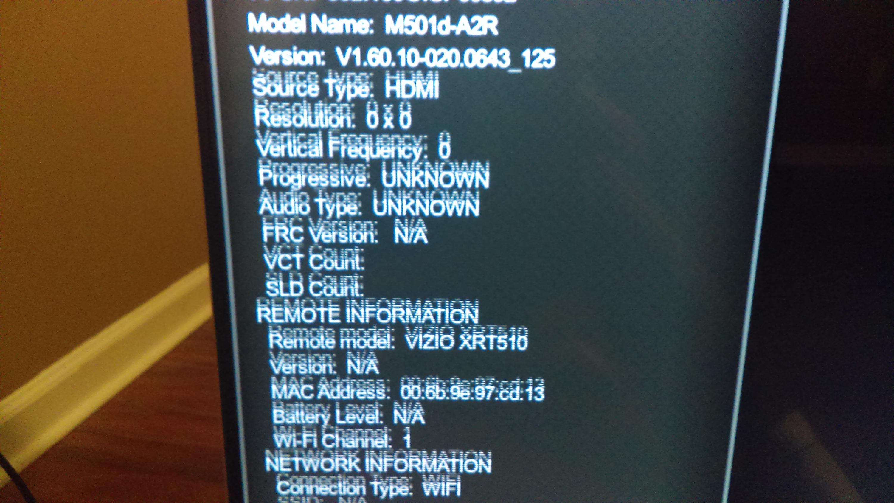

    Re: Vizio M501d-A2R screen jumping from normal to horizontal lines every 2 secs
    Freeze spray the left and right side of the panel. See if it stops doing it.
          I have the exact same issue, wondering if i should replace tcon
          • budwich
            • Jul 2015
            • 3097
            disconnect the tcon to panel cables, one at a time and see what the result is. That may tell if its a panel problem... or possibly a tcon problem.
              Gate Tab bond failure.
