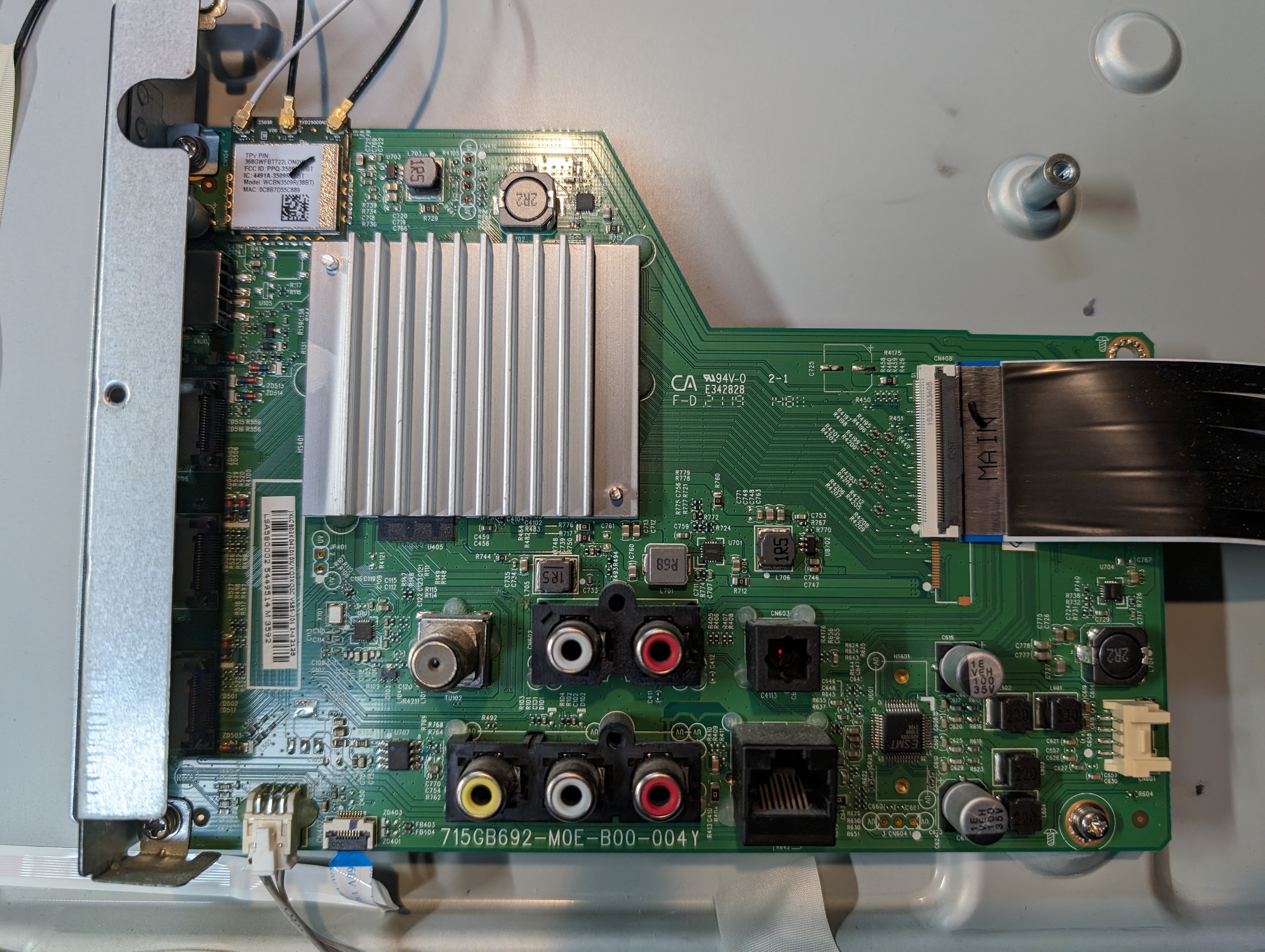

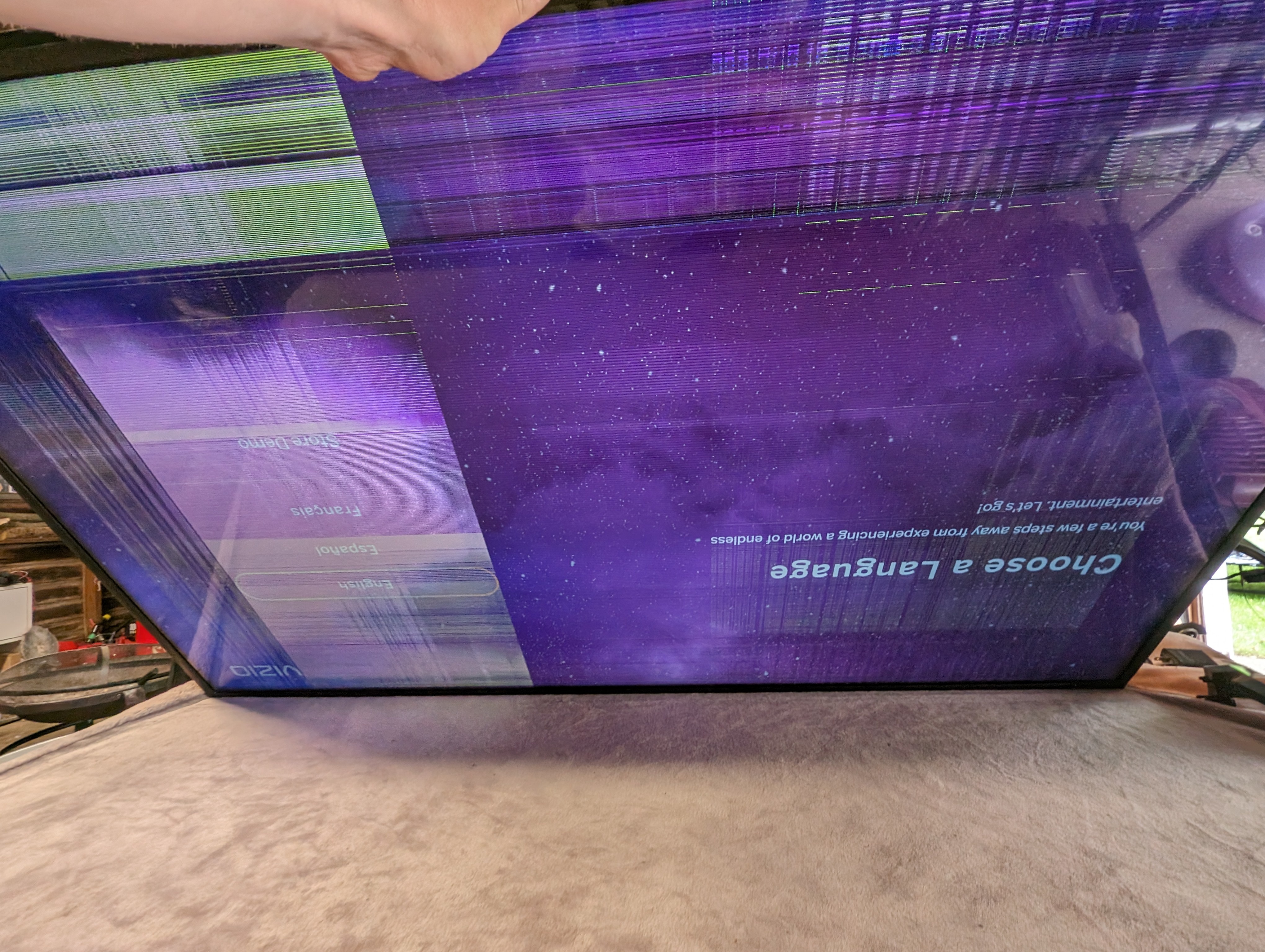

    I got this tv yesterday and it shows a screen full of colored vertical bars and horizontal lines that move, change, and dance around. When the set is powered on there is a slight buzz from the tcon. I removed one ribbon at a time and this was the result:

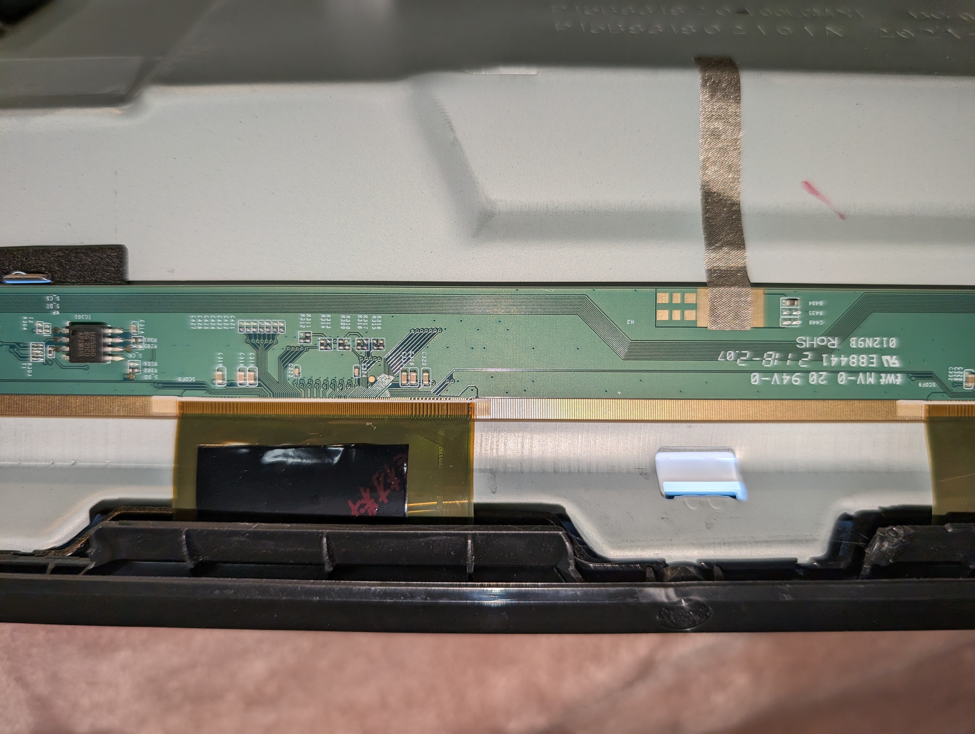

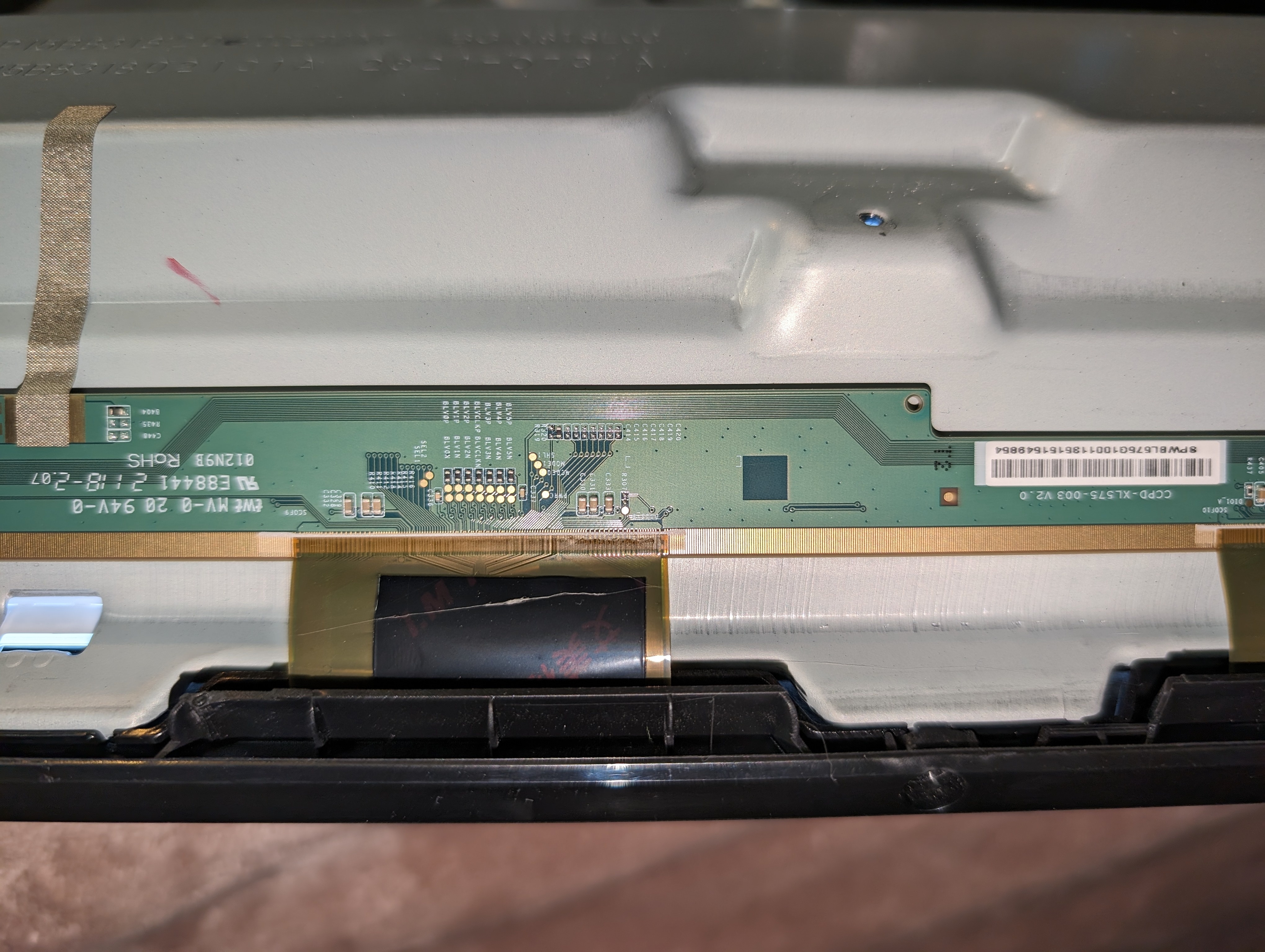

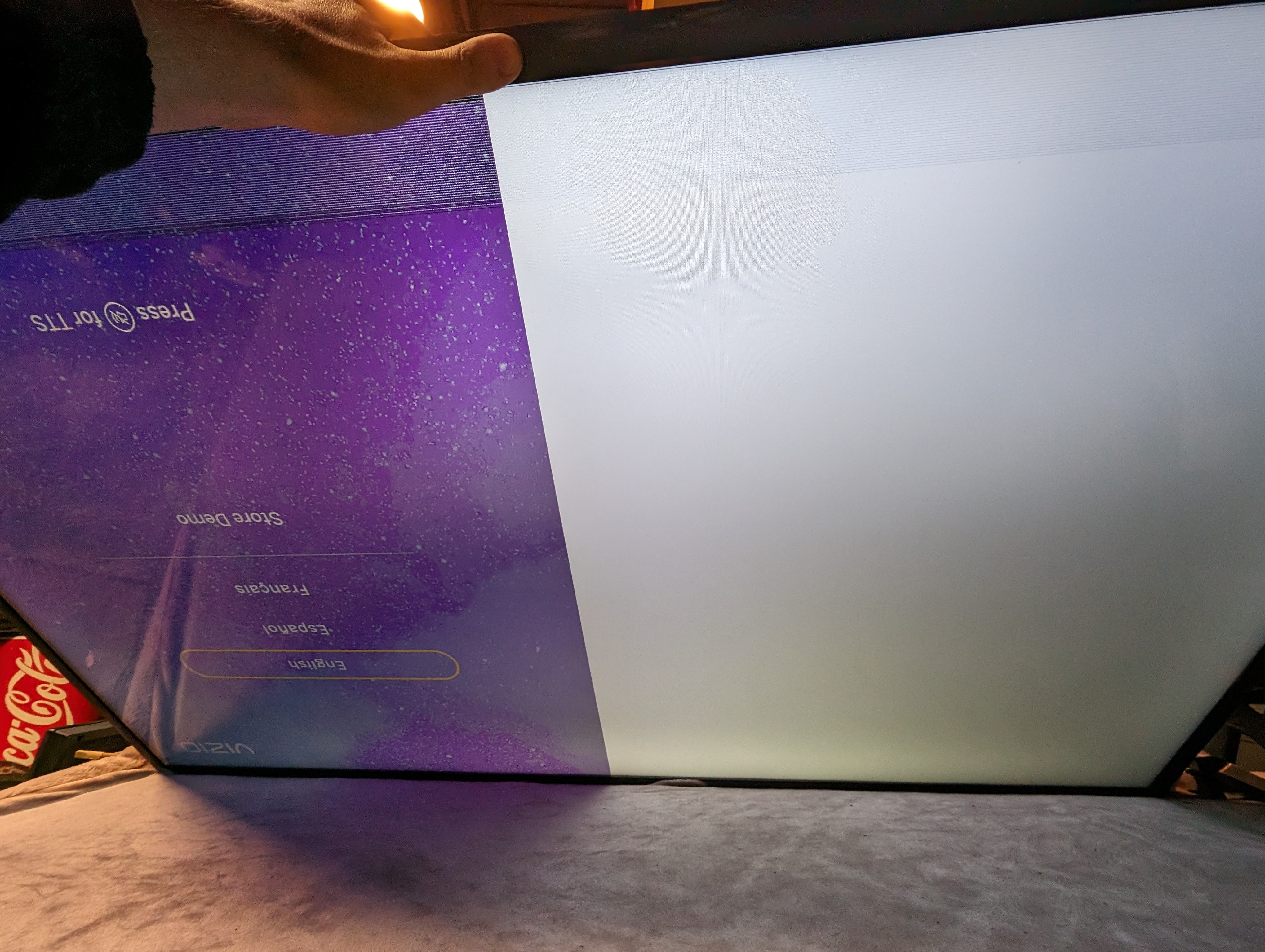

    Right side connected, left side disconnected = half image on right (somewhat distorted, see photo attached) white screen on left. NO buzzing from TCON
    Left side connected, right side disconnected = right side black, left side white with distorted horizontal lines near top of screen. Buzzing from TCON
    I swapped the ribbons as well to see if it was a ribbon issue but the symptoms did not change.

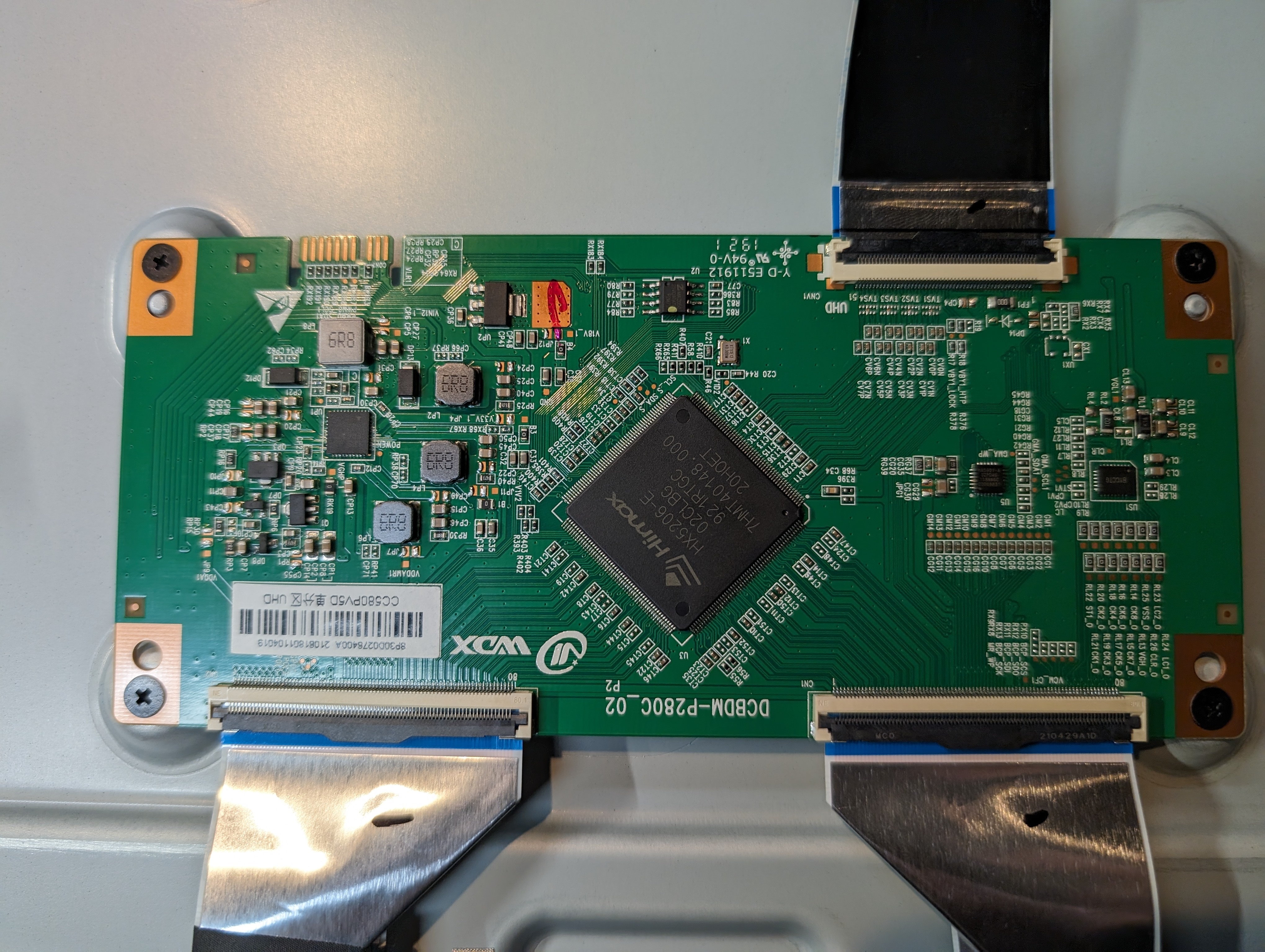

    Attached are photos of the boards as well as the scaler for the left side

    Try tape method. My guess is panel because I have had something like this before. Check buffer board for Shorts

        You won't be able to sell this.. if tape works
        Tape will just show is a panel short usually without wasting a bunch of time, for me it does anyway. Since you got half a screen with lines probably is panel..
        Yes something will generally be off in the picture with tape. Tape isn't really a fix.. so ethically I cant sell them, so I just take the good parts and put em on ebay

            from yours photo of half panel disconnected you have the line s and clear white half screen... it tell the T-CON issue or ribbon cable damage

              As diah said, could be TCON. I've never had luck with TCON yet. Or ribbon that is.

                I can rule out the ribbon as I already tried swapping them and the symptoms were the same. It would be nice if it were just a TCON. The way that the lines move and everything kinda morphs DOES look like a TCON issue.
                I haven't checked the caps on the scaler yet, but I will before jumping the gun and buying a board.

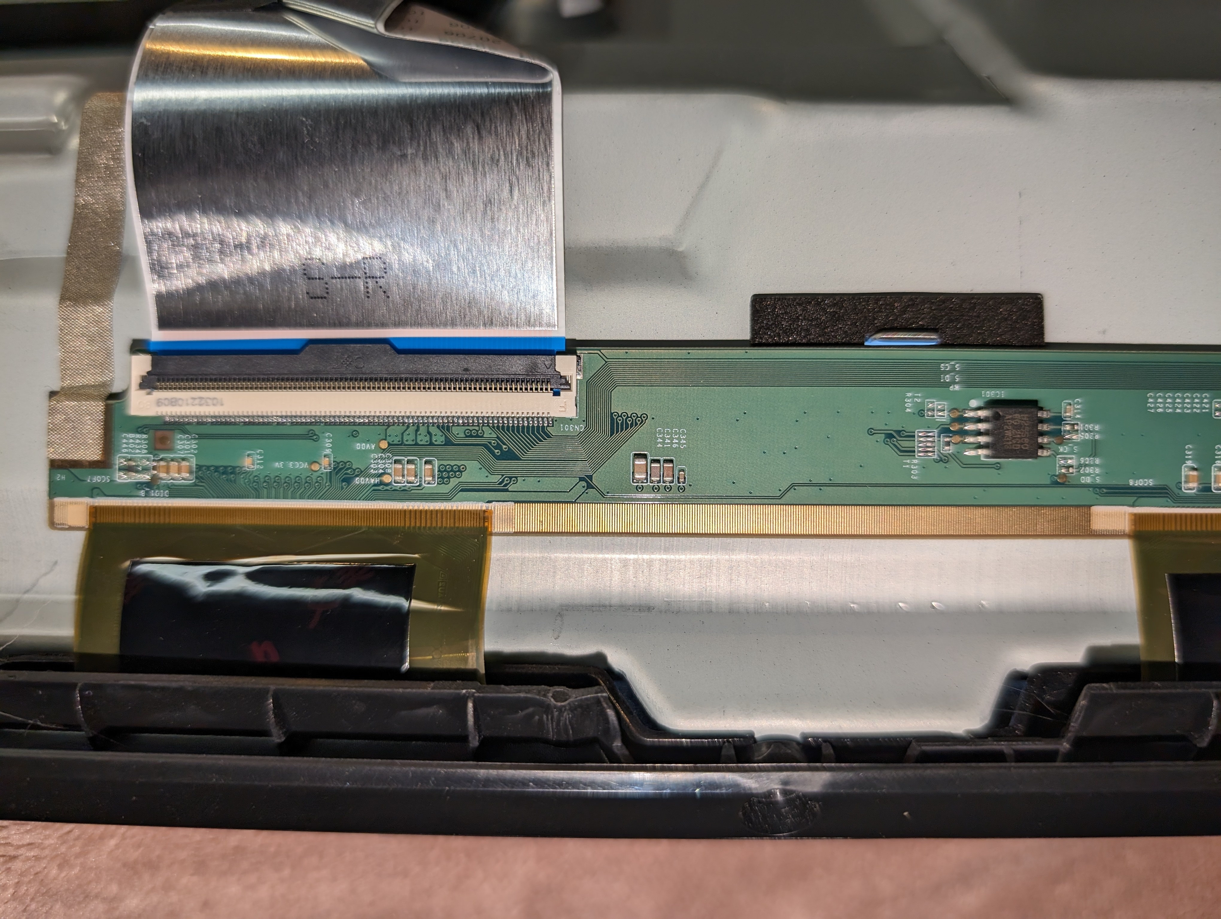

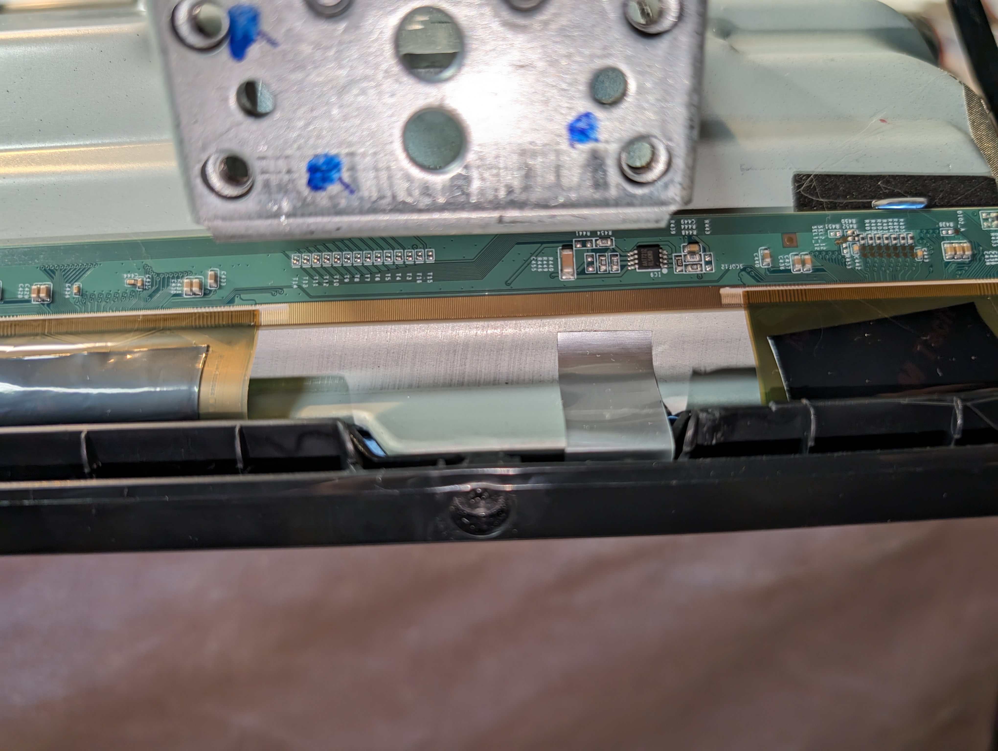

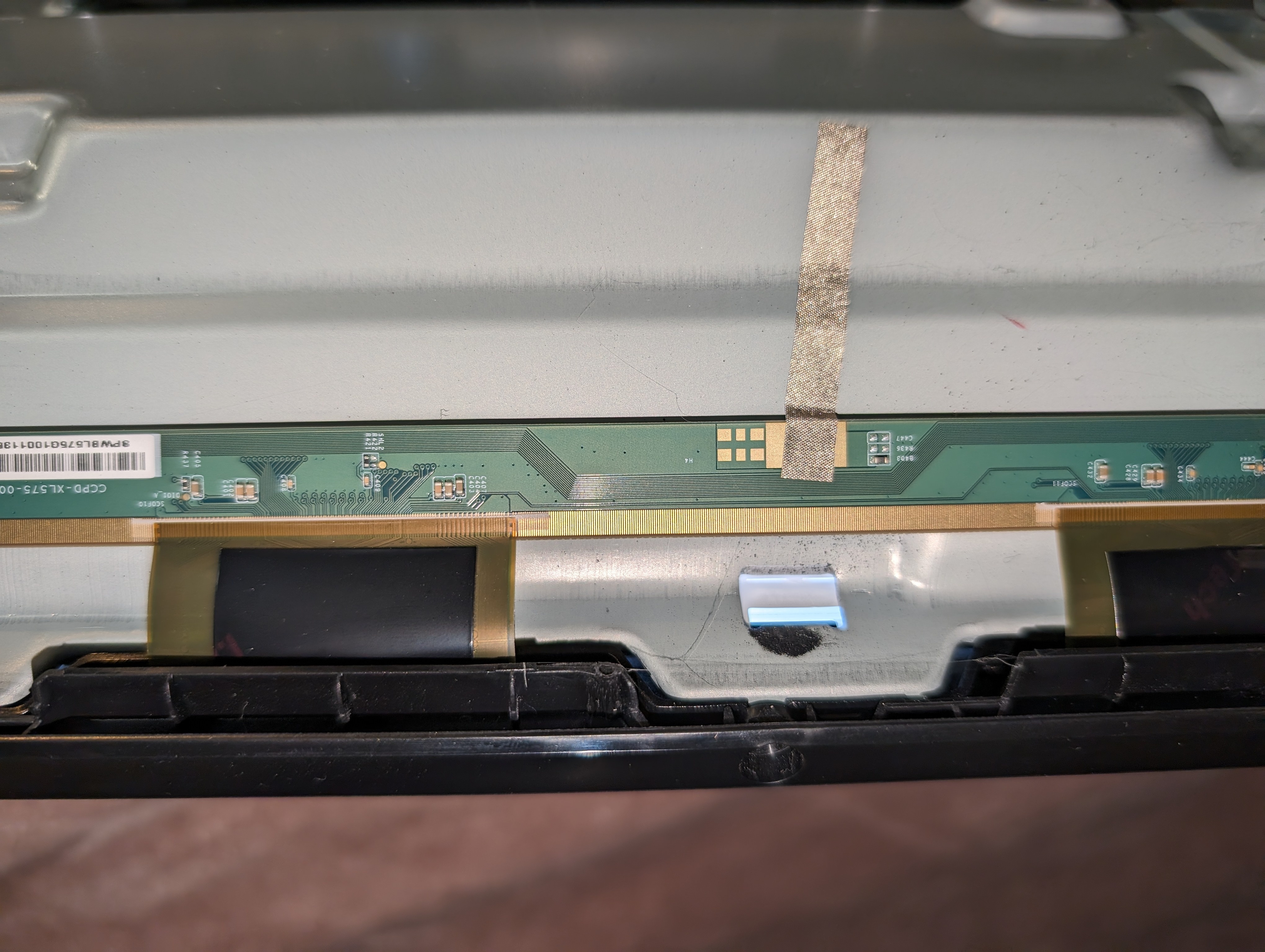

                  I unlatched the left side ribbon and started wiggling it around and can get almost a full picture. As I said earlier, I did try swapping ribbons and still had the same result which is weird because this looks like a ribbon problem, or possibly a connection issue within the sockets?
                  Extra info: I blocked off the clock signals and get the image attached
                  Can clock signals be bad on the TCON side, or only the panel side?

                      panel fault , the dancing jumping of the image can be stopped but the lines will remain on screen by
                      try masking the first 3 pins on the left side of ribbon cable ( the one on your left hand when you looking from the back... and the first three will be the first lines on the left side of the ribbon cable..
                      if this not succeed do the same of the right side.instate of the left side.

                        Update: messed around with this some more tonight and by taping off probably 10 or more traces I got a very nice picture with just a shadow banner across the bottom. However, after about 2 or 3 minutes it fades into bright purple and looks terrible. Turning the tv off and back on instantly restores it to just the shadow banner.
                        Is this the best I can hope to achieve with tape, or am I missing another pin somewhere that could prevent it from turning purple? Further, would this be an actual fault inside of the panel, or would a bad capacitor on the scaler board for that side cause this and be repairable if I could track it down and replace it?

                                  from yours photo , remove the bezel you could find at the same place of the screen class have broken

                                    🤔 Would that really cause the color morphing AFTER a few minutes of being on and looking relatively good as in the first couple pics?
                                    I was wondering if maybe I covered TOO MANY pins with the tape.. like I said tho, powering off and back on instantly gets rid of the purple again for another few minutes.

                                        Oh. It's the same TV tho! No cracks as far as I know, I just haven't had a chance to really mess with it again until just recently. I cleared up the image using the tape method. It's just the grey shadow at the bottom now that eventually fades purple. I have maybe 10 or 12 covered, so I'm wondering if that's overkill and actually causing the purple to come in.
                                        Attached video shows the purple morphing in over the course of 1 minute.
