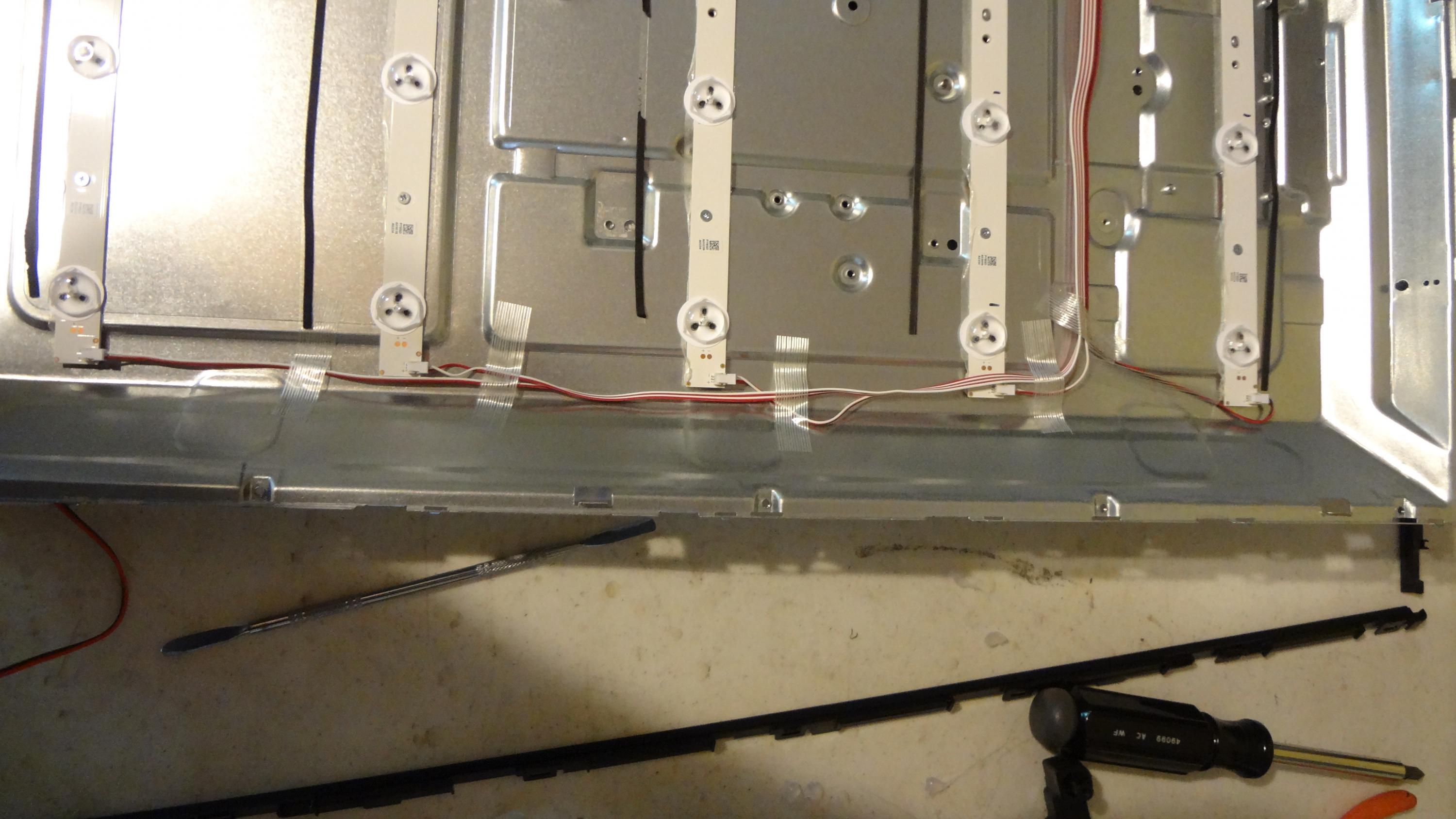

          Sounds like what I was thinking. I opened the panel up last night and got through testing the first two strips of LED's, accidentally damaged one of the first few removing the lens so I'll be replacing that with one from another LED strip. Let you guys know what I discover after testing all 5 strips.
            Re: Hitachi LE49S508
            You can glue the lense back on woth hot glue saves replacing it, you can test each led with a Dmm.
              I damaged the actual LED not the lens, the led still tests good with a DMM it just doesn't light up.
                I just got finished testing all the LEDs and regluing the lenses.
                All LEDs test good and light up when checked with a DMM.
                Anything else that could be causing this issue?

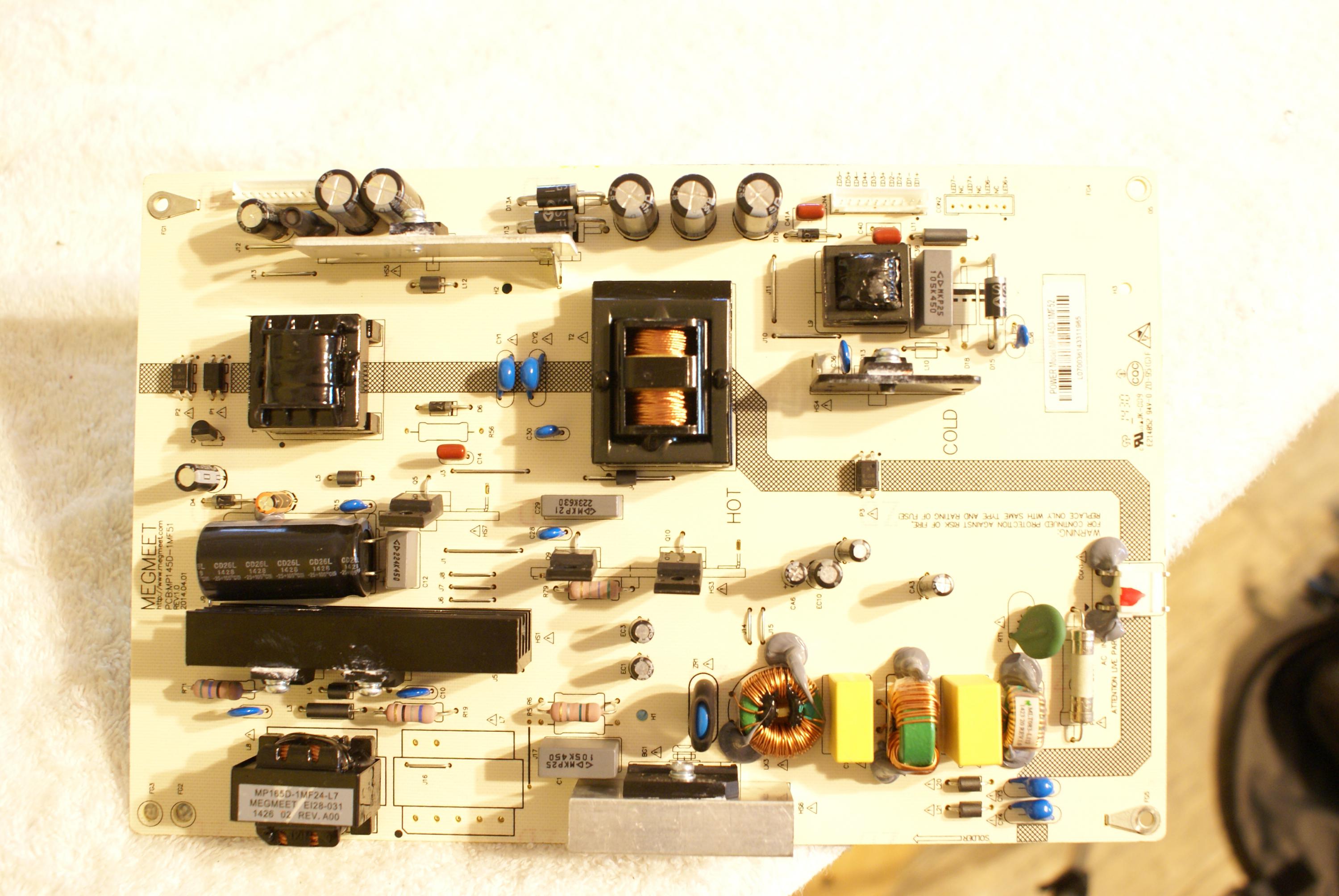

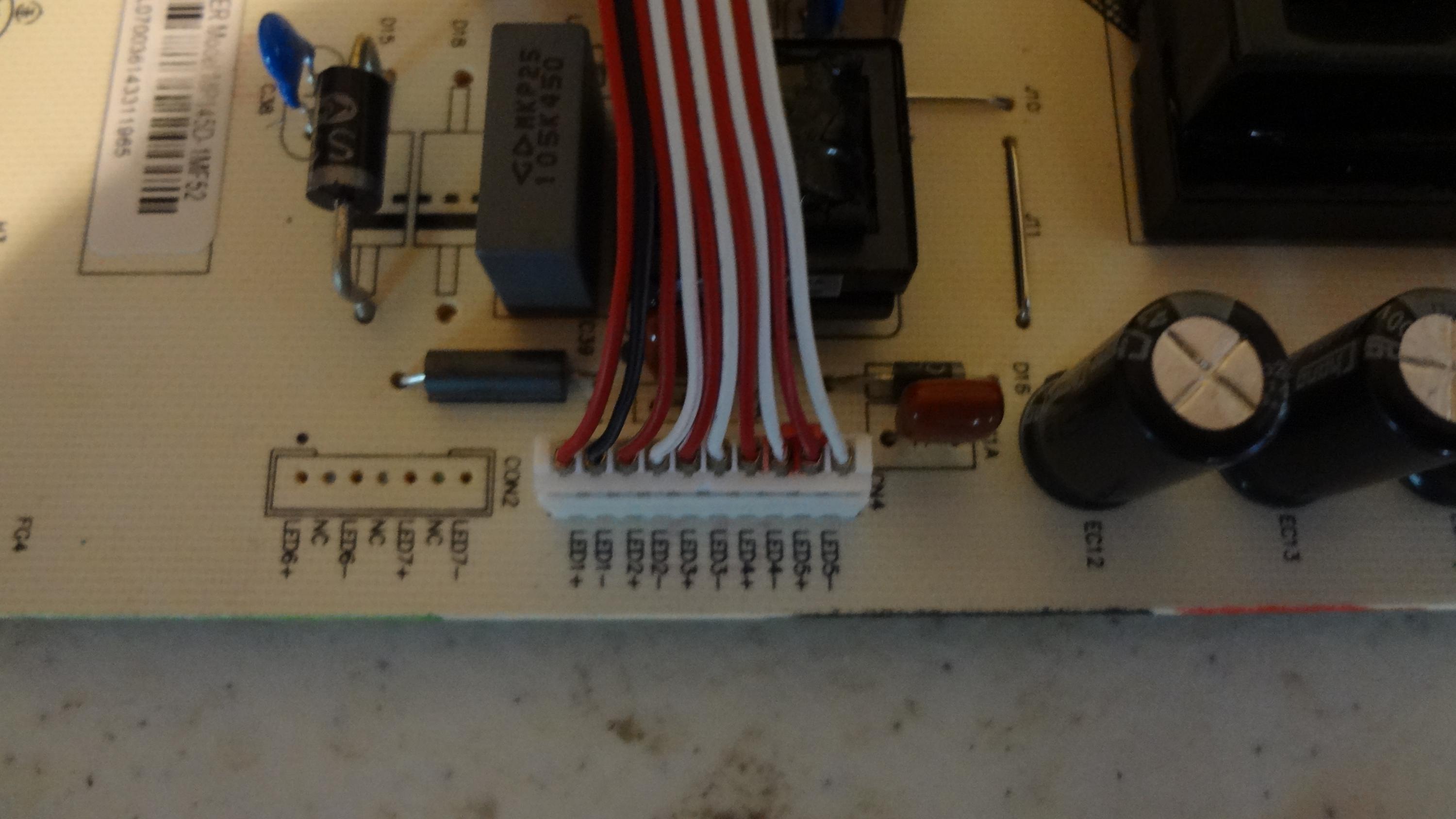

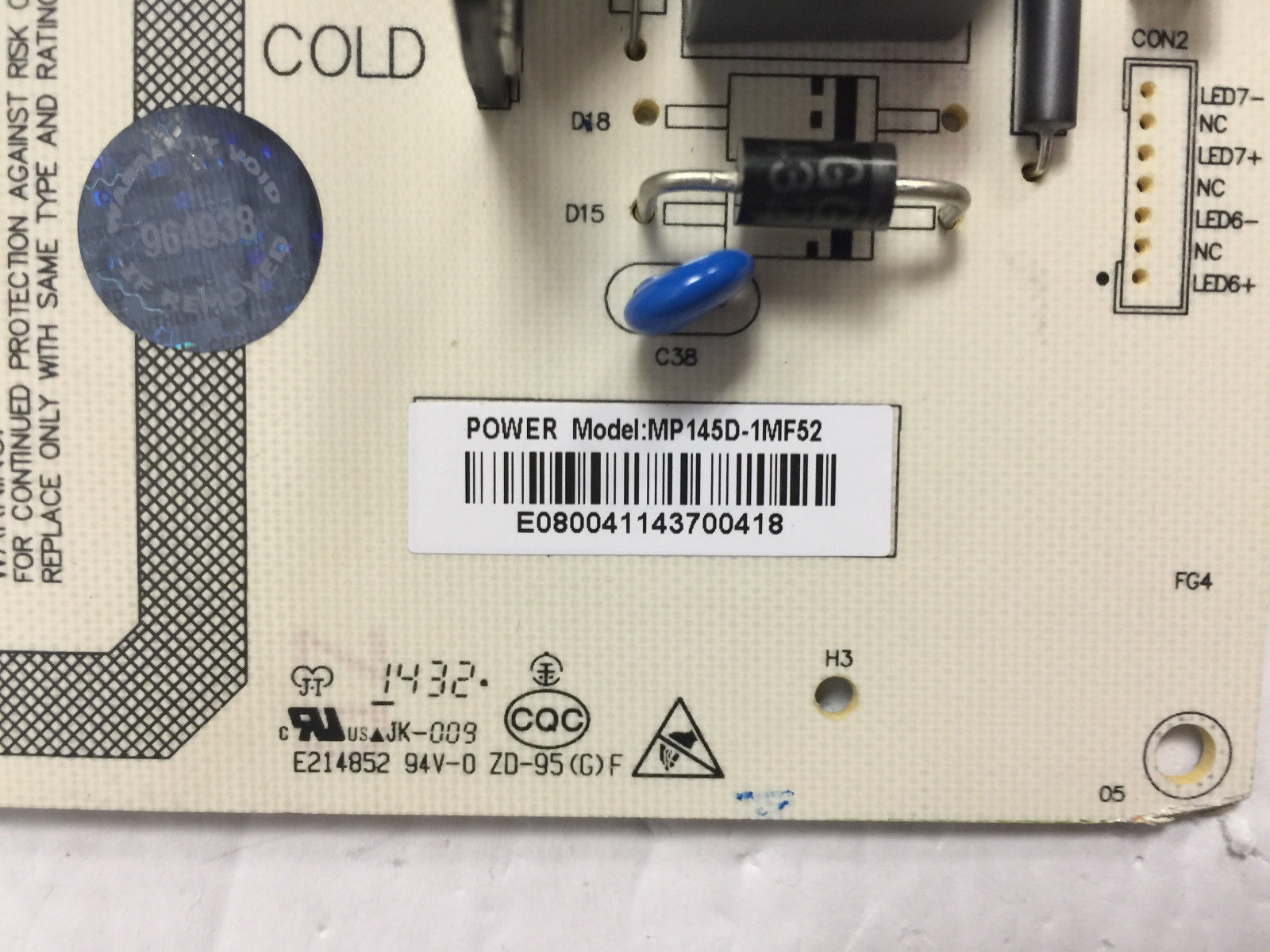

                  Can I see the pictures that show the wires from the LEDS that go to the LED connector?
                    Here's a pic of how the strips are connected and also a pic of the connector on the PSU
                    Let me know if you need better pics or of something else
                      OK, so it does have 5 LED strings and they are connected in series as one big string.
                      Your readings at CN4 do not look right for the string #5.

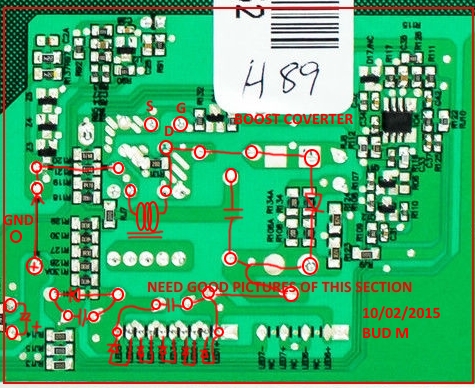

                              12 LEDs x 5 strips = 60 LEDs, so the minimum drive Voltage should be 60 x 3Vf = 180V (or 60 x3.6Vf = 216V), so the drive Voltage of 119V is too low.
                              Need to look at the driver circuit next.

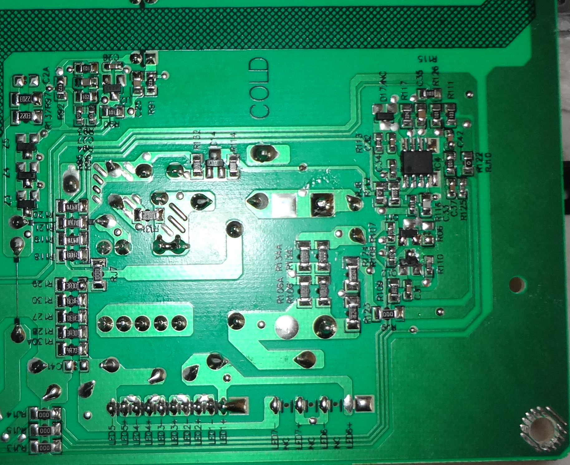

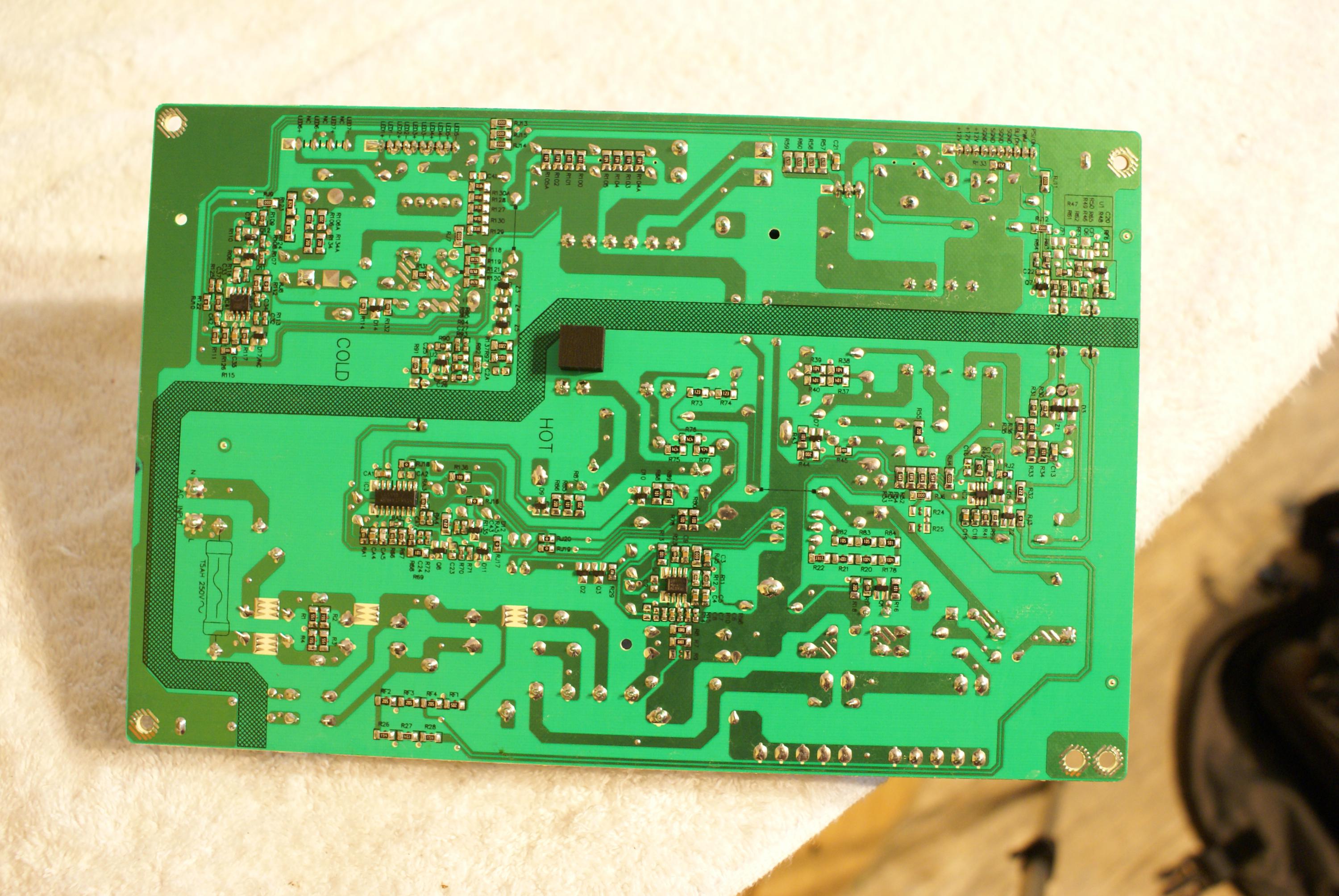

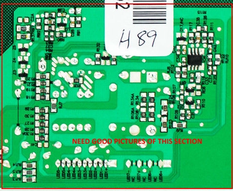

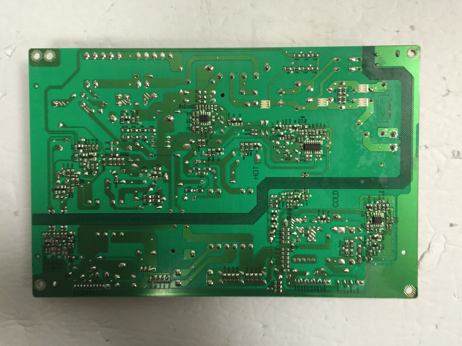

                                Need good pictures of this area.
                                  OK, I trace out the connections.
                                  Seems to me that the boost converter is not working. You should check the capacitance of that GREY rectangular cap, and get the P/N of that 8-PIN SMD IC.
                                    Ok here is a picture of the section you want to see. Let me know if this is a clear enough picture otherwise I'll see if I can figure out how to get a clearer picture while zoomed in.
                                      I don't have any means to test the capacitance right now, the transistor tester / esr meter that I bought from ebay isn't working properly it keeps telling me that its testing a mosfet when there is nothing being tested and tells me that every capacitor is unknown / damaged.
                                      Here is the P/N of the 8 pin IC F28543 and below that is 083350CP
                                        Please check the resistance between LED 5+ pin and the chassis (LED connector in place) to see what you get.
