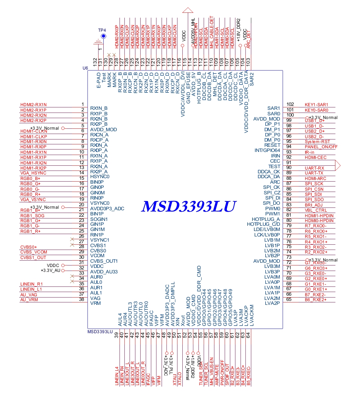

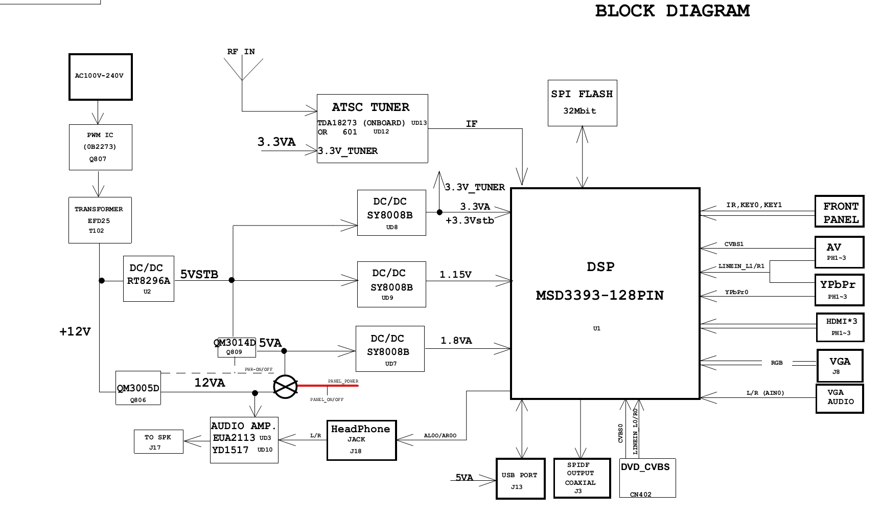

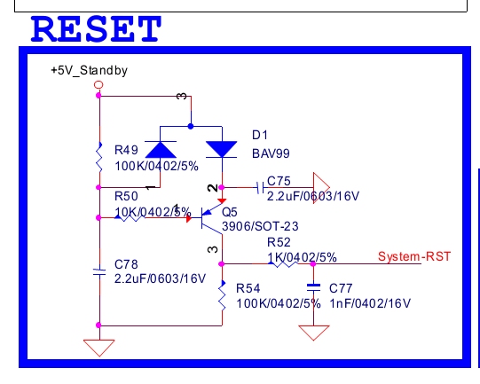

                                I would check U804 (+3.3V LDO), U807 (1.8V LDO), U805/L810 (+5V switchmode?), U700 (multi-output switchmode), U802/L805 (+1.15V switchmode?). Some voltages are standby voltages (+3.3V and +5V), while others are required by the SDRAM (1.8V) and SoC (+1.15V Vcore).
                                I have found several several service manuals for TVs using the MSD3393LU SoC:
                                System_Reset (pin #95 of SoC) should be low when the SoC is running and high when it is in the reset state.
                                Panel_On/Off is pin #94 of the SoC.
                                PWR-ON/OFF is pin #59.
                                FWIW, I recently helped someone repair a TV using a different MSD SoC. In that case the problem was a bad 24MHz crystal. The symptom was similar.
                                Edit: I think U700 may be a class-D audio power amp, not a switchmode supply. Sorry for the error.

                                      I'm a little confused about the LEDs. The voltages of the two LEDs are in opposite states (3.3V and 0V), so one should be on and the other off. However, my understanding is that neither LED is on. ???
                                      I'm also trying to understand which voltages are switched on/off by PS-O/F and PB-O/F.
                                      Does PS-O/F control the 120VDC supply for the boost converter, and does PB-O/F control the booster itself? If so, does it make any sense for one to be on while the other is off? Wouldn't both need to be on in run mode and both need to be off in standby?
