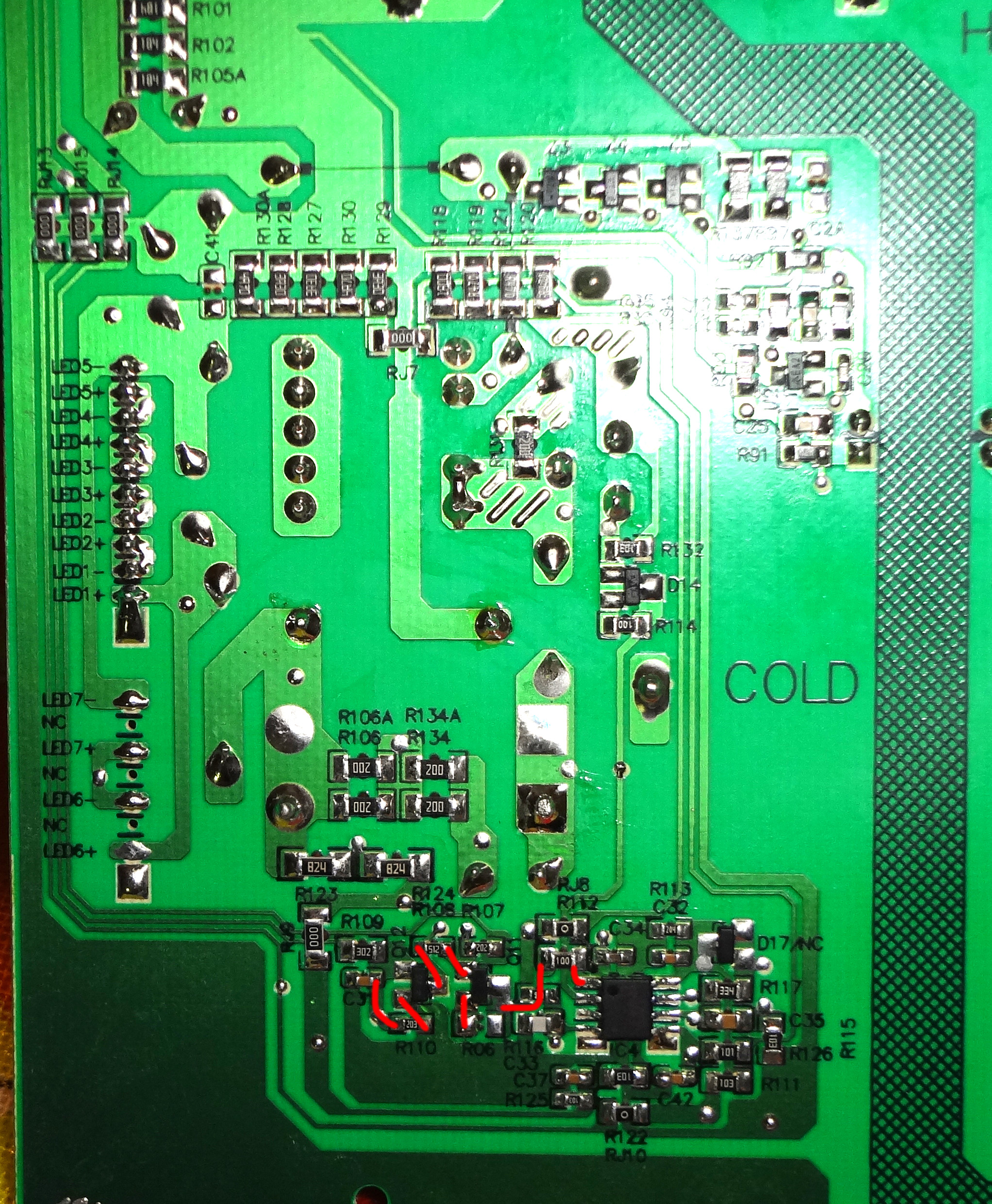

  • dragometin
    Hitachi 40HYC42
    by dragometin
    TV Model: Hitachi 40HYC42
    Power Supply: 17IPS71
    MainBoard: 17MB95M
    Panel: VES400UNDS-2D-NO3
    When the set came in it was dead. Fuse was open primary side and the power mosfet was shorted. So I ordered a new power supply. Now it turns on, only displays "Hitachi" and then power off red and blue led flashing.
    I had to modify the 0ohm resistors in the led backlight of the new PS like the original power supply.
    Is there any variants on 17IPS71 power supply's?
    UART output pins 10 and 12 on scart connector:
