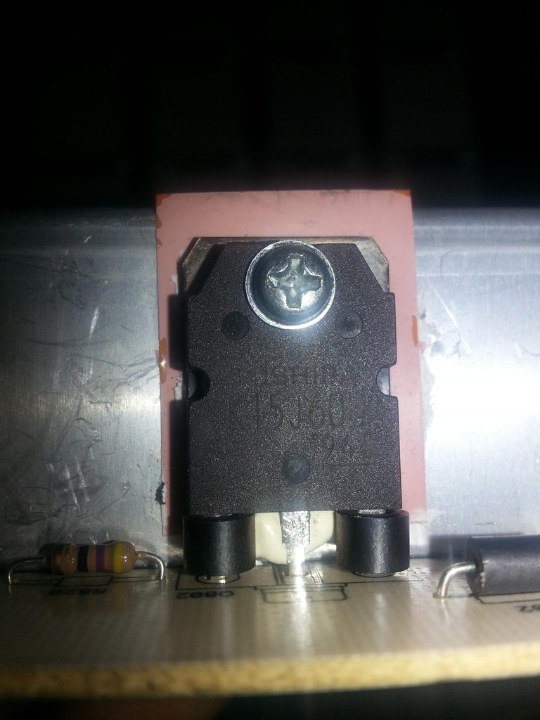

    I'm a noob when it comes to these types of things, I have a transistor that i tested, it seems to be a bad one. I'm trying to order a new one from Amazon but i don't know which one I should get, can someone please post a link from Amazon on which type of transistor I should get,here's a pic of the bad transistor.

      TOSHIBA Field Effect Transistor Silicon N Channel MOS Type (DTMOS II)
      TK15J60U is the full number

        How is it tested out? Shorted? What circuit section is it in?

          I had the negative lead in the middle, I put the positive lead on the left side It tested OL and on the right side it tested .259
            maybe explain to every one the fault + Tv model photos of boards etc
            Chances are that FET is ok

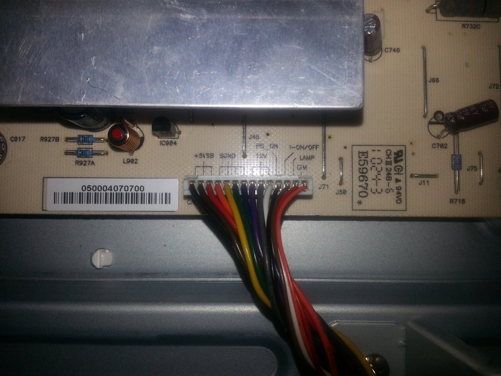

                      No pic and probably no backlight but will have the 5v STBY as set "attempts" to power.... So will be missing the 12v and 24v.
                      Can you give me a close up pic of the connector that goes from the PSU to main (Top left of your image) so I can see the labels for voltages please.
                      Need to confirm voltages at this connector to confirm the missing voltages and see what's going on.

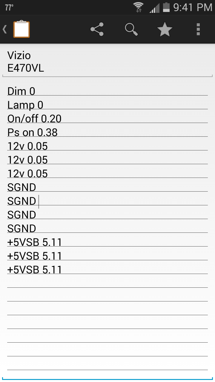

                        Re: Transistor for TV problems
                        Yeah, no picture and no back light, I tried the flashlight test I didn't see anything. Here's the pictures

                          That is body diode of the MOSFET you are seeing, the Cathode of the Diode is connected to the Drain pin (middle pin), the Anode is connected to the Source pin (right pin), this is N-CH MOSFET.

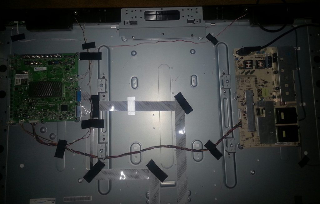

                            Are these readings with the power switch activated? If it is activated, then the main board is the problem.
                            https://www.badcaps.net/forum/attach...7&d=1431658037
                            We will need good clear pictures of the whole back side of the TV to see all the boards.

                                  It is not showing as shorted circuit, using Ohm meter can only do so much for testing the MOSFET, but this MOSFET has nothing to do with what the TV is doing right now, it is the main board that is not sending the signals to turn on the power supply board and the inverter board but we need to know if those Voltage readings are made with the power switch is activated or not, that is VERY IMPORTANT info I need to know.

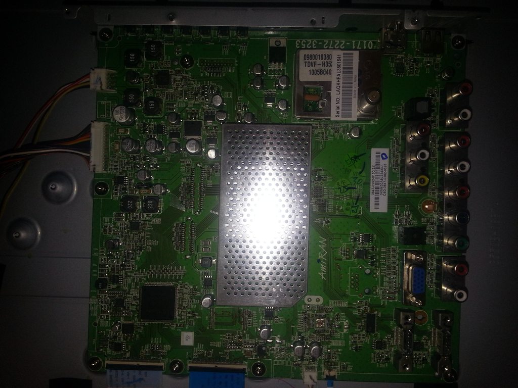

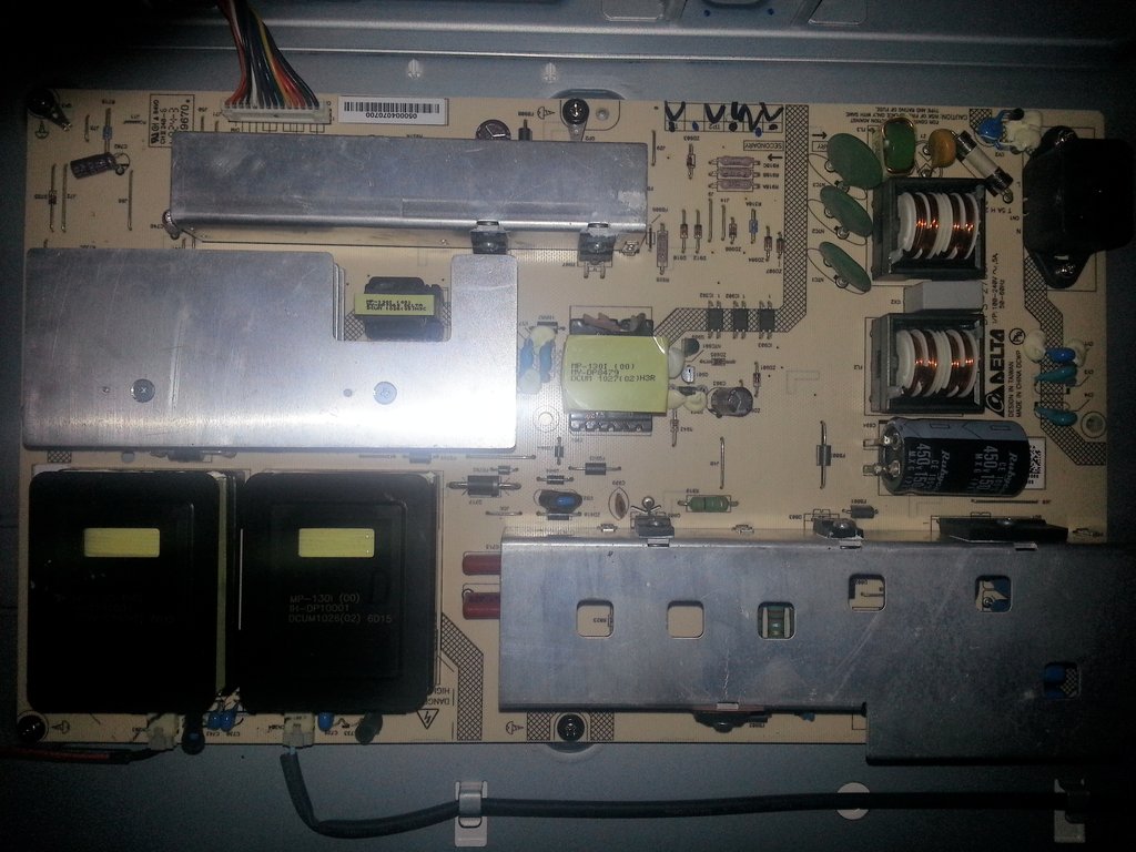

                                    Yes the TV was on when I did the readings. Here's the pics
                                      OK, then the problem is on the main board and will require more troubleshooting.

                                        Can a eeprom fix this issue? And what's under that metal rectangle in the middle of the main board?
