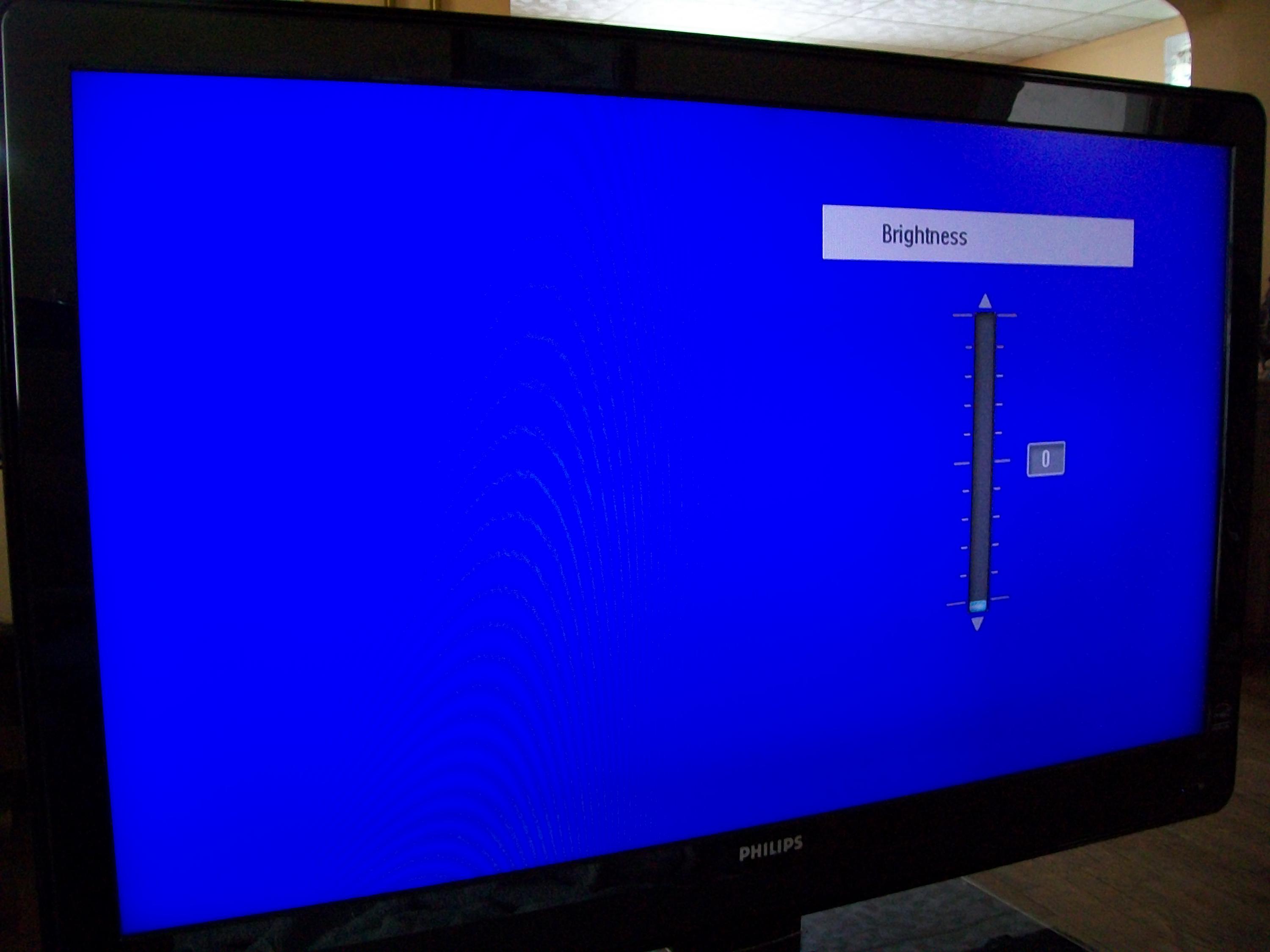

      Unless I am doing something wrong I cant tell that the brightness level adjustment is doing anything at all. From 0-100 the screen looks the same to me.

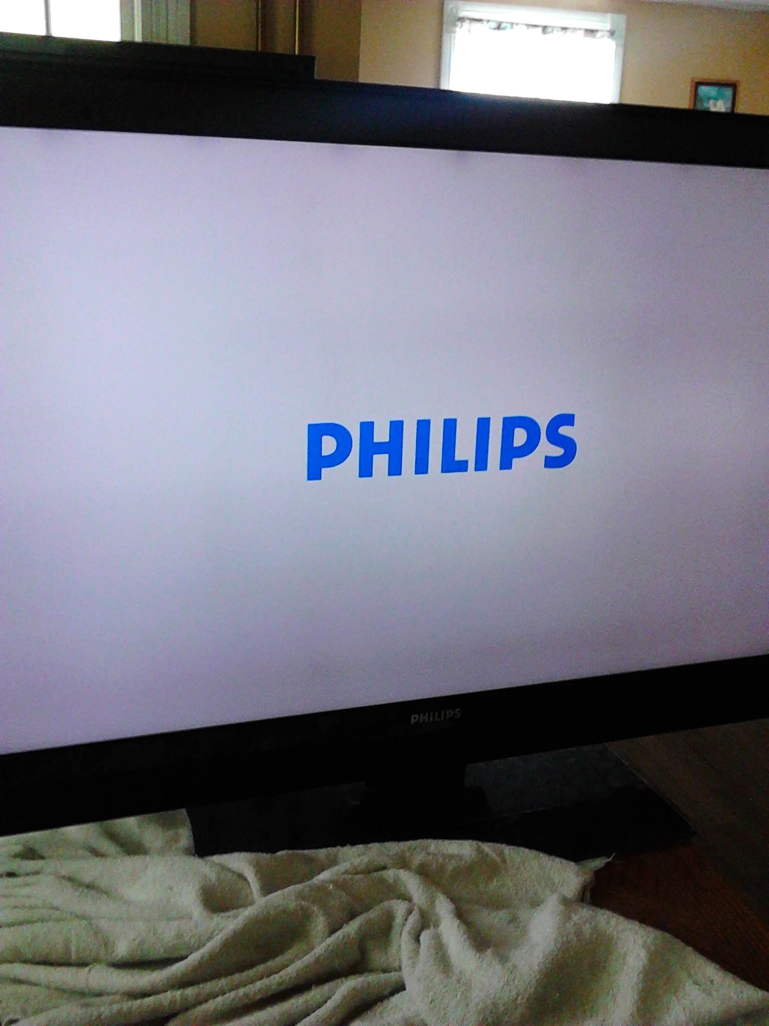

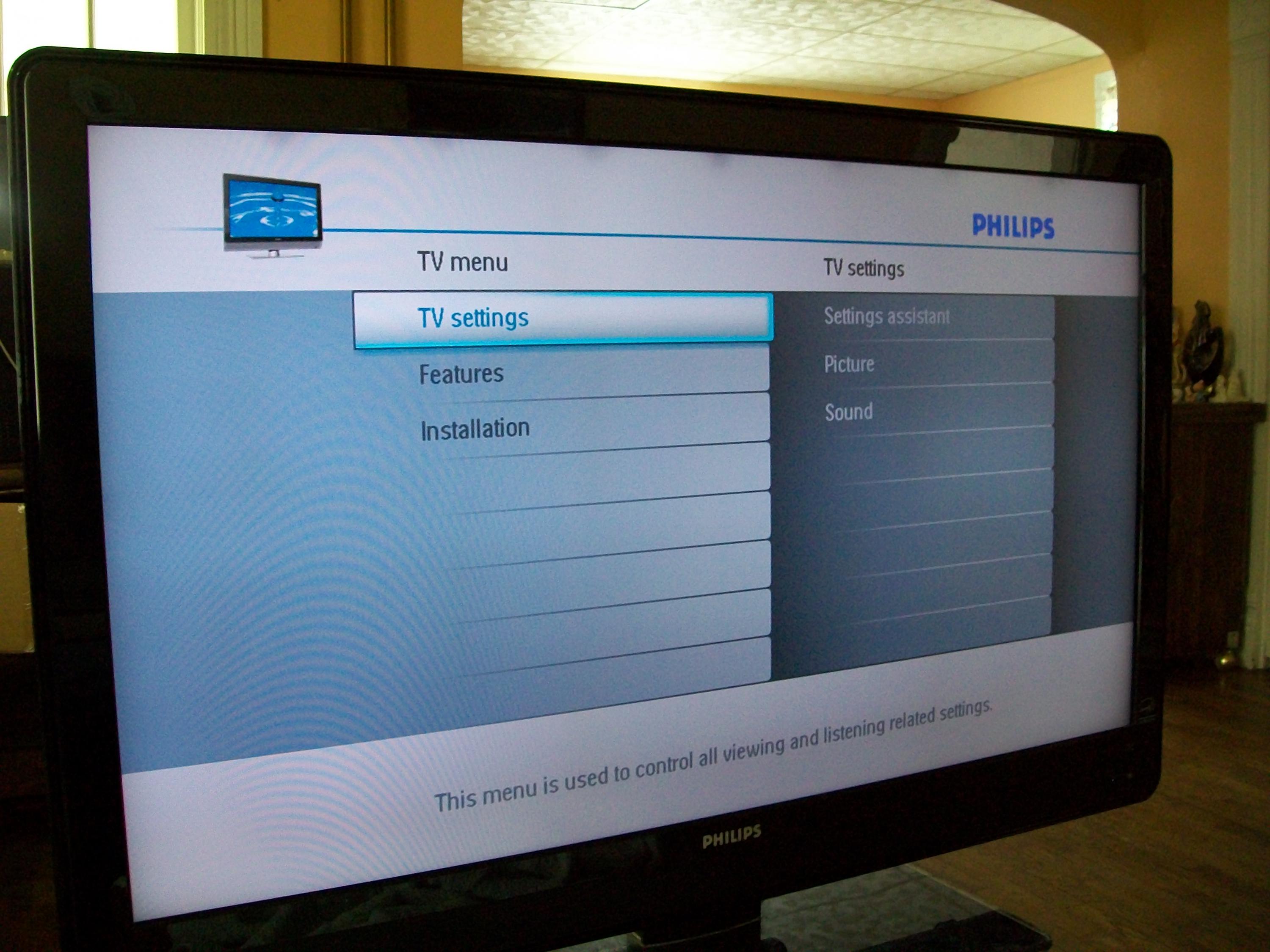

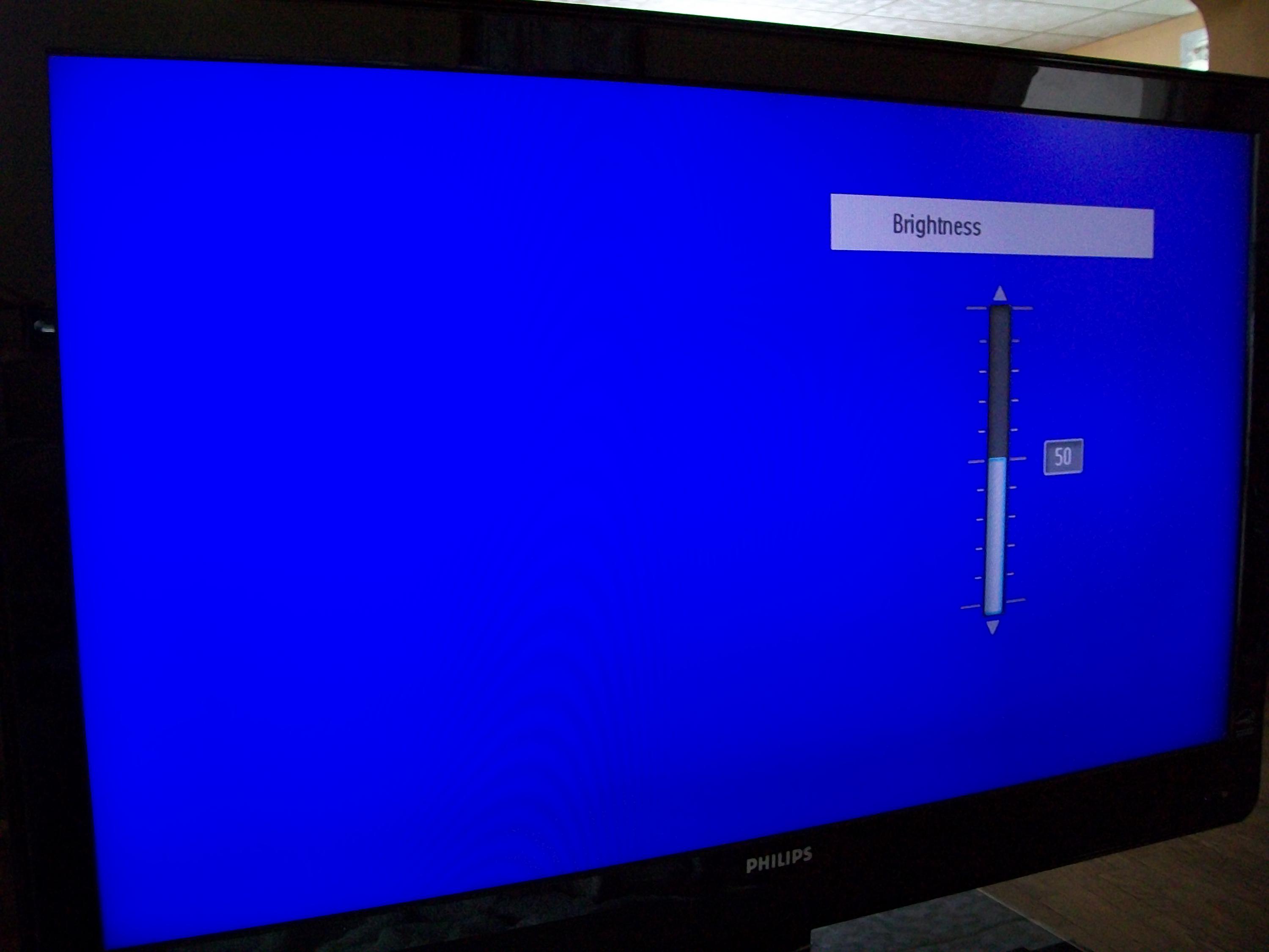

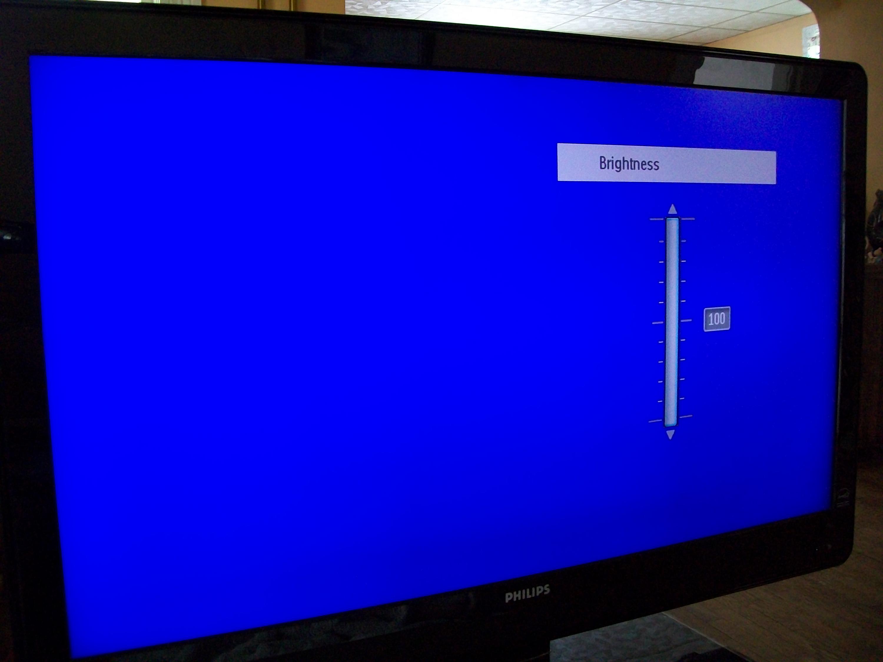

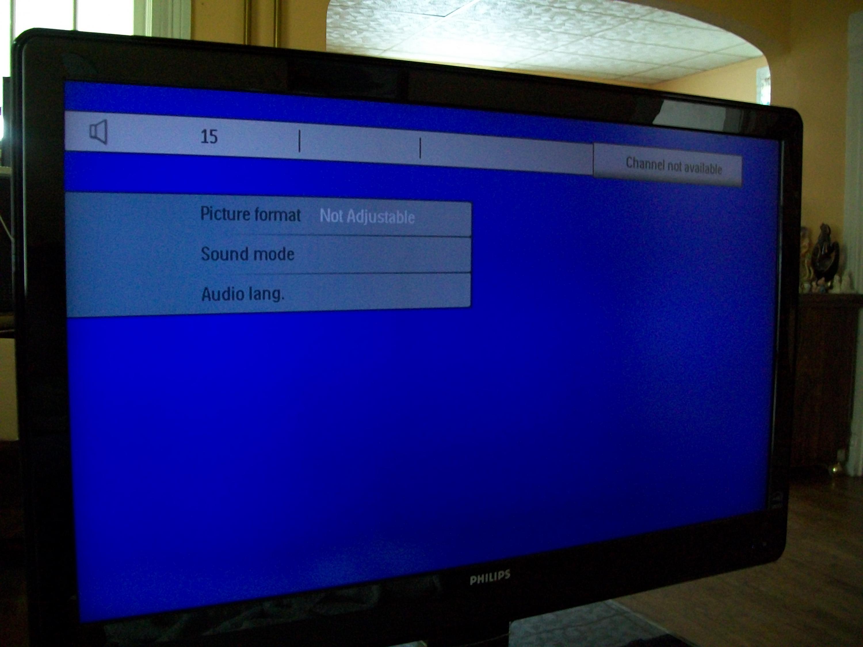

      The first 3 pictures are of the startup sequence. Pic1. Immediately after pressing power button no buzz, Pic2. buzz starts, Pic3. TV is fully on and buzzing away.
      Picture 4 is after pressing the menu button and the buzz is gone.
      The last 3 pictures are the brightness level adjustments. No buzz while on these screens.
      I exit the menu and the buzzing returns.

          Not the Brightness adjustment, there should be another adjustment on the user menu for the BACKLIGHTS level.
          Most TV will have CONTRAST, BRIGHTNESS, and BACKLIGHTS adjustment. Your TV may not have that function for the Backlights level adj.

              I don't see any option for backlights adjustment.
              Could it be the panel itself (or CCFLs) causing the trasnformer to buzz?

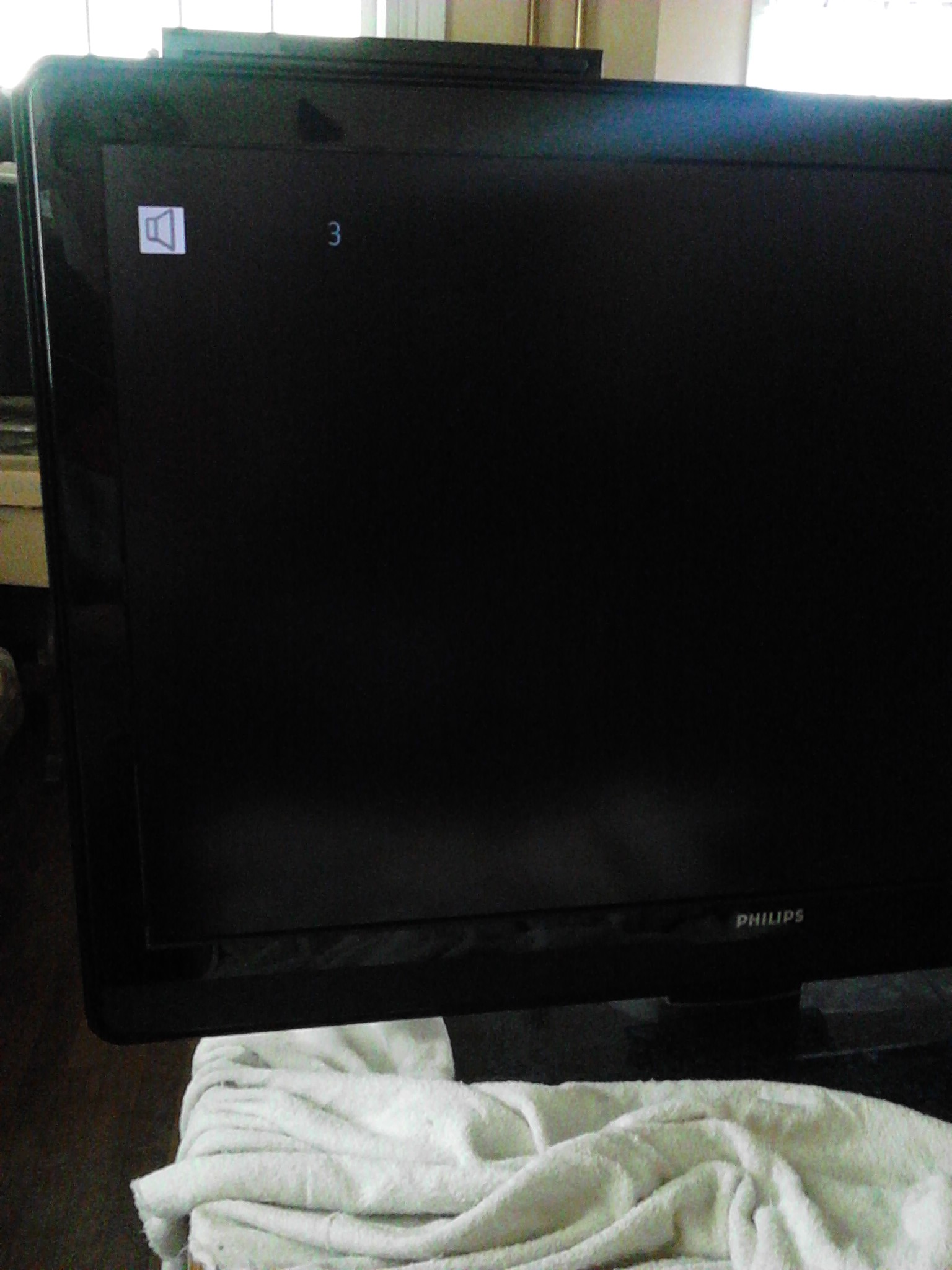

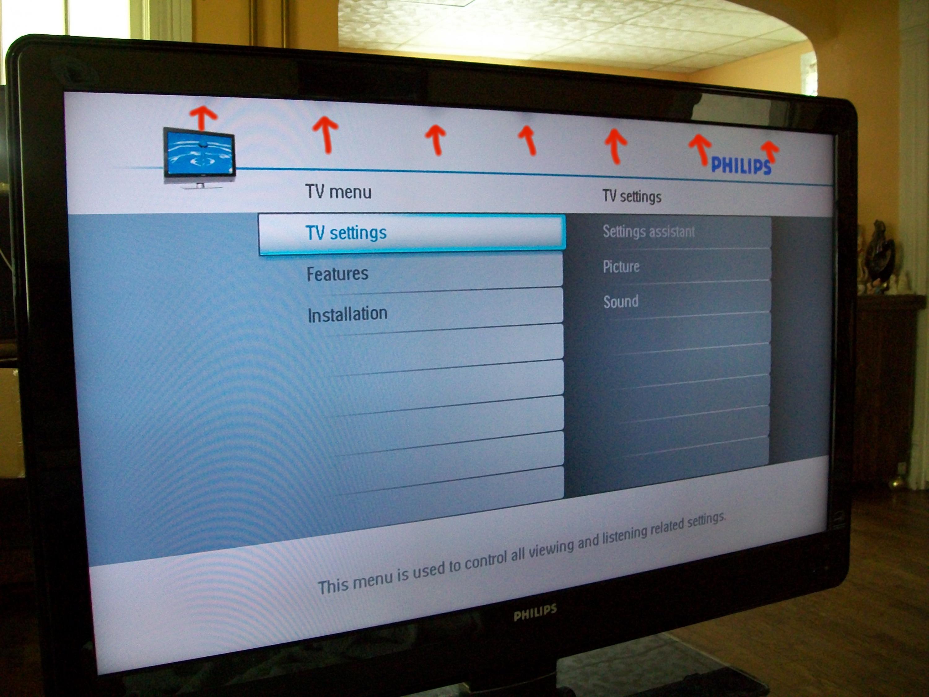

              In post #9 I attached a pic showing some problems with the picture at the top of the screen.
              I'll attach a pic here on a lighter screen so hopefully it shows up better.
              thanks

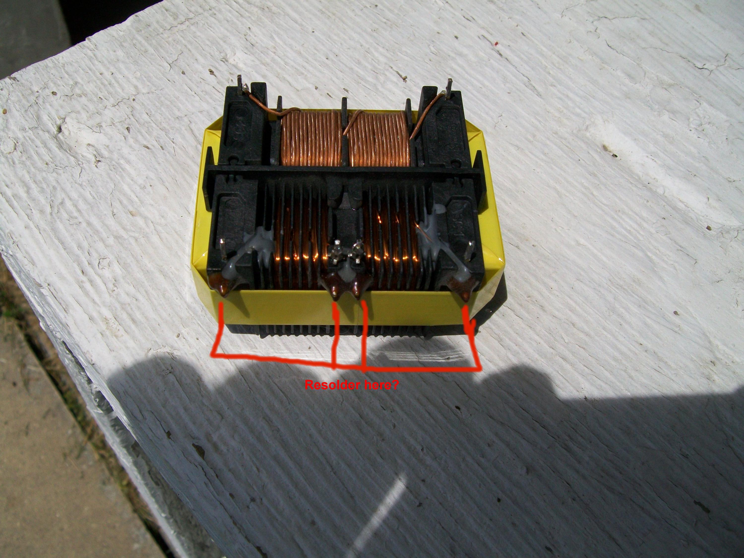

                Next step = remove transformer from board and examine...
                Then re-solder wire wrapped lugs...then re-install on board.
                Test =
                  Re: Phillips 47PFL3603D/F7 No Power

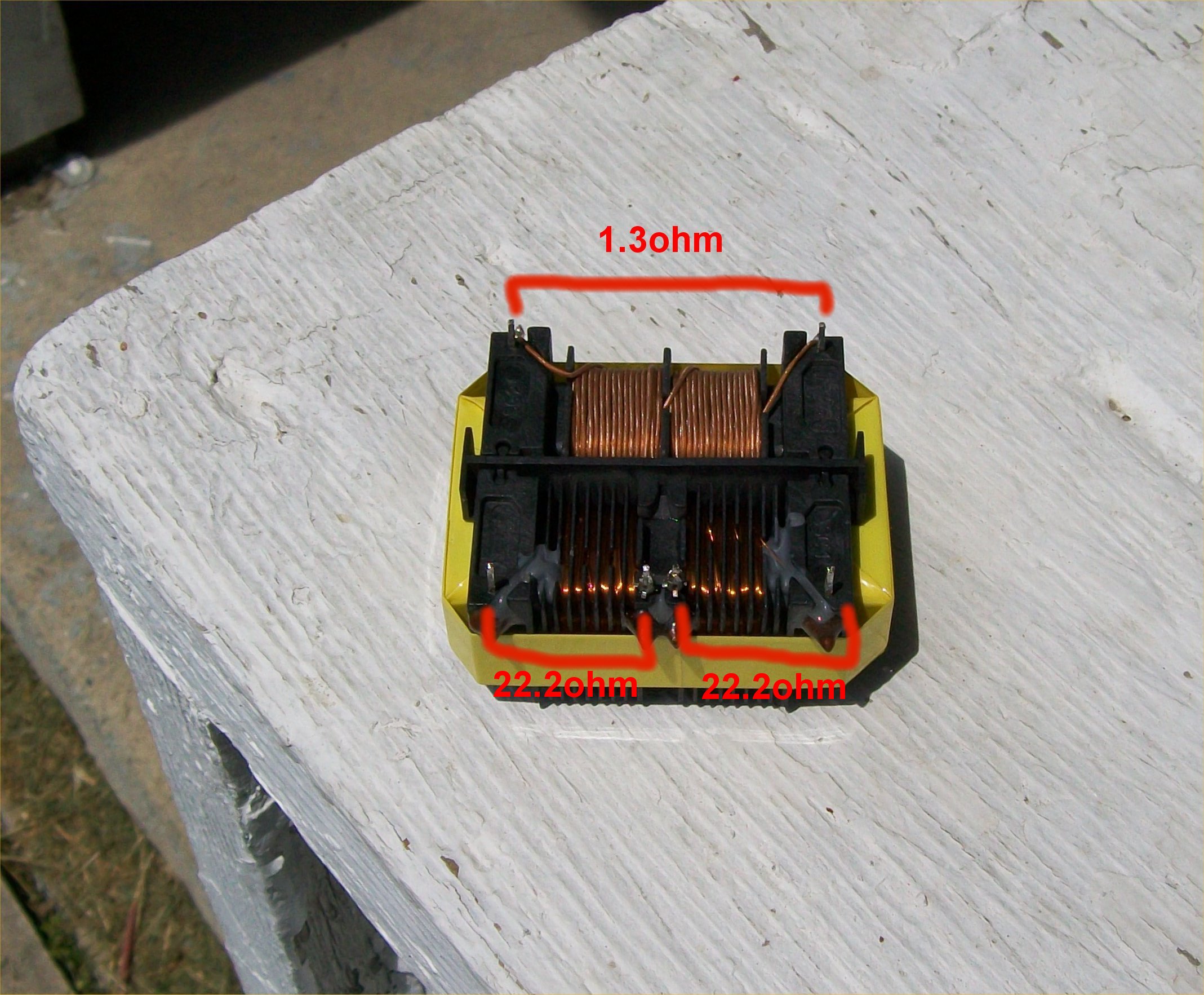

                  If I am doing this right with my dmm set on 200ohm scale I get 22.2ohm on the primary side and 1.3ohm on the secondary. (see pic1 for test points I used)
                  Does this sound about right?
                  In pic2 are those the places that I should re solder? Then do the same on the secondary side?
                  If so, thsoe spots look to be covered with resin..whats the best way to remove it?
                    Do you think my transformer is good? I couldn't find any info when searching google to see what ohms it should be.
                    (BTW in the above post I think I have the primary and secondary backwards. primary is the thicker wire right?)

                      Solder primary wire wraps then inspect secondary....
                      BTW, MY transformer measures the same.
                      Smell it....does it have any physical problems?

                        Just so I am clear on where to solder, I should solder across the whole top and bottom primary side (thicker) wires as circled in the pic?
                        if that doesn't fix the buzz is there something else I should test?
                        thanks
                          #32
                          DO NOT solder anything !
                              them marks might be caused by the casing screws maybe? try undoing them and seeing if the dark patches go
                                Thanks azza1234..I will check the screws a little better.

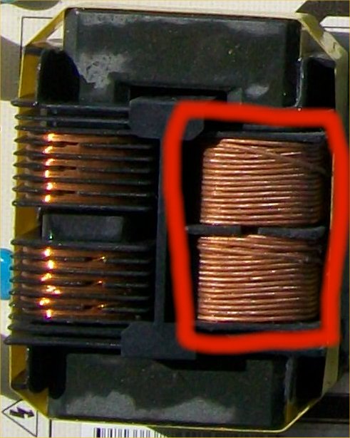

                                        The last issue for me on this TV is those dark spots at the top of the screen. the Op Hours on the TV are 35,534..with that many hours I'm guessing that its some kind of panel issue or burn in spots..I've checked the screws and it didnt make any difference...is there anything else I could try?
                                        thanks
