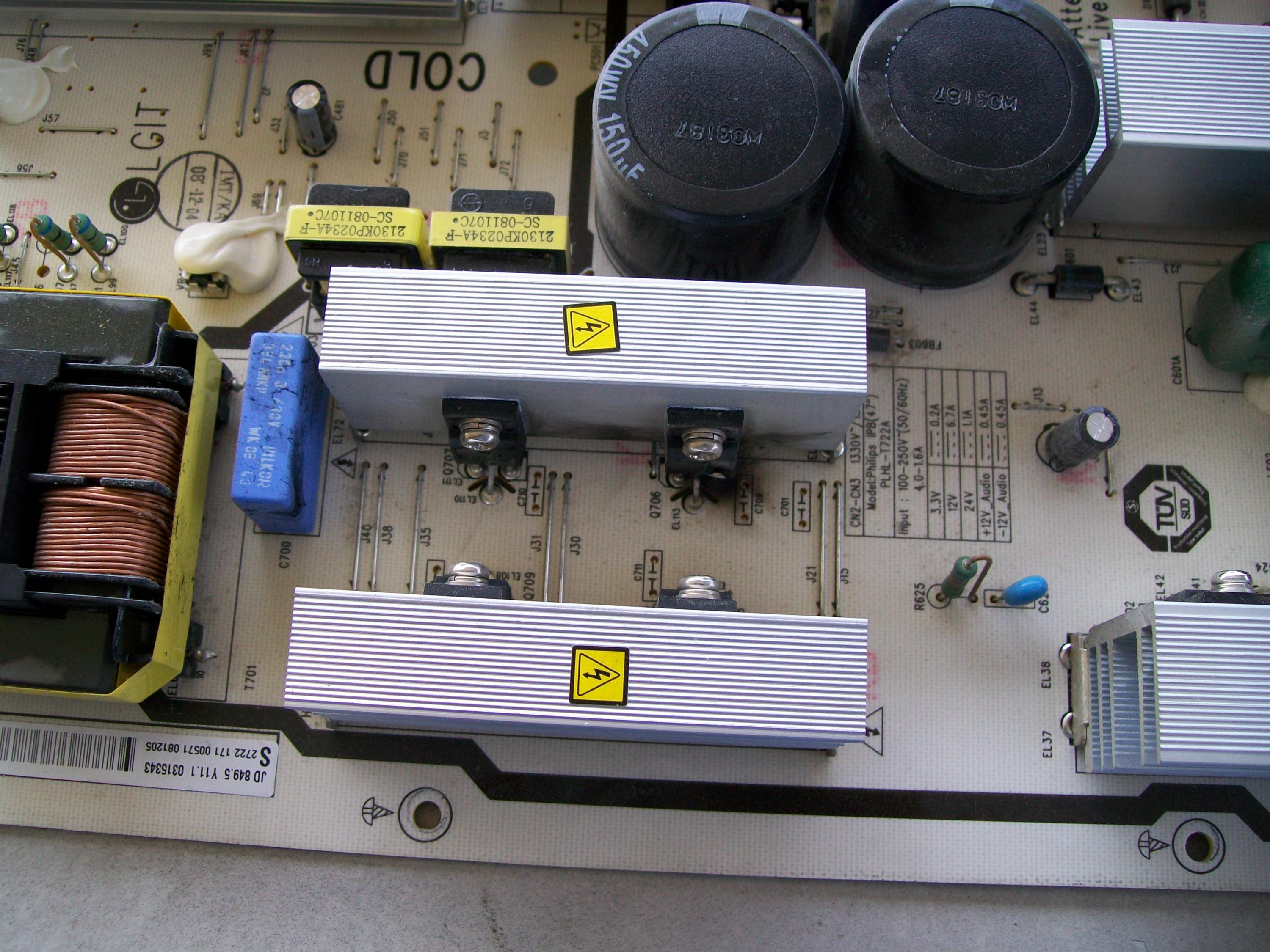

    When plugged in I get no standby light or any signs of life.
    I took it apart and from just doing a quick visual inspection I noticed a MOSFET that looks burned out ( has a hole burnt in it and the right leg is burnt off) and there is a thermistor up next to a couple of relays that has a whole burnt in it as well.
    I checked the 3 fuses with my DMM and the 1 at position F1 was blown.
    The fuse is labeled T8.0A H 250V
    The MOSFET is labeled F1 J44, FDPF, 7N50U (there are 4 alike in positions Q706-Q709).
    The thermistor is labeled SCK, 086, 831D and it's position is TH1.
    Do you think if I replace the bad MOSFET (and test and/or replace the others), the thermistor, and the fuse that it will work or is there more components likely bad as well?
    or should I just get the repair kit from shopjimmy and a thermistor (if I can figure out where to buy one) and go that route?
    Chassis is Philips LC8.1U LA
    Power supply is 272217100571, 2300KEG033A-F, PLHL-T722A
    I haven had a chance to take pictures of the actual board I am working on yet, but in the meantime I uploaded a pic I downloaded with the damage locations circled in red.

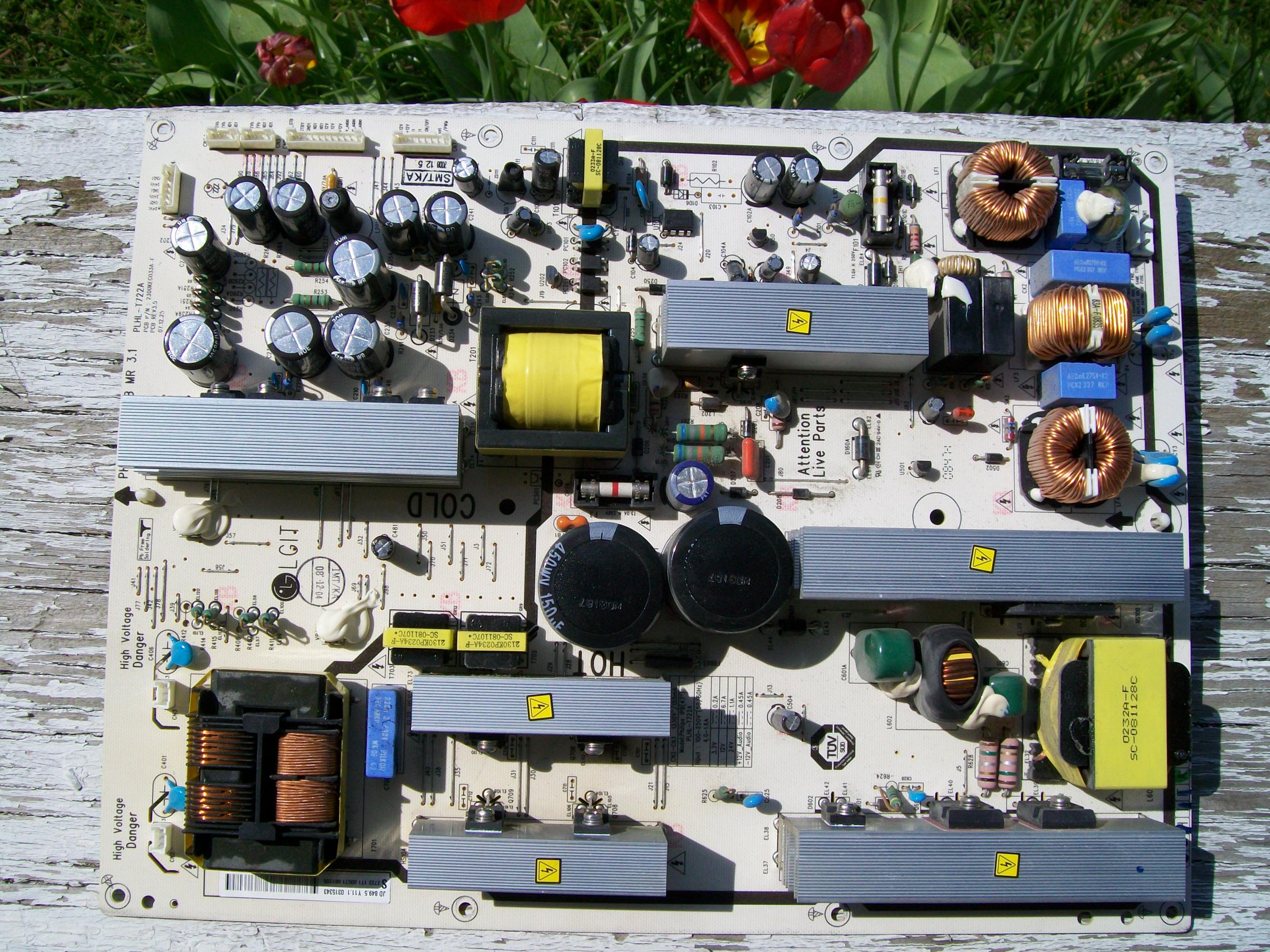

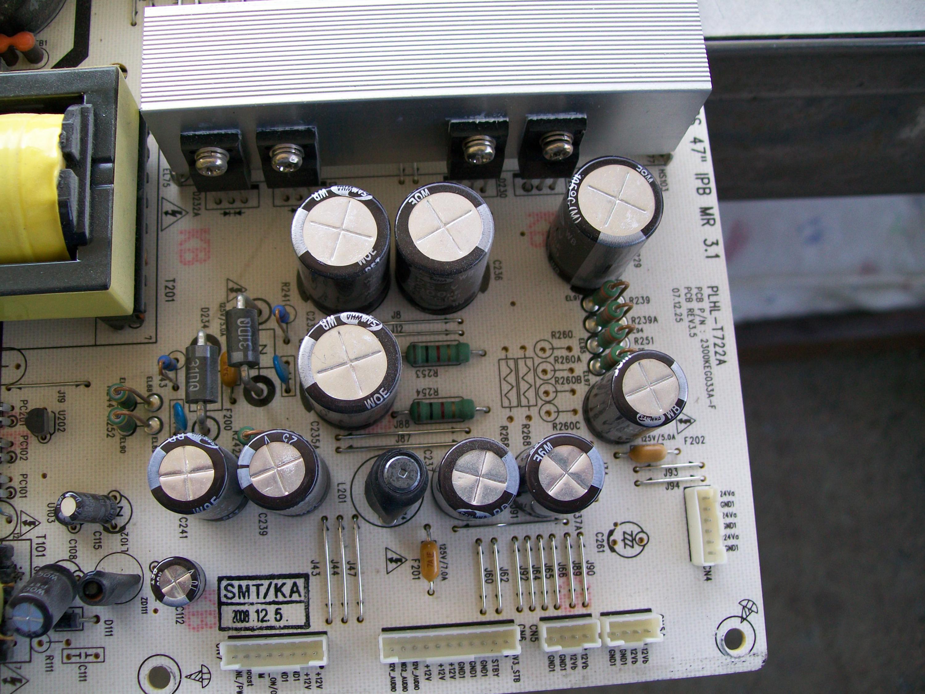

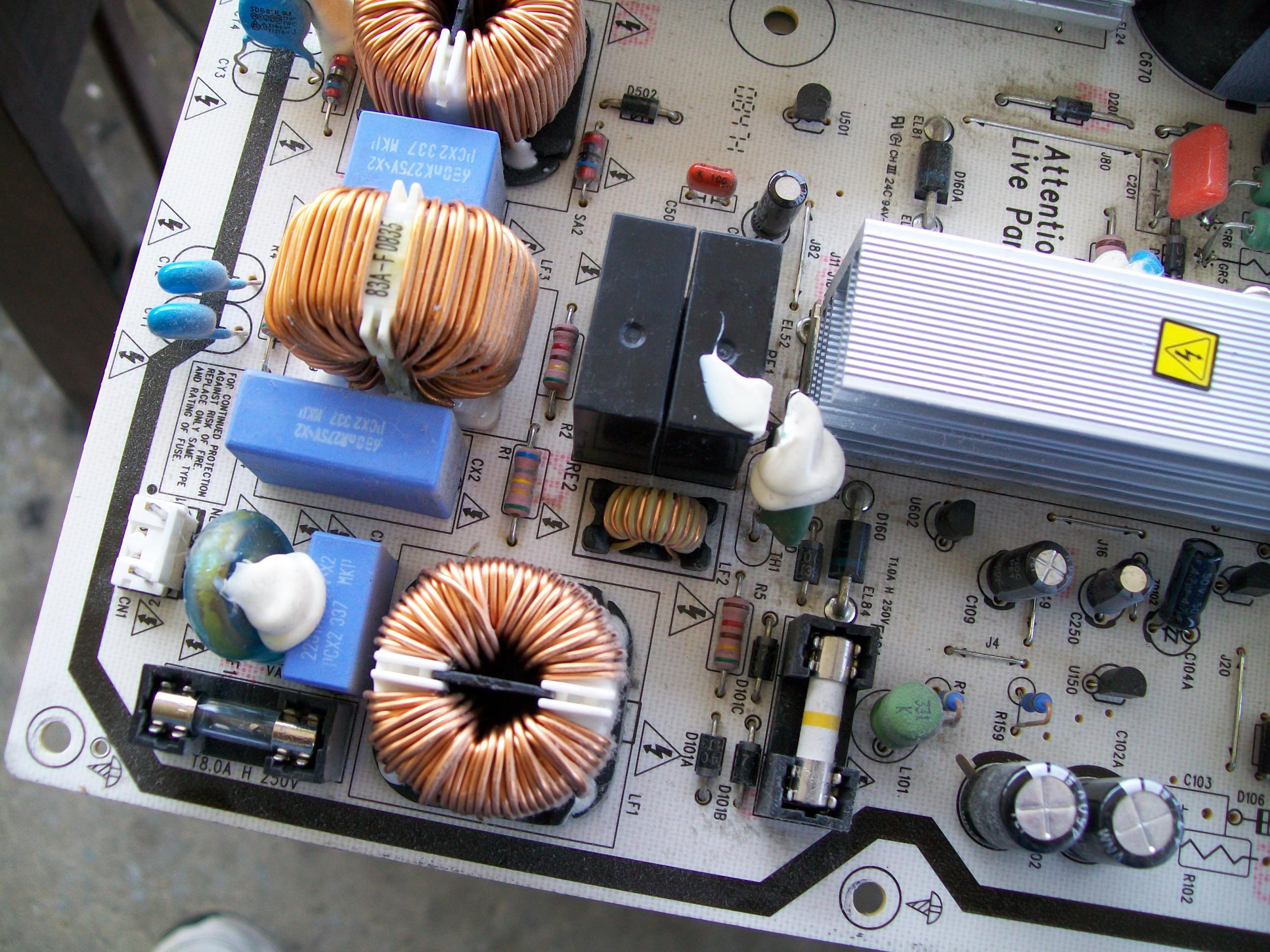

    I finally was able to get some pictures of my psu board.
    any ideas guys?
    thanks

      Re: Phillips 47PFL3603D/F7 No Power
      Put a 100w light bulb in series with the AC mains line to prevent further damage on the PSU or after you exchanged parts.
      Only because you don't see more blown parts, doesn't mean you are done there. You want to check diodes and even resistors too. All depends on what kind of equipment you have and how far you want to go. Be careful on the hot side of the PSU, there can be 39oV DC stored in those main filter caps!
      What makes you think the thermistor is bad?

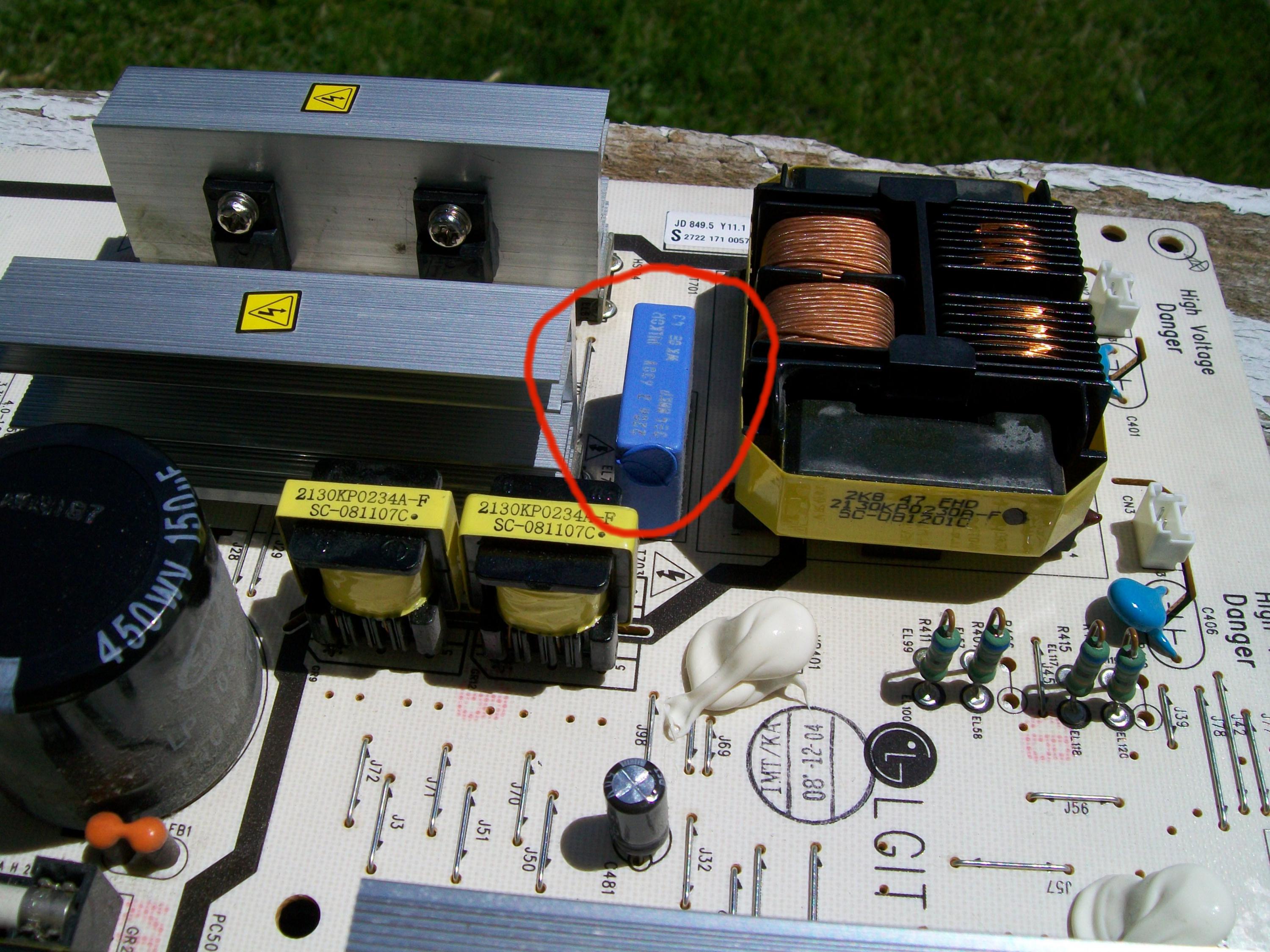

                      In post#2 pic 4 I noticed there is a blue rectangle shaped thing at location C700 (some kind of cap?) next to T701 that looks like it has some kind of black stuff on it.
                      If that cap is bad could that cause the transformer to buzz?
                      With caps I have always heard you could go up some on the voltage, but should always try to match the uF. That's why it seemed odd to me shopjimmy would have the wrong value cap in the kit.
                      I think I'll contact them to see what they say.

                            Something that caught my eye when looking at the board today is the film cap located at C700 looks damaged.
                            Does anyone know where I could find a replacement?
                            The original is marked Pilkor, 384MKP, 220n J 630v, wk 08 43.
                            Digikey chat said they didn't have any box shaped ones but did have a axial lead http://www.digikey.com/product-searc...=0&pageSize=25 that might work, but I would need to check the data sheets.
                            I am in over my head a little when it comes to data sheets..do u think the digikey part would work?
                            attached is a pic of my possibly bad C700 cap.
                            thanks

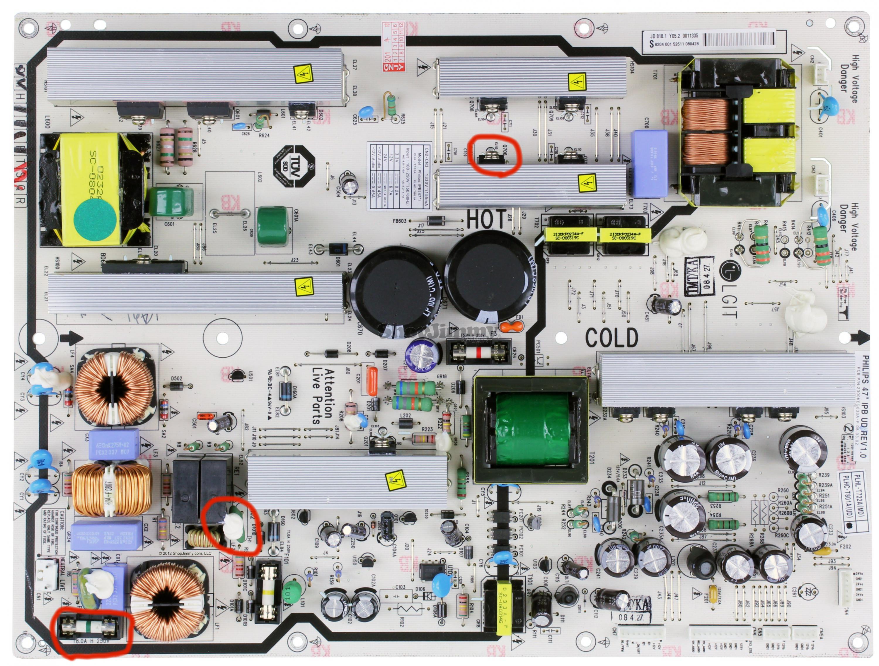

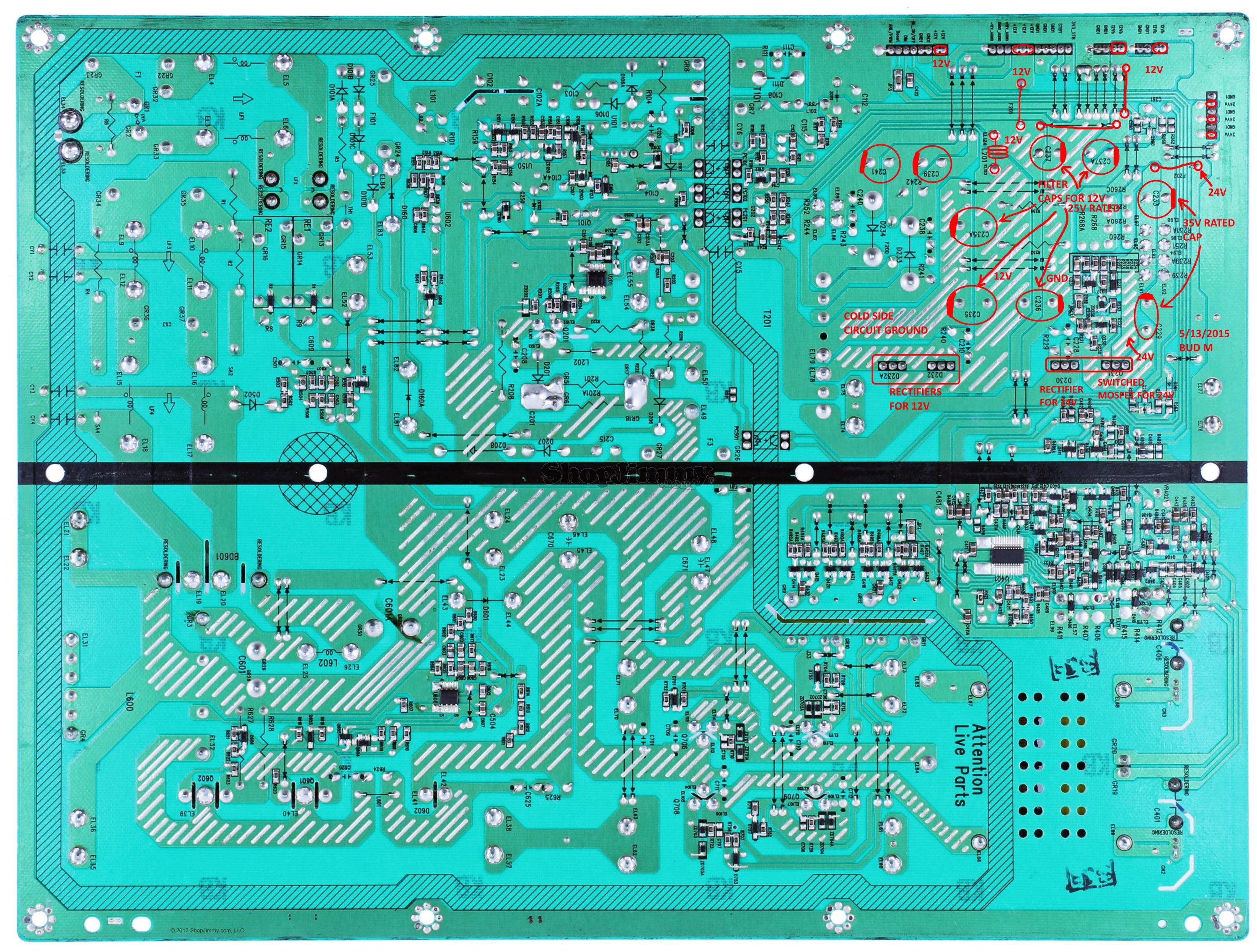

                              That is special hi-pulse withstanding cap for driving the inverter transformer, it looks like some one melted it with soldering iron but not electrically damaged. When this cap is bad it will lose its capacitance.
                              BTW, there 5 fuses on that power supply board, are the F201, 202 (small yellow fuses) OK?
                              I marked what the Voltage of the 12V and the 24V filter caps voltage rating should be.
                              Pictures provided by shopjimmy.

                                I measured F201, 202 on my freebie harbor freight dmm on the 200ohm setting and got .5 ohm for those 2 fuses.
                                I am still very much a newb when it comes to troubleshooting..Do I plug the board in and test with the TV in standby or fully powered on?
                                Also do I just test just the caps or everywhere circled?
                                thanks
                                  So at this point you installed the new caps and the unit is not blowing fuse, right?
                                  If that is the case, then hook up everything back together and take the DCV readings of each pin with its pin names next to the reading of voltage of the connector on the power supply board that goes to the main board sow e can see what are missing.
                                  Take the readings when TV is off and when power switch is activated.
