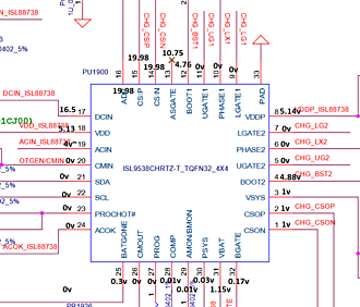

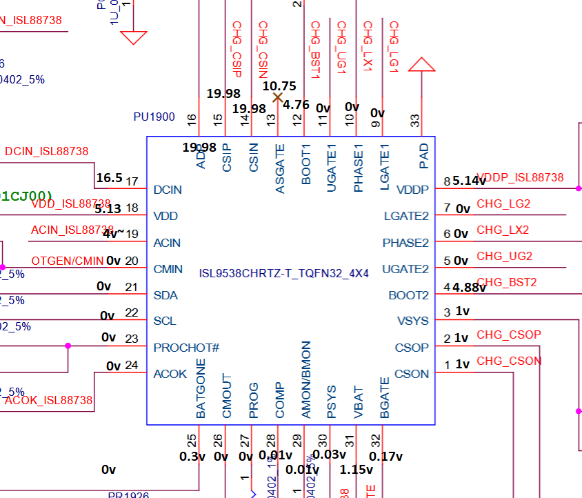

    Precision 5550 LA-J191P No Power, Burnt ISL9538
    I picked up this Precision 5550 to fix up recently, and found that the ISL9538 chip was burnt on pin 14 (CSIN). The two left side Type C ports negotiate at 20v, and the right side one only negotiates at 5v. I also found the EMI protection diode, DT35, was burnt on that side. I pulled the ISL9538 off, checked for any other obvious shorts, repaired the pad, and put a new one on. Now, I still do not get power, and there is a rapid clicking sound from somewhere on the board that I can't pinpoint.
    Here are the voltages measured at that chip:
Name:	PU1900 Voltages.png
    To note, DCIN at Pin 17 is low, fluctuates between 16.4 and 16.6v, and pins 1 2 and 3 are all low at 1v. I do not have any voltage on the main power rail.
    Where should I be looking next? Does anyone know if there may be a boardview available for these (or the XPS 9500/9510)? Doesn't seem like there is, but figured I'd ask!

                            Remove all power. Meter in resistance mode. Measure the resistance across the resistor @ PR1907. Is this ~2 ohms? If not, it is defective. This is a point of failure.
                            Measure the resistance to ground of the DCIN pin # 17. Post each measurement.
                            • swimllamaswim
                              • May 2016
                              • 20
                              PR1907 is at 505 ohms, and once I cleared some trash off the board around it, I did notice it has a small burn hole on top of it. I'll see if I have one of those and get it replaced.
                              Pin 17 to ground is showing OL.
