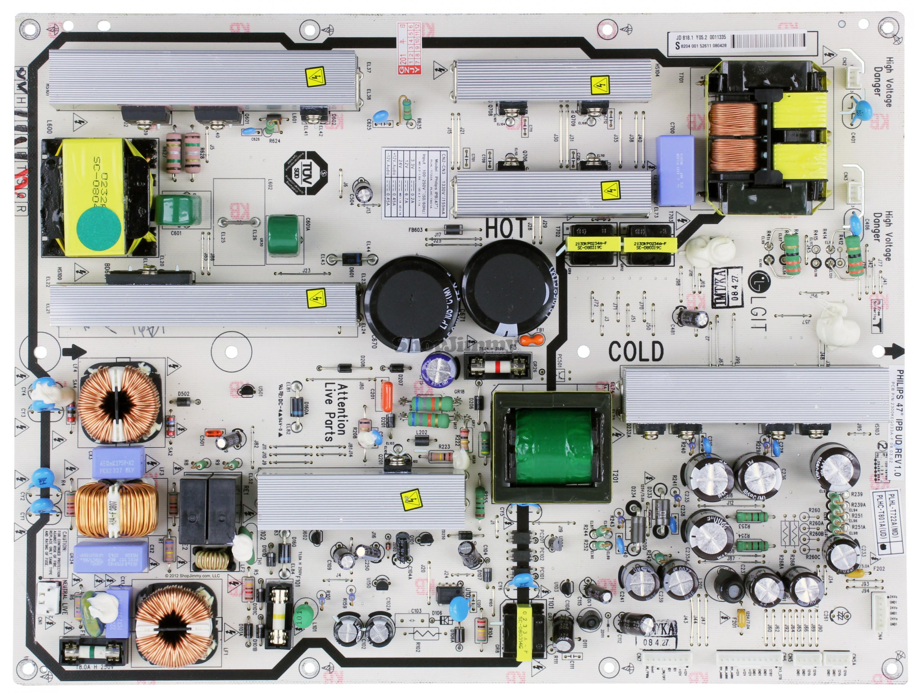

                Quick question if I may. My Philips 47", 47PFL3603D/F7 was purchased used and broken. The set was dead. Opened it up and found a burned connection on the board where the transformer has been a problem on many other TV sets. I repaired the connection no problem. I also noticed two small caps beginning to bulge.(C-108 & C-112) I replaced them, but with 85 degree rated that I had in old stock. I plugged the TV in and it worked. After watching for a short time I noticed the picture began to intermittently stretch out past the bottom of the viewing area resulting in a distorted picture. I have no schematic on this set and was wondering if either of the caps I replaced are in the vertical circuit? I have ordered the correct caps and was also wondering if I should replace any of the others even they appear ok. (no signs of bulging) I have opened the set back up and see no signs of damage to the two caps that I had replaced or any others. I will wait until I get the 2 correct caps in before powering up again.
                Thanks for any help/advise.

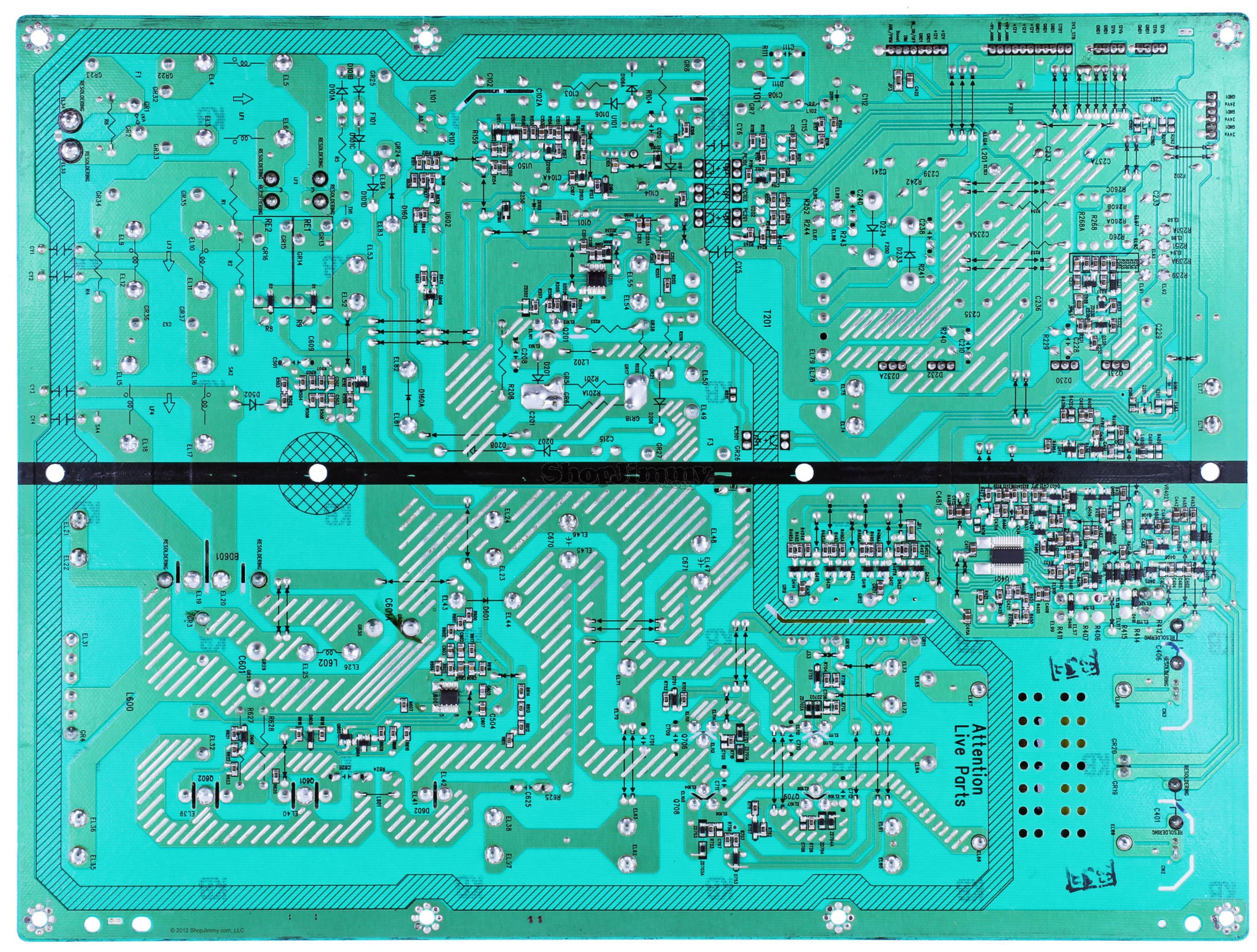

                    Re: Phillips 47PFL3603D/F7 No Power
                    'I also noticed two small caps beginning to bulge.(C-108 & C-112)' On which board?
                    Is this your power supply board?
                    http://www.shopjimmy.com/philips-272...upply-unit.htm
                      Yes the two caps I replaced are on the power supply board you identified. Hopefully when I get the correct caps in, this vertical/stretching will go away. They are located on the right side a little over half way up, just above the small transformer and just below the wiring harness plug.
                        C-108 & C-112 are filter caps for the 3.3V STBY power supply, they are not the cause of the pictures problem.
                        Do you have screen shot of what the pictures look like? It sounds like bad panel.
                        Philips 272217100571 (2300KEG033A-F) Power Supply Unit.

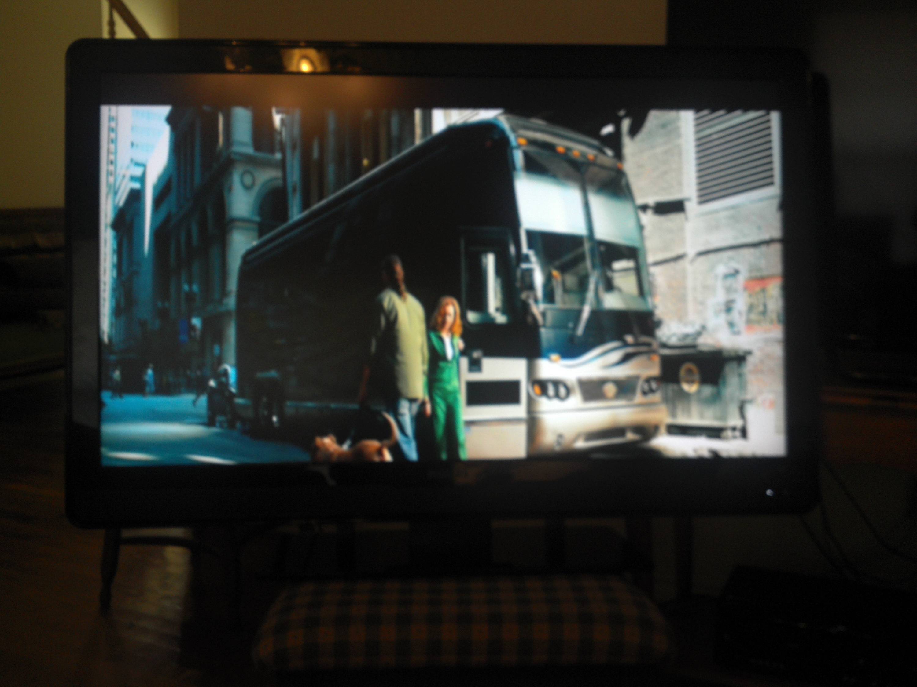

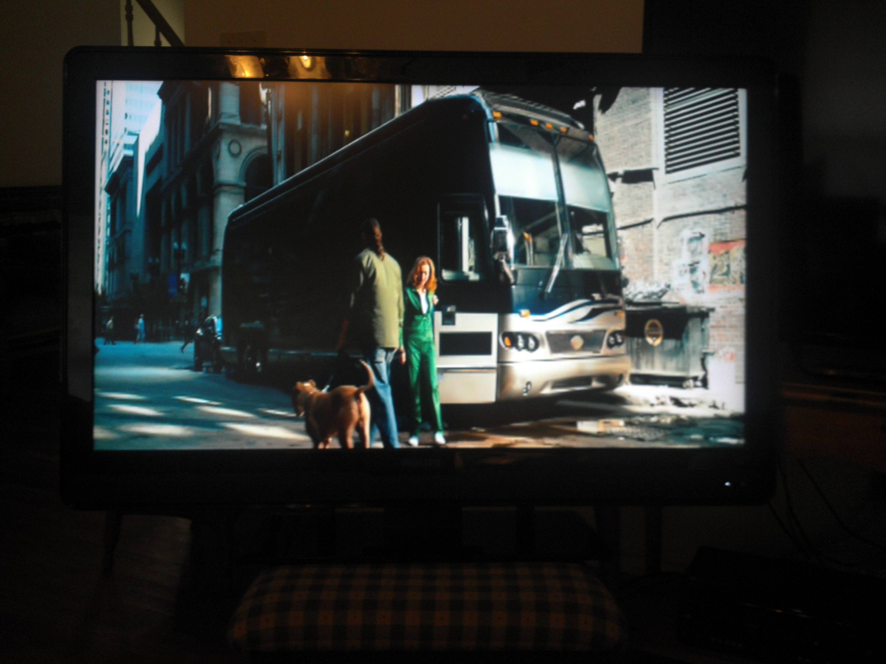

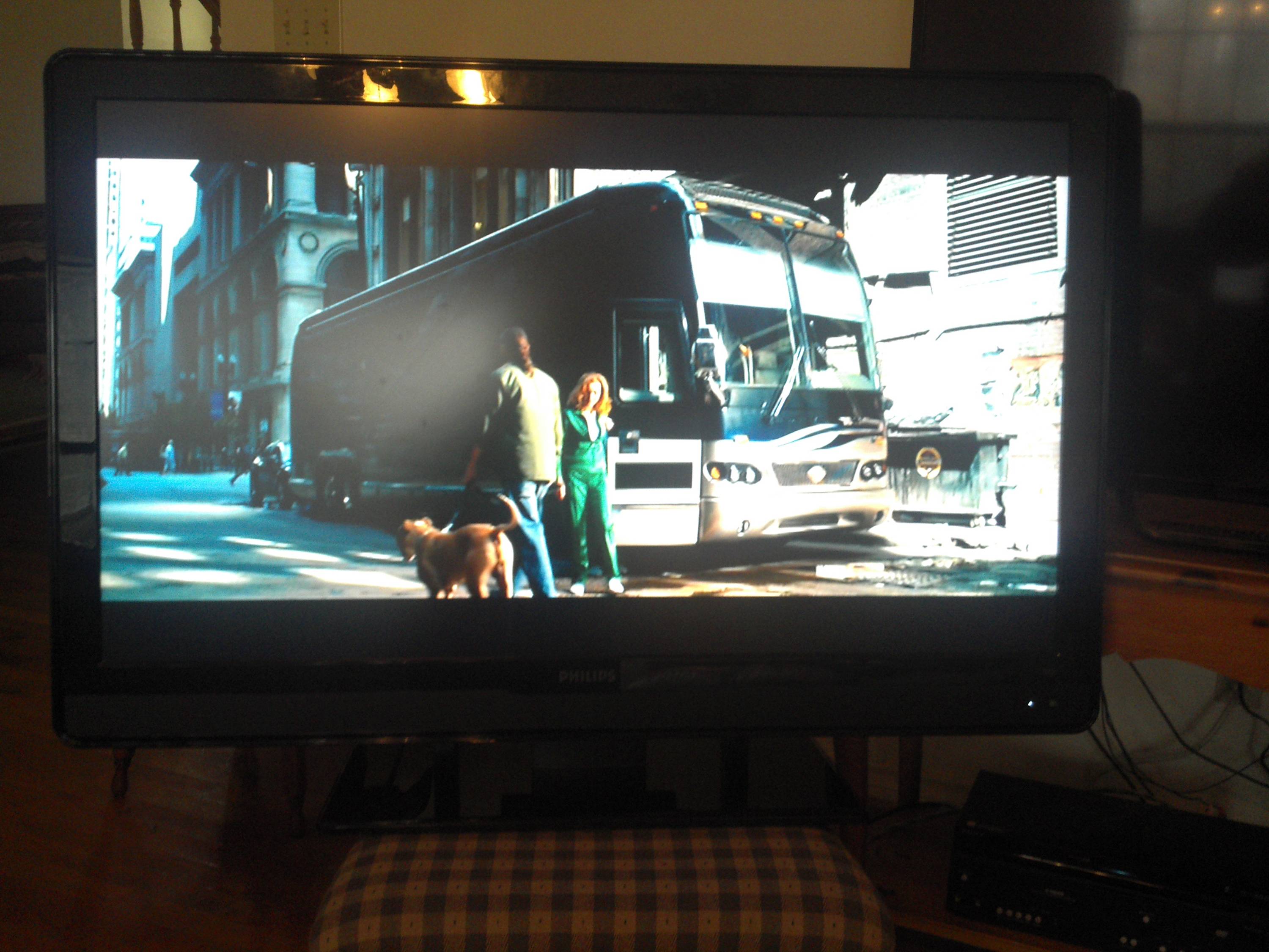

                                  When normally watching a movie there will be a blacked out area above and below the picture. After warming up the picture will stretch out beyond the bottom of the blacked out area at the bottom. And later the top part of the picture will do the same thing. This leaves no blacked out areas on the screen and elongated images. Similar to the old verticle fold over issues we used to experience in the old days.
                                    #57
                                    Well, I had to get my daughter to walk me through process to load
                                    pictures.
                                    Hopefully this will work? Three images:
                                    one shows the correct image(black band,border at the top and bottom of the screen)
                                    two shows bottom black band gone(image goes all the way to the screen bottom)
                                    three shows bottom and top black band gone(picture fills entire screen)
                                    It occurs to me that perhaps this could be a problem in the ZOOM circuit and not a vertical issue?
                                      sorry here is the No. 2 pic
                                        #59
                                        and here is No. 3

                                          T701 is inverter transformer that crates high Voltage (1500~2000V) to light up the CCFL's (Cold Cathode Fluorescent Lamp) inside the LCD panel for the light source.
                                          The LCD TV has pictures aspect ratio setting mode, normal, full (fill), zoom 1, zoom 2, etc.
