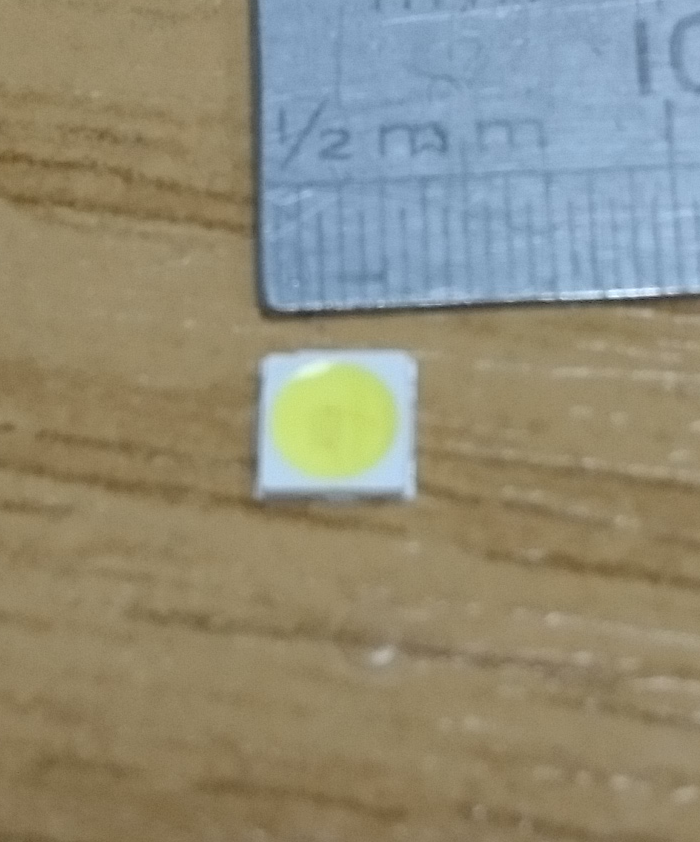

      #42
      Re: LG 47LN578V - Brief Backlight flash on power up.
      i had a good look through them all - all similar to this http://www.ebay.co.uk/itm/50x-XENON-...HHYtHEAF0DjH8A
      my concern was all the forward current were rated at 20mA max which i'm guessing is much lower than spec.
      Personally I am leaning to these @ 200mA http://uk.rs-online.com/web/p/products/897-8737/
      or maybe these at @ 300mA http://uk.rs-online.com/web/p/products/897-8784/
        #43
        Those 3528 are rated around 30mA which is not going to make it.
        3535 in your link () will be better but not sue if it will fit the footprint on the PCB.

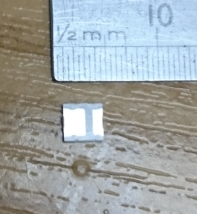

                    #49
                    So this is the footprint. Was hoping for more 'side' access to the pad but looks as though it needs to be sat on the pad from above.
                    I intend to be using a hot air station from below so shall see!
                    It appears there are 2 bits on each pad which wrap up the side of the led which you could use for soldering but they are thin and wouldn't like to guarantee to be a good enough connection.

                      #50
                      the larger pad is the actual base of the reflector and acts as the heatsink - or the link to one.

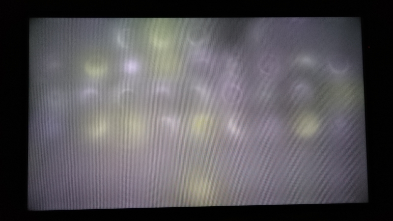

                          #52
                          Funnily enough that is exactly my experience! So my previously fixed tv died again. Stripped and saw no obviously (new) dead led but 1 string was obviously not flashing at all at startup. Narrowed down by swapping the r1 r2 l1 l2 combos until the other string failed. Then popped off the led lens to work along. Curiously, on my multimeter in continuity mode which beeps, i can just manage to get a working led to light which helped no end identify the issue. One of the led's which had previously failed shorted had popped and was open. Cool, set meter into current mode and measure current. Voila set backlights working again - albeit with dead ones still in existence.
                          Interestingly, screen is brightest just after powerup at a whopping 400mA over the string, this settled to ~140mA based @ a backlight of 30 iirc. That proved, I still had 9 dead leds from before. I had the repalcement led's linkedf rom above from rs as a repalcement so set about pulling of lens and removing dead led with hot ait staion (Aoyue 908). 2 were problematic in that they were somewhat welded to the pad and took some force with a soldering iron. 2nd problem was that the larger heatsink on the pad is the anode and on the replacement led is the cathode. This mean the led position is moved approx 2 mm down form where it was originally intended. This was a pain for a few as there were obvious shorts which needed reworking. Eventually, all failed 9 were replaced having then also removed several adjacent led's to test continuity in the string.
                          Next part reassembly - this turnewd out to be hard. As I had removed nearly half of the 54 led lens via trial an error and faultfinding i intended to reglue them back. Ok this kindof worked using superglue however
                          1: the lens were mixed up so not going back to original source so legs may have broken is different locations
                          2: The new leds were actually now lower than originally located so this meant the lens didnt fit correctly either.
                          Also re-assembly showed many lens were out of position and simply fell off. Pikey fix was to attach with clear sellotape. This worked to a fashion, re-assembled and made sure diffuser panels were ok then powered up. Result was massive bleed from all over the place. The 9 led were actually brighter and marginally different colour than original, 2nd the lens alignment makes a huge difference to baclight continuity.
                          I was stuck and had removed too many lens to do anything so I reassembled and put tv back into front room where the final results annoyed the hell out of me.
                          Pic below is finally assembled tv showing a test pattern from openelec (kodi).
                          The 9 different colour patches obviosuly show where the new leds are, then the other halo marks are original led's which have misplaced lens.
                          These are 6500k led's rated at 300mA and 70 cri. These look too bright and the wrong colour. I thinkt hey are 52 lumen too. Maybe closer to 7000k is required.
                          Also ideally, heatsink pad needs to be reversed.
                          Major issue is lens reattaching. I would love to know how anyone has correctly done this ? I can only suggest using some kind of washer ? which will keep them alaigned correctly but i guess would need to be a specific thickness.
