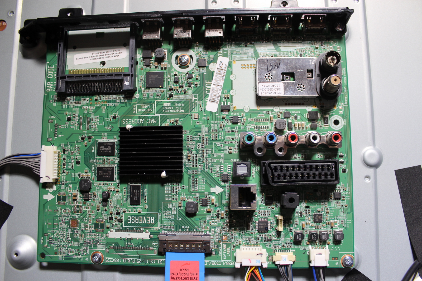

    Hello everyone!
    I'm trying to repair an LG smart TV, 47LN578V and have so far come to conclusion that the PSU has a fault but would like a second opinion.
    Symptoms
    Powering TV on causes the screen to come on briefly with LG logo then the backlight goes out, the smart functions of the set continue to function and the TV can be controlled both via the remote and over the android application.
    Shining a light into the screen allowed me to view the android application pairing key.
    Measurements
    Main, Large, Cap: 394V
    Main connector to main board (P201):
    Row 1/Row2
    GND/GND
    11.8V/24.8V
    11.8V/11.8V
    GND/GND
    24.9V/24.8V
    GND/GND
    3.52V/1.12V (PDIM2)
    3.51V/1.12V (PDIM1)
    3.4V/3.22V
    Backlight LED Output:
    0V, brief spike that my DMM cant pick up quick enough beyond a flash of a number >24V then returns to 0V
    Backlight Resistance Between pins:
    Nothing found
    Backlight Resistance to ground:
    Nothing found
    Notes
    The central transformer on the PSU gets quite warm, unsure whether this is normal.
    At this point should I just replace the Power Supply? My thinking is that if there was an open circuit on the back lighting strips then the BL would not come on at all, and measuring the pins on the BL connector found no obvious shorts between pins or to ground.
    Are there further troubleshooting steps I can take to narrow the problem down further?
    I hope I've provided all the required information, Any help is much appreciated

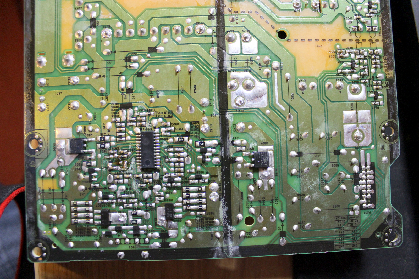

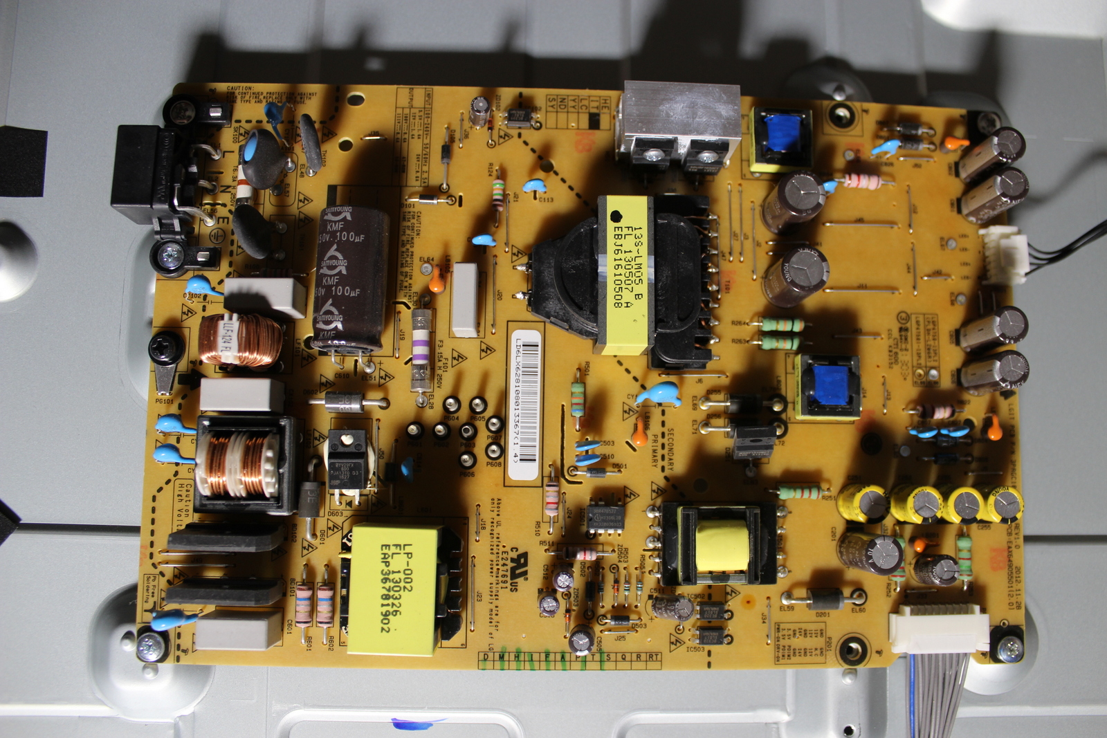

    I need good clear pictures of the backside of the power supply/LED driver board. More likely to be bad LEDs problem.

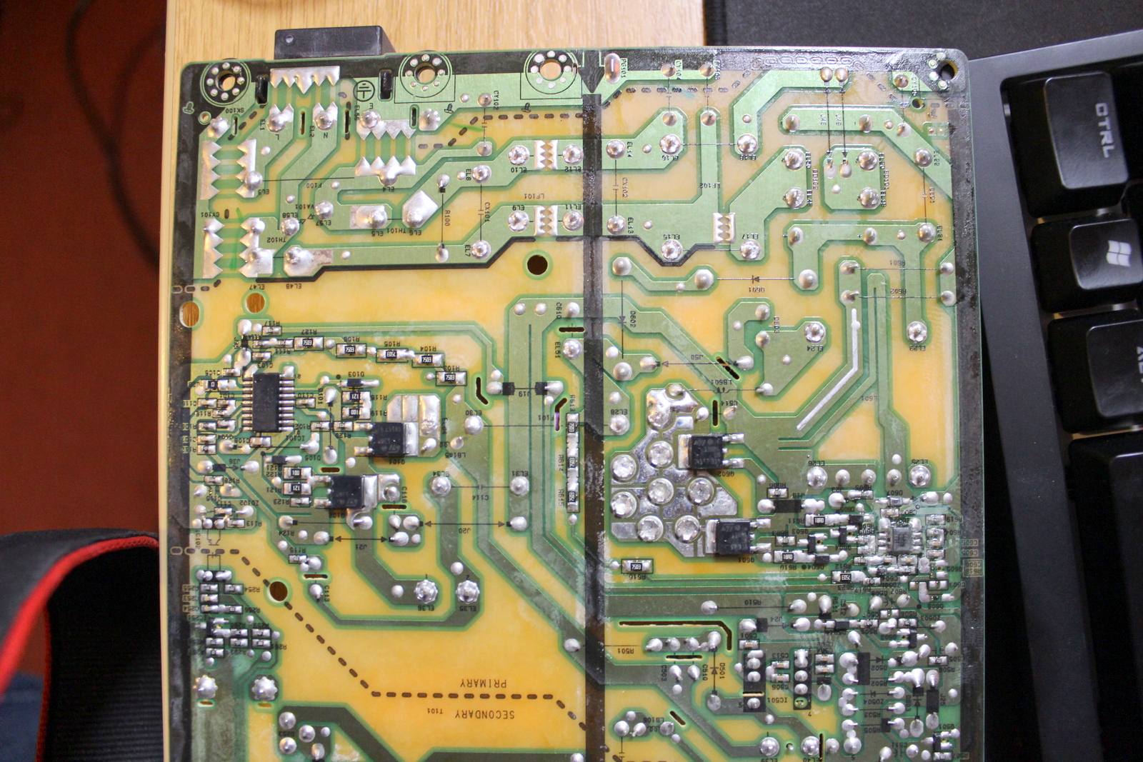

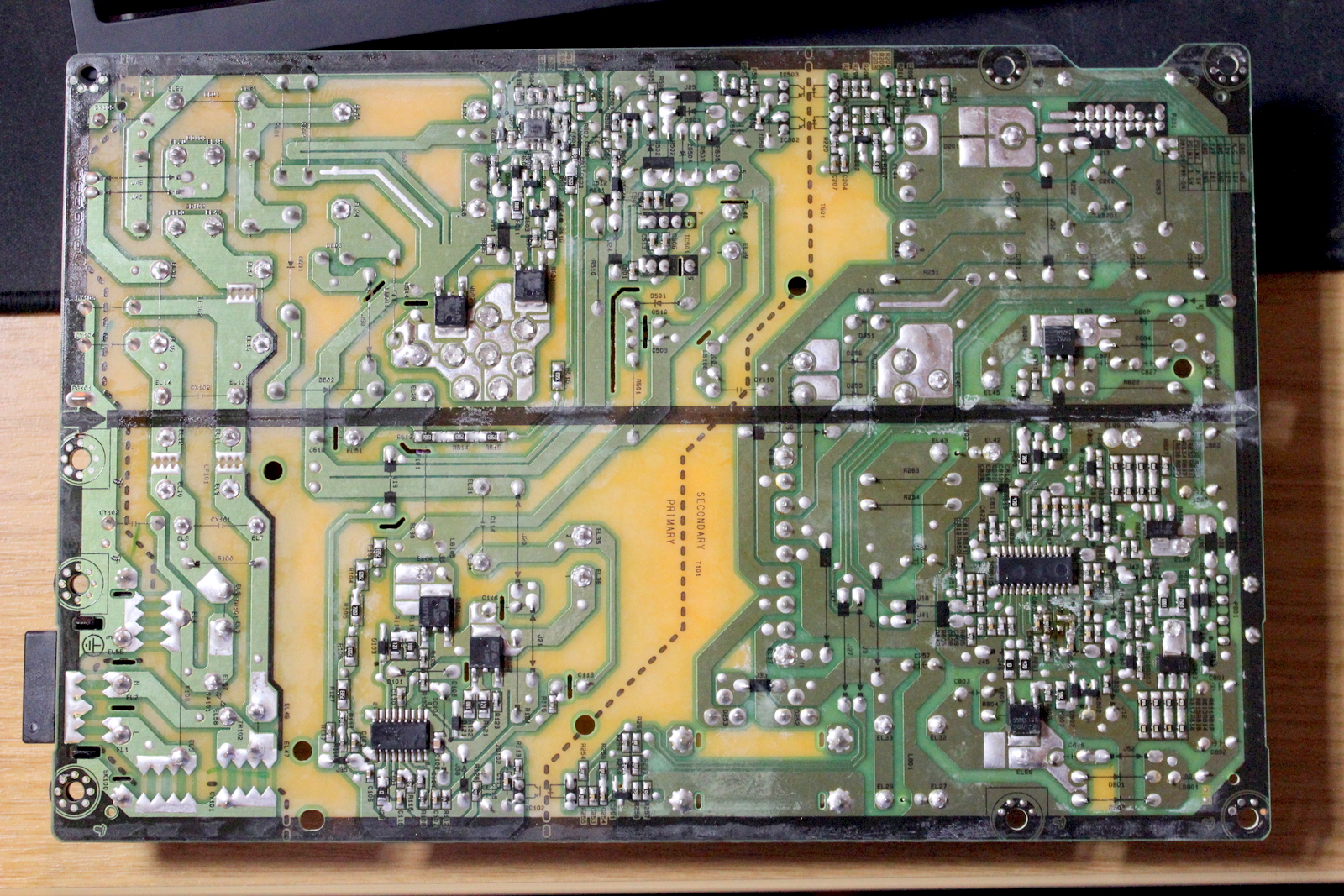

      Re: LG 47LN578V - Brief Backlight flash on power up.
      Hi Budm,
      Thank you for taking the time to look at my thread
      I hope these photos prove adequate.

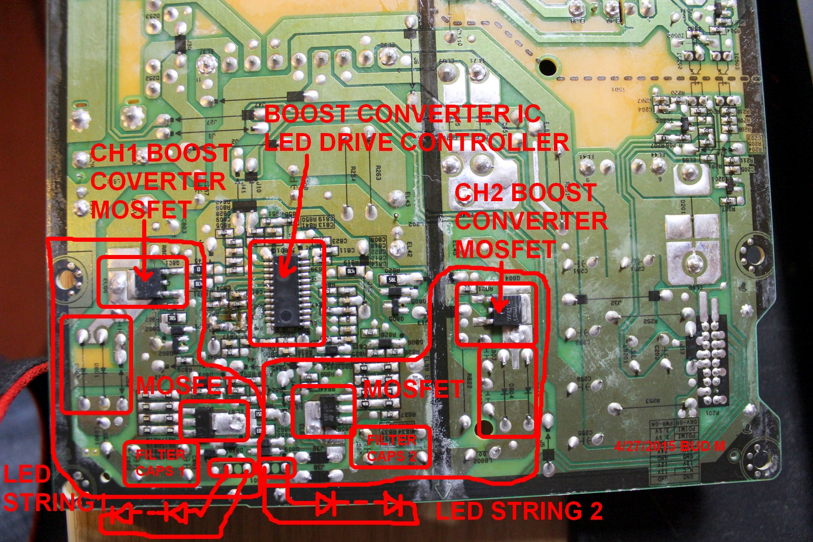

        OK, this TV uses two LED driver circuits one per string.
        If one of the string goes open circuit, it will cause the circuit to go into protection mode.
        You need to check the DCV on the + leg of CAPS 1 (any + of the two caps 1 legs) and Ground when you first turn on the TV, then turn the TV off and then check the + leg of the caps 2 when the TV is turn on.
        I expect one of the reading will show a lot higher DCV than the other.
        The two caps in CAPS 1 are connected in parallel and they are for the boosted DC filter caps.
        Same for CAPS 2.
        Right now I believe only one string of the two LEDs lights up.
          PSU and the innards are almost identical to mine and two others who recently posted with the same issues. This seems to be a spreading issue for these production runs if this turns out to be LEDs as well. Very much a pain to source, they are going for a mint on the used market as well.
            Hi Budm,
            Cheers for the diagram
            I have done the voltage measurements as requested and these are my findings:
            Cap set 1: 0V, Quickly rises to 160V then slowly discharges after backlight has turned off
            Cap set 2: 0V, Quickly rises to 96V then slowly discharges after backlight has turned off
            I'm guessing this points to a backlight strip fault? Intuition tells me that the strip powered by the circuit containing "Cap set 2" has a short or is at the very least taking excess current?

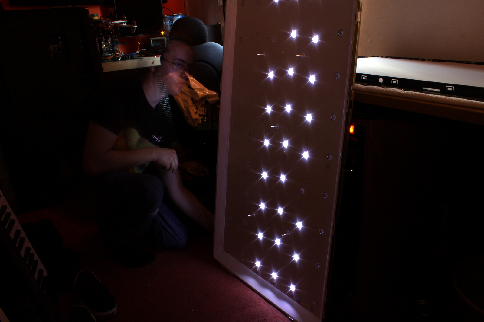

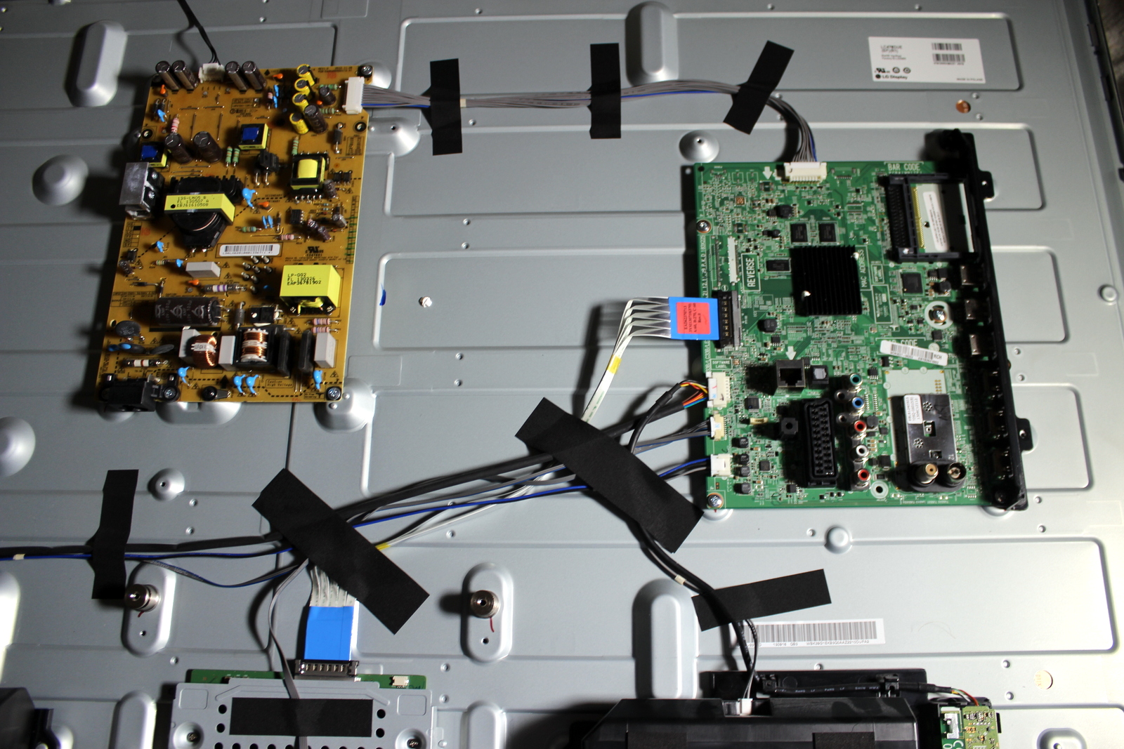

                Thought I may as well tear into it, in for a penny in for a pound =)
                I set up my DSLR with an 8 second exposure time and switched the TV on so I could easily see if any LEDs weren't coming on, the result is quite interesting...
                On two of LED strips there's one LED out... I'm assuming they are in series so surely these must me shorted? And then there's three entire rows that aren't lighting up. However one of the rows isn't in adjacent.
                At the very least it's a cool photo!
                  Series circuit, so when one component failed, the whole series circuit will be dead. Just like Christmas lights.
                    Originally posted by budm
                    "Cap set 1: 0V, Quickly rises to 160V then slowly discharges after backlight has turned off" You have open circuit, no load so the Voltage went up real high and so it goes into shutdown.
                    Open LED (bad LED), connections, etc. You need to open up the LCD panel assembly but good luck finding new LED or LED assemblies, one is already bad so you can expect the CH2 to go out later also.
                    LED backlights TV are very unreliable!
                    Timing!
                    Ah, That makes sense.
                    Thank you very much for your help. I shall see if I this potential backlight comes good, if not I think it may be destined for the scrap heap.
