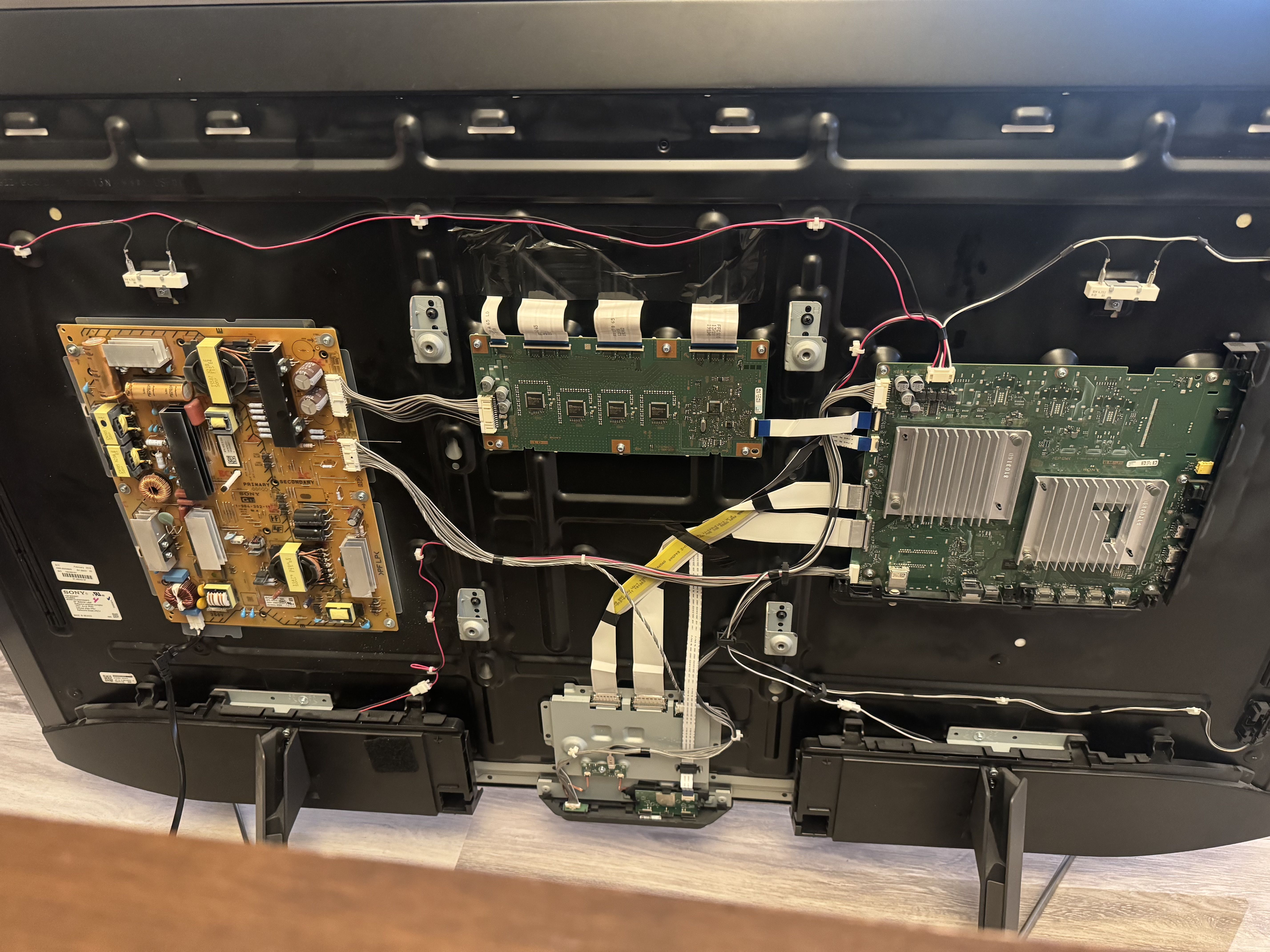

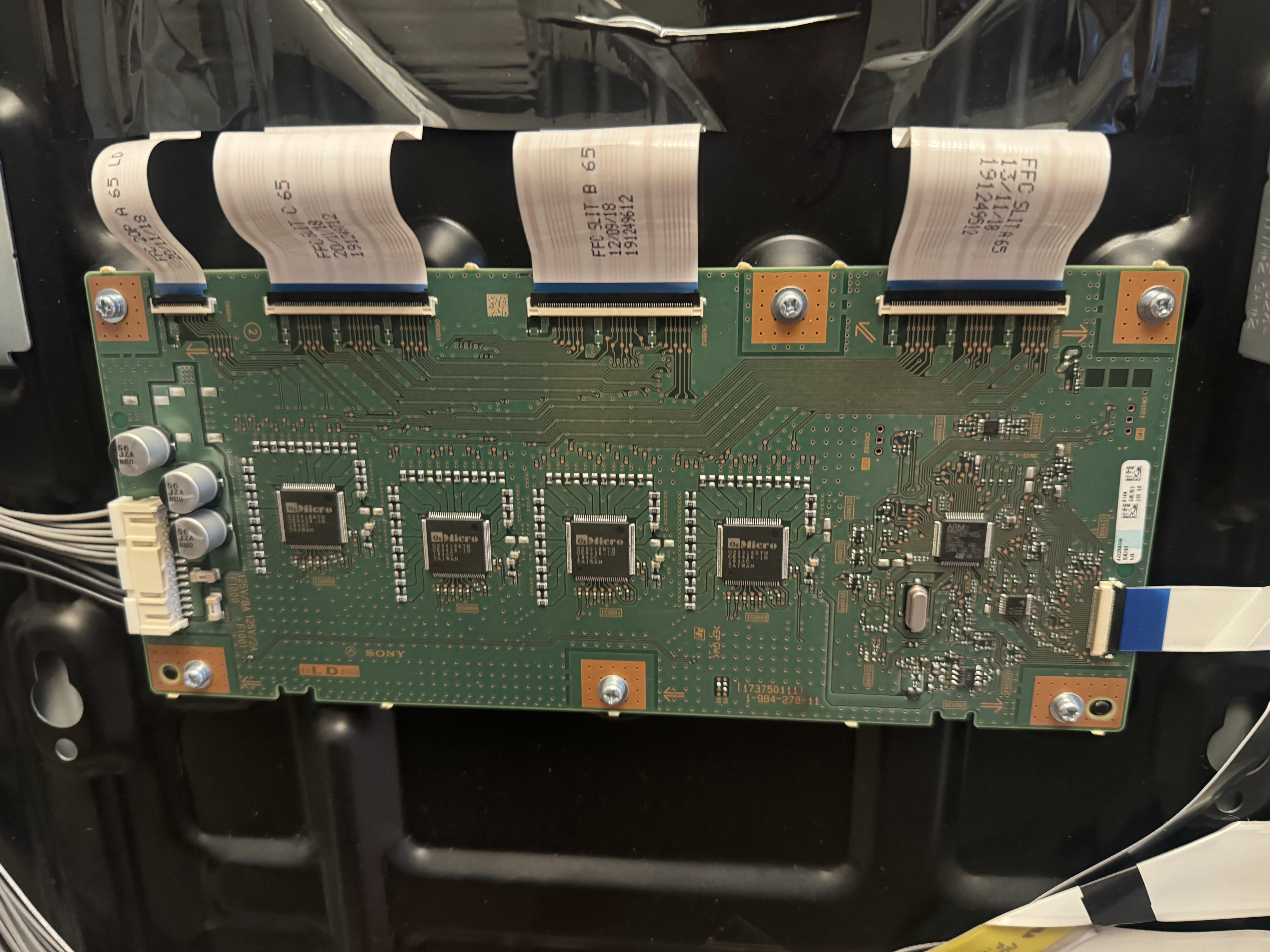

    HI guys
    I got here a Sony 65X950G - I tried to find any repairs guides for this model but not many online
    here is the issue
    I have Sony and android logo. but then 4 led red flash lights front of the tv
    I have 3.3v ref. 12v reg then T con 12v when I press the power on button
    but then I get black screen and 4 red flash light at the front LED
    but I get 3 led flash on the LED driver board.
    I check that few X900F or C YouTube repairs, seems that if you have 4 led red flash it could be due of LED black light error
    so I tried Nick cheat, check the BL_ERR for power
    but I don't get any, is that mean the back light should be ok?
    so anyone know what is the 3 flash red led on the LED board?
    also what could be the issue ? main board?

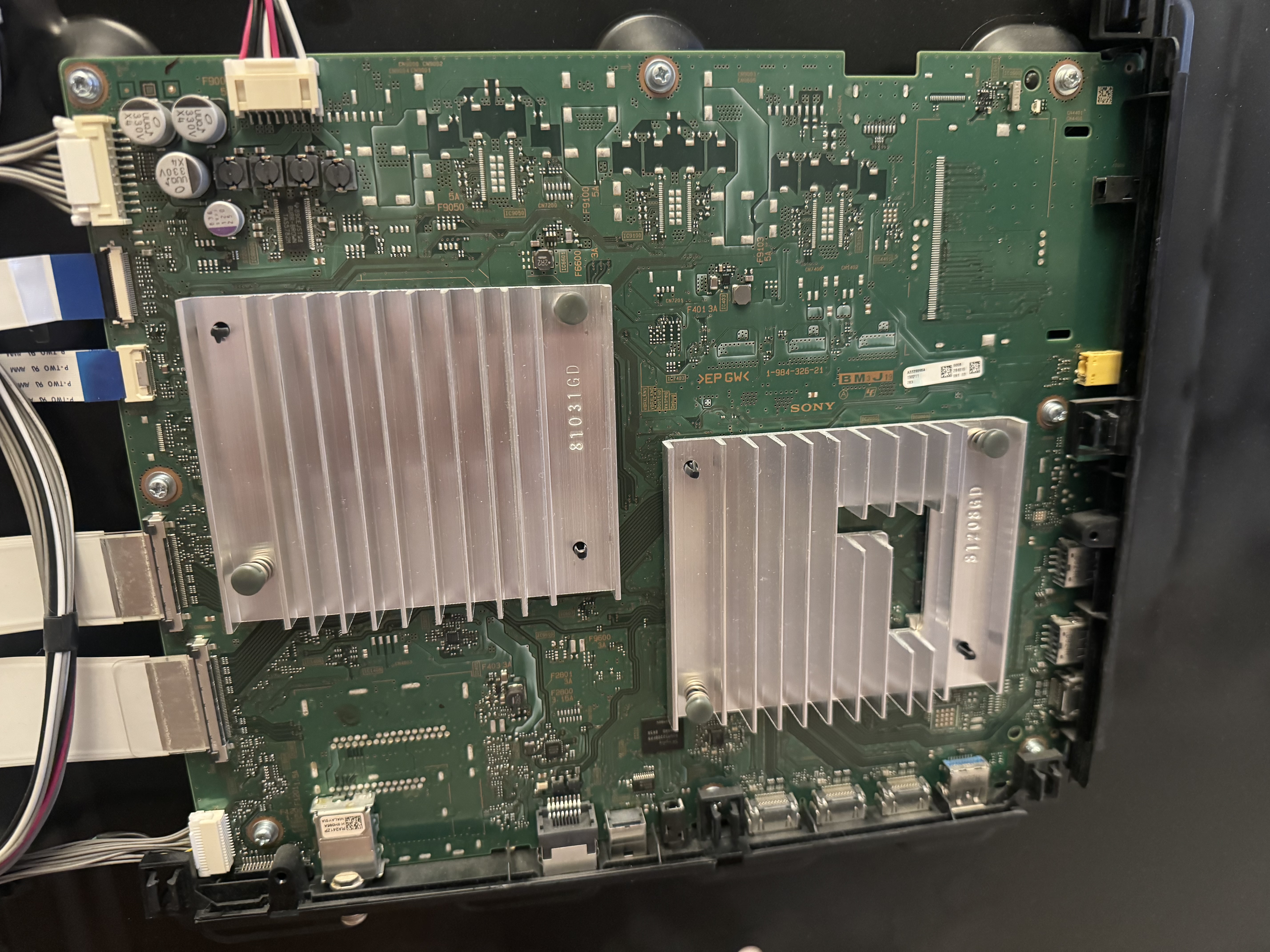

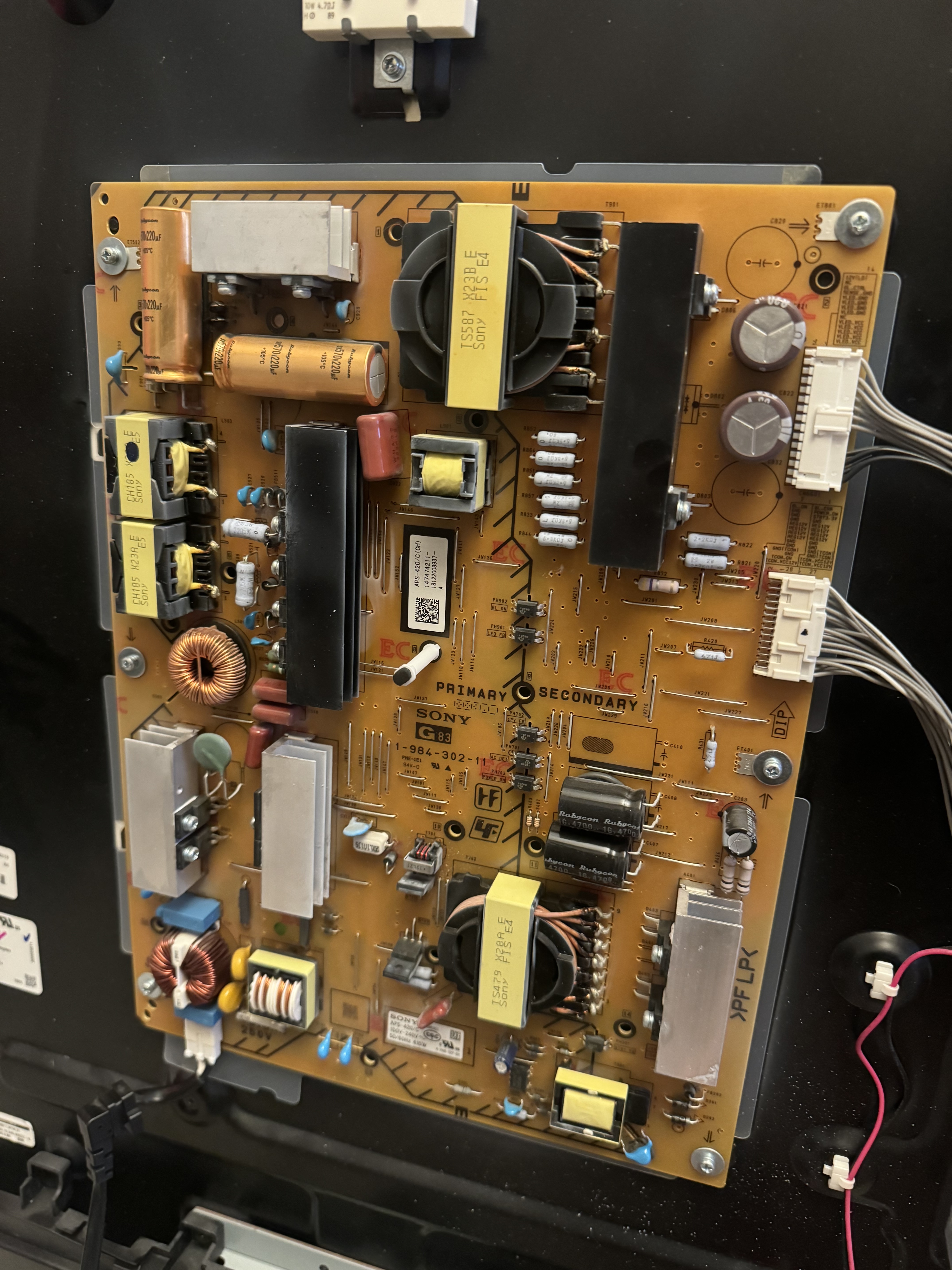

        Post some straight on pictures of each board and one of the whole back as to see how everything is connected.

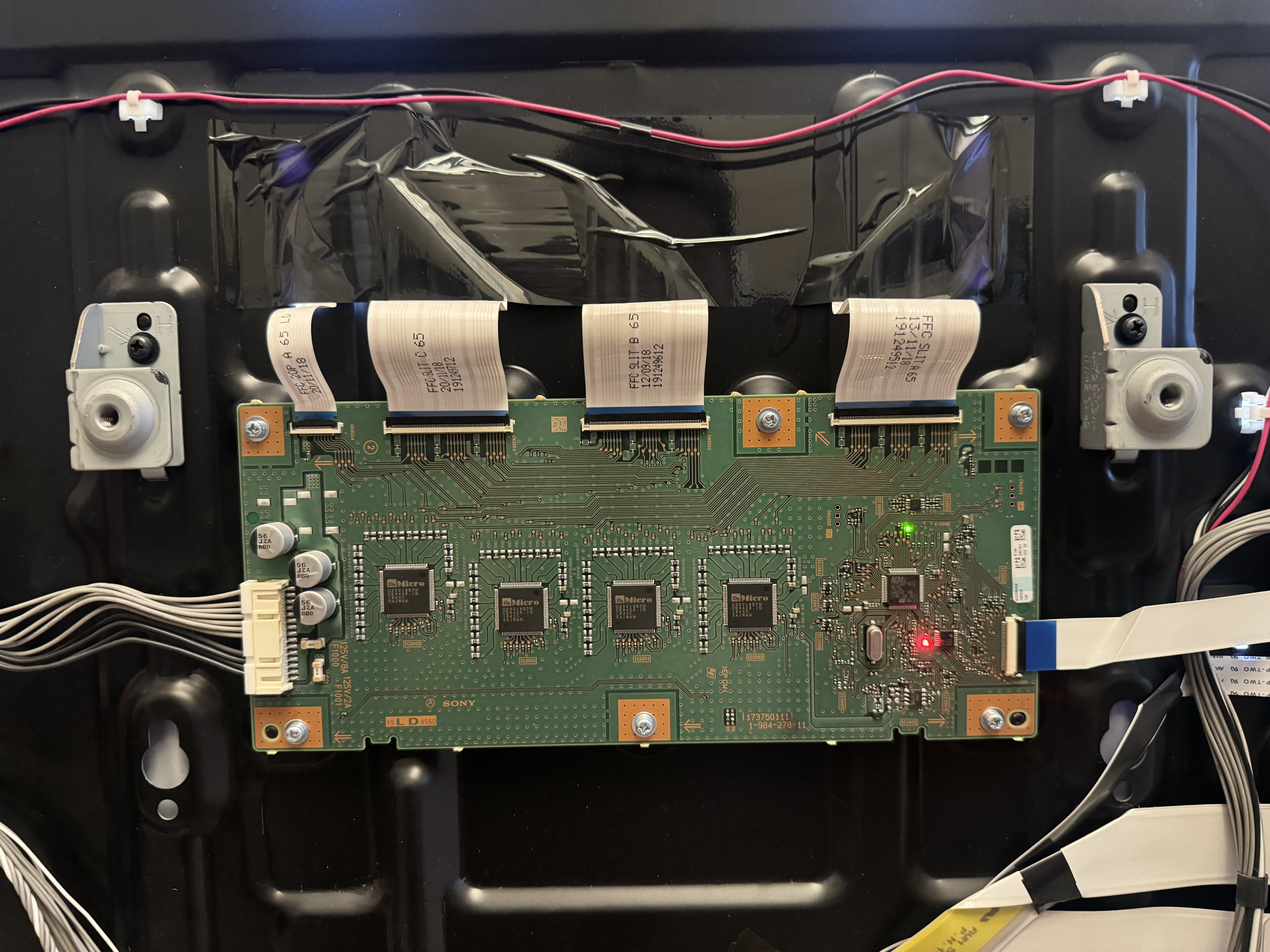

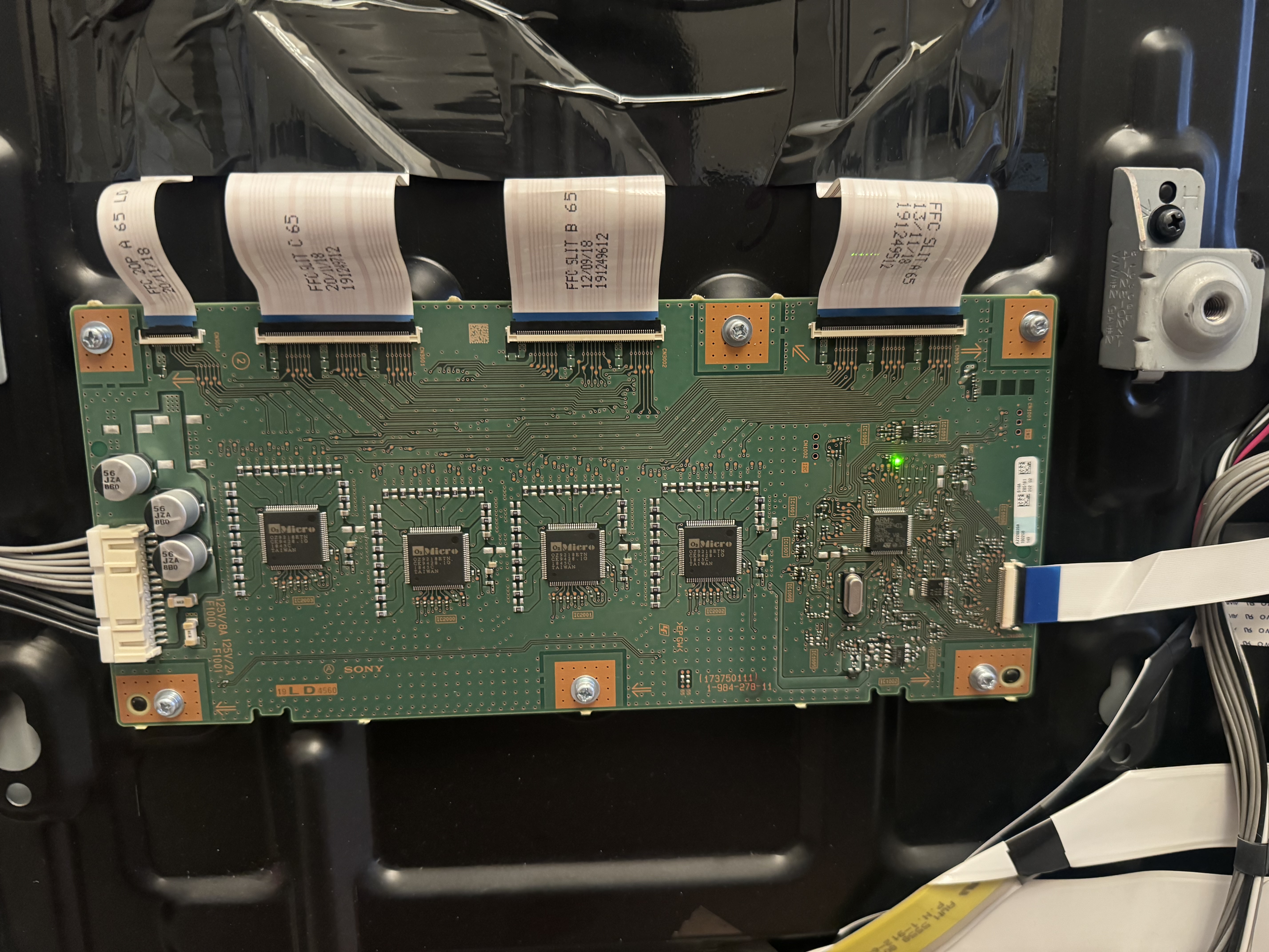

            • Ihandyrepair
              • Sep 2017
              • 44
              This board showing green led at start
              then 3 flashing red
