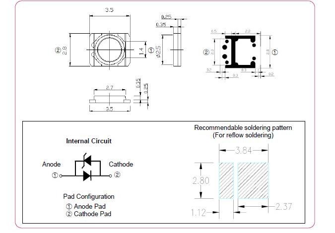

                    well i got under my hand LG47LA6208, and it was suffering from short LED and 2 open one. ( Open LED mean it doesn't make Light, but the Opposite Ziner Diode keep in touch and forward current to the next LED
                    I purchased from China LOT 100 pieces for less 10 USD and replace only the defect one and it had almost working perfect at background light 80%
                    the SMD LED are with 400 mA and it had round 100lum voltage 3.5 -3.65 Volt
                    the back light at TV are consider of 2 group, each had 3 right and 3 left, total are 54, mean each line had 27 LED. as well the TV had energy save mode, this mean it will used low current, if 1 LED had 3 Volts mean 27x3=61 Volts this is minimum save and can go by dimming lower than 2.9 Volts
                    the max 3.65 x 27= 98.55 and you cab find this value on the strip as labeled max 98 Volts.
                    the LED had cool white color mean from 6000 to 6500 K
                    more info on this to you
                    3528 2835 SMD LED 1W LG Cool White
                    Model Number: LATWT470RELZK
                    Brand Name: LG
                    Forward Current:400mA
                    lumens: 100LM
                    Forward Voltage:3.05-3.65V
                    Notice most IPS Panel use this Backlight.
                    lens easy to put pack with no bad reflection. if the the 3 points all of them in correct high. while you remove the bad SMD LED by heat GUN, remove the black bed from the3 wholes, and rset the lens with heat white silicon glue.

                      Good find! So do have / plan to replace all 54 then - I think this is good practice IF you can refit the lens correctly as if the light colour is not the same as the original it is not noticed.
                      My observations though:
                      Colour temp of originals i thought was more in range 6500-7000k as I compared a few i replaced (rated 6500) against the originals and the originals were a touch whiter.
                      I very much suspect they will be a fixed voltage & current rail with varying duty cycle for dimming. Obviosuly this may alter slightly if one / many led's fail.
                      If doing again, i would do each led individually to make sure the lens is replaced from where it was originally. Would love to see some pics of the lens you have refitted and a final pic of diffuser - very well done if it looks half decent!

                        well 7000K it would be in range of high power LED, which in this case of energy save A+ wouldn't be good idea.
                        if the lens set in correct way all 3 legs go down in the hols you will not experiences any different.
                        the Idea of change all of the 54 LEDs are to keep all new and at same new life. just add replace new 2--3 LED to old strip. will cause soon or later dead open LED. and this wouldn't be happy story to risk again by toking the panel out.
