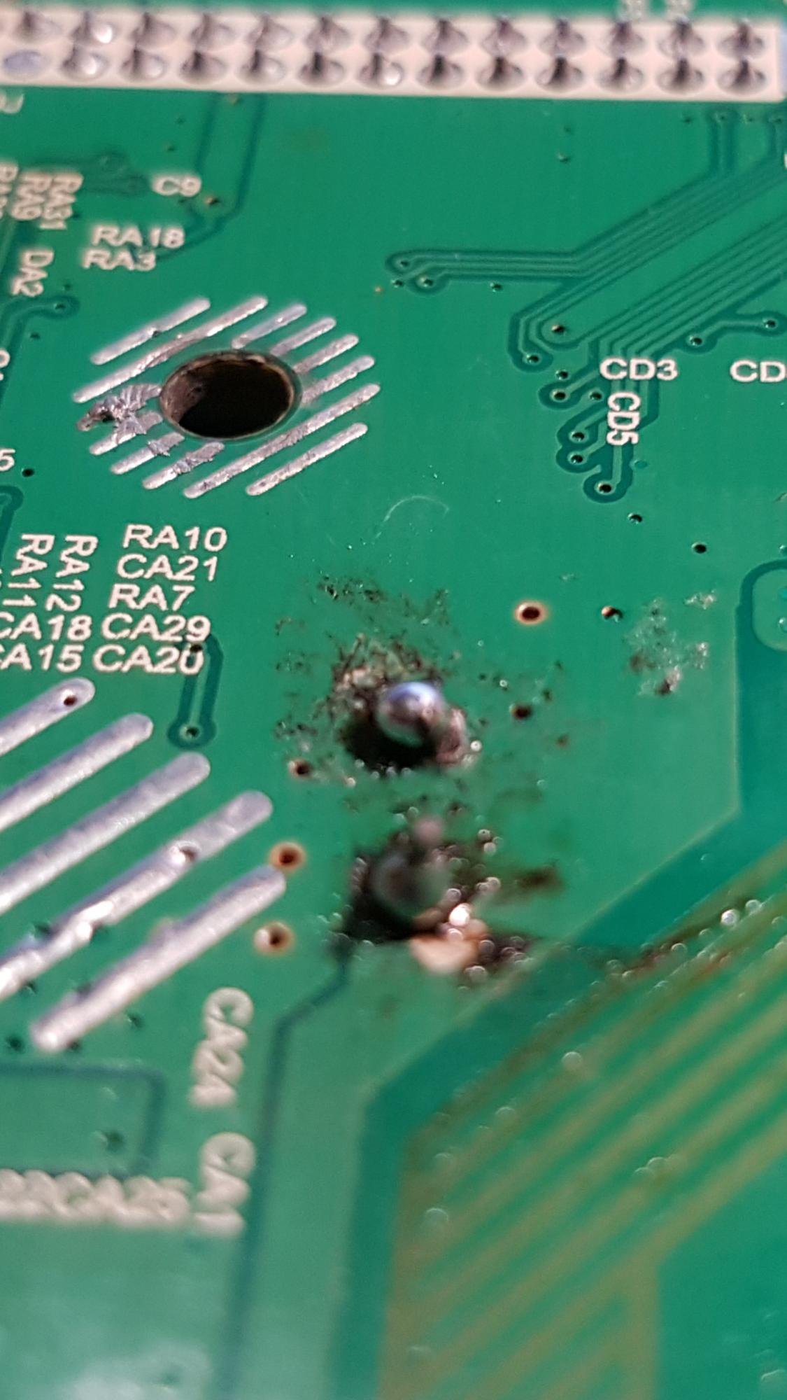

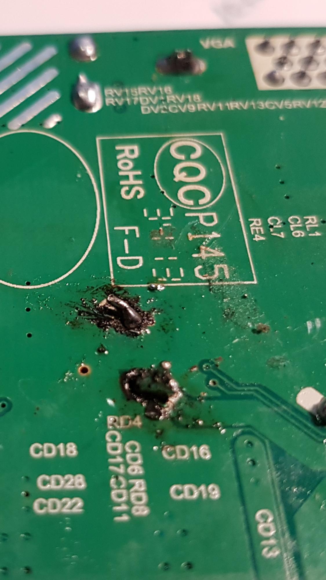

                      I believe the problem was the 2 capacitors, i changed them and tv started working more regularly but looks like i de-soldered the old caps without the right tools so now the little spots where i am to solder the capacitor's legs are damaged it seems, i attached 2 pictures of the crappy soldering job i did, was wondering if there was a way to repair

                            if u want help take pic of entire tv set and also try to salvage that board u did soldiering on. What iron you using? Try to clean it with rubbing alcohol and see how bad the damage is. doesn't look so good.
                            Being a multilayered mainboard it is crucial delicate soldiering. Need to see up close and clean to see how bad the pads &Thru-hole is. Since you don't have led anymore it is clear there is either no connection or it is grounded out by nearby tracks and or pads. it will need to be reworked. Make sure you use flux and a good iron with clean tin tipped iron very important, and if you're transferring too much heat to pads you will destroy pads, so no long lingering time on contact let it cool little bit.
