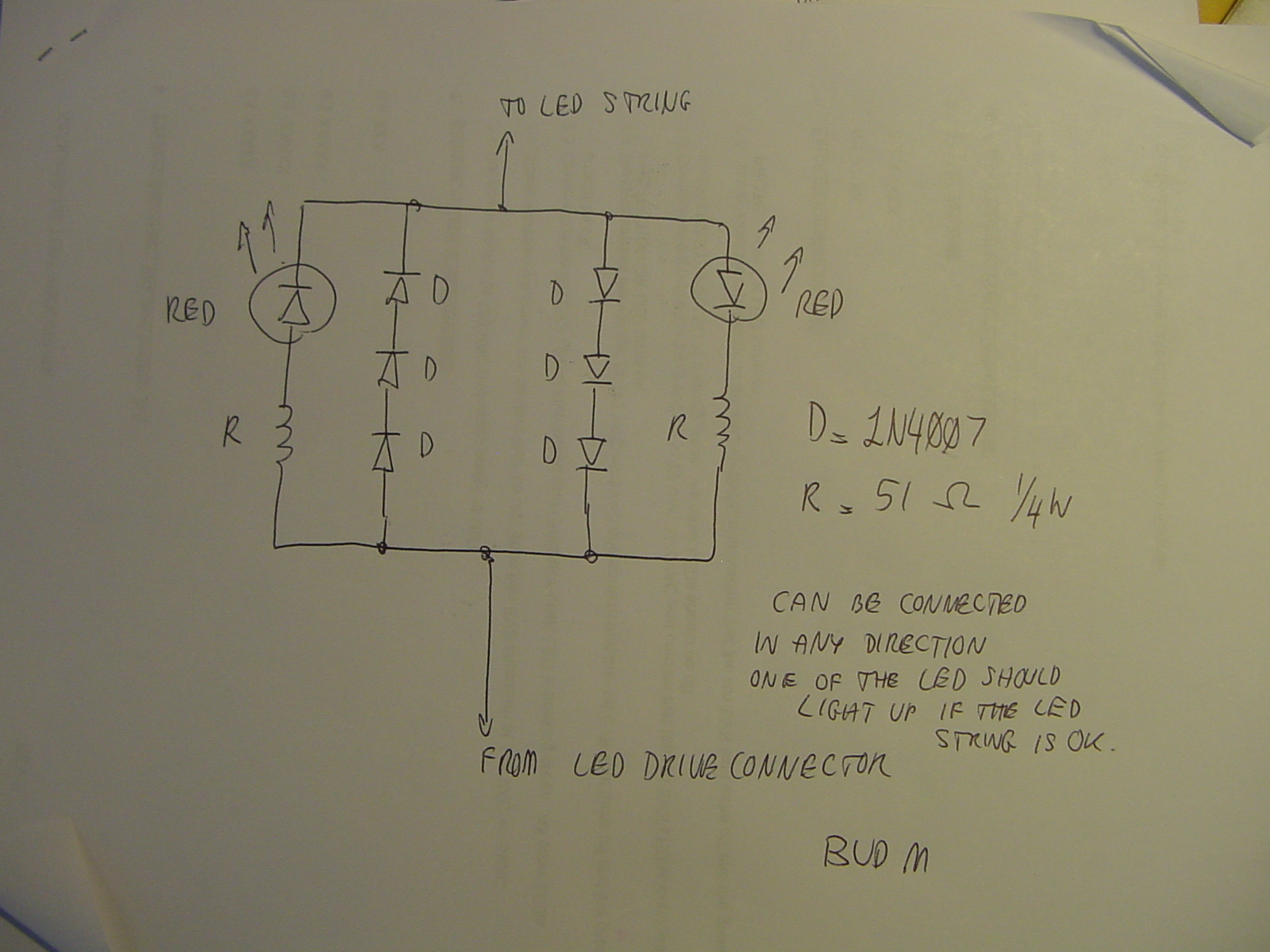

      OK, are you asking how to test individual LED mounted on the circuit board that form LED string?
      You can use 3V battery with 100 Ohms resistor to limit the current for testing individual LED.
      Or you already verify that the LED driver circuits are OK but the LED still does not light up?
      Test LED string current draw using DCA.
      https://www.badcaps.net/forum/showpo...4&postcount=95
      Or used indicator:
      https://www.badcaps.net/forum/showpo...&postcount=107

            Re: how to test lcd led backlight?
            Originally posted by pnv
            Yes, something like an adjustable voltage source with constant current
            That will be correct if all the LED int he string are good, but if one goes open circuit then nothing will happen, but you need to know how many LEDs are in the string to determine what the power supply voltage needs to be, some string you will need more than 100VDC, Vf of each LED is between 3~3.6V.

              Please, if not asking too much to draw scheme Led string indicator to find out which string is dead.
                  I think it is exciting and dynamic method of insertion of an indicator Lord budm
                      See picture, the diodes will get hot so do not run it too long.
                        Now that is a neat testing device I hafta make! Thanks budm!
                          Bud M don't laugh at me, but I was hoping to unplug all the LED strings and plug them into a separate power source that would eliminate any feed back circuit from turning the the LED driver chip off.
                            If you want to use external constant current power source to drive the LED string then the strings are no longer connected to the LED driver board) so there is need to have any power to the TV at all since you are just testing LEDs.
                            The harder part is to figure out how the strings are connected together and which wire is the Anode and which wire is the Cathode if the panel is not open up to see the LED string, or you can trace the connector on the driver board to see how it is done.
