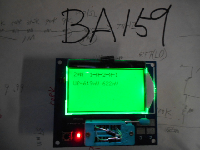

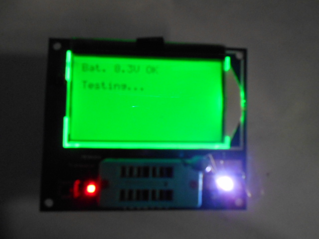

      One of the LEDs I take out from the board ,now.and,I take picture again.
      When I push test button, the LED will blink twice then the the readout....
      For BUD M... yes , but you drew the diagram mean SHORT ( in DC, but they probably use 1k-100k hz to test the pin because they can test ESR...

        The meter is doing its auto test routine by reversing the probes automatically just like when you do the test manually with your meter by testing the DUT in both direction.
        Just hook up two diodes as shown in my picture then you will understand what your meter is doing.
        Just use your DMM to do the diode test both direction on that LED to see what it shows on the DMM also.

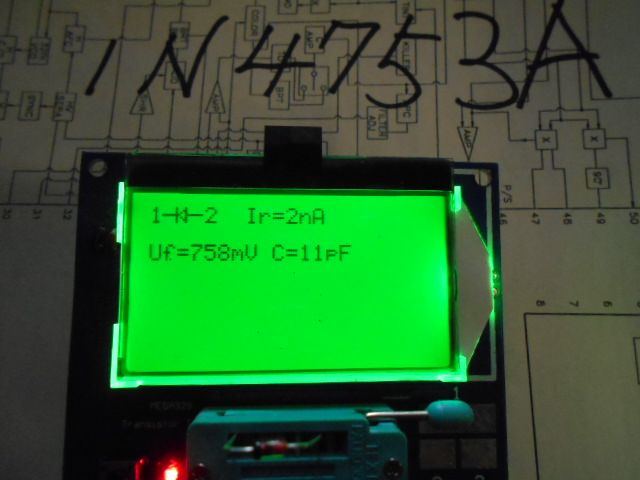

          Re: how to test lcd led backlight?
          No, exactly happen like #70 readout, I will use scope and see what happen.....tomorrow...

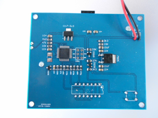

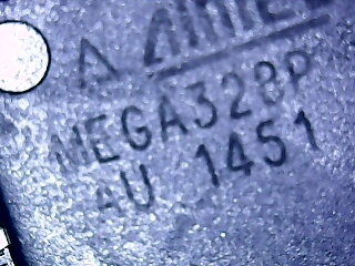

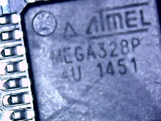

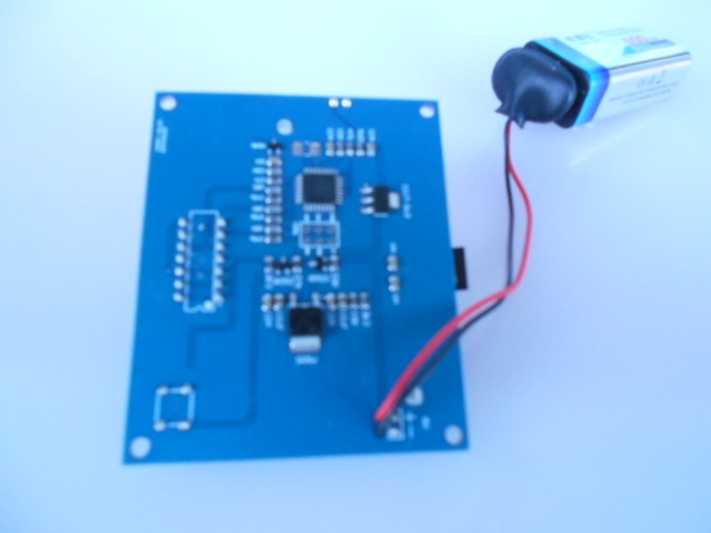

          By the way.....the tester is GM328 transistor tester \ ESR meter \ LCR meter \ Cymometer( Frequency counter)\ square wave generator......... most is the firmware (software) do the job....
            "but you drew the diagram mean SHORT" No, it is not. I think you need to read up on electronics theory! iF YOU THINK ANTI-PARALLEL connection of the two diode is short, you have more learning to do.
            As I said, hook two diode as shown and use the DMM to read the Vf in both directions and see what you get.
            The 100KHz is used for ESR AC resistance testing, nothing to do with Vf testing.
            When you test the junction of the semi, does your DMM in diode mode put out 100KHz for testing the Vf, of course not.
            " most is the firmware (software) do the job...." Like I said it does the test routine by applying the reversing testing automatically, what do you think do when you test semiconductor, you test it in both directions.
            How do you think it knows when you stick a bipolar transistor and it can tell you if it is PNP or NPN? How do you do with your DMM to figure out if it is PNP or NPN?
            BTW, you DID NOt hook up the diodes as shown and tested in pin 2 and pin 3 of the tester as I suggested, right? or Tested them with your DMM.

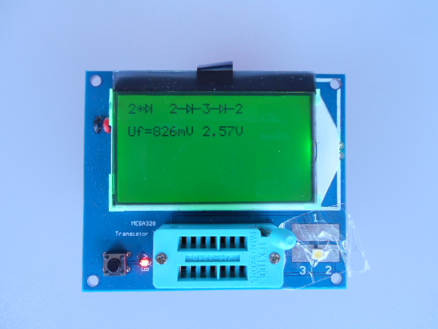

              Sorry... Sorry..my bad ..... I did not pay attention to that , I was here and there take pictures, take out SD card and put it back.........yes , when you use multimeter is 0.5V and the other side is 0.5V .....but when I put on DC power supply ,they shorted right away...Yes I really don't know why......although I did graduate Electronic Engineering(double E).
              Oh.....Oh...I remember, it is reverse voltage readout.....too late...... I lose.....I really think..... how could you ask so simple question to me ... teacher gap a handful scr triac pnp npn ujt mosfet ...I am the only guy pass the test. By use mouth-water I can distinguish EBC each legs ............my apology...........

                "but when I put on DC power supply there shorted right away..." Why would you do that? The diode will try to maintain Vf of about 0.6V, so what do you expect.
                May I ask, did you take any basic electronics theory class?
                Read this what the anti-parallel diode connection can be used for and how it is used.

                  BudM are you sure the 0.826 Volt reading of the device is coming from a protection diode built into the device or is this protection diode built into the LED? Understand BudM the higher the level of theory the bigger the mistakes. Like sometimes not being able to see the forest through the trees.
                        He can easily simulating the reading by connecting the Diode and the LED as shown or verify that with his DMM.
                        That Diode is probably for reverse polarity protection since the most White LED can only handle about 5V reverse voltage, with the Diode in place, the max reverse Voltage across the LED will be only about 0.80V
                        If you read this in post 73 about how he thinks it has TWO LEDs to produce Whit lights "The tester thinks have two diodes inside. And it is, first Blue diode(2.61V) and dropping with yellow diode (at 819mV) will give the almost white color.......But they put the symbol wrong side.....Don't worry, someone wrote that program not perfect, yet"
                        How can the so call Yellow diode which shows on the meter as anti parallel connection will ever light up when you only apply the current flow in one direction (DC). So I have been trying to explain that it only has ONE LED!

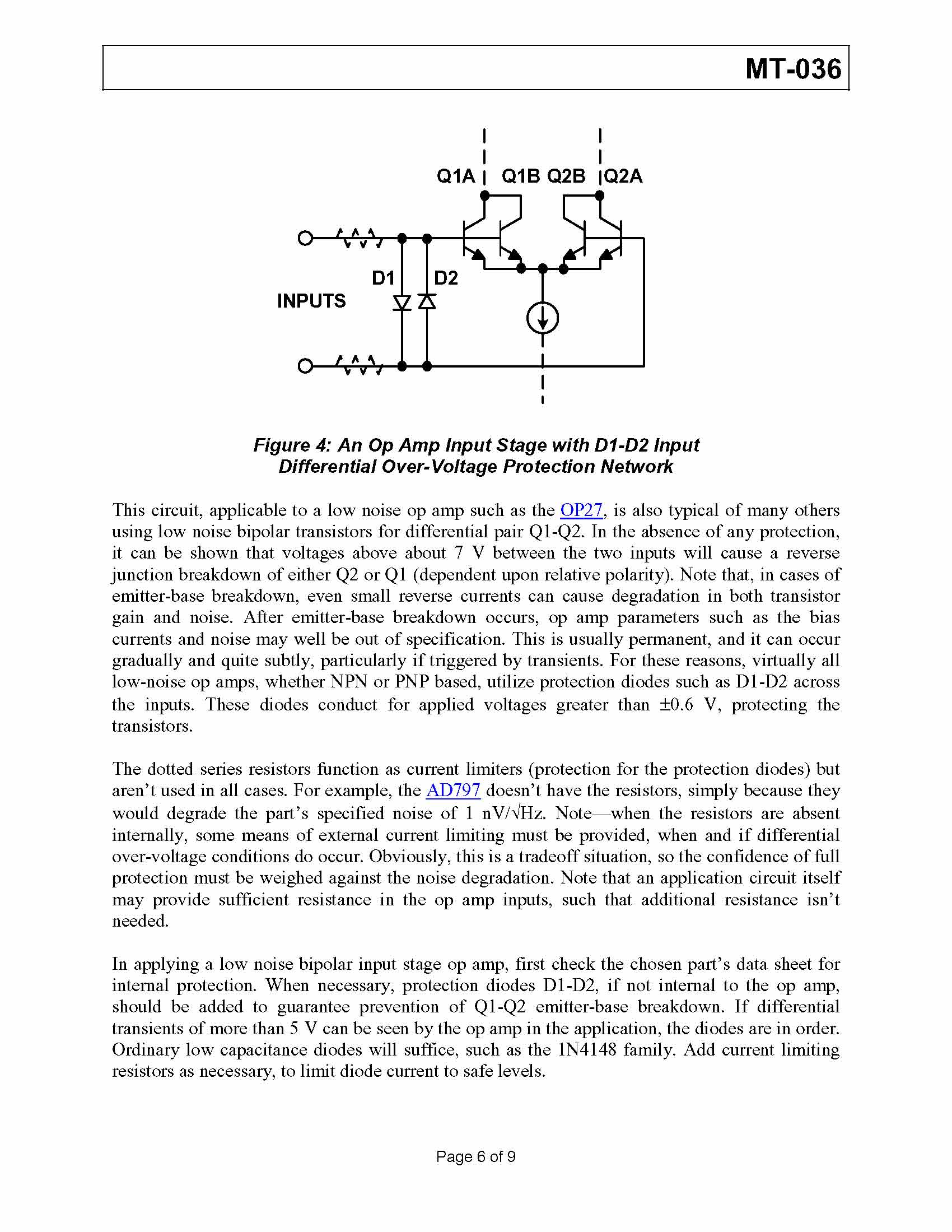

                              It is a matter of applying what you want the circuit to do. Diode is not made just for rectification only, it can be used as switch also for example.
                              "yes, when you use multimeter is 0.5V and the other side is 0.5V " So how does it display on your tester?
                              How about another application, Voltage protection for OP-AMP?
                              https://cdn.badcaps-static.com/pdfs/...921fff160b.pdf

                                      he's using this:
                                      http://www.mikrocontroller.net/artic...ansistortester
                                      you may want to put it in a translator.
                                      they are being mass produed in china for about $20 on ebay.
