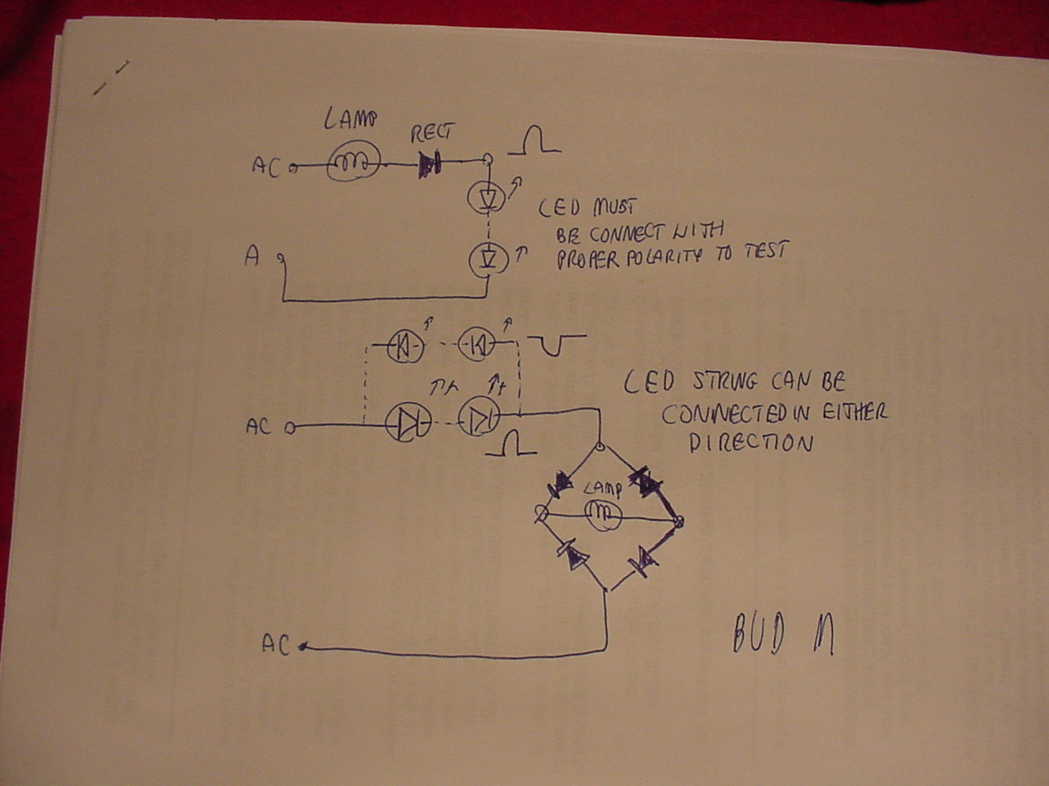

          Use the bridge so you do not have to worry about the polarity of the LED string. Hopefully the Hot resistance will stay high when switch over occurs. The lamp can be replaced with active device to allow to set the current, the problem will be that the Vf of total string will have to be met.

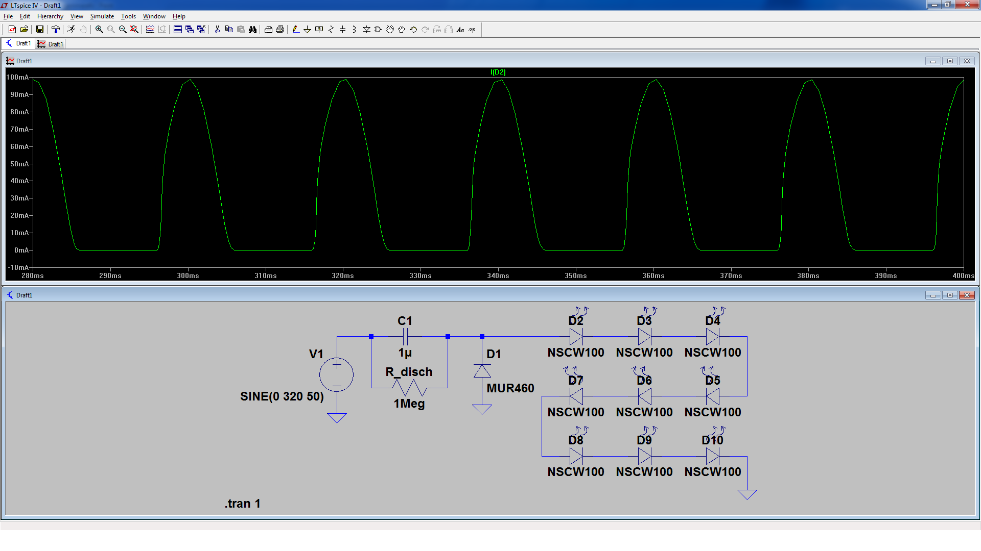

              Another alternative; Use a capacitive dropper. 1uF in series with AC mains is about 100mApk at 230V and 50mApk at 115V. Common to find 1~2.2uF X-caps on power supplies. D1 rectifies the output via charge pump action (can be 1N4007 or so.)
              This is the same circuit as used in most cheap made-in-china LED ballasts. It has the advantage of being lossless, in theory. So the capacitor only needs to be rated for a peak voltage, rather than power rating. R_disch will discharge X-cap after mains is disconnected.

                  For up to 80V across the LEDs the current will remain roughly constant, within about 20%. This is sufficient for a simple test of a backlight array.
                  Of course, I'm not a massive fan of using this circuit without an isolation transfomer, as it puts the LEDs at mains potential. Should someone attach, for example, a grounded scope probe to the set (it's easy enough to forget) they could end up with a live-to-earth arc inside the panel. This could cause an electric shock, or damage the diffusers, LEDs, LCD panel. So, it will be best to use this circuit only with an isolation transformer.

                    That is not my design to use direct power line to drive the LED, it ALASTAIR ideas I suggested to add the bridge so the polarity of LED string will not matter, by the way, there is no filter cap so the there will no 340VDC, it will be on average DC since the LED will only light up half of the line frequency only. One thing I will not do is to use direct line operate to test the circuit without isolation or safety equipment in place.
                    I am still in the progress of making high voltage constant current source.
                    "It's kinda of hard to Calculate and to find the right capacitors for different LED screen applications. " that is the key since you do not know how many LEDs are in the string so the current source has to have high enough Voltage to provide enough total Vf of the string, but if you have to open the panel to get to the string then you might as well just check each LED.
                    So you have LED backlights that you are not getting any lights so the purpose of trying to testing the LED string is to find out if the string is bad due to bad LED or bad connector or the LED driver is bad. Some board setup can have 8 wires going to the LED assembly so that is hard to find out which pair of wires go to the LED string, or the string may be connected in series/parallel setup, so using LED lamp tester is only small part of troubleshooting, figuring out how the LEDs are connected and driven are harder part.
                    I use DCA to find out if the string has open circuit or not after I am sure the power supply is OK.

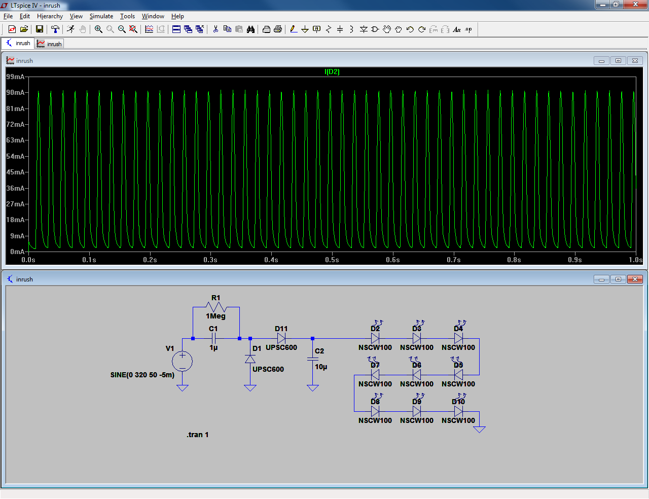

                      One thing is not mention using Cap for Vdrop is the Voltage on the load at the first half of the cycle when power is first applied, the cap will be like a dead short (think of the power supply cap when you first apply the voltage to it, you will see current surge when power is first applied) for that first half of the cycle so you will need the clamp at the output.
                            That is a good point, at zero crossing, the circuit has no inrush but at all other conditions it does. To avoid this you can attach an output rectifier, although this may be increasing the complexity too far; C2 is a 10uF/400V electrolytic.

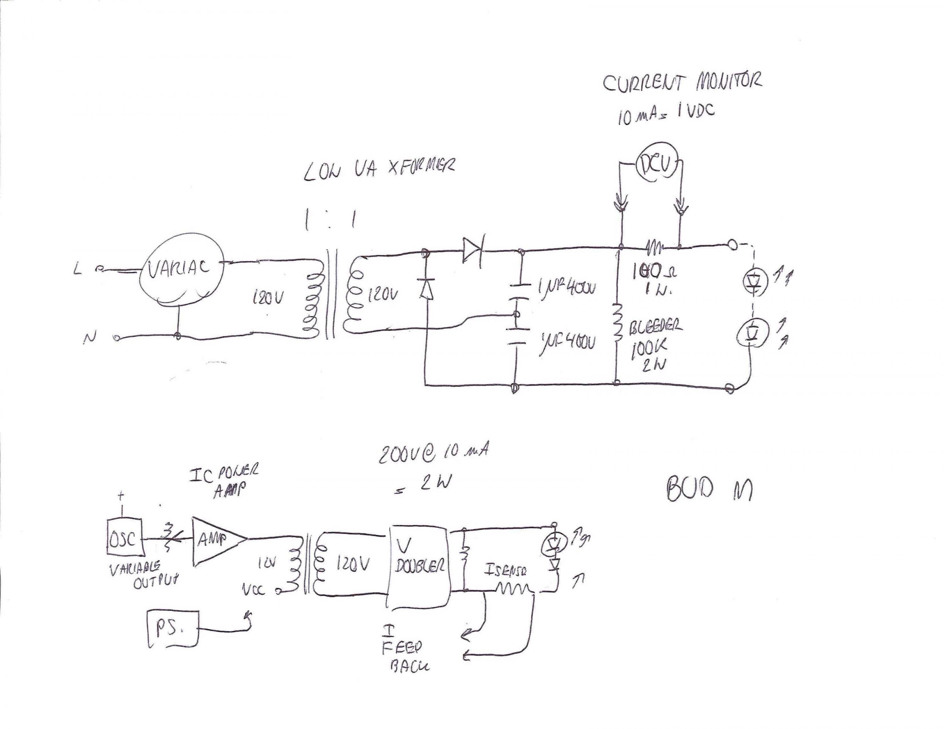

                                That is what I am experimenting right now (two 120V:6V), the output (120VAC) is fed into voltage doubler circuit, I am using VARIAC right now but will build the drive circuit to drive the 6V winding with feedback to maintain current.
                                I use this method for other project to get high voltage with low current.

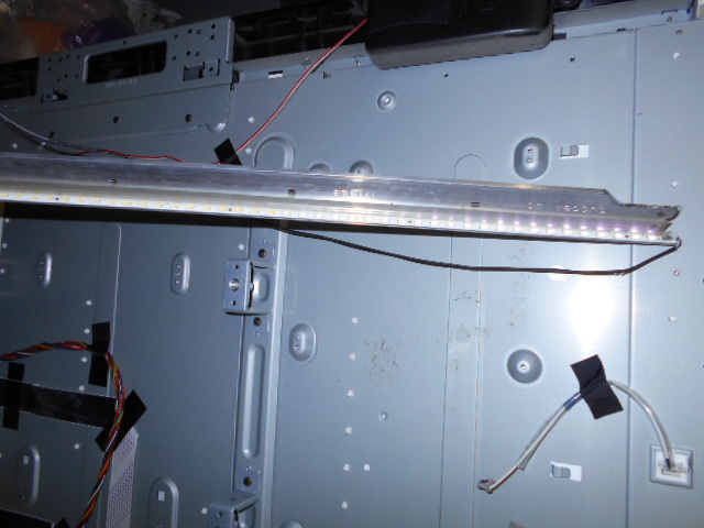

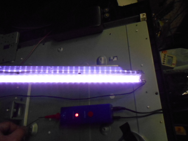

                                  I try to use CCFL Tester ....to light up the LED section (This is the super thin LED screen , 2 stripes from top and bottom reflect to all screen with thin pieces of prism plastic. don't know the name, yet.(from 60' thin LED TV)).
                                  one LED section has 60 LEDs (top and buttom total 4 sections , one section 3.3v x 60= 181.8v DC votage needs be to light up the LEDs . I use my 50v dc lab power supply cant do anything!)
                                  But, strangely , just by connect the black ground wire to the LED strip , I accidentally touch the on button..... so the CCFL tester is turn on.......the LED strip light up a little bit .... show in (thumbnail 2) .....I just connect the ground wire .....and push the on button.... the LEDs light up faintly........ the it's a miracle happen right in my eyes....
                                  ......Working...... from my theoretically..... use HV and low current power source ( the low wattage is the key)... .....to drive unknown LEDs section
                                  controversially... I use Lab power supply... kill a lots of 10w leds by over power them!

                                    #37
                                    Re: how to test lcd led backlight?
                                    Well--It would blow up!
                                    CCFL's commonly use several Thousand Volts to Strike, and applying several thousand volts to a string of silicon diodes rated for only a few hundred at most will have the obvious result!
                                    DOH!!

                                        #39
                                        This is what I am experimenting with. The switch can be added for using Voltage Doubler mode or not. The OSC can be the 60Hz power line frequency.
                                          Finally, I have a adult's toy can play around..
                                          ....This is fun.....you can light up almost all LEDs , by maneuver the distance( not directly touch ....near then move away ).
                                          playing with ..... the arc.....the Plasma.......{ feel like.... Nikola Tesla play with his Tesla coils....}
                                          This might not to be the conclusion!
                                          The anwser to (how to test lcd led backlight?) is ........give it a.... [shock]......
