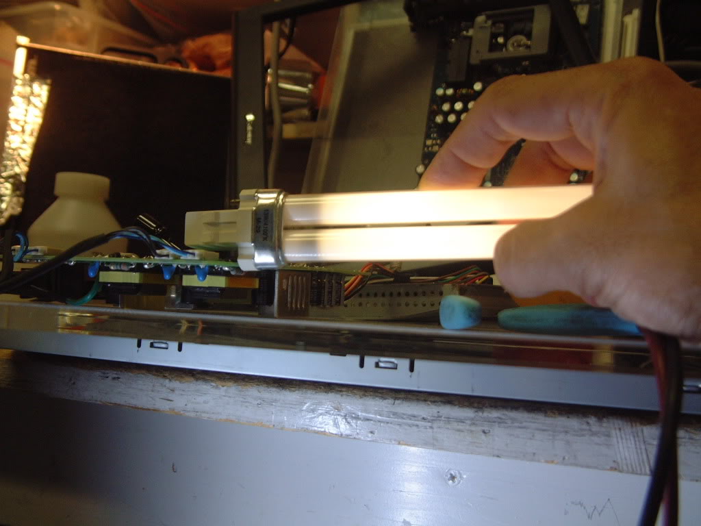

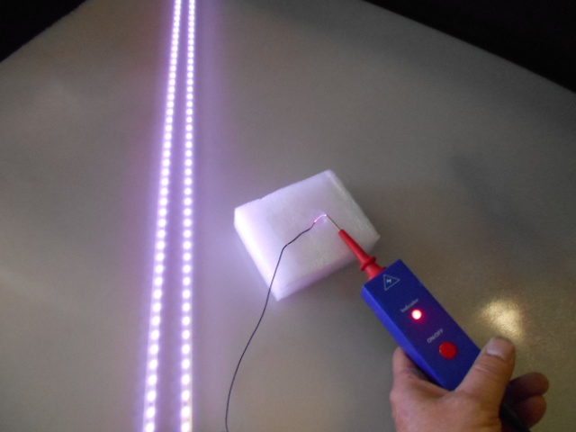

          ....... I see that the CCFL is lit up partly on one of the winding. The good winding will light the lamp brightly. I remove the transformer, and sure enough, it has burnt winding.
          So this is a new trick for finding bad inverter transformer.......
          ? Aurora ???
          Exactly happen to me!!! This phenomenon can apply to (the LEDs section) too..... Amazingly.... the power of the nature....probably we can use proton or electron to light up LEDs.....or tasla ball or maybe super NOVA comic rays.......or just close to {Electricman-2} will light up the LEDs ....I knew electric static will light up fluorescent light, when I was a teenage, I hided in the cloth closet, used wool sweater to rub the tube ...and it light up.......
          The vacuum - gas or mercury filled -CCFL-or neon light... I knew that already.
          But for a semiconductor- solid state- PN junction-LED, I just learn today.

              After 4 hours research.... still no answer.....
              1. Why did not burn out the LEDs which I think so too.
              2.When any side of LEDs section, connected to the CCFL tester's ground will light up.. ........ Is the leaking voltage from real ground ,enough to breakdown the PN junction 's Bias voltage 0.56v
              http://en.wikipedia.org/wiki/P%E2%80%93n_junction

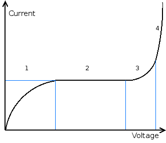

              there is a non-linear relation between voltage and current as shown in the picture ,In region 1, there are free ions that can be accelerated by the field and induce a current. These will be saturated after a certain voltage and give a constant current, region 2. Region 3 and 4 are caused by ion avalanche as explained by the Townsend discharge mechanism.
              Saturate certain voltage and give a constant current.... may be this is the answer..?......
              I can light up LEDs with + - or - + means non polarized....or is the CCFL tester actually is AC (I mean no HV dieodes inside , need to open the Tester to find out ???

                White LED Vf (Junction Voltage) is between 3~4V range. Vf range depends on the current, so the LED Vf chart spec.
                http://www.maximintegrated.com/en/ap...ex.mvp/id/3070
                Typical silicon diode has Vf of 0.6~0.7V

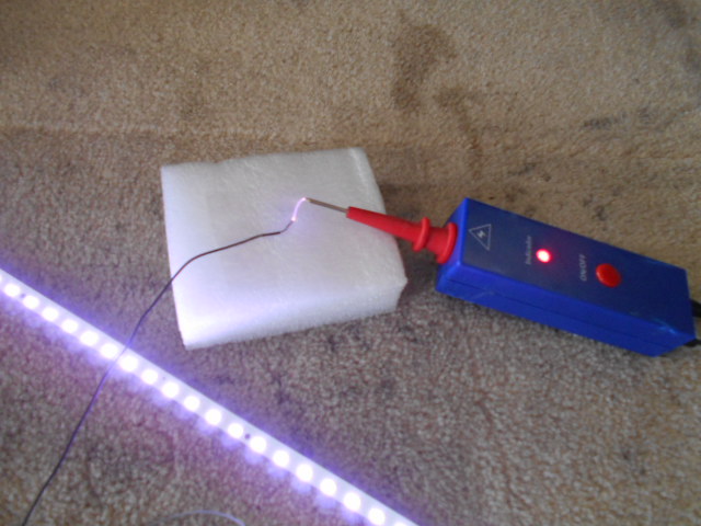

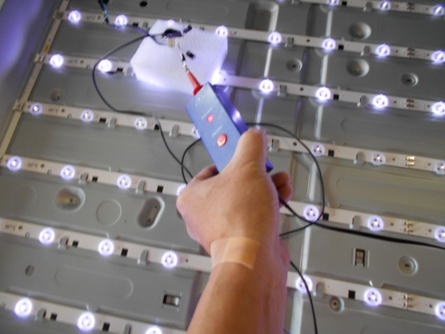

                Is that arcing in picture #2?
                Check the current draw.

                  Even I hammer down one LED
                  They still light the rest LEDs ....BY high voltage jumping?.....(in picture 2)
                  ......Should I hammer down more LEDS and give back the report.......

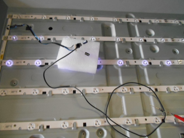

                  After about 20 mins
                  Oh ......YYY...E...SS....Yes......Yes....... (in picture 3)
                  .................We Are The Champions............................Queen..............
                  https://www.youtube.com/watch?v=04854XqcfCY
                  By the way, The CCFL tester exactly the same one in this video
                  https://www.youtube.com/watch?v=sfVkRiDGewA

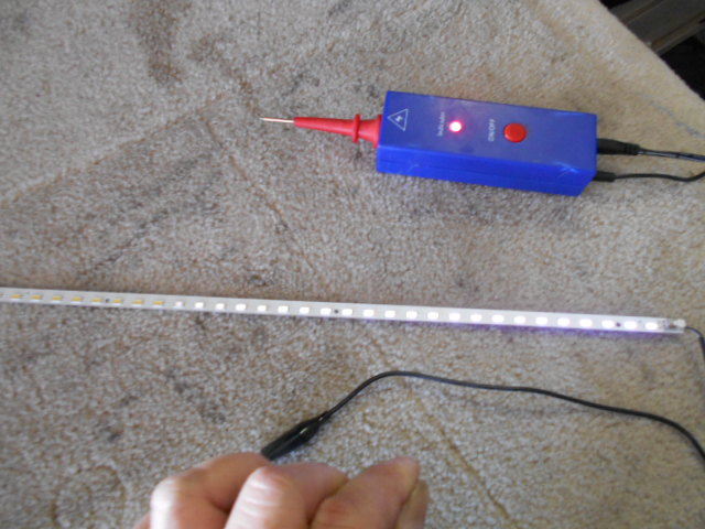

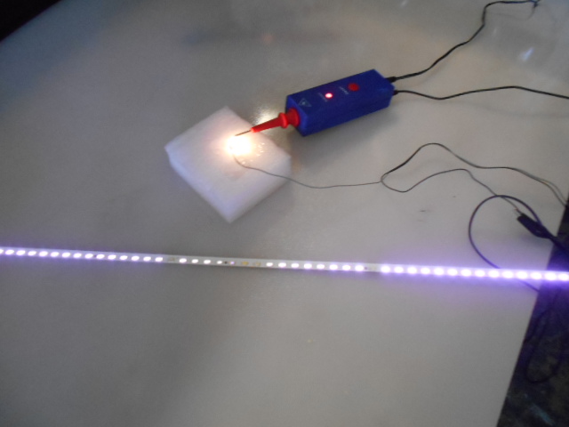

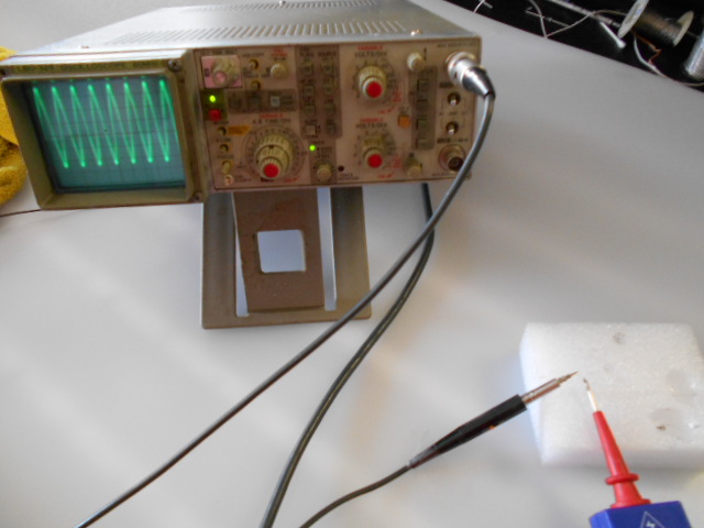

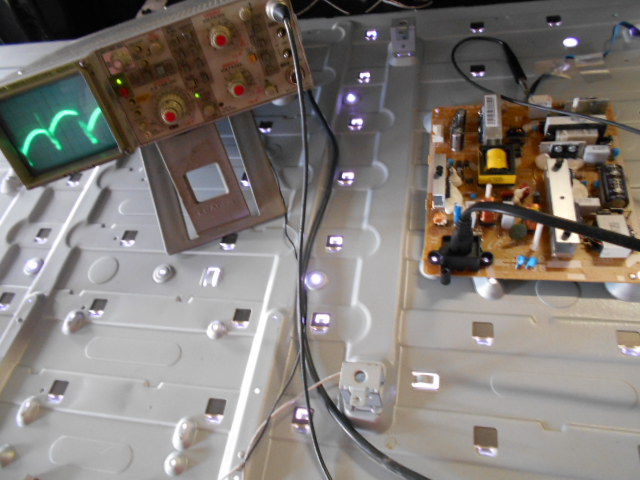

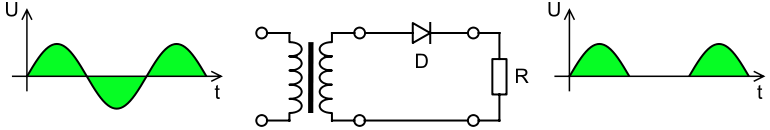

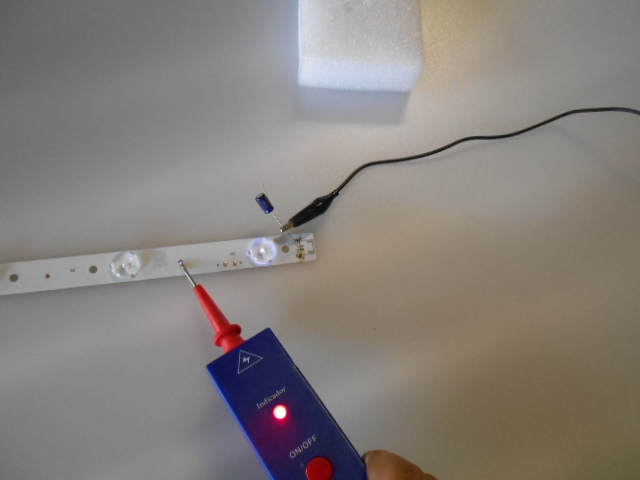

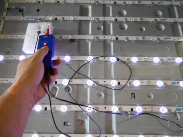

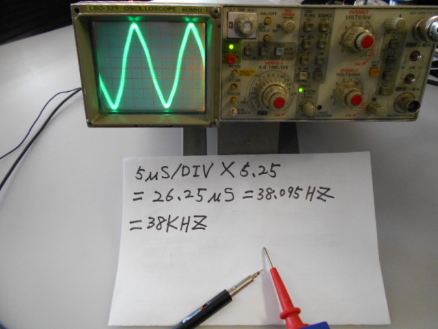

                    The LED Screen divided to two sections top 3 line LED strips, bottom 4 lineLED strips.
                    Picture 1 ...I test with original Samsung power supply @ 1us so it's about 2Mhz/374V

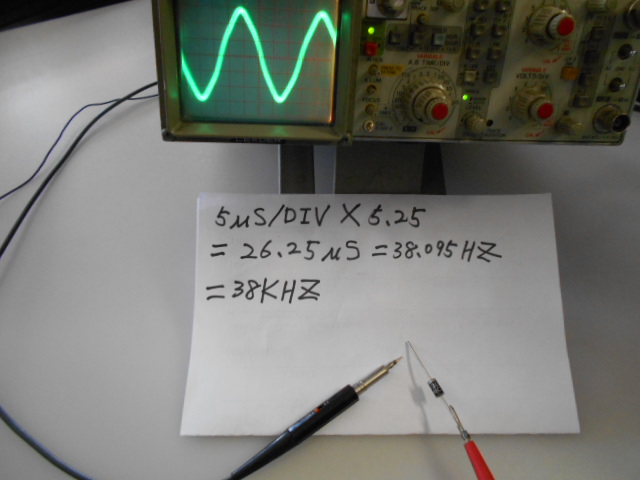

                    Picture 7 The CCFL tester @20us so 50khz- sine wave-voltage out of my scope's range.

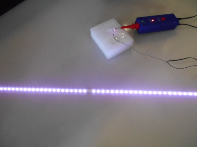

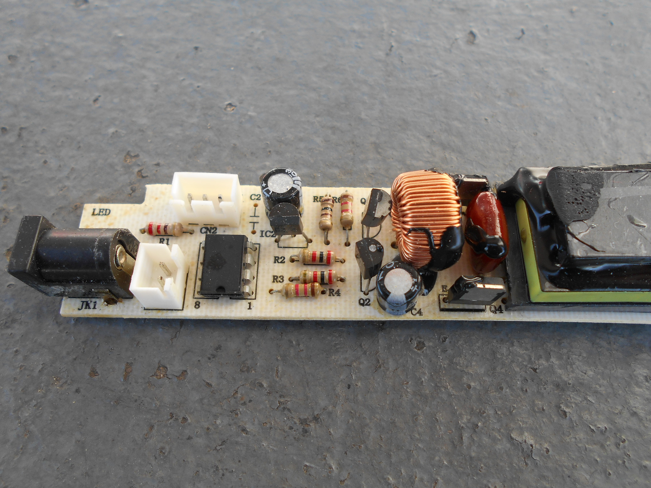

                    Picture 6 Just light up 1 LED.
                    Picture 3 only connected the CCFL tester black ground wire.
                    Picture 4 light up all the LED screen.
                    See in the picture, I cut my hand.......so I am in deep (The Moody Blues).....
                    ........to be continued.........

                      Pic 7: https://www.badcaps.net/forum/attach...1&d=1427996444
                      I am surprised that you did not damaged at least the input circuit of the scope.
                      I see that all the pictures show arcing from the tip of the CCFL tester to the LED connecting wire, is that right? And if you make the tip to have direct electrical contact to the wire, then did you damage the LEDs?
                        #51
                        Re: how to test lcd led backlight?
                        I did try directly contact just one LED still OK . In reality, the brightness isn't bright enough.
                        The CCFL tester should use 2A 12v but I use 1A 12v( next time put a 3A/30v power supply or (a LM317 adj-voltage IC) will be fun.
                        .......arcing from the tip of the CCFL tester to the LED connecting wire......
                        That's why did not burn ,I use (the distance of the gap) as the current limitation.

                          "use total current to estimate how many LEDs in one section" current draw will not tell you how LED or diode are in series, its the total Vf that can give estimate how may active device is connected in series.
                          You can easily prove that using 6 Diode in series with small current limiter resistor then measure the total Vf for the 6 diode, you should see around 3.6V, please notes that Vf varies with If.

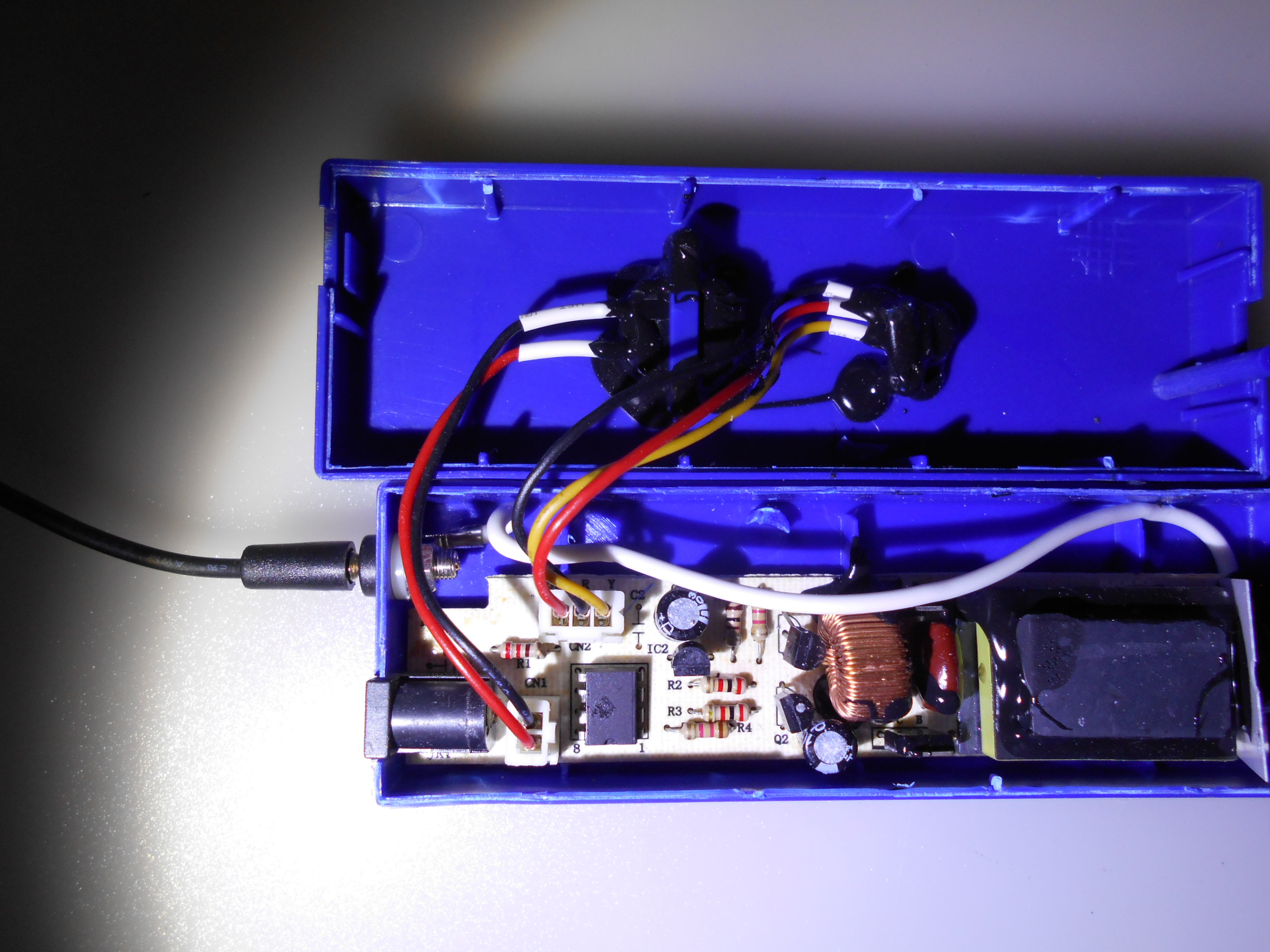

                                he already open .....Me too, will take picture ......tomorrow......
                                Sorry, should be 1/(1us*4)=250kHz stead of 1us*2= 2MHz oh... sorry, my bad!....

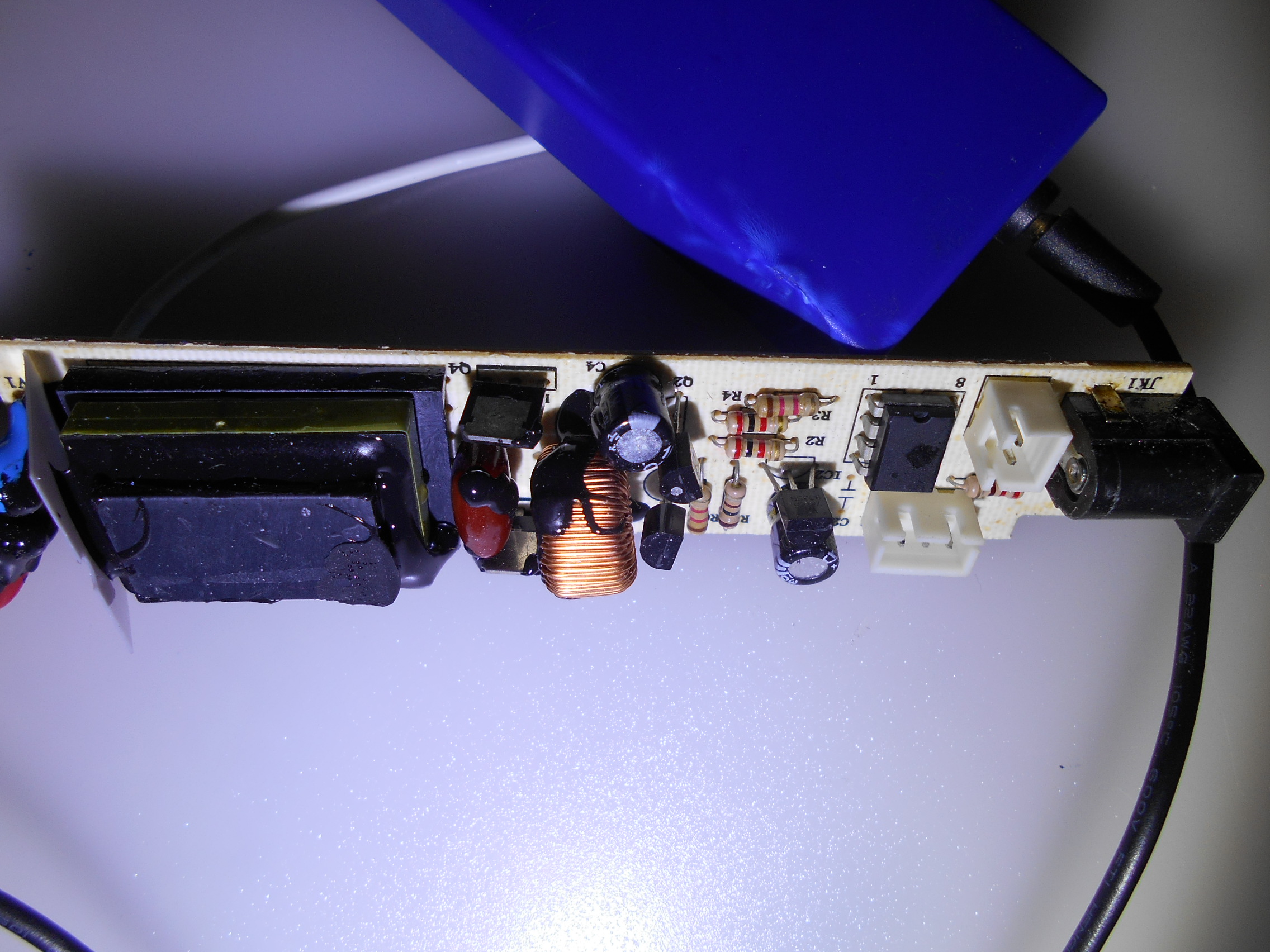

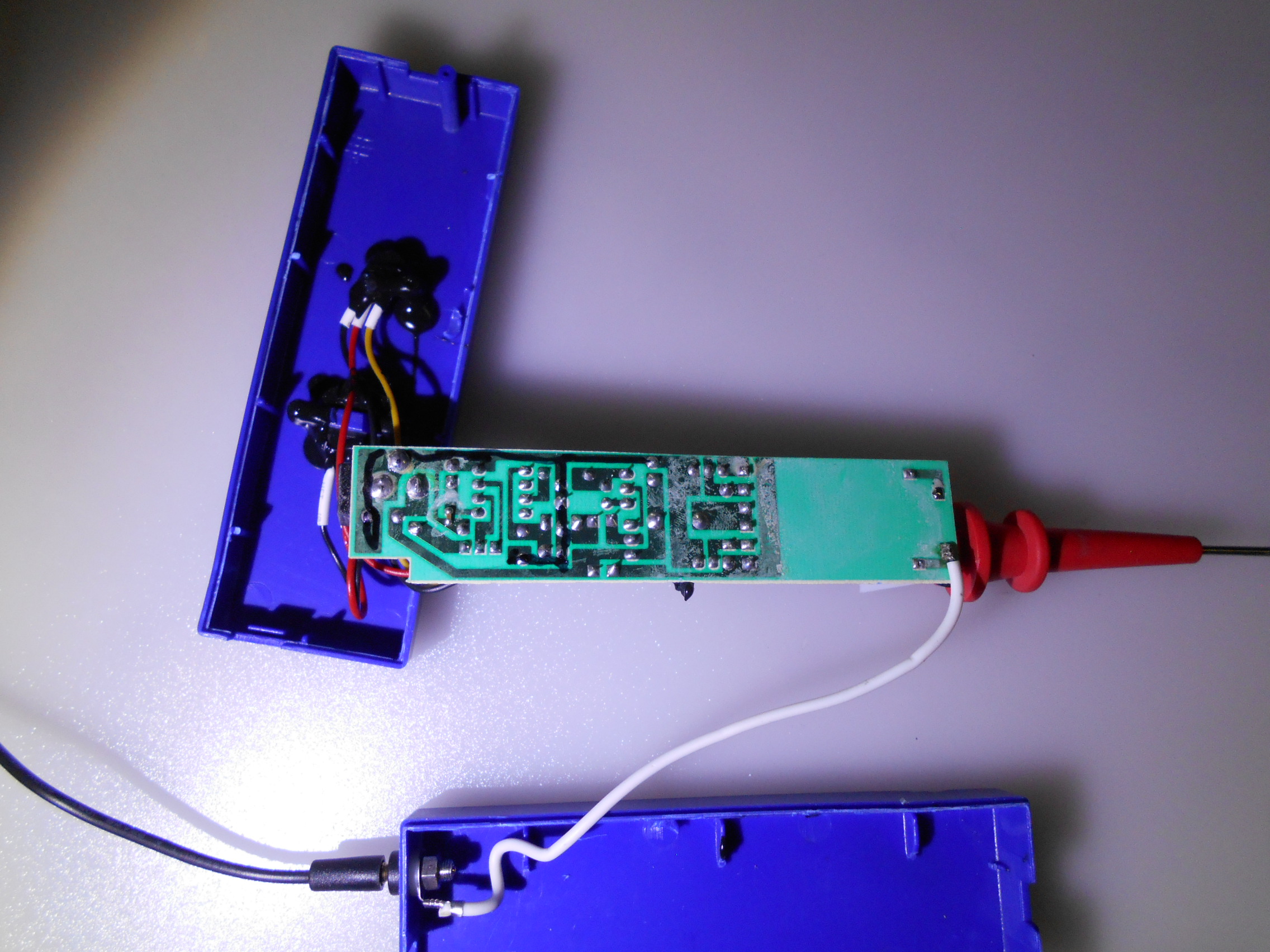

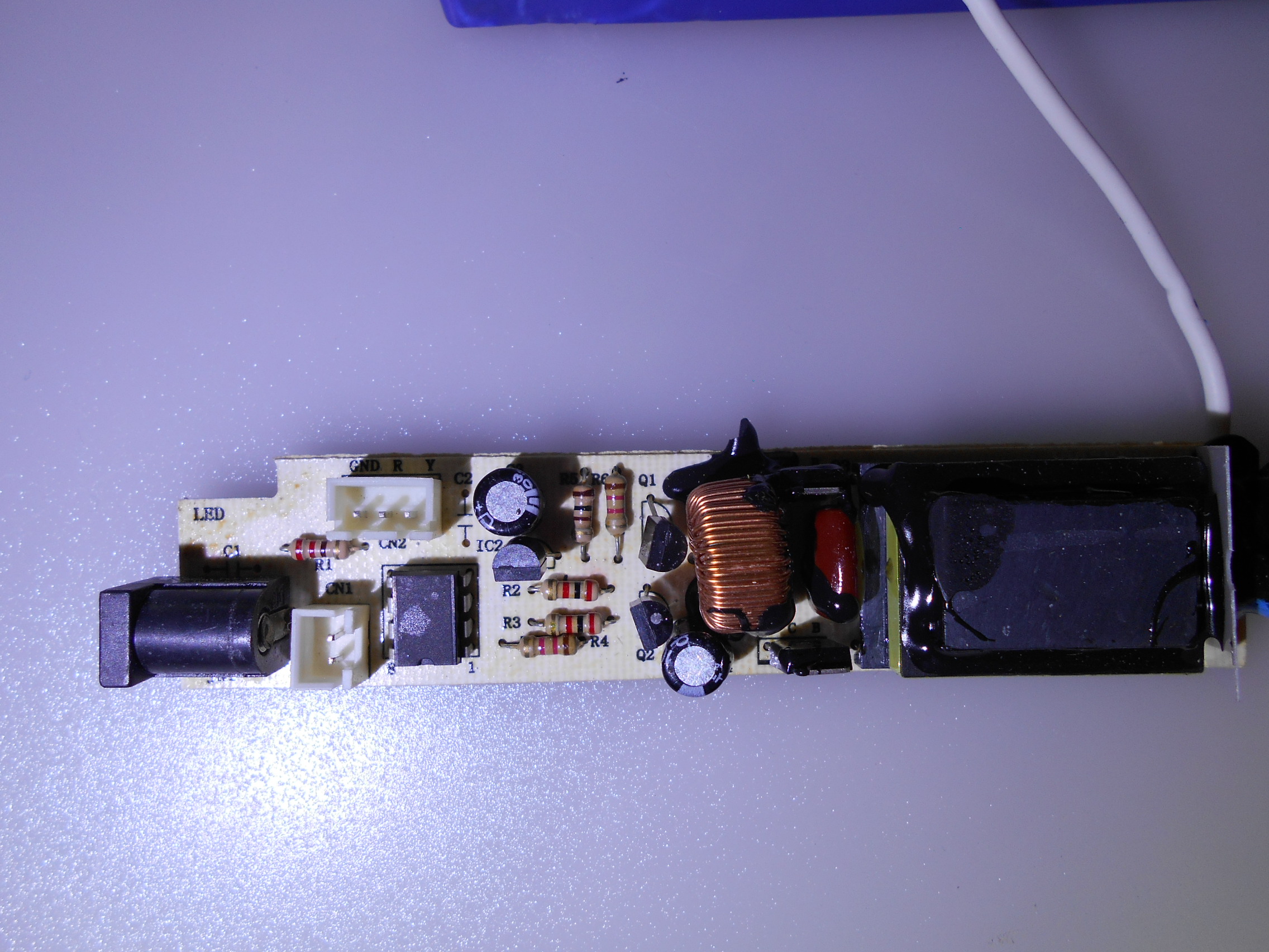

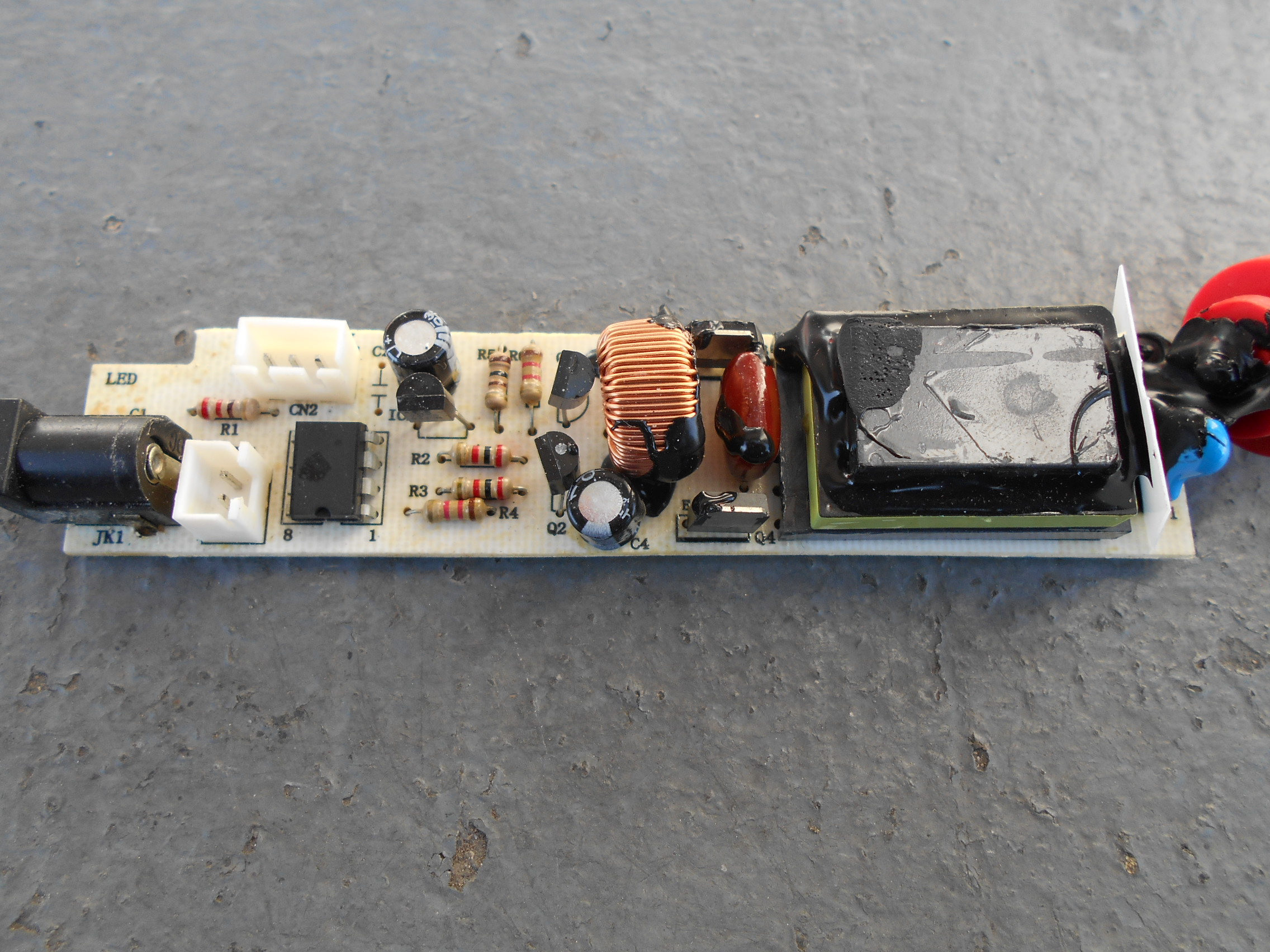

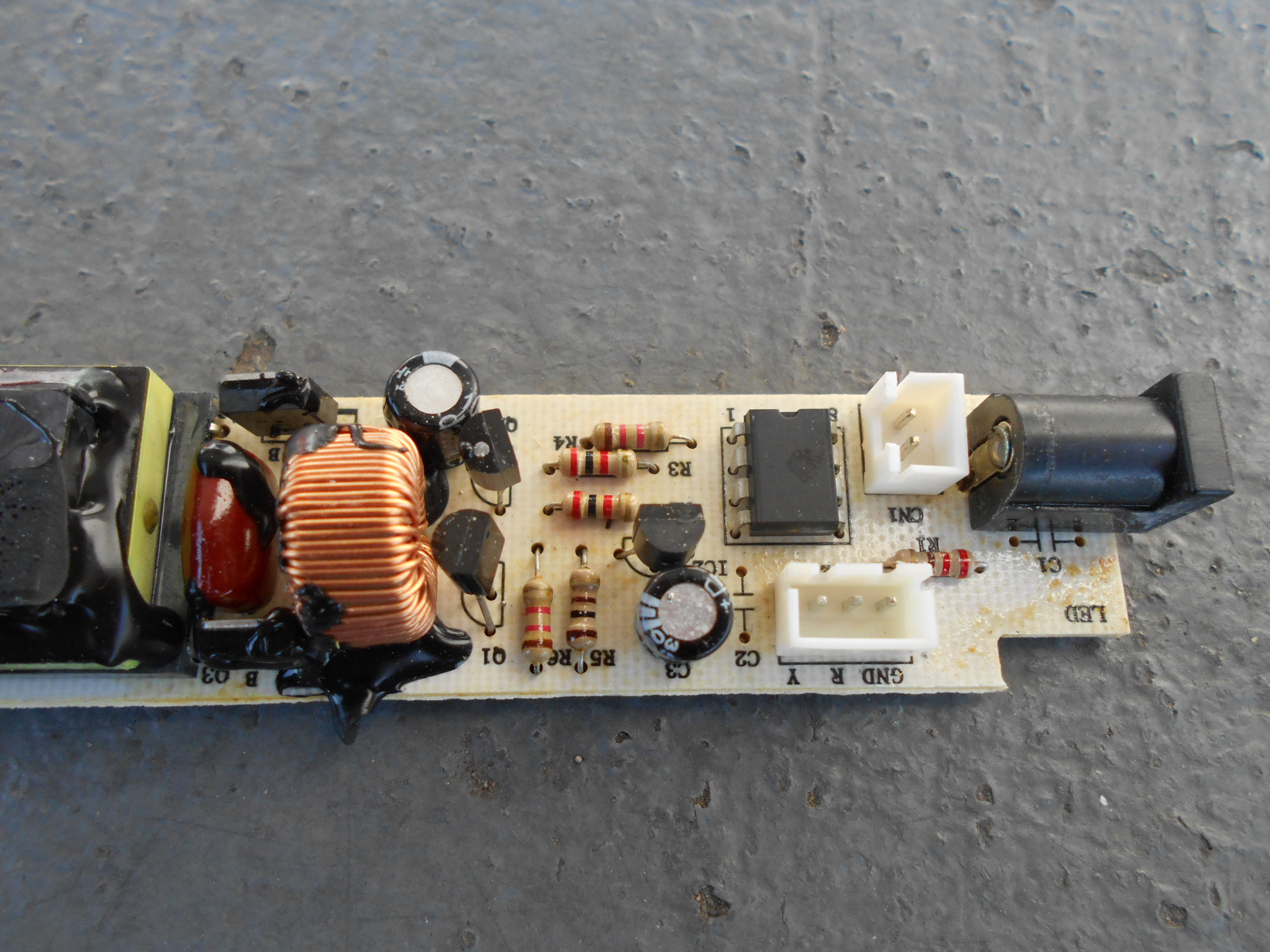

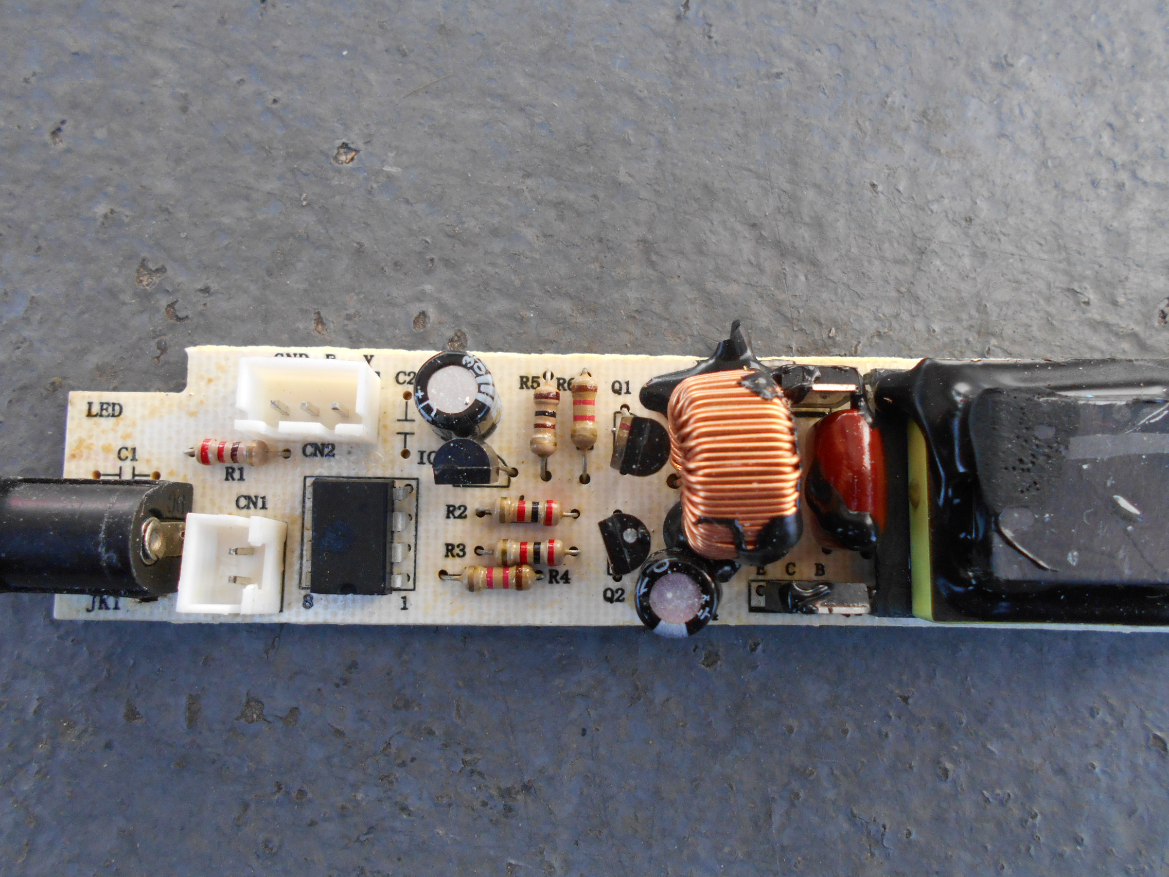

                                    The CCFL tester more accurate..... The oscillator is at about 38K HZ. (The same as most LCD TV CCFL ballast's frequency.)
                                    DIP 8 pins IC (they erased) can't see the No.
                                    .....(At the price range $12 ).......Maybe...LM555(As an oscillator +LM78L05 + four transistors (two pair NPN and PNP)to oscillate the HV transformer.
                                    Picture 2: put SF(super fast ) diode still sinewave... HELP! PLS.....
                                    Open the PICs take long time what else we can do....??....

                                      Diode will be predominantly capacitive with no output termination. Cannot measure like that.

                                          #60

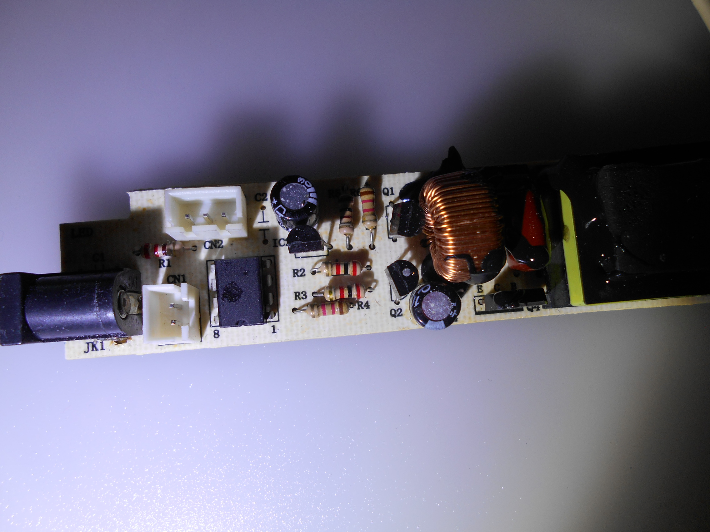

                                          Can I get just straight shot of the bottom side of the board?
                                          The transformer output drivers look to be just the Two power MOSFETs and the tunning cap (Brown Polyester film cap) Royer Osc circuit. Q1 (PNP?, P/N?) control the ON/OFF GATE bias Voltage (through R6, 1K2 Ohms?)
                                          The 8-pin IC is not 555 because pin 8 (VCC pin for 555) of that IC is connected to circuit GND (Negative GND).
                                          If you want to lower the HIGH Voltage output , then you need to lower the B+ to the output, the B+ id fed through that TOROID inductor.
