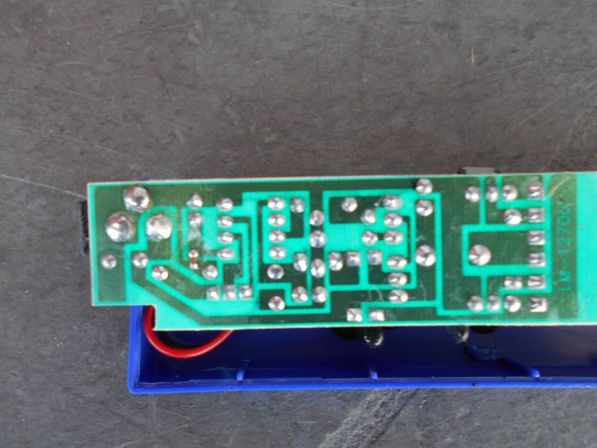

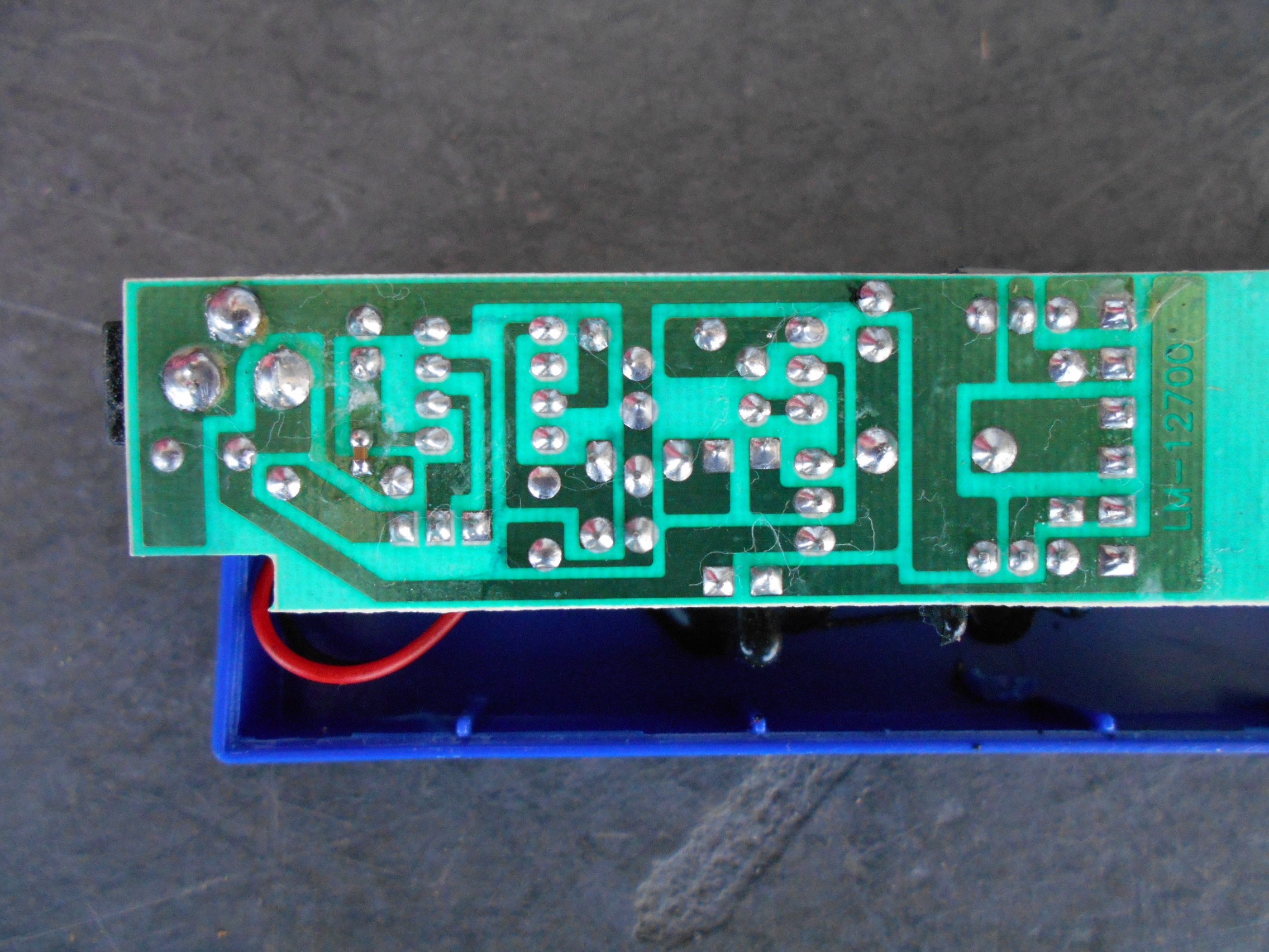

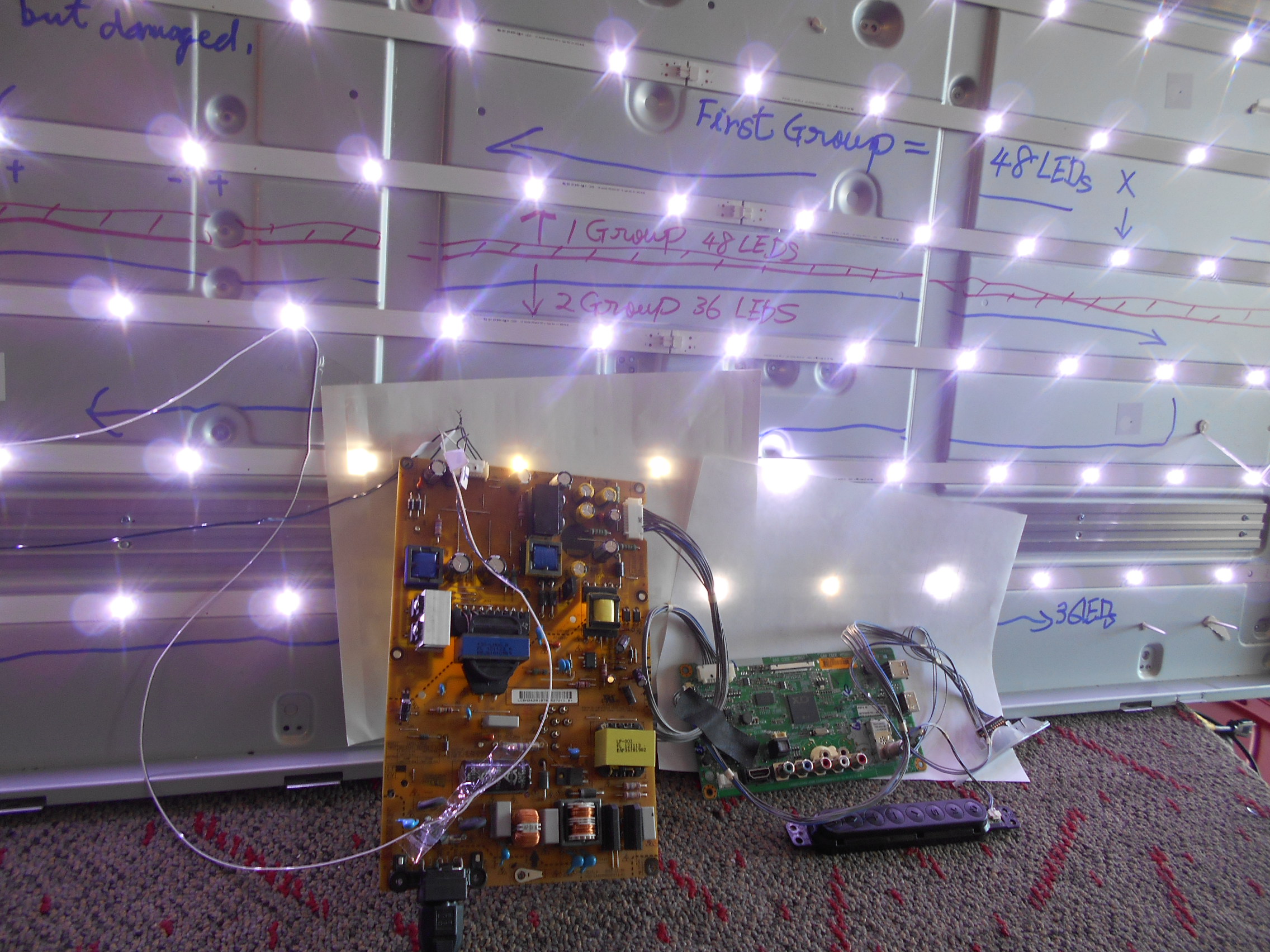

              Back to the {how to test lcd led backlight?} .....Are u ready!......OK ......let us ...R....R..O...C..K.........
              Background music....We gonna use this https://www.youtube.com/watch?v=09R8_2nJtjg

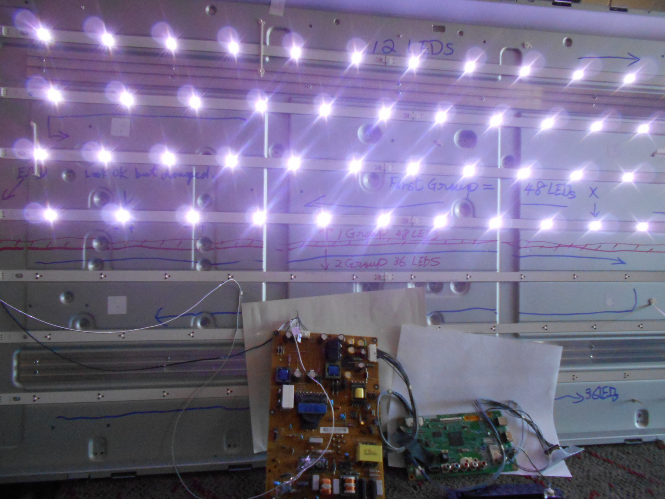

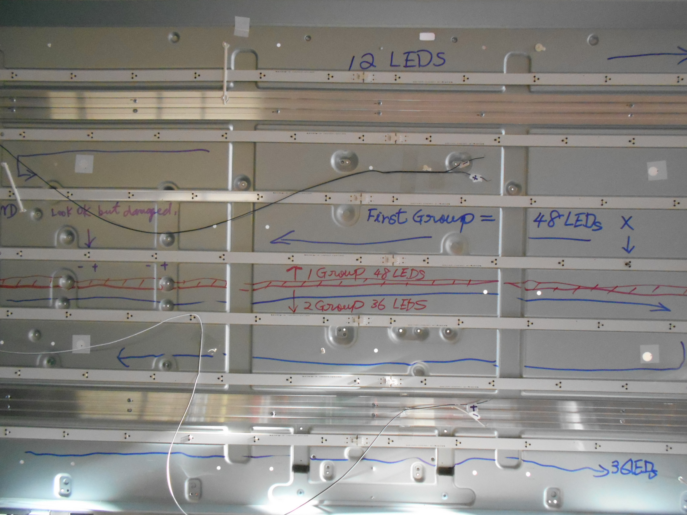

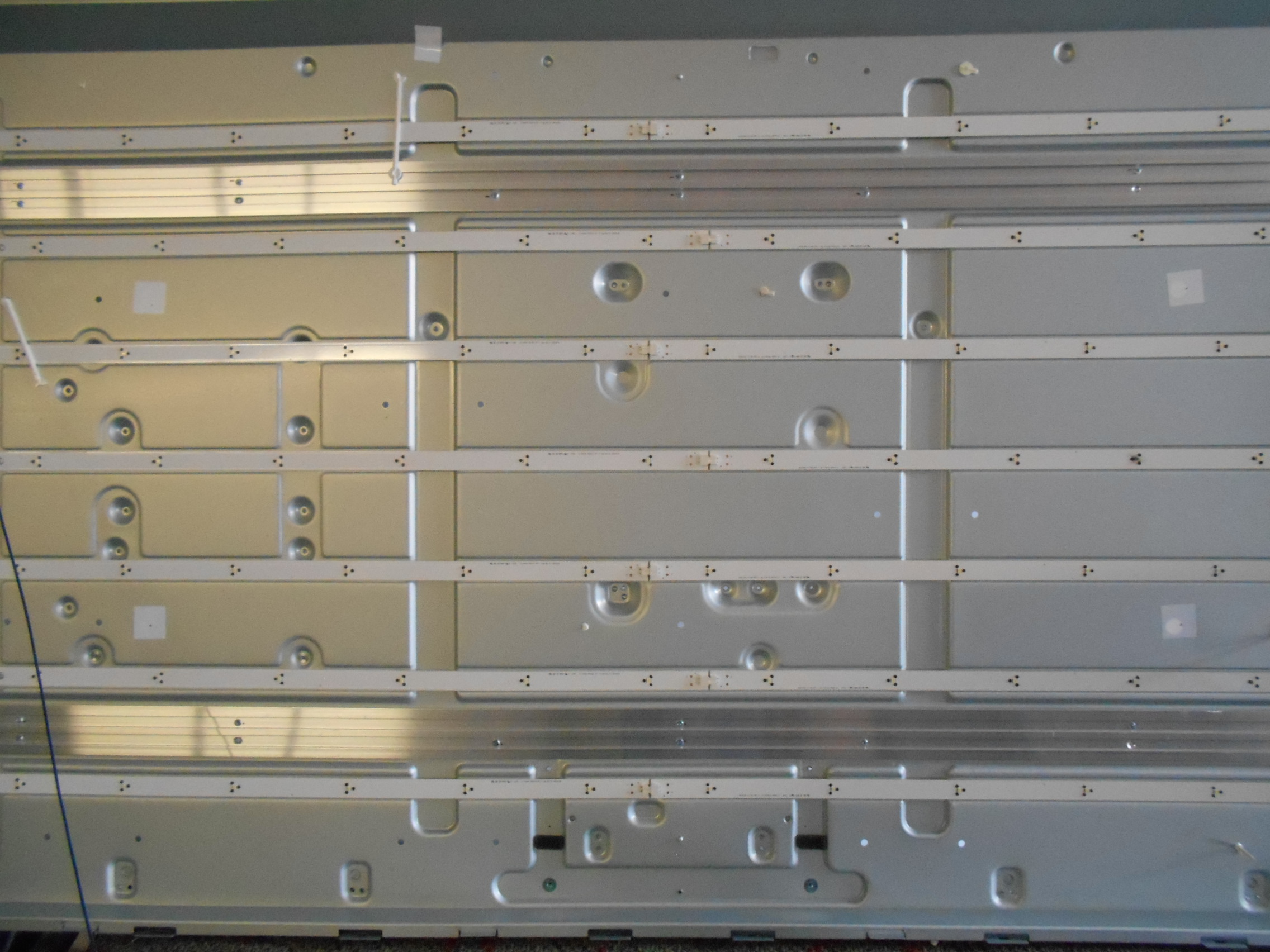

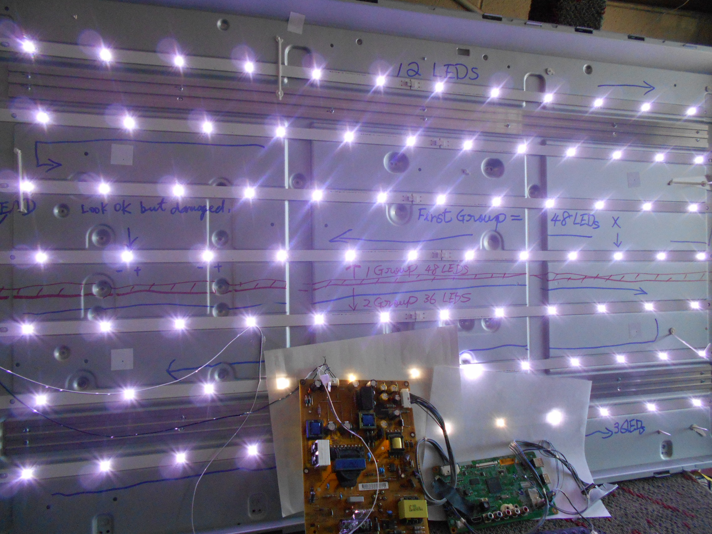

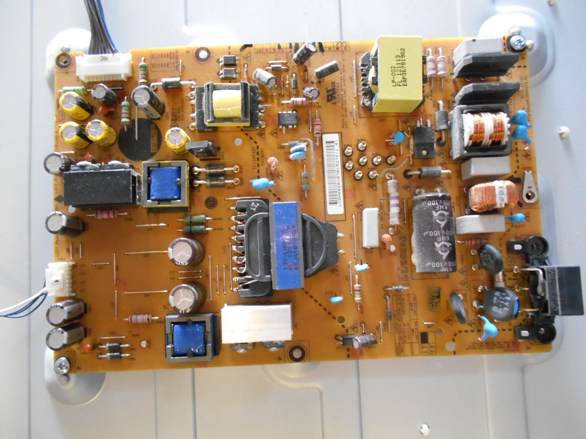

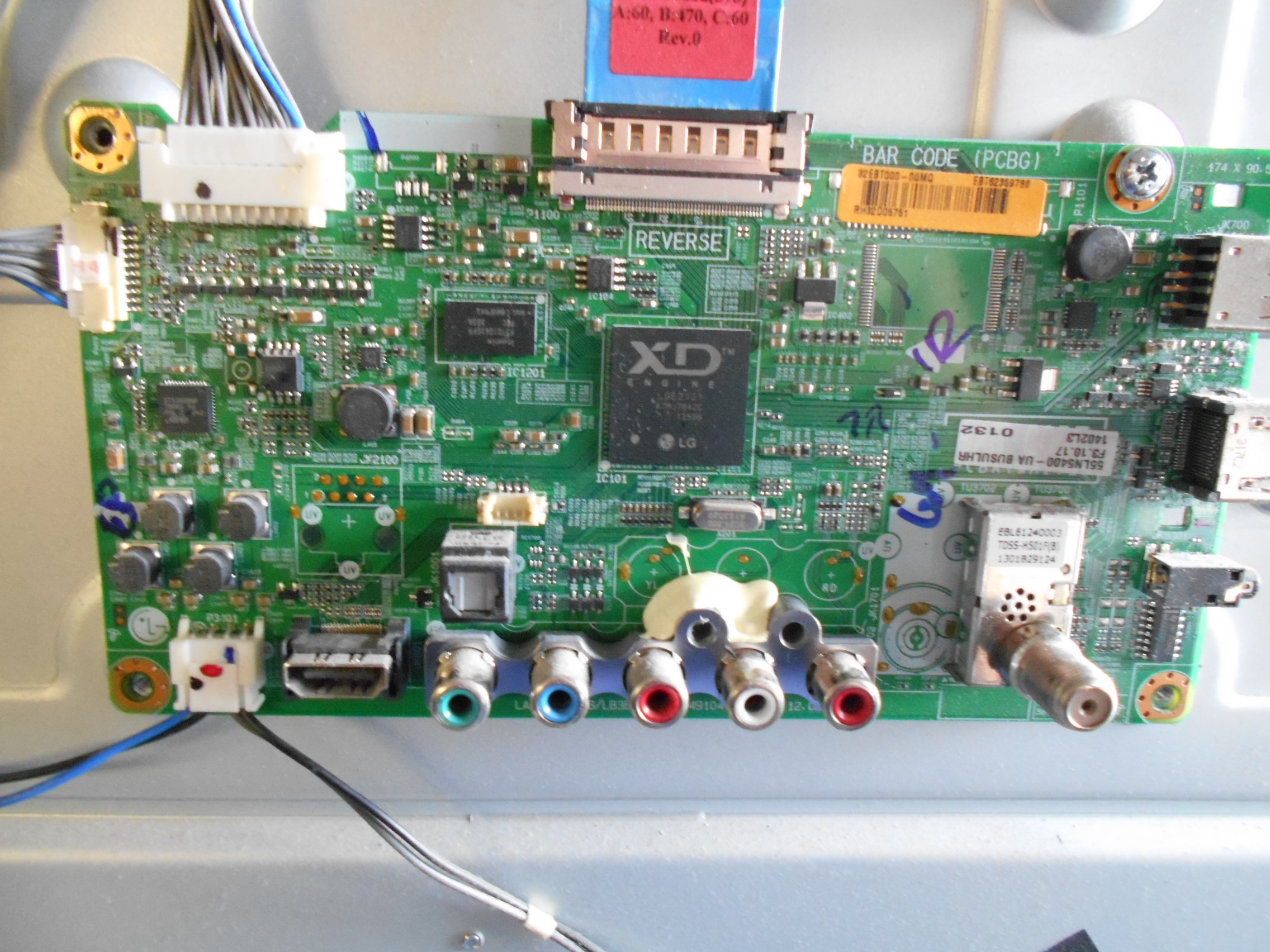

              LG 55LN5400-UA.... EAY62810701 (3PAGC10124A-R) Power Supply / LED Board.... EBT62359788 (EAX65049104(1.0)) Main Board.
              LED screen's connector marked (LED- LED+ LED+ LED-) is easy enough.
              first group (top) LEDs 48 LEDs ( back....led- , blue.......led+)
              second group (bottom) LEDs 36 LEDs ( white.......led- , bule.......led+) Total 84 LEDs
              Let's rock with this LG-55' LED-2/2013-screen has 4 wires connector -BD9483F drived-84 LEDs-divided by two groups -TV, which I found in dumpster.......
              https://cdn.badcaps-static.com/pdfs/...a8607cbf1a.pdf
              The LED-screen-light works good ! So I destroy it with 110AC . Now, one LED is blow out, another LED is no light but look OK. Screen won't come on anymore.........
              Simulation Case 1: TV come in with no backlit...Pic, sound is OK
              Solution: Open LED screen, use CCFL tester find two LEDs not work.
              ......After change two LEDs ......... YYYY...EE......S.............. it work.....
              Theoretically: One LED not work , the whole LED screen won't light up.........
              I forgot the most importance thing: Penal No:LG LN54M550060 V12

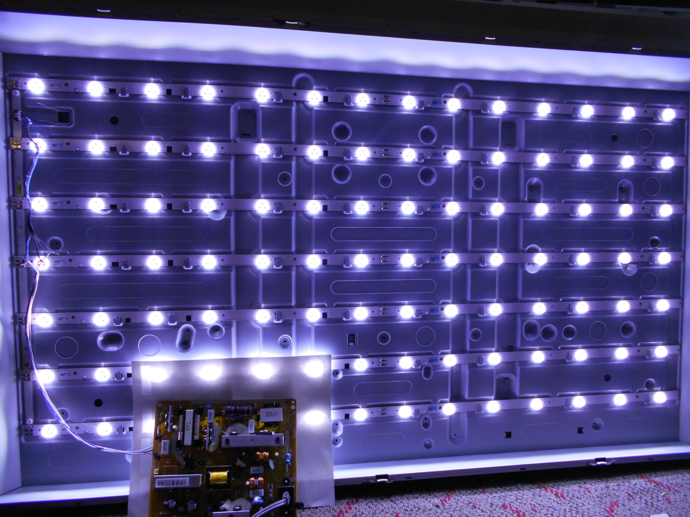

              Next project:
              Isn't that a beautiful one (picture last one,from Samsung 50' LED TV.).

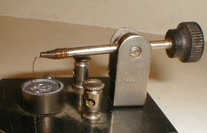

                  If someone ask me....Who invented the LED... I would say H. J. Round
                  If you say is Viking or Russian, I have no argument, too.
                  https://www.youtube.com/watch?t=20&v=8quZrUcRFlw
                  This is USA movie..... Sorry! …..They did forget …..H. J. Round....... they put him in Electroluminescence (EL) categories.................not fair...........But we will always remember his Cat's-whisker detector........
                  http://lighting.com/how-leds-are-made/
                  https://www.youtube.com/watch?v=CAgRF8TibJ0
                  This is my version of Cat's-whisker detector........with HV CCFL tester... tips put a piece of Kanthal wire.......go to my backyard..... ZAP.....the scorpion... see if any Fluorescent light come out.......If I win Nobel Prizes, I would donate to Badcaps.net......

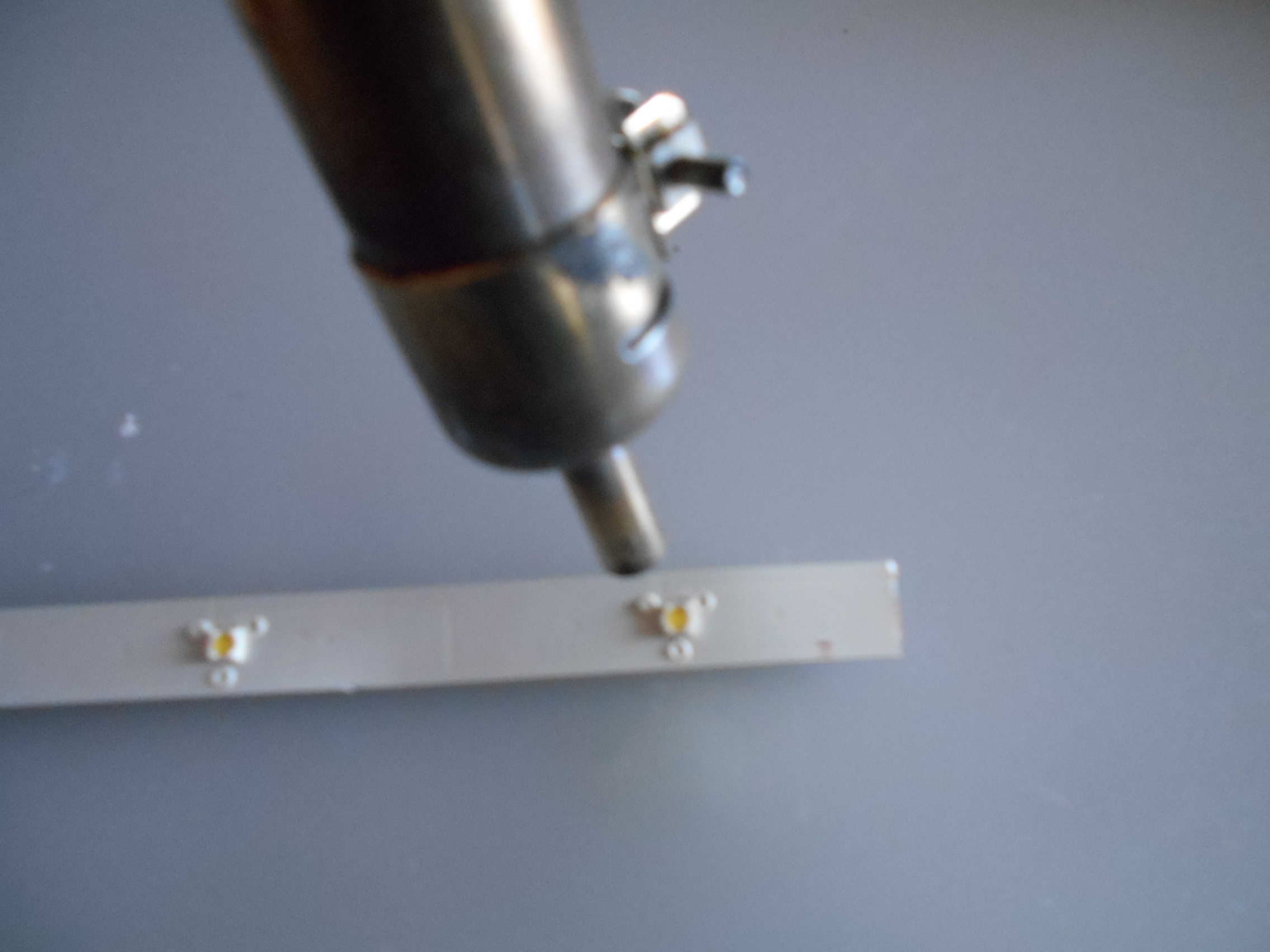

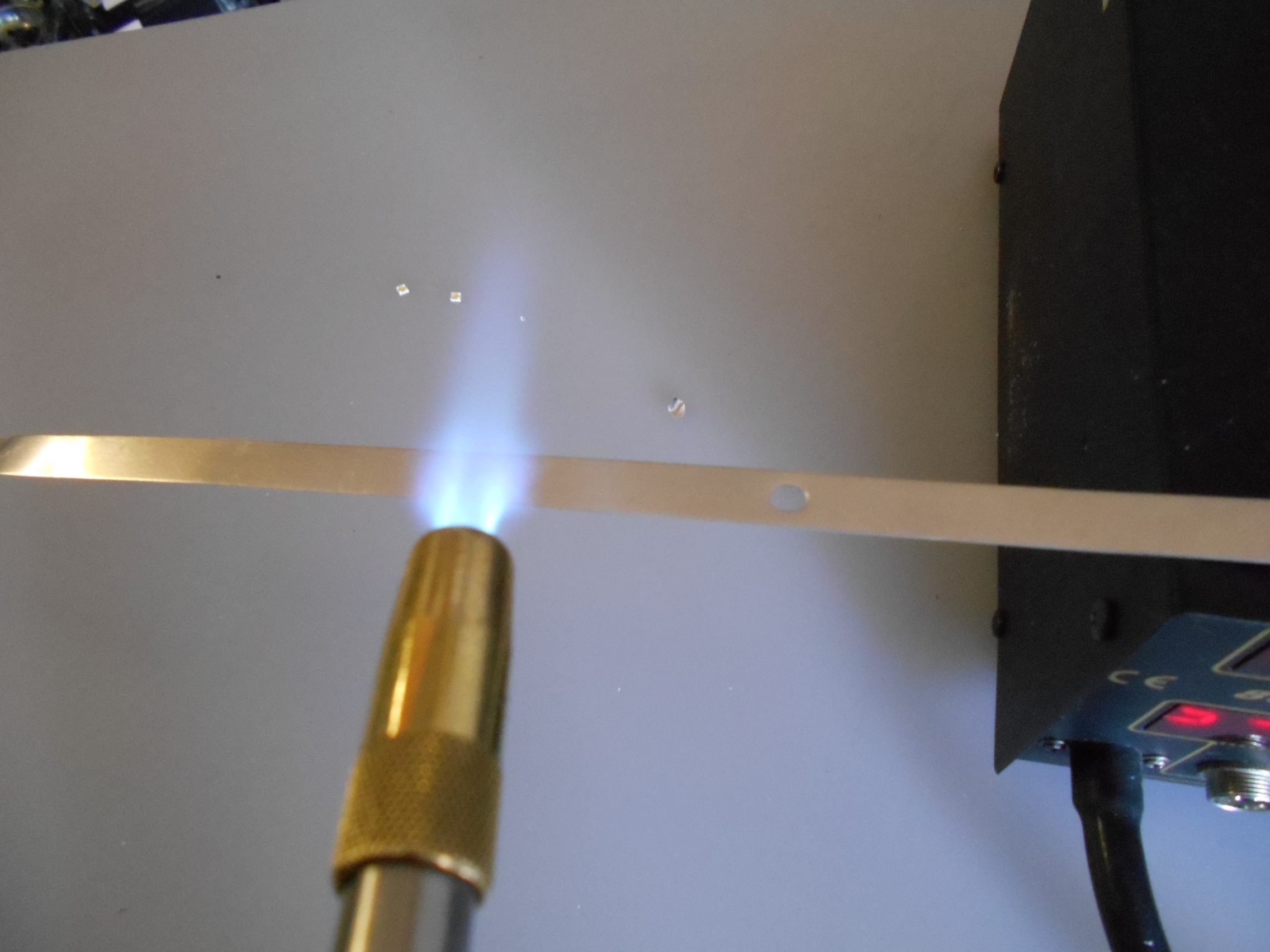

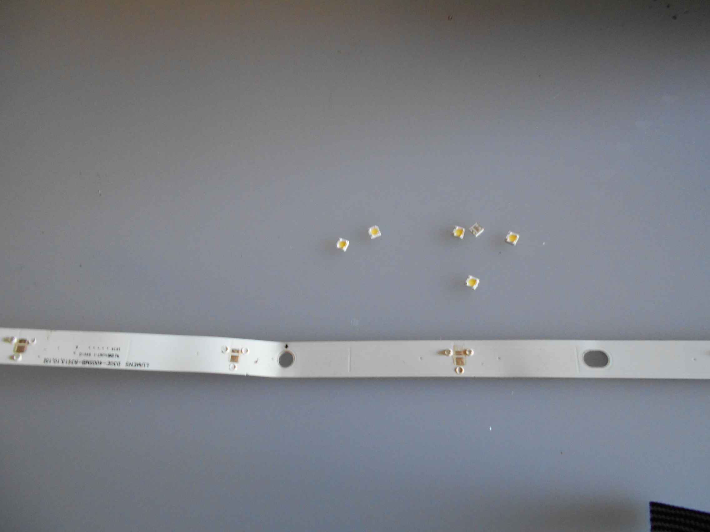

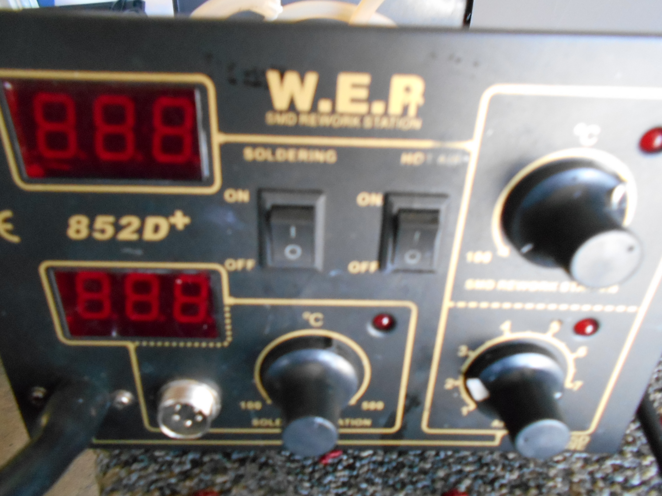

                      How to change LEDs.........
                      1. Solder iron
                      2. Hot air gun
                      3 Oven bake (BBQ)
                      4 My favor... gas touch.............. collect,sort,and reuse all the LEDs
                      Next .....I will teach you ,how to test and group them... in case U need one...... because different TV use different LEDs...................most important thing is current......next project......
                      PS: collect as many LEDs as u can (damper dive)........ we gonna use for making a car head light...........

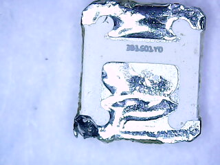

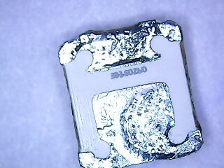

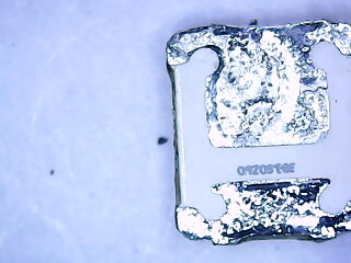

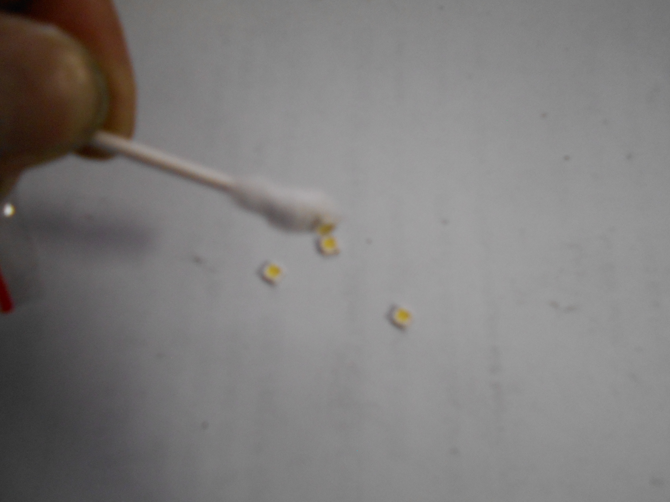

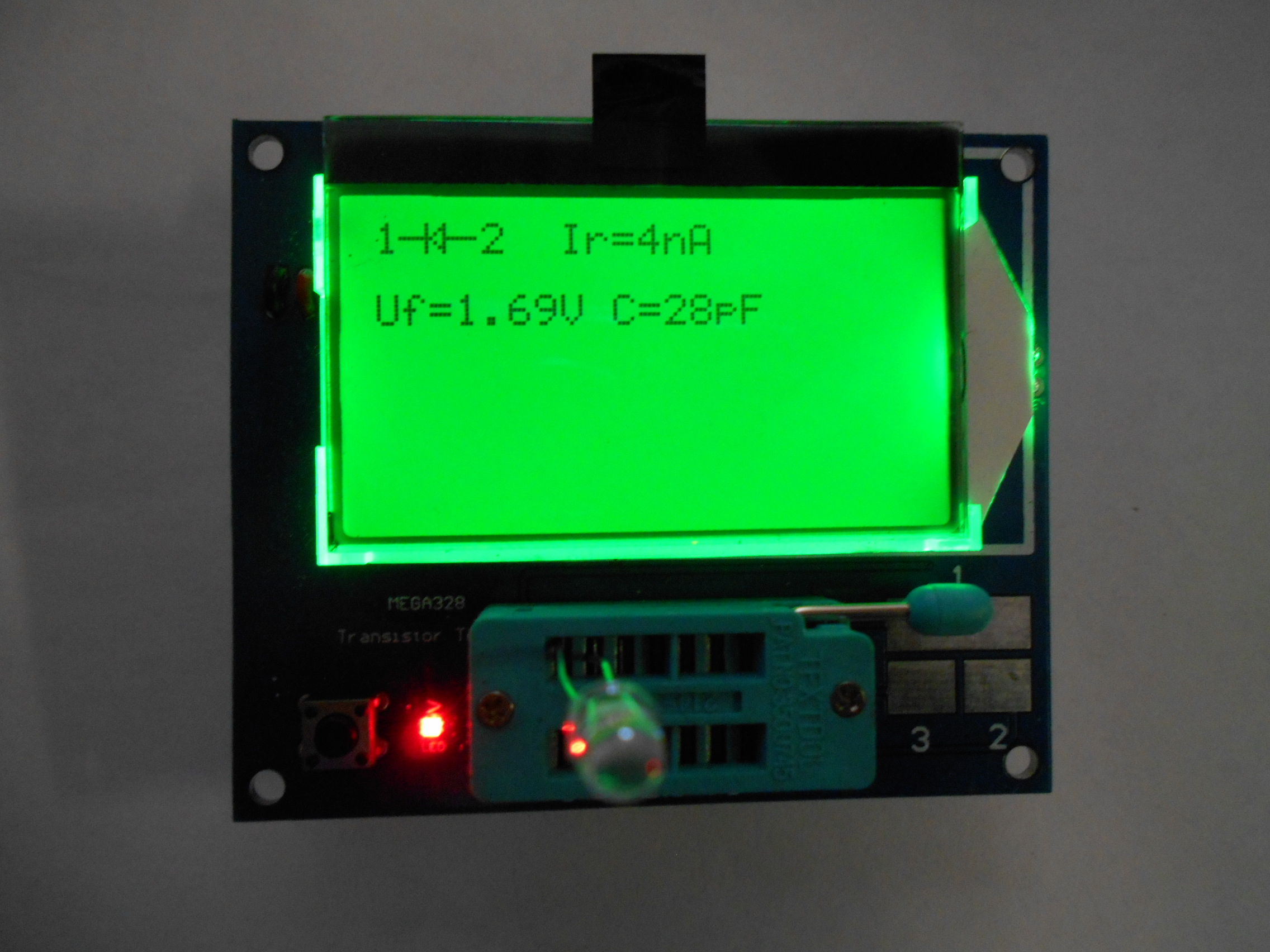

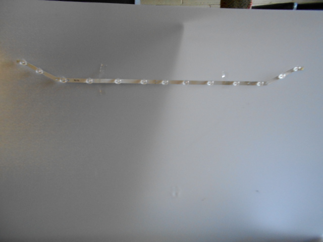

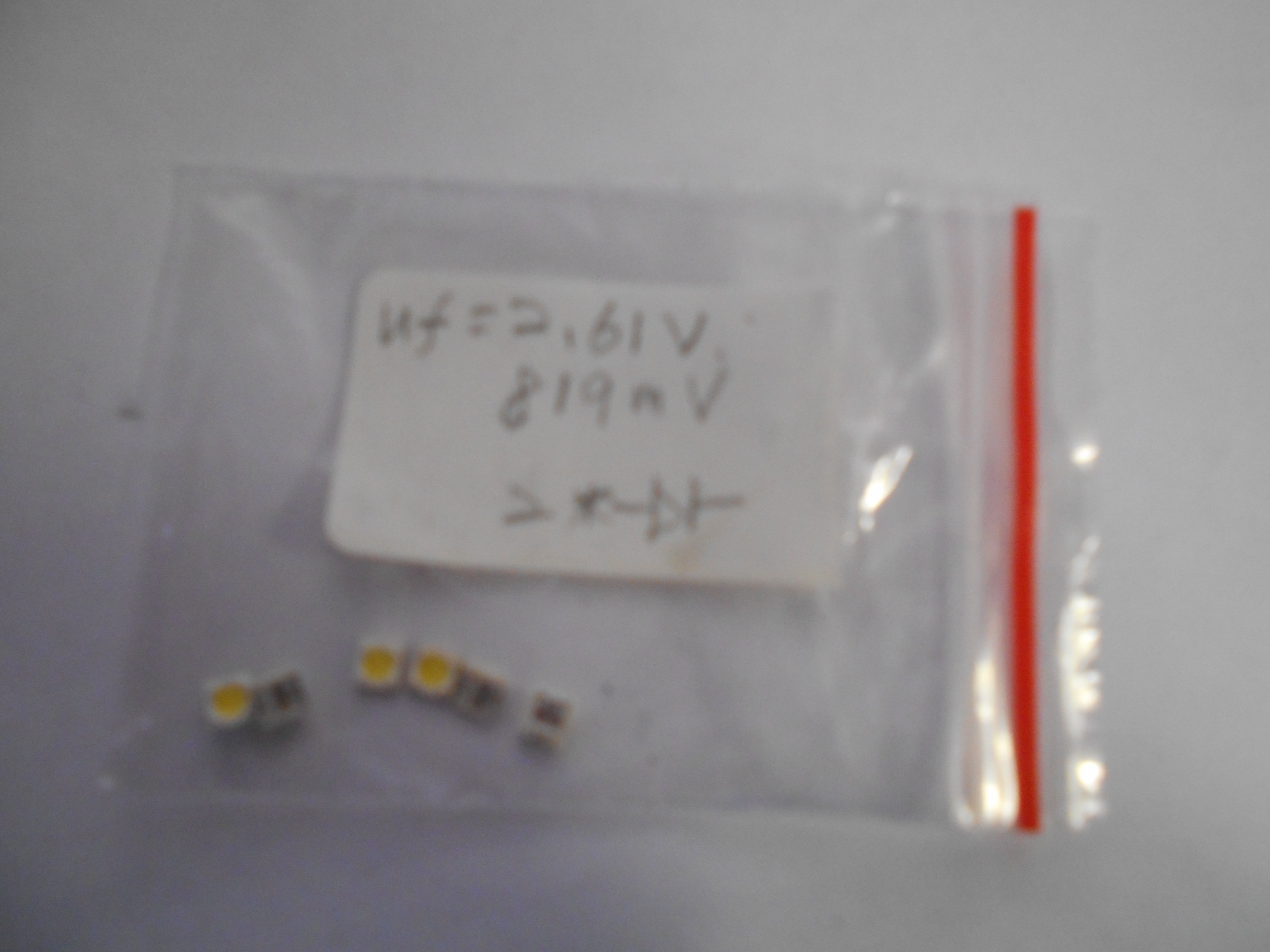

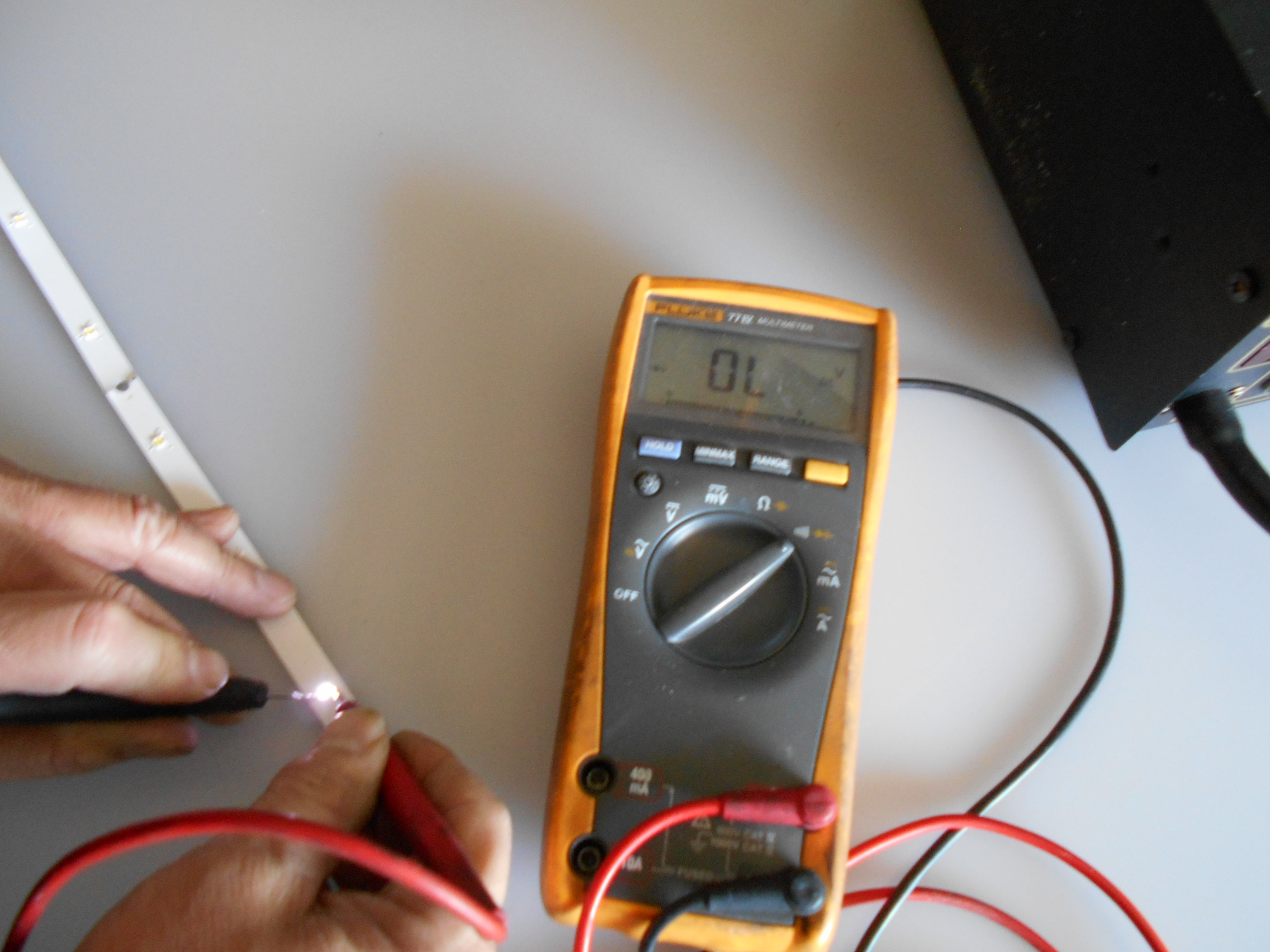

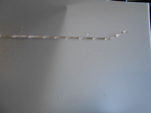

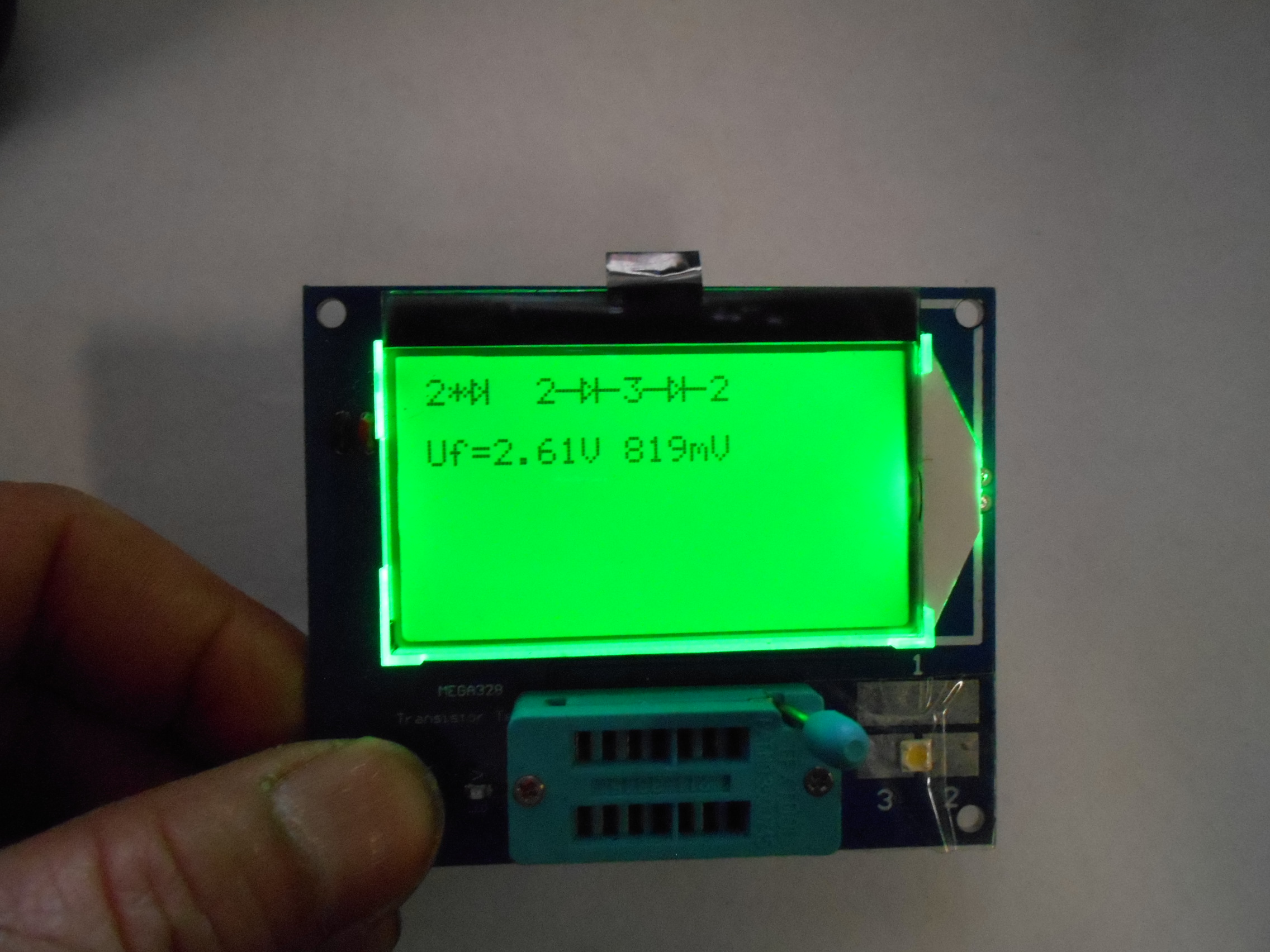

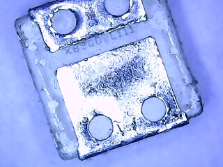

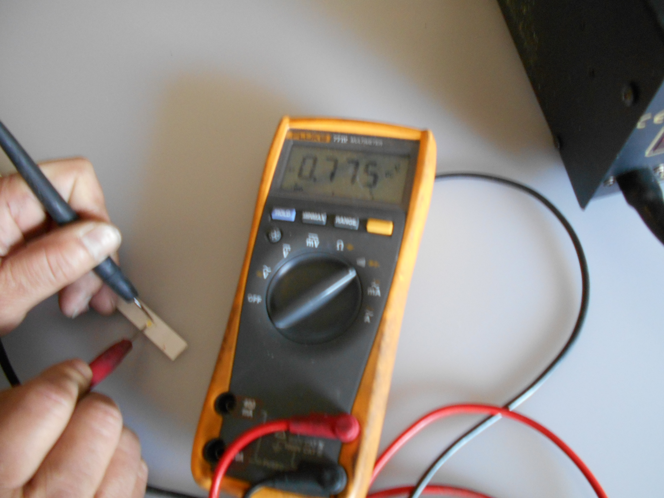

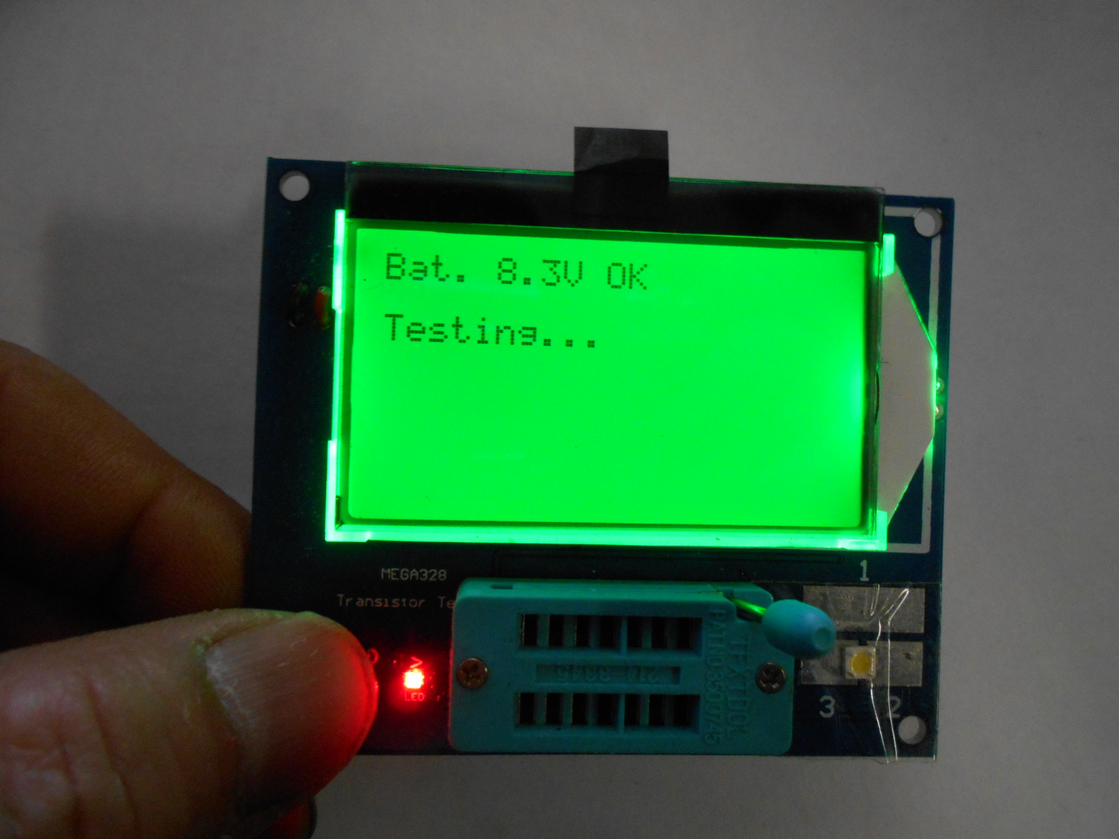

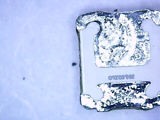

                        How to test backlight LED ?...............let's go.....
                        Pic 1: Look that parts-No.
                        Pic 2: LEDs.... I took out yesterday.
                        Pic 3: You can use swab to pick the LED, with help of month-water.
                        Pic 4: Taped on the tester.
                        Pic 5: read out the information.
                        Pic 6: sorting....
                          #72
                          Re: how to test lcd led backlight?

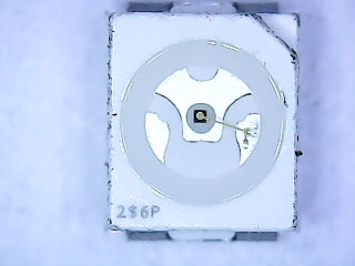

                          What is the 819mV VF, the protection diode?
                          What is t he P/N printed on the bottom of the LED?

                            #73

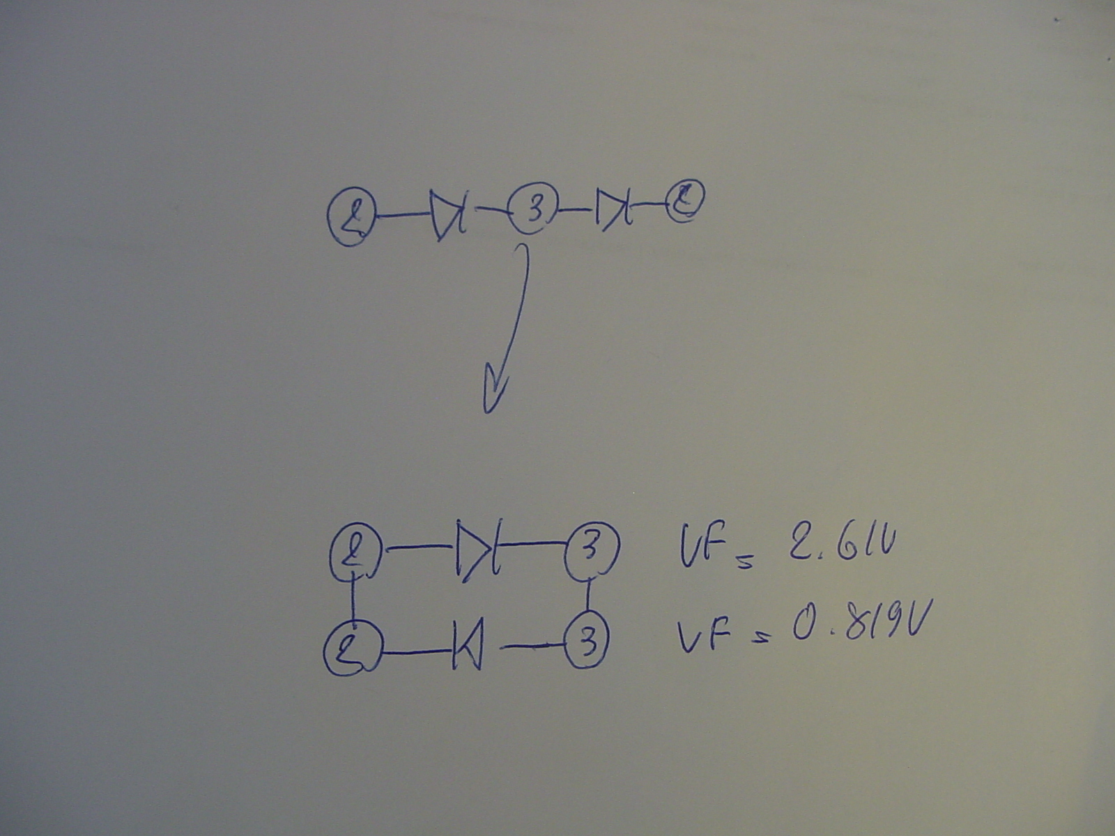

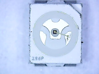

                            The $18.00-wonderful tester-a must have toy.
                            The tester thinks have two diodes inside. And it is, first Blue diode(2.61V) and dropping with yellow diode (at 819mV) will give the almost white color.......But they put the symbol wrong side.....Don't worry, someone wrote that program not perfect, yet
                            Pic 1: I tested with a red LED
                            .....What is the P/N printed on the bottom of the LED?....
                            Hard to read....but just collect them, that was an old stocks. From now on , I will put Penal No. model No.

                            Pic 2,3: A yellow LED.

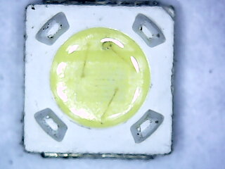

                              #74
                              There is only a blue diode in there.
                              The LED surfaces are coated in CE:YAG or similar phosphor which emits yellow light when blue light hits its surface (fluroscent)
                              So it will test around 2.8-4V forward voltage when good, at If=1mA. (Higher If, greater Vf.)
                                #75
                                That 819mV (it is shown on the meter in reverse polarity in that test mode, it test the two legs of the DUT under two conditions, forward and reverse, look at the symbol on your display) got to be some kind of protection diode, there is no LED with that low Vf that I know of, or that meter is doing something funny. I think you need to understand what the meter is showing and how to read the result.
                                "The tester thinks have two diodes inside. And it is, first Blue diode(2.61V) and dropping with yellow diode (at 819mV) will give the almost white color.......But they put the symbol wrong side.....Don't worry, someone wrote that program not perfect, yet" I think you mis-undetand about LED function. I has only ONE LED.

                                  The printing on the bottom is something like K8CD8C111???? If you can get the number then you can look up the spec sheet.
                                  "Next project:
                                  We can establish a Data Base for all kinds of LED screens.... pins layout .... how many LEDs ......what's kind of LED .......V and A they used....."
                                  If you cannot get the spesheet then you will not know the current handling, color temprature, viewing angle, etc.

                                      I only know , the tester think has two diodes inside by the voltage they detected, how this happen ? I need more research......

                                        When you test with 1 junction device, it will show Vf (Forward Voltage, 1.6V), Ir (leakage current, 4nA), Junction capacitance (28pF).
                                        https://www.badcaps.net/forum/attach...8&d=1428684053
                                        If you look at this picture, only test pads 2 and 3 are used.
                                        If you draw up the test result, you will see I what I draw. It is probably protection diode:
                                        You can simulate the reading by connecting a diode in parallel with the LED as shown, and you will see what I mean.

                                          For BUD M... yes , but you drew the diagram mean SHORT
                                          by search D3GE-400SMA-R2 Pop a lots.... come out......
                                          D3GE-400SMA-R1, LM41-00001V, 2013SVS40, UN40EH5300F, LED BACKLIGHT,DE400BGS-V1
                                          http://www.ebay.com/itm/D3GE-400SMA-...-/271496440642
                                          THIS PART PULLED FROM WORKING 40" SAMSUNG LED TV MODEL # UN40EH5300F, UNIT WORKING COMPATIBLE ALL MODEL # BELOW.
                                          HG40NA570LFXZA
                                          HG40NA577LFXZA
                                          HG40NA578LFXZA
                                          HG40NA590LFXZA
                                          UD04LH40HDBPLGA/ZA
                                          UN40EH5000FXZA
                                          UN40EH5300FXZA
                                          UF40LH40EDCPLBC/ZA
                                          US02LH40MDCPLGA/ZA US02
                                          PART DESCRIPTION IS.
                                          http://www.ebay.com/itm/D3GE-400SMA-...-/221430738045
                                          Wow....I did not know, you can sell that, I already parting out
                                          SAMSUNG 40" LED BACKLIGHT (SAMSUNG_2013SVS40_T1_3228N1_B2_13_REV1.5) UNIT FULL FUNCTION TESTED & CERTIFIED BY TECHNICIAN (100% WORKING CONDITION).
                                          WHAT YOU SEE ON PICTURE, THAT IS RIGHT PARTS YOU NEED.
                                          http://www.sahy.cz/sahy/eshop/5-1-LE...NS-D3GE-400SMA
                                          http://www.ebay.com/itm/like/1516186...466&rmvSB=true
