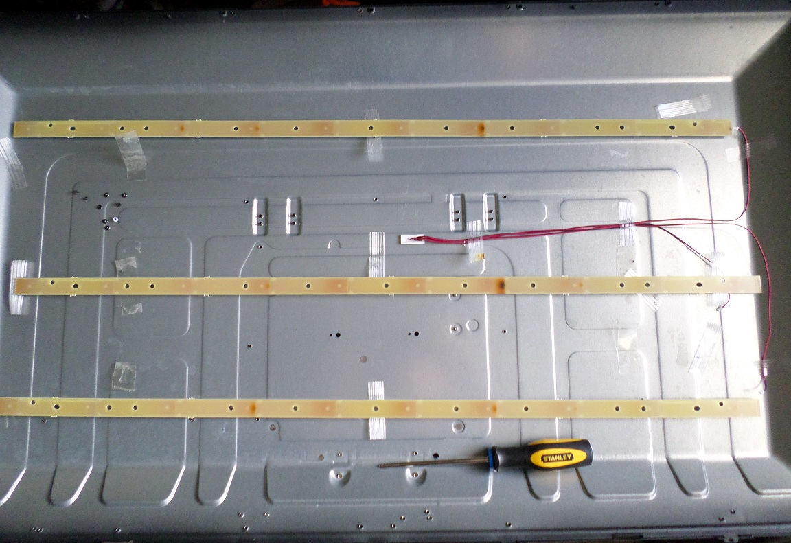

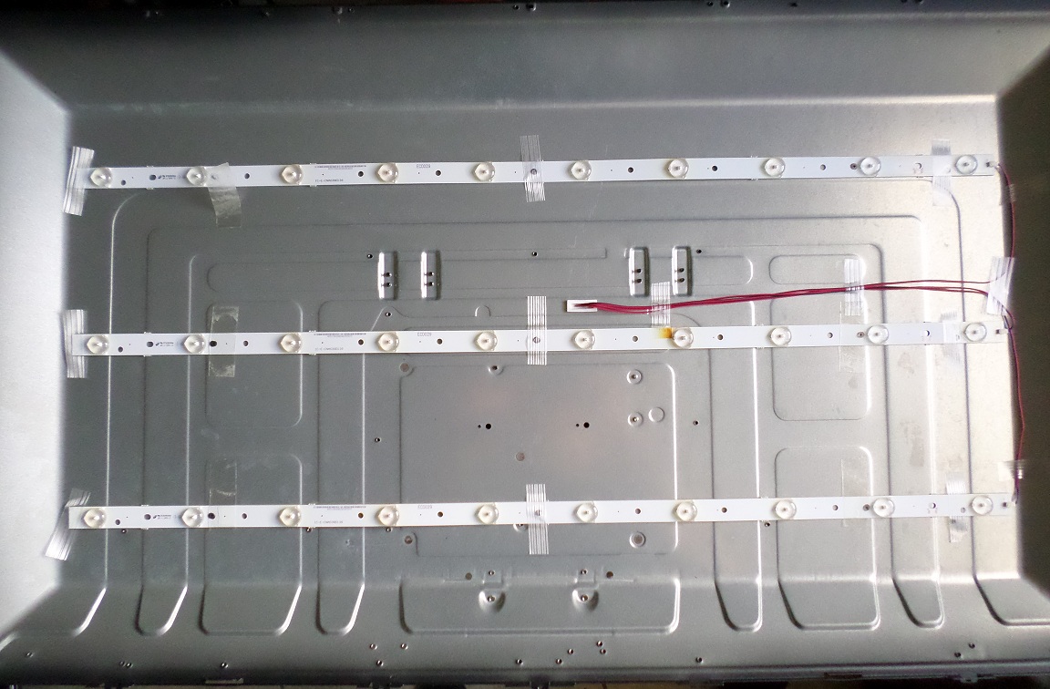

                                      I was extremely careful in removing everything ,
                                      Curiosity killed the cat, I know,...... I know
                                      But looky looky
                                      ECD029 IC-E-CNA039d139
                                        #39
                                        Re: Proscan Plded3996a-c2
                                        I Just tried to see if the led strips would light using a small tiny H.V.inverter from a colored cold cathode tube for PC Modding, that feeds itself from a pc psu at 12V,
                                        regardless of the horrible /Black-brown states of the back of those LED Pcb strips, they flicker and all do light up (not brightly but they do turn on with the little inverter), Ill heat sink them to the large metal backing before I close it all up using a potting / thermal paste adhesive... WHY the hell didn't they do this at factory the tube costs like $2.14 on ebay sigh.
                                          #40
                                          Be careful you don't electrically connect them to the frame somehow and short them out.
                                          -David VanHorn
