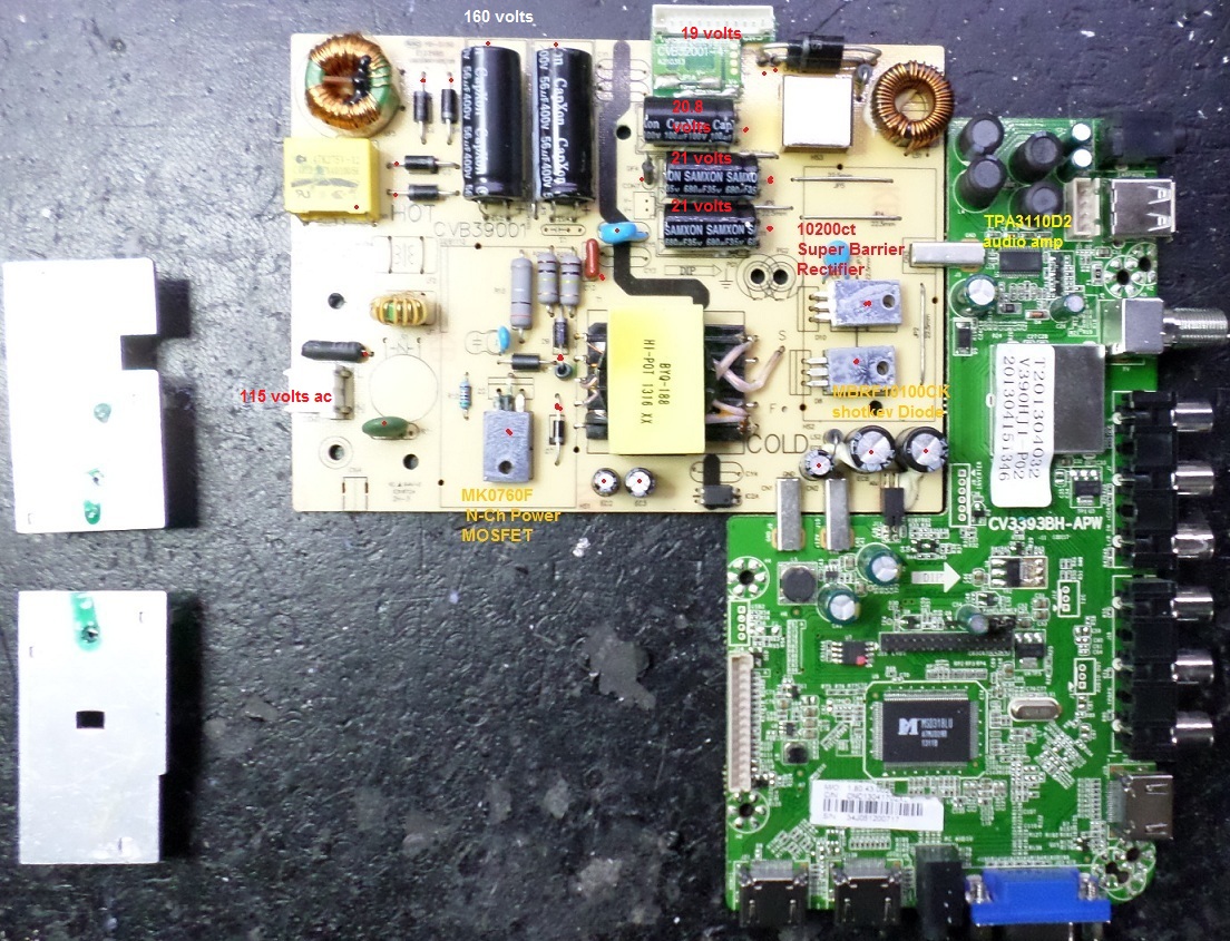

    Man there's nothing in these Tvs these days wow tiny little boards compared to the Sammy. This one ill keep to turn it into a led monitor for the pc :P
    Symptoms Are :
    Tv red power led turns on when plugged in, Once power for the remote is pressed led becomes Blue and remains. No back-light Leds come on at all, not even a flicker.
    Ive checked the through hole components in the pics they have dots, all seem to register on the little trans tester as what they are, none burnt.
    In the pics ive tried to take readings, I can already see
    "Bud, typing inverter/Pwm circuit , here we go again" what are the voltages."
    Not sure sure if its CAP Ground leg or chassis .
    To take those readings for the inverter IC ,Youll ask and ill measure.
    http://www.datasheetlib.com/datashee...conductor.html
    http://www.scribd.com/doc/255967649/...Control#scribd
    tried to do all the homework so you guys don't waste time

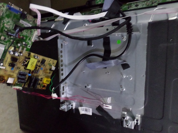

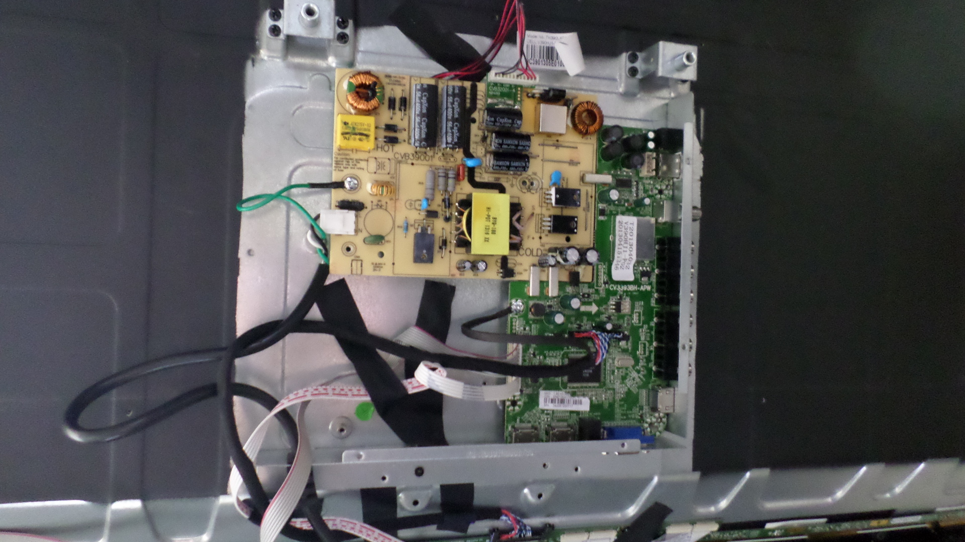

    Can we see the whole back side of the TV? I cannot see where the LED BACKLIGTS wires are at, it looks like the connector with the red and black wires.
    • _N_
      • Nov 2010
      • 52
      Re: Proscan Plded3996a-c2
      Those red and black wires disappear into a little slit in the caseing under the psu/inverter. the whole tv must weigh like 15 lbs max lol.
      I think there just connected to the led strips inside, I didnt want to dismantle the complete thing in case a break the screen,limited work space.
      BUT if its required, NP. needed?

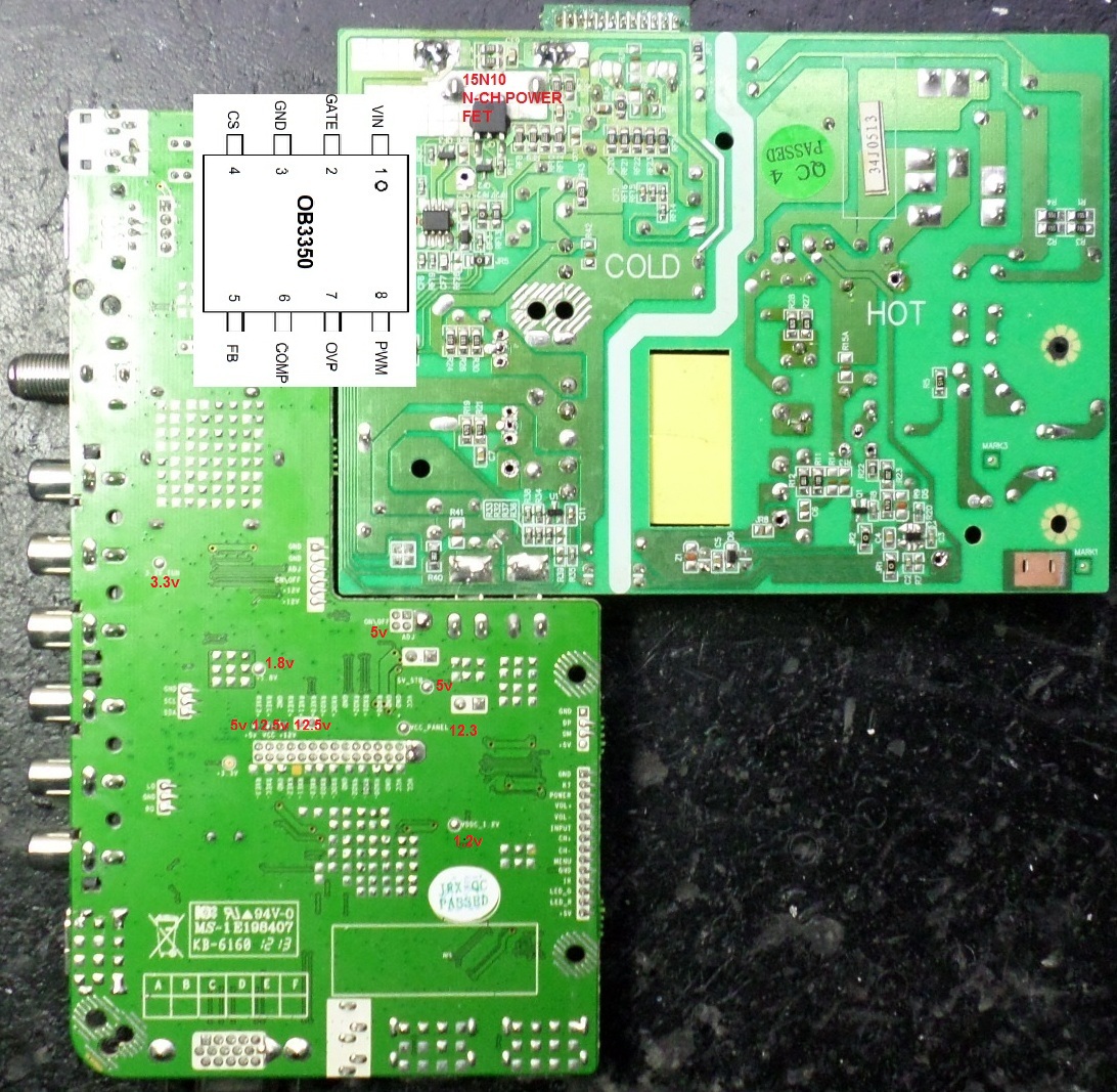

        See. In the 3rd pic I took, where you see the voltages of the backside of the board in red ,
        Under the N channel Fet
        theres 2 tiny little 3 pin SOT-23 ( i think) Smds .
        1 is 3pin NpN and checks good the others a 3 pin Diode and
        Theres 1 tiny Zdiode (gives voltage both ways)
        these are by the inverter ob3350

          Did you check the 15N10 FET on the bottom for shorts?
          • _N_
            • Nov 2010
            • 52
            None of the 3 contact points beep on my meter, I tried in every combination.
              OK, the Voltage on the 100uF 100Vdc cap whcih is the filter cap for the LED driver Voltage boost converter circuit (the TOROID Inductor, the SMD Power MOSFET on the bottom of the board, the two rectifier diodes stacking on top of each other next to the TOROID). The 20.8BDC reading on that 100uF 100Vdc is too low. Was the Voltage reading taken without the LED connector in place?
              So beside check the MOSFET for shorts, you need to check the diodes also.

                                        OK, that means the MOSFET is not switching on and off and it just passes the input Voltage right to the output without producing the boosted Voltage needed for the LED.
                                        So you need to find out what DCV you have on the VCC pin and the GND pin of that 8-pin SMD IC.
                                        Did you download the spec sheet for that IC? If you did, then you should upload it.
